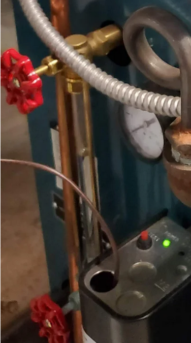

Hi folks,

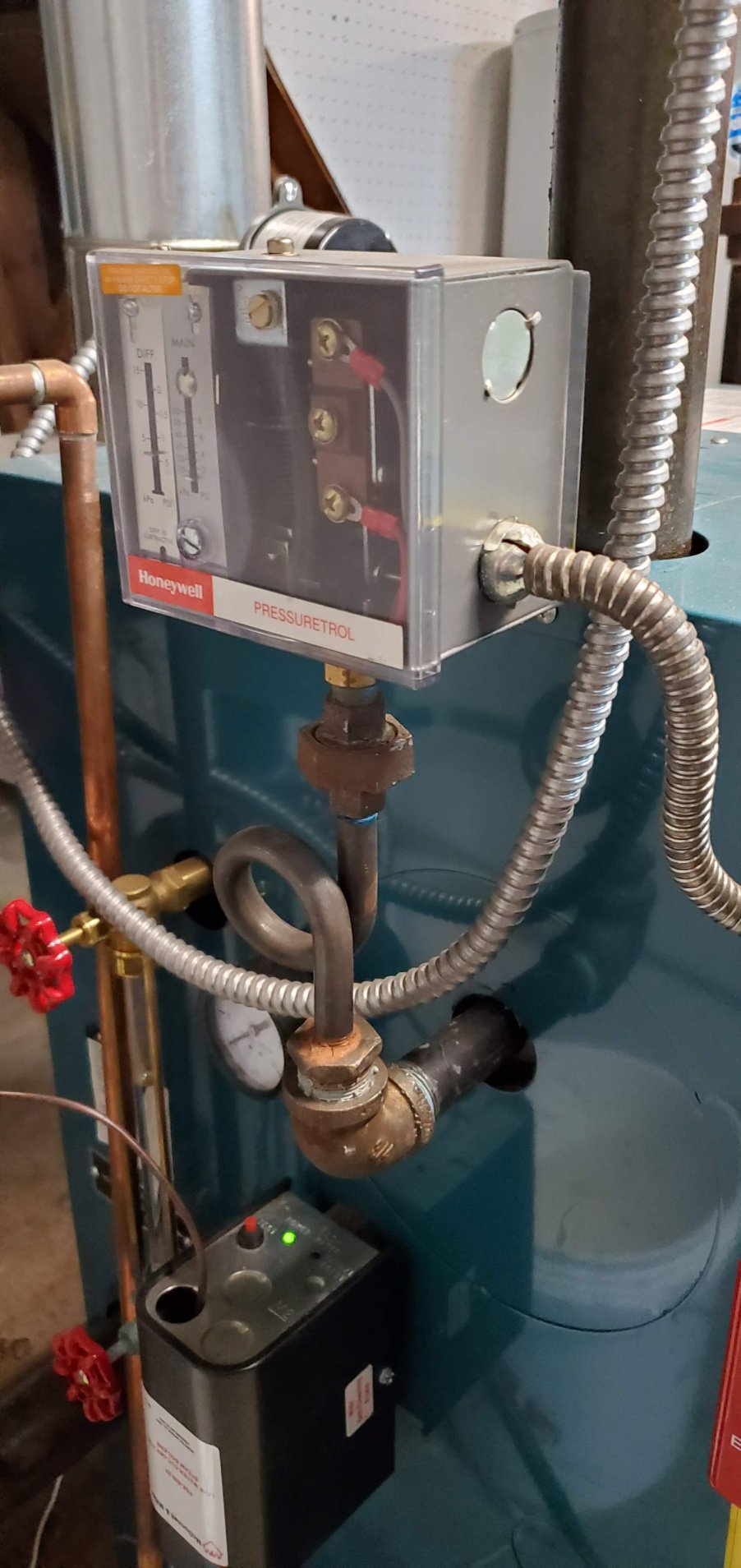

When I moved in to my current house in fall last year I promptly had the [1 pipe steam] boiler system inspected and serviced. When the technician took off the pigtail, the elbow and nipple connecting it to the boiler was pretty well clogged up with rust, and he said it probably was never serviced (i.e. in the 10 years since it was installed). I discovered, from later finding the plumbers who the previous owner used, it likely was serviced probably 2 years prior.
Fast forward to now, where I realize all connections between the boiler and pressuretrol (including pigtail) are steel instead of brass, which I understand is not ideal. I just took it all apart to inspect, and found plenty of gunk at the elbow and nipple again (not quite as bad as what was found last year). I did notice a few instances of the boiler shutting off before the heating cycle was done, then promptly restarting, at the end of last season which I presume is related to the pigtail being clogged.
So I figure I should replace it all with brass fittings instead of steel. That would include a 4" nipple, elbow, 3/4 to 1/4 bushing, pigtail, and union - to do it one for one.
Looking at supplyhouse.com there are a few brand selections. Can anyone tell me if there is something I should look for or avoid for these brass parts?
In particular, I see a 1/4" straight brass pigtail for $9 : https://www.supplyhouse.com/Wal-rich-1706006-1-4-Straight-Brass-Pigtail
Or "straight brass steam gauge siphon loop" for $35.
https://www.supplyhouse.com/Apollo-Valves-2740101-1-4-Steam-Gauge-Siphon-Loop-180
Or, another 1/4" pigtail for $11 https://www.supplyhouse.com/OMI-Parts-PIGTBRS-1-4-Straight-Brass-Pigtail
Which should I go with?
Most of the other parts (nipples, bushings, etc) seem to be predominantly from Bluefin brand.
Another opinions welcome too, regarding others ways to redo it. i.e. eliminate the elbow and use a 90deg pigtail? Still though, whats the difference between the Apollo, Wal-rich, and OMI pigtails, and do I need to care?
Thanks,
Jeff

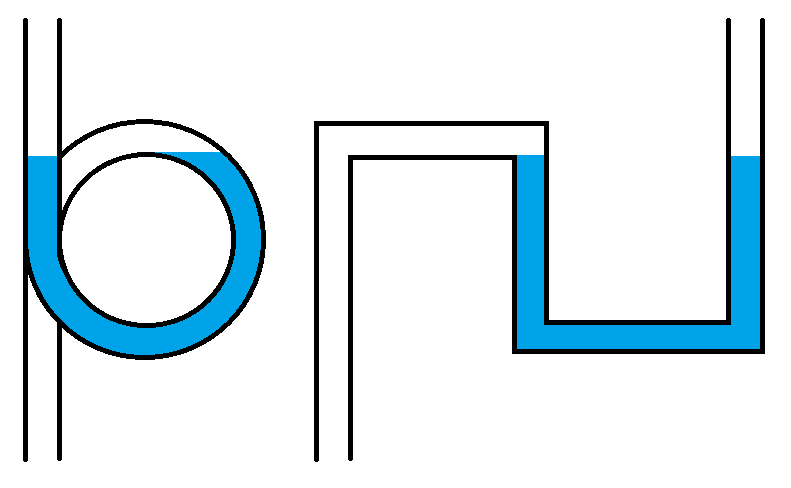

    You can make a trap out of brass tees and nipples and plugs and you can just remove the plugs and flush it without having to take it apart.

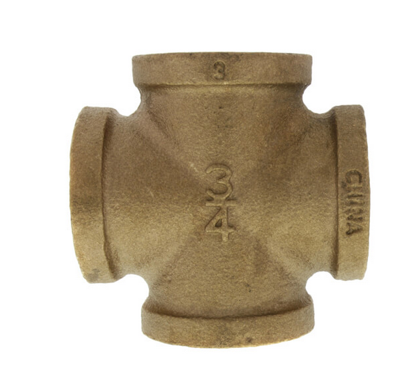

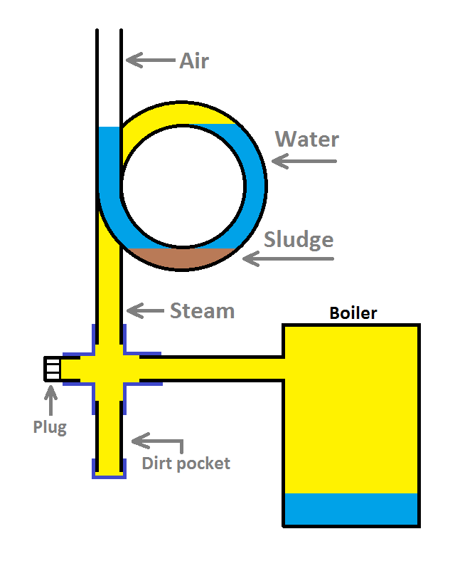

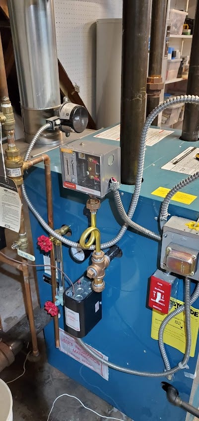

    I would replace that elbow with a cross and make a dirt pocket and have a plug to clean out the horizontal pipe to the boiler. Might as well make needed maintenance easier. You could scrap the pigtail and make the water trap out of larger piping, if the needed elbows are tees or crosses with plugs easier to clean out.
  • Ok. The dirt trap idea is interesting - I may do that in addition to replacing it all with brass. Any reason not to replace the nipple and everything else with brass?

    Here is an example of a water trap built up with nipples and lots of plugs for cleaning. In this case the long horizontal pipe fills with water providing the water trap protection. For some reason your boiler seems to like to fill up that pipe in a short about of time. Brass may slow it down but the buildup in your picture seems excessive for that amount of time. Maybe (historically) they only serviced the pigtail and not the larger pipe going into the boiler. If it keeps loading up the pipes maybe a different tapping on the boiler would work out better.

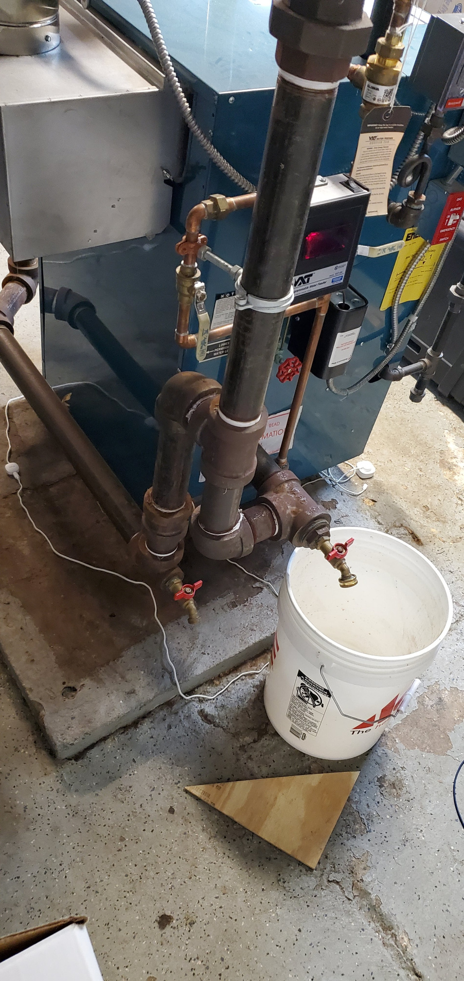

    Yes the wet return is accessible. Anything I should do before draining it? The system hasn't run since April probably - should I make it run for a cycle before draining?
    edited September 2025
    you should flush it with a hose.
    do you have wet returns or just that piece of return below the water line at the boiler?
    109A_5 Posts: 4,759
    If those are the only two spigots in the return system there is no good way to flush that short wet return on the left hand side other than firing the boiler and let the condensate drain out of the Left valve pictured. Better than nothing. Probably better done during the heating session.
    You could connect a hose to the Left valve pictured and drain out the right valve but the excess water will mostly just go into the boiler.
  • Yes, those are the only two spigots. And yes, just that one return below the water line.
    There is a main vent at the end of the main before it drops down to the return. I suppose I could remove the vent and flow water in via a hose there if that would be worth it.
    The other thing I could think of is, once draining it, I could flow in just enough water from the feed to fill the wet return, then drain it again. Could maybe do a few iterations of that. You can see the copper line feed on the right, then it runs under the drain on the right at bottom of the boiler to connect to the riser of the return line.

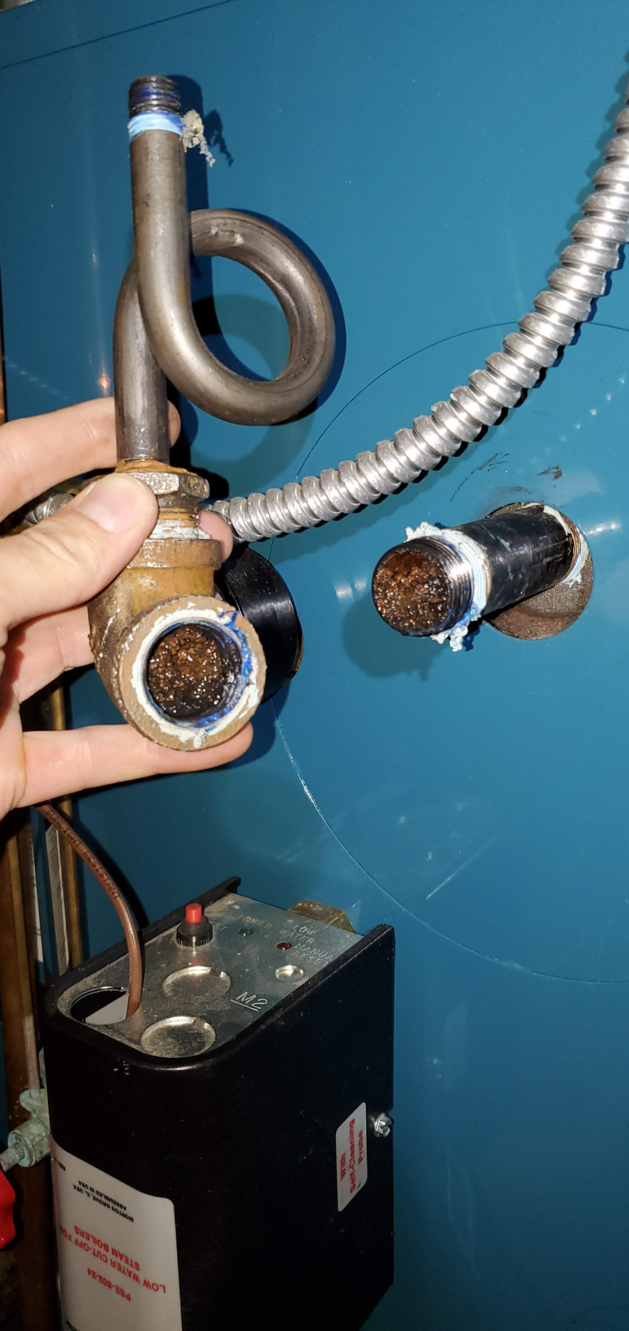

    This is what I ended up doing:
    Left the original nipple in the boil, then replaced everything else with brass and made a dirt pocket as mentioned above.
    Haven't turned the system on yet. Waiting for a cooler morning perhaps.
    I also got some 8-way boiler treatment to try out. Any advice on using that? (how much? Should I drain the boiler once first then add 8-way?)
    109A_5 Posts: 4,759
    Looks good, now you can inspect the horizontal part with a flashlight. The horizontal part could have been brass too.

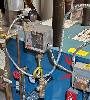

    I'd fix this too when you get a chance.
  • jefftk3
    jefftk3 Posts: 32
    Yeah… the new brass pigtail is a bit longer so the existing flex conduit isn't quite long enough. If I don't encounter any problems when turning it on, then I suppose I'll look in to replacing it with a slightly longer run of conduit.

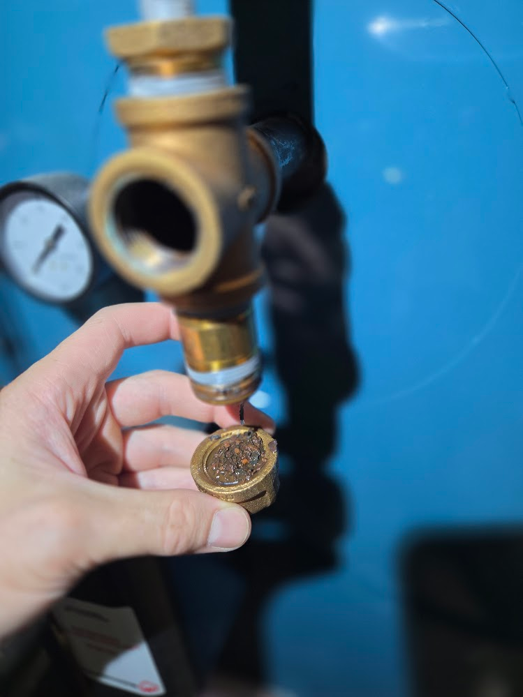

    Update on dirt trap setup:

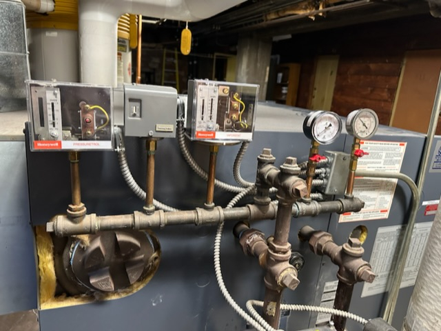

    Doing some pre-season maintenance yesterday, and took off pigtail etc.
    Here is the bottom of the dirt trap filled with muck. So I guess that worked, insofar that it was in the trap and not clogging the pigtail.
    I made a very brief attempt to replace the steel nipple going in to the boiler, but gave up after putting as much force as I was comfortable with on it with the tools I had. If I get some professionals over at some point I may ask them do it.
    109A_5 Posts: 4,759
    At least now you can easily inspect and clean out the whole assembly and the steel nipple.
    ethicalpaul Posts: 9,075
    The steel nipple is fine. Still curious about what's making so much gunk in your boiler. Are you regularly flushing and filling you boiler? If you are then STOP

    Remove the existing flex conduit and re use it coming out of one of the top knock outs in the electrical box. It will then be long enough. Buy a KO seal to plug the unused KO
    109A_5 Posts: 4,759
    Maybe just switch these two cables.

    Good ideas on re-routing wires through different knockouts on the junction, I'll look in to that.
