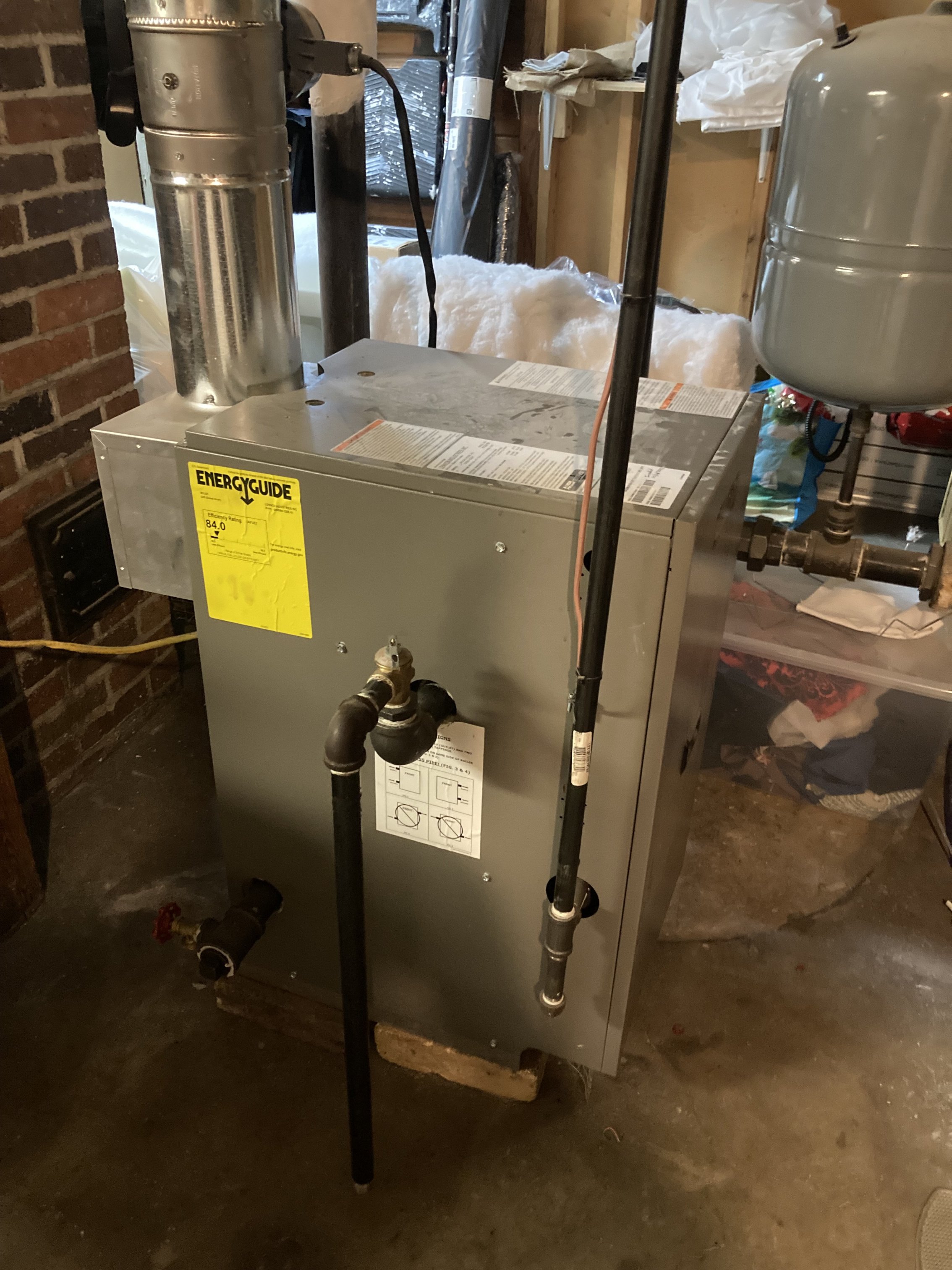

I just had my annual fall inspection on my Lenox boiler (Hot water) and the technician says my heat exchanger needs cleaned. Boiler was installed October of 2022 and has not had the heat exchanger cleaned since install. Tech did a combustion test and carbon monoxide levels are elevated. He is saying the heat exchanger needs cleaned which is probably true. Cost is $$$ which includes 2 hours of his labor and he has to "buy a few brushes" for this job. Cost seems high to me, but what do I know. Boiler is a Lenox model GWB84-120E-01
Questions I have: 1. Is this a reasonable price to clean a heat exchanger on a relatively new boiler?
2. How often should this be performed?

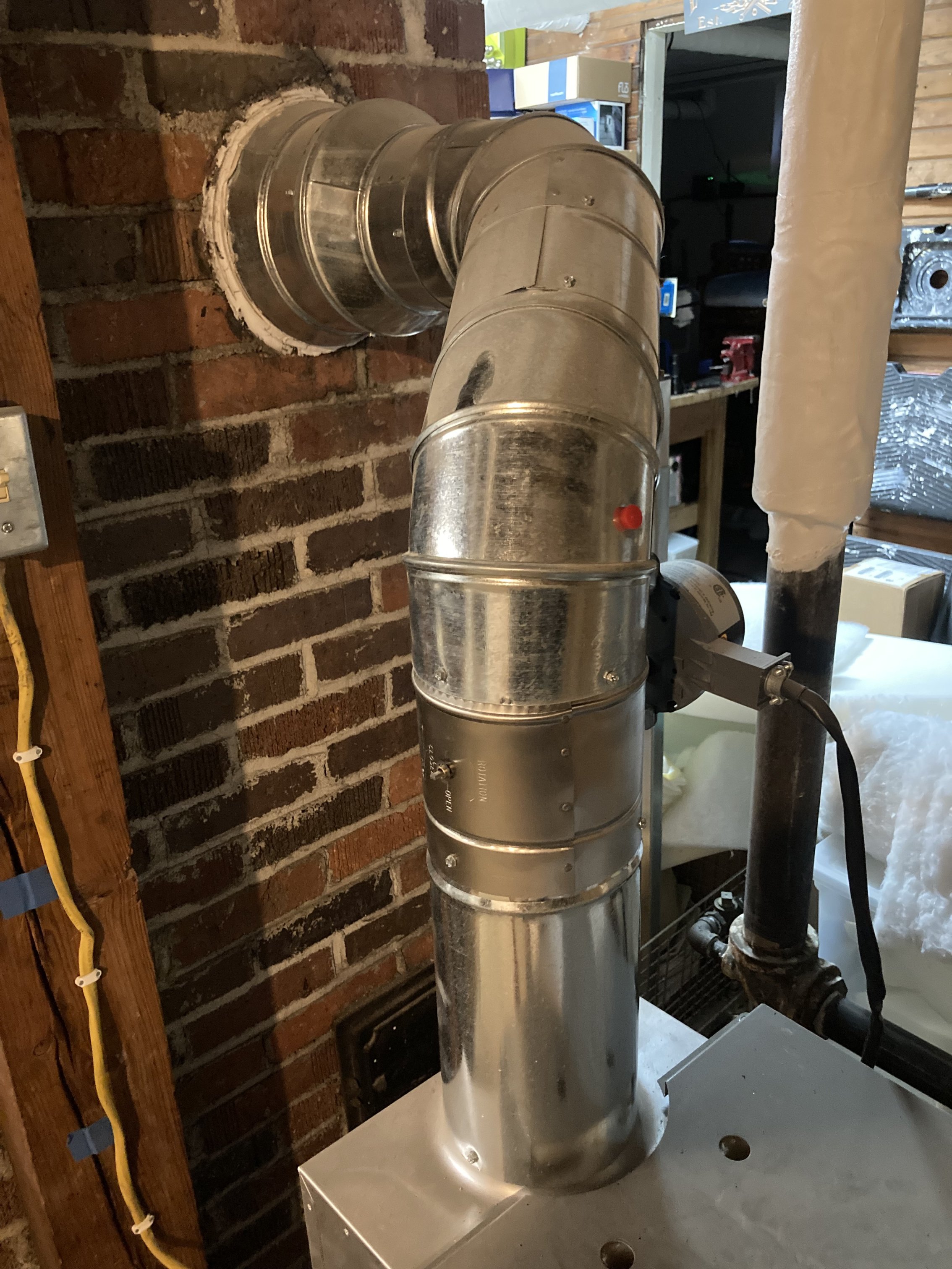

  • @HVACNUT I was not present during the combustion test so did not see inside of anything. I got the numbers after the fact. The tech drilled a small hole in the metal venting piece that goes into the chimney and then plugged that after he was done. Would you recommend I call a different servicer and run another combustion test? I do want to make sure everything is safe. I dont know if the first guy was trying to upsell me or if something is truly off?….

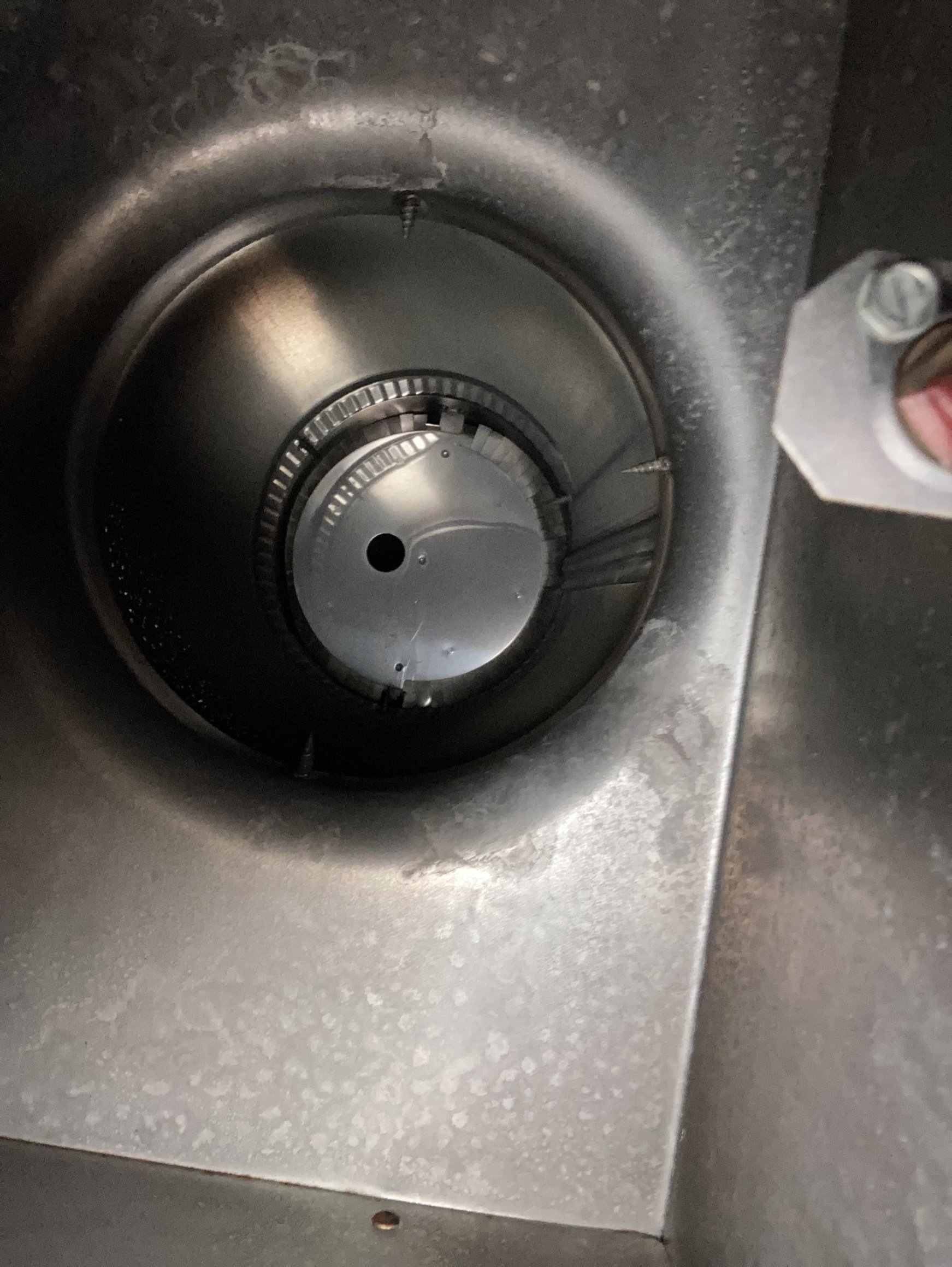

  • @captainco @HVACNUT After you mentioned draft hood I got to thinking and I am not sure if there is a draft hood?… I am including a photo here. Little red plug is where he drilled and stuck his probe in. If there is no draft hood could that be contributing to the wacky numbers?

    Drilling a hole in the flue pipe is NOT where the combustion analyzer probe goes on your particular boiler. The box that the flue connects to at the back of the boiler is open at the bottom. The probe needs to go up through that box to reach the undiluted flue gasses directly coming from the boiler block.

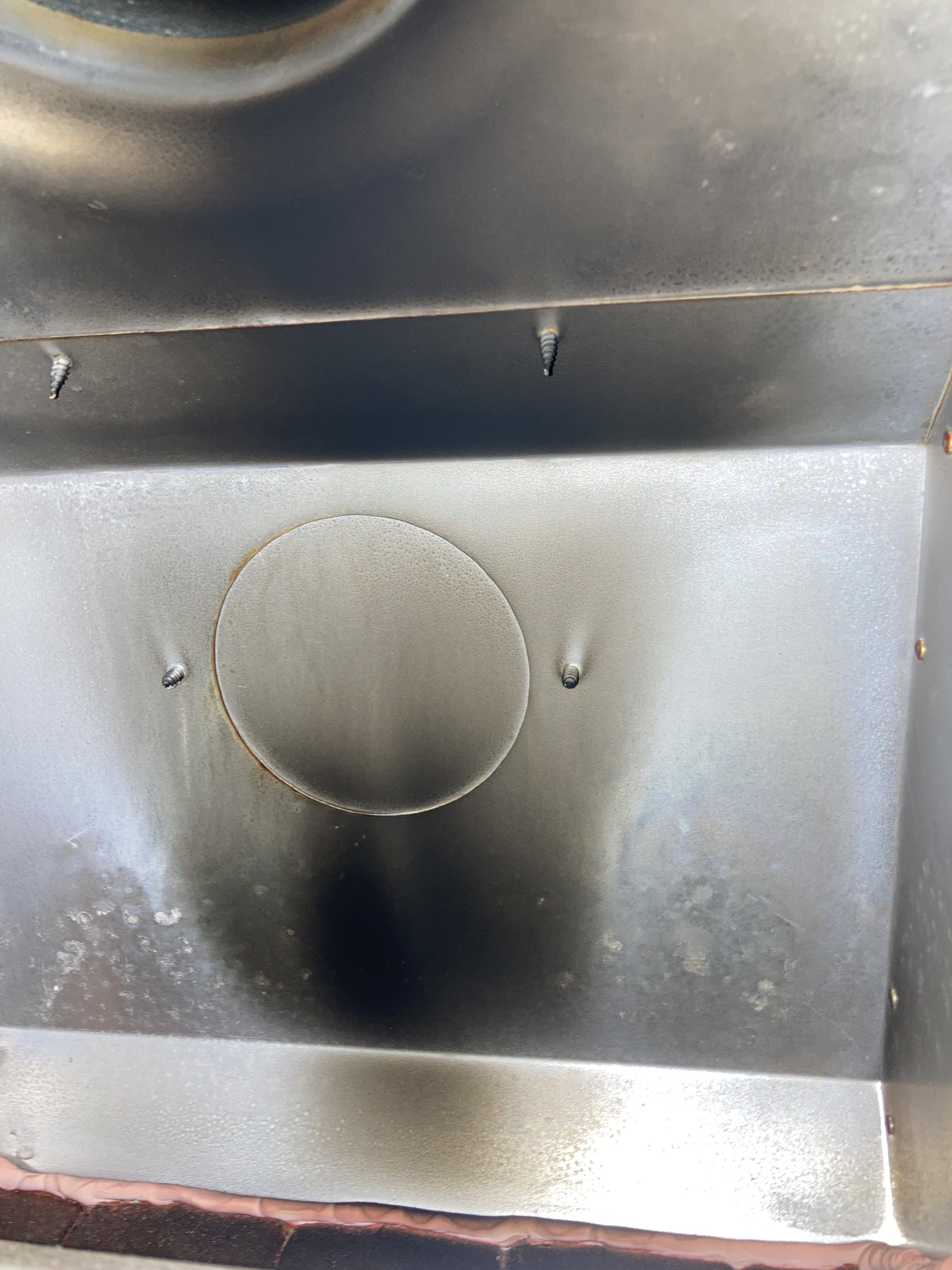

  • @HVACNUT @captainco Photos looking up into the box at back of boiler than connects to flue pipe. Some soot but I dont know that this is excessively dirty?… No soot on the ground under box or around boiler.

  • I have seen hundreds of sooted up boilers and water heaters. I still don't assume safe without soot. I have never figured out why some equipment making lower levels of CO make soot and equipment making high CO doesn't.
    A CO alarm plugged in near the floor will not see CO until it is much higher.

    can you look inside the boiler? you are looking up the draft hood up the vent. the collector box on top of the boiler connects in to the side of that box, can you look in there? there is some soot there which shouldn't be there. not enough to affect operation, at least here, but something is happening to make it.
    you can also take the front cover off and take some pictures around the burner and up the bottom of the heat exchanger.
    turn the switch off before you start sticking your hand and face inside so it doesn't accidentally fire with you in it.

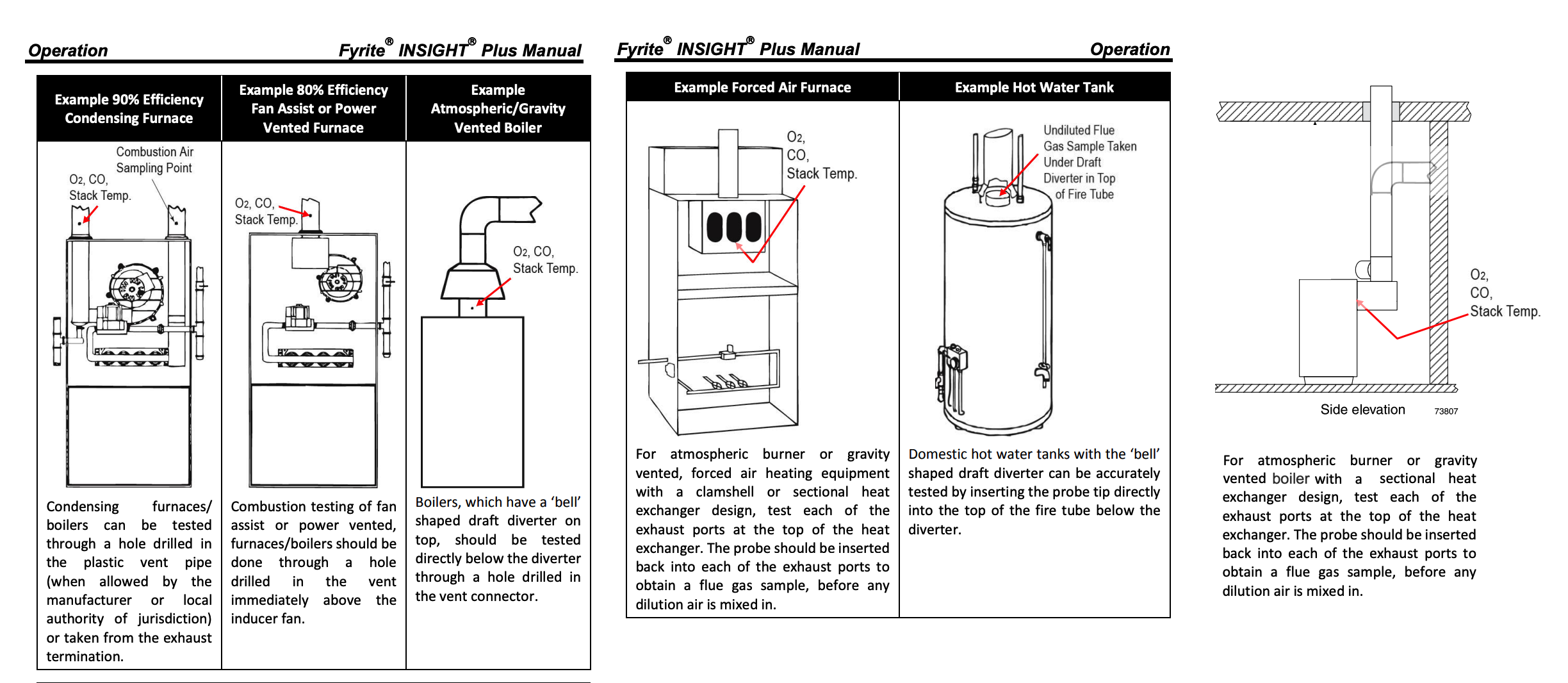

    But seriously: As other's have explained you do have a draft hood and the combustion test was taken from the wrong location. here are 5 diagrams from the instructions of a combustion analyzer that show the different types of gas heating appliances, and I have put Red Arrows to indicate the test location. If you look at the 4th diagram of a furnace with a similar draft hood to your boiler's draft hood you can clearly see that you need to place the probe inside the furnace from the underside of the box type draft hood. In that illustration there are 3 openings to that draft hood box where you need to take readings.
    I have added one more illustration that depicts your boiler's draft hood, and the arrow showing the test location for CO, CO2, O2, and stack temperature from each separate section. this may reveal that the boiler is operating perfectly in all the sections but one. then you can look at the burner that feeds the one problem section.

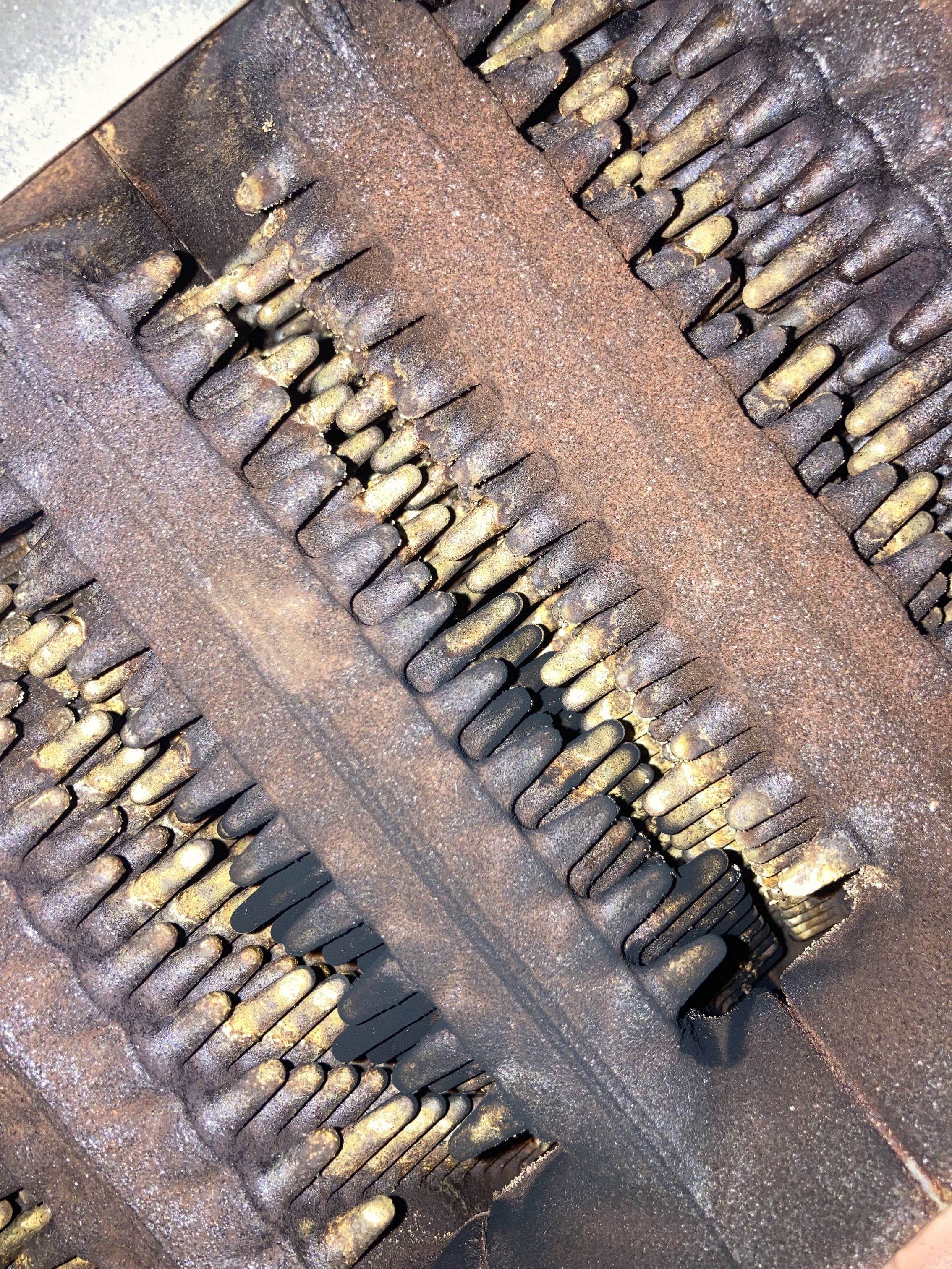

    Looking down into the heat exchanger with top cover off. I'm not sure if this is how a typical heat exchanger should look? You all have been very helpful and I appreciate all the advice given thus far. This site is a wonderful resource for homeowners!
    hot_rod Posts: 28,706
    Certainly some black soot there. If that is the top? how does it look from the bottom with a mirror?
    I'm not sure about the yellow color, @captainco will know.
    What kind of emitters is this connected to? Is it fin tube baseboard or cast iron radiators or what? What is the aquastat set to?
  • @mattmia2 Cast iron Peerless style radiators. American radiator company. I dont know about the aquastat but maybe I can find out.
  • @hot_rod There was very little room going from underneath to see anything but from what I could tell the bottom of the heat exchanger was a little sooty like the top. I did not notice the yellow color on the bottom but again I didnt want to take everything apart to get a better look.
    it is probably caused by lack of return water temp protection, the boiler is probably staying too cold and is condensing. it needs to have a thermostatic bypass or at least a manual bypass to keep the boiler temp up with all the mass in that system. is it a gravity conversion, are the original mains huge?

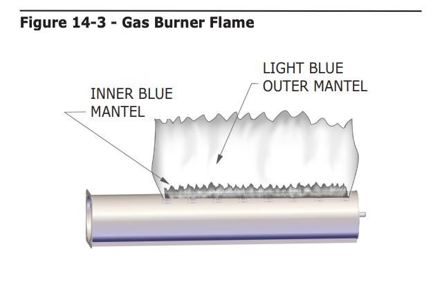

  • I'm not liking the soot although it is very minor. The problem with soot is that the little coating can build up almost unnoticed for weeks or even months, but all of a sudden there is a point where things turn really bad within hours. then you have a house full of soot and no one can explain why it happened.
    You may have a negative pressure happening inside your home from time to time. There may be a tree growing higher than your chimney, there are many reasons for back drafting through a boiler like yours.  It could be a rare occurrence but just enough to screw up the combustion process for a minute or two and then you get “incomplete combustion”aka "SOOT".  You may never find the cause, but it is important to keep an eye on this condition.  At the end of each heating season, you should open up your boiler like you just did here.  Inspect the heat exchanger and brush off anything that may have built up over the past heating season.
    I have found that placing a piece of cardboard or newspaper at the bottom of the combustion chamber after removing the burners from the combustion chamber.  Use the brush to clean out the HX and you can pull that paper out with all the soot and debris to discard before placing the burners back in place.   You can also clean out the burner tubes while you have that burner assembly out of the boiler.
    The white/yellow build up is less of a concern.  That is just some calcification that happens during the combustion process and it sticks to HX.  You can try to brush it away with a soft fiber brush.  That is all you really need to clean the soot away. You may need a wire brush to do the white stuff but it is not a priority.
    This atmospheric burner does not have any air shutter adjustments because the manufacturer feels there is no need for adjusting the combustion air.  All the adjustments are done by eye and adjusting the gas pressure so there is no yellow in the flame only blue "according to the service manual." Many pros on this site will disagree with "Adjusting by eye" but there is no mention about combustion testing in the I/O or Service manual(s). But I have the combustion testing tools, so I would check yours if I saw that soot during one of my maintenance or service visits.
    This assumes that the boiler room has sufficient air for combustion.  If you have installed the boiler in a “confined space” or have done renovations that cause the previously acceptable boiler room into a confined space, then you will need to make provisions for the right amount of combustion air for your boiler.  Ask me about that if you need more information about what is considered a confined space.
