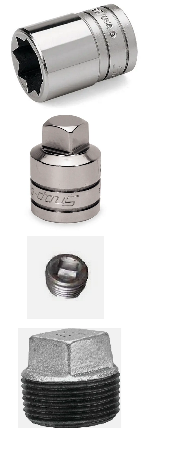

  2. Is there a special wrench/socket available for square head plugs? The boiler jacket makes this a “recessed “ plug that is inaccessible any other way than with a special tool.
    is the square drive raised or recessed?
    109A_5 Posts: 4,759
    There is male 4 point (square) and female 4 and 8 point (double square) sockets. There maybe other tools too.

    maybe slightly more if it is a raised square plug but you are probably cutting it out. take most of the middle out with a hole saw then cut 2 slots almost to the threads and knock the wedge out with a cape chisel.
    better installers will replace plugs with nipples and caps so they can be removed or are easier to cut out if needed.

    If they used Teflon tape it might come out with a standard twelve point socket and a very large breaker bar. Pipe wrenches or fifteen inch adjustable wrenches work sometimes with cheater bars (pipe). Unfortunately, after twenty years the heads have a tendency to snap off when you try to remove them.
    Like others suggested, plan on drilling and cutting the plug out.

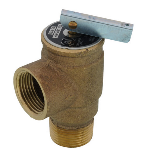

    You could temporarily remove the pressure relief valve as another access port to accomplish your task. Any Skim tapping ? Is the water excessively dirty ?
