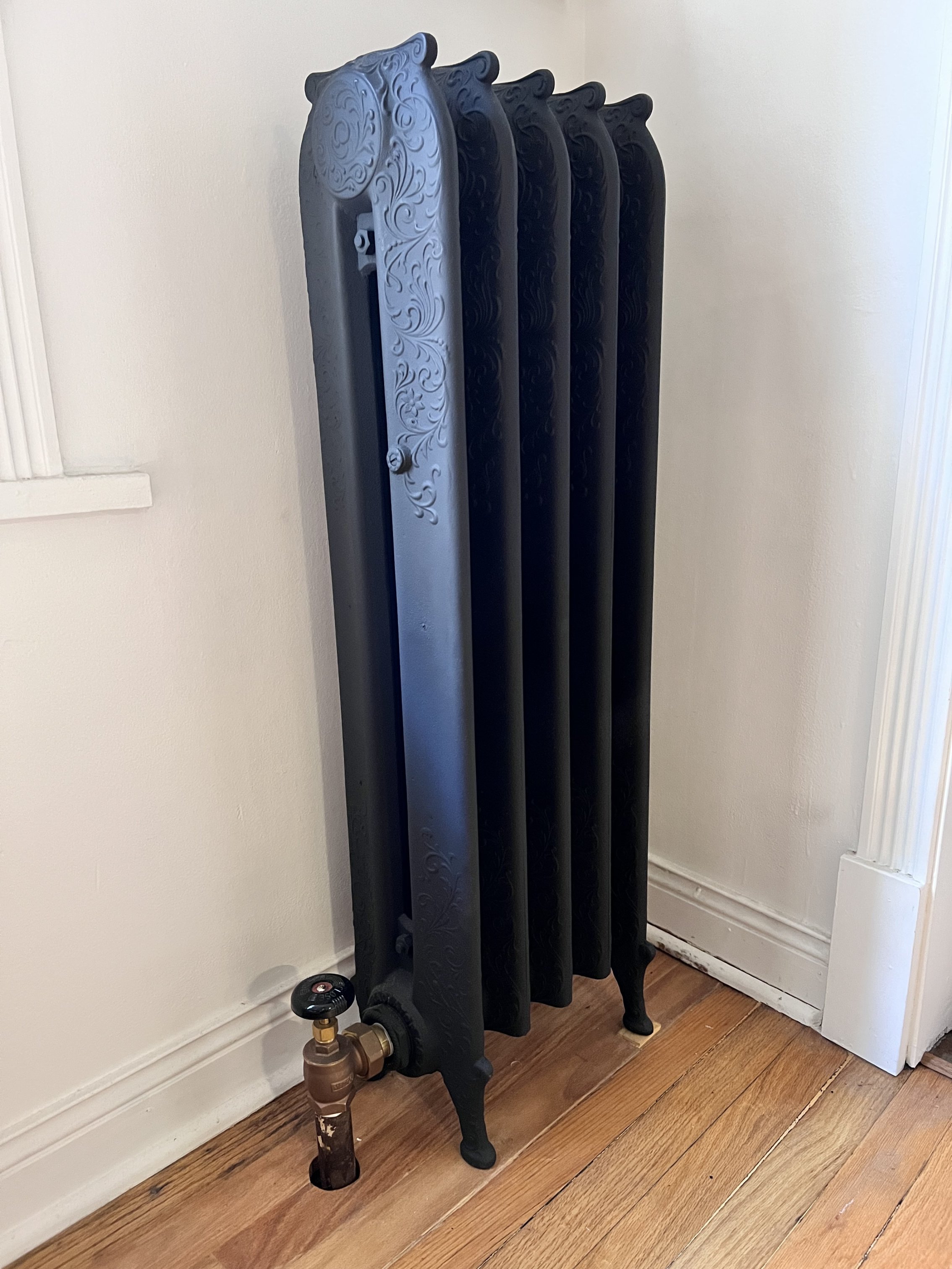

I installed a refurbished radiator over the summer in our bedroom. It was supposedly pressure tested by the supply house I purchased from. I ran the boiler and it makes this bird-like screech basically the entire time it’s on. I don’t think it’s the vent. It’s a vent rite #1 and no matter how I adjust it, the bird noises stay the same.
Is it possible the radiator has a hole? There’s no sign of a leak and I ran it until the vent closed and the radiator got hot all across. It’s under warranty for a year so I can return if necessary. I plan to switch to a different vent next call for heat but may have to wait until tomorrow so I don’t cook the upstairs tenants.

    this is the only one making noise. It’s not the same one as before. It replaced a cracked radiator. There were no system changes. The only other new factor is that I used 8-way boiler treatment over the winter and I’m using that treated water now. I will try running with no vents to see what happens.

    Ok ran it without a vent and did not hear anything. When about half the radiator was hot I screwed in a different vent from the first test, a MOM adjustable with the slowest orifice. When radiator was nearly hot all the way across I started to hear the screeching again.
    Some observations: the tapping for the vent seems to be run kind of deep. The vent rite had to screwed in all the way and kind of bottomed out. The MOM felt like it had a good tight fit before being screwed all the way in.
    Not sure if there’s a small hole that only leaks when pressurized?

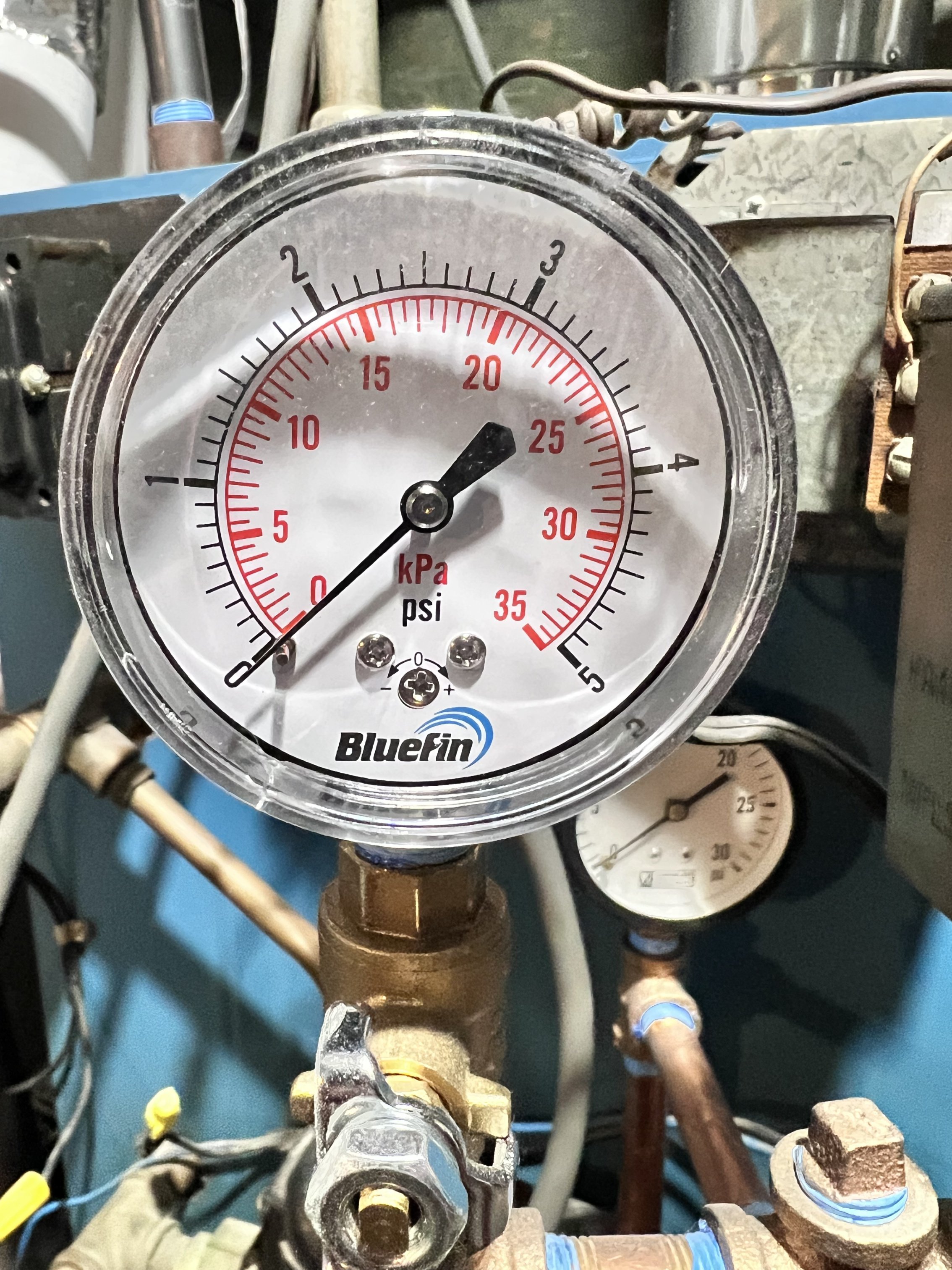

    And what pressure are you running your system at?

    @Jamie Hall as low as possible. Having no issues on any other radiators.
    Just asking — so often we hear of people running steam at a few pounds and wondering why it's noisy…

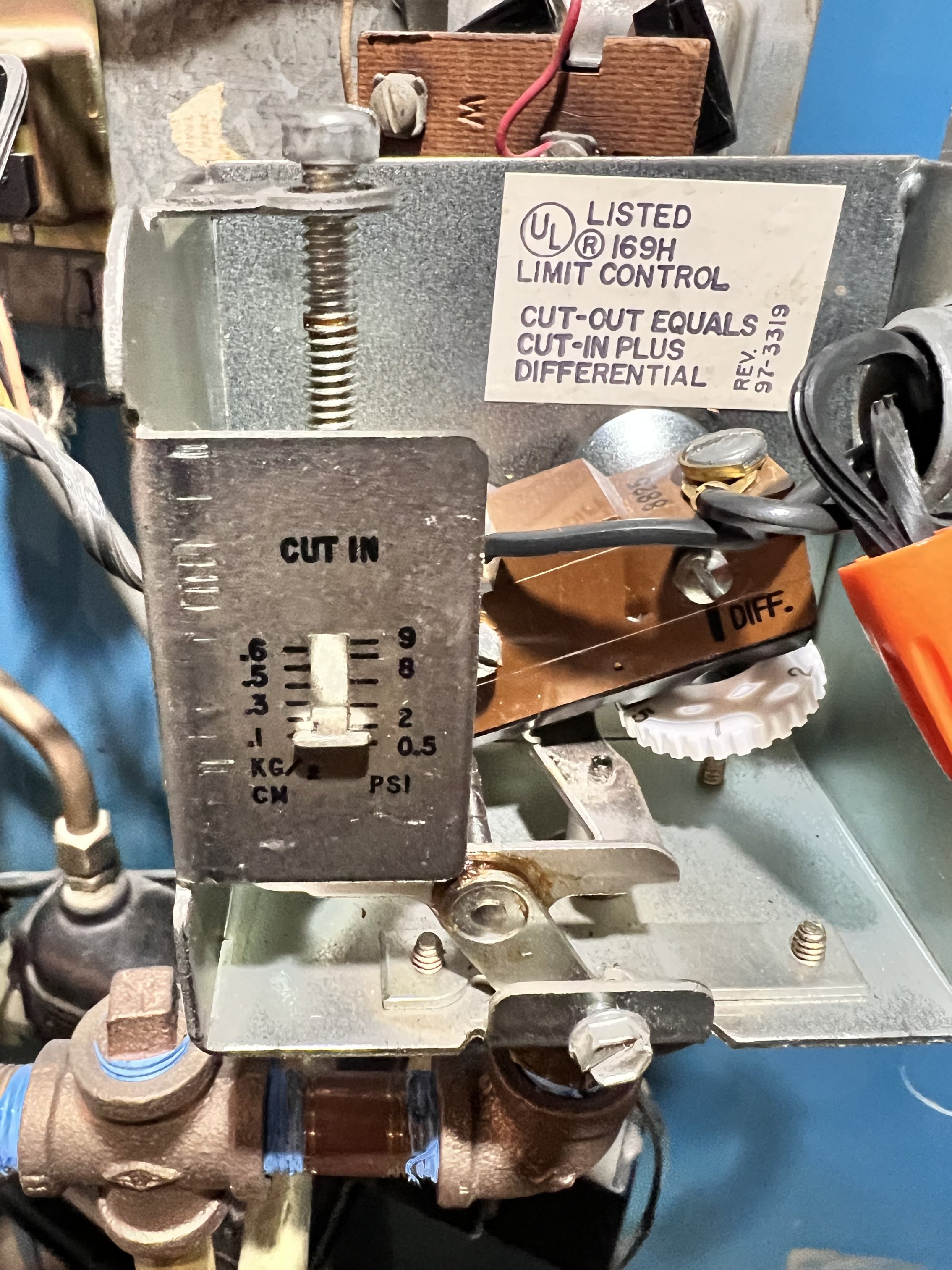

    Post a picture of the pressure setting on the boiler.

    3PSI gauge

    It’s a nice looking radiator too, the matte black rustoleum bbq spray finish turned out pretty good.
