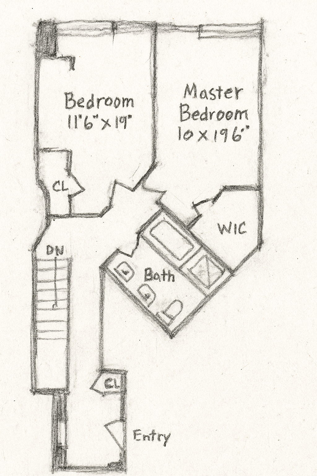

I have a question on BTU sizing for a PTAC unit I'm replacing. The room is 20'x10' with 10' ceilings. It's a master bedroom. There is a hallway and a bathroom adjacent to this bedroom that have no HVAC (its nyc). So maybe my tenants turn on the AC and leave the doors open to cool the place. IDK. I know there is a home office setup by the entrance door. The other bedroom also has a PTAC in it.
The windows are very large, but there isn't a lot of sunlight b/c of another building blocking it. And there are window treatments to block the light.
I'm guessing if it was just the bedroom that was being cooled, 6k BTU would suffice. Maybe you bump it up to 9k b/c of the hallway and bathroom.
The smallest PTAC replacement unit is 9K (they don't make a 6k), but the wait time is 4-6 weeks.
There is a 12k in stock but I think it might be oversized. I'd get issues with short cycling and humidity removal based on a google search.
There is no visible plate with the model # or BTU rating of the old unit. Even with the cover off, I can't find an identifying mark.
What would you guys do in this situation?
(Heat is provided via hydronic pipes which run above the PTAC. The PTACS fan blows on the hot copper pipes).

    units above, below, left, right?

    The 1 ton would be way oversized no matter how you look at it, my 800 ft^2 house in michigan is probably 1.5-2 tons. The hallway adds some load but unless you have a fan to circulate air between the 2, don't count on it adding much load. Even the 9,000 btu/hr will short cycle in that space but will probably be manageable.
