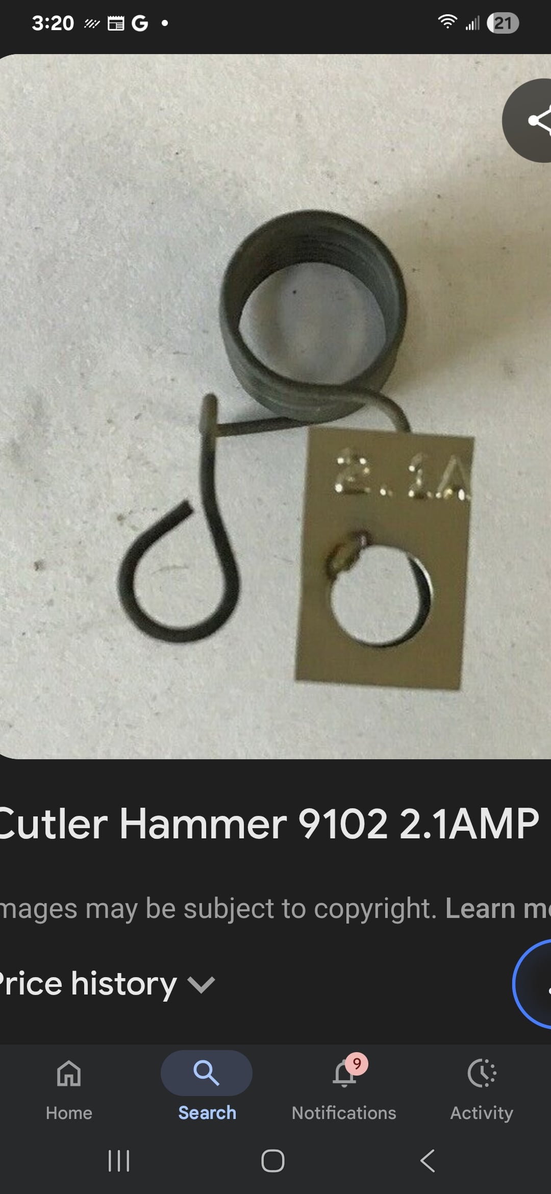

I believe this is a thermal overload relay… When i Jump out the two terminals that have wires going to them the pump and blower for the modine come on. I do know that the coil that used to be there has completely disintegrated ( i have a picture of a new one here with
different ratings but what should be there).. If i just eliminate this control and wire nut the wires together will that be fine?? or what would work as a replacement. Thank you in advance

    Sorry the first picture didn't load here it is
    the picture of the burned coil is not in this post, just a whole one that says 2.1 a.
