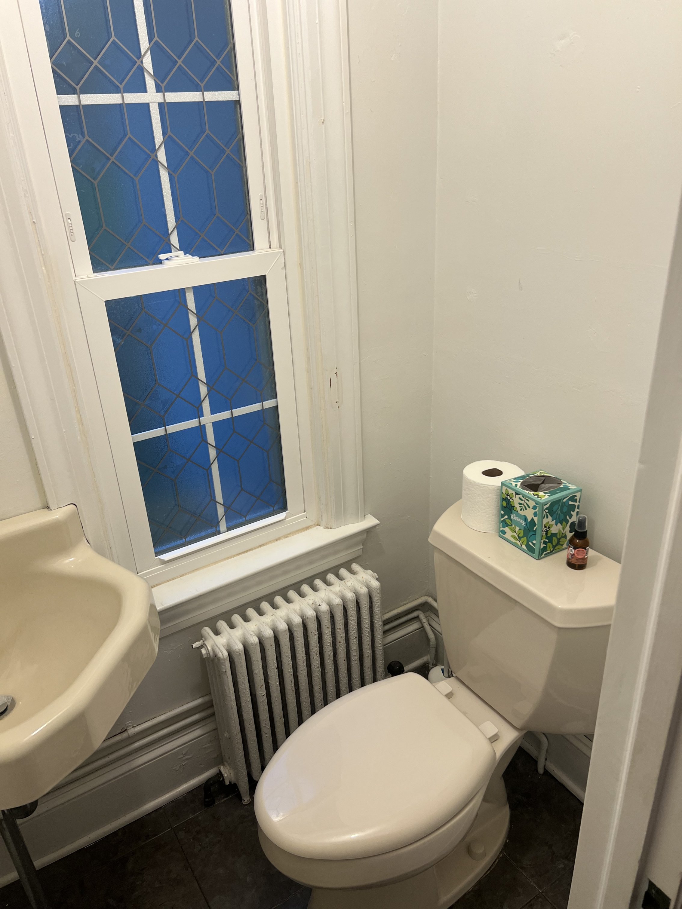

thank you, I just ordered one on Amazon. Luckily I only did two so far so I will just replace the spuds real fast tomorrow. I ended up getting an old rusted radiator sandblasted and powder coated for our bathroom. I wish I could do it for all of them in the house!
