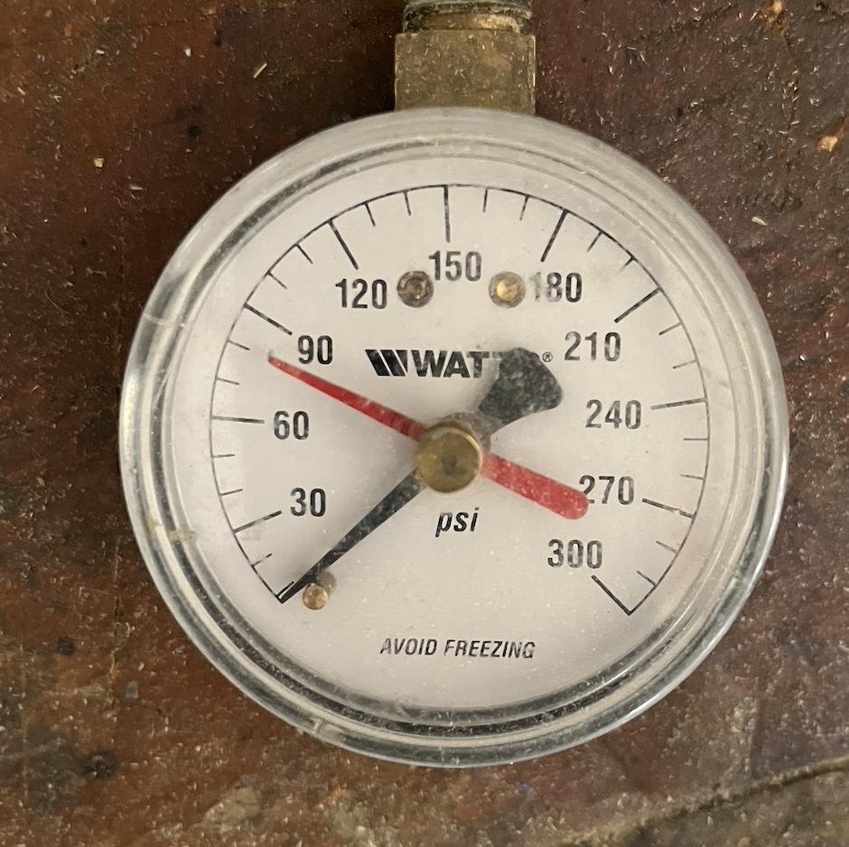

  • A plumber came today and checked the water pressure etc. He didn't find any problems. He gave me a pressure gauge and asked me to check the water pressure a few times a day. We turned the water back on.
    hot_rod Posts: 28,705
    A gauge like this on a hose bib will show if you are getting pressure flucuations.
    When the water heater warms, pressure increases ins the system. Some PRVs allow that pressure to go backwards through the PRV, that could be the noise you hear. Generally at days end when no water is being used, the water heater catching up.
    Is there a back flow device at the PRV? If so, have it tested and you need a thermal expansion tank.

  • I checked the pressure at the hose spigot two days in a row and it was 55. The noise hasn't happened again. Hopefully it was just a fluke. I heard it only in the evening so I noted this comment by Hot Rod: "When the water heater warms, pressure increases in the system. Some PRVs allow that pressure to go backwards through the PRV, that could be the noise you hear. Generally at days end when no water is being used, the water heater catching up." Is that normal and not a concern?
    If you have a pressure reducing valve or any other valve which functions as check valve between your water source and you how water heater, you must have an expansion tank on the hot water. It doesn't have to be that large, but it has to be there. Sounds as though your don't…
