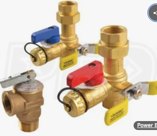

The install of my combi boiler had the domestic water side just done up with Pex off the boiler, a pair of ball valves and boiler style spigot valves for flushing. No "combo" valve. I'm not sure why, as the heat piping has the standard combo valves.
The domestic water combo valve kits come with a T&P on the hot side, which makes sense for a tankless water heater.
Does a combi boiler need that as well or does the PRV on the boiler side function take care of that?

    any time you are heating water you need a relief valve. i believe it needs to be a t&p valve but some application of boilers heating dhw can exceed the temp rating of t&p vavles and require pressure only valves.
    the dhw is isolated from the boiler water so it needs a relief valve before any valves on the outlet of the domestic side of the hx.

    Any water heating device needs a T & P or a straight pressure relief.
    A combi is basically just a HX and I don't think it needs a T & P.

    Um… it's very rare, but I have to disagree, @EBEBRATT-Ed . If there is any sort of check valve on the feed line to the water heating device — check valve, PRV, backflow preventer, whatever, you need at least a pressure relief valve on the hot side.

    I think they get just a pressure relief, often includes in the isolation valve set. I don't know there is a place where a probe would go in, as the T&P have temperature probe.

    What I'm calling the combo valve is the insolation valves in the above pics.
    It's on a well, there's nothing stopping backflow from the combi to the well pressure tank. There's just a check valve at the well pump. Well has
    How this all came about is I descale flushed the hot water side and was wondering why the heat side had a nice valve set but the hot water was kind of a janky setup with a ton of pex fittings. After finding the correct isolation valves, I noticed they all seem to come with provisions for a T&P.

    Just a relief valve…. nothing more.
    I have never seen a temp and pressure relief valve on the isolation valve set ups.

    Not sure what code says where you are but I have always sold and installed a relief valve with tankless water heaters. As others said its not a T&P though, just a P lol.
    I believe this cash acme valve is the one included with the caleffi tankless water heater service valve kits
    https://www.cashacme.com/us/en/temperature-pressure-relief-valves/fwl-2-pressure-only-safety-relief-valve
