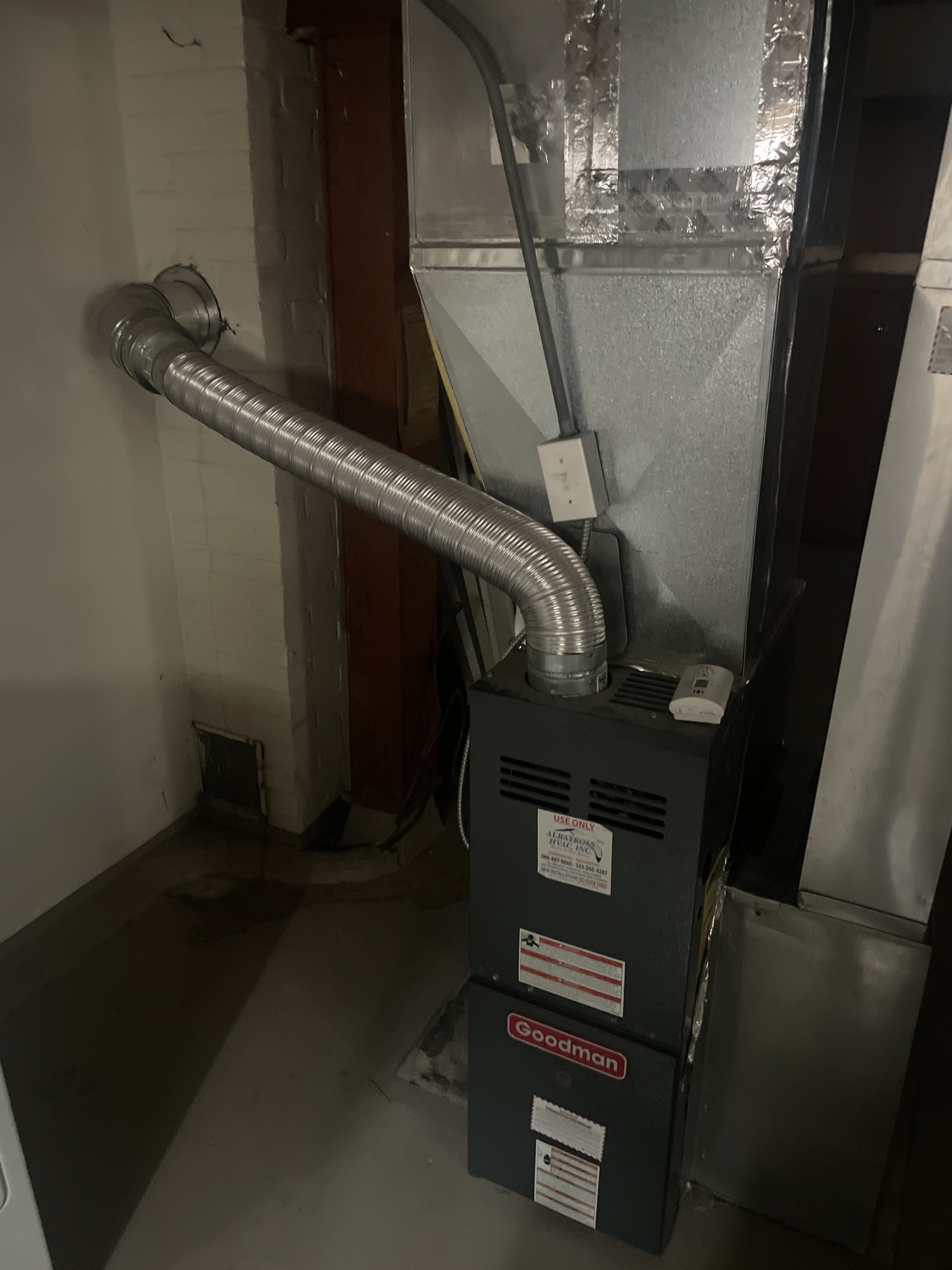

    PC7060 Posts: 1,980
    Glad I’m not here in winters with gas furnace running. Pretty sure dryer vent isn’t approved for flue gases.

    PC7060 Posts: 1,980
    I think @EBEBRATT-Ed has a post about this install…
    i think that is aluminum flue liner but i don't think you're allowed to use it like that.
    i like the co detector sitting on the furnace

    Not sure that is dryer vent, may be liner which wouldn't be allowed. There probably is some type of flex that is approved.
    Gues they couldn't afford an electrician or even straighten out the conduit looks crappy.
    My grandparents' last condo that was built in the early 200'0s had about 4' of flex floating in mid air down to the junction box on the furnace. If i remember it had ctss kind of draped down to the furnace and the sheetmetal looked like crap too. I remember opening the door to the utility room and thinking this is a proud day for all of the trades.
    When i visited a few years later he said the ac didn't work. I didn't know a lot at that point and i just looked wile walking past or waiting for others, but i was able to unscrew the caps to the service valves by hand so I'm pretty sure the refrigerant escaped because the installer didn't tighten the caps. he seemed kinda confused when i said i thought that was what happened. He was the one that when I was a kid patched the evaporator of their basement fridge that was gouged with a spatula with epoxy putty and charged it with a can tapper and some freon 12 from the auto parts store when i was visiting(without evacuating it but it worked until they moved a decade or so later). Now that i think about it i think he also punched a hole in the can in the process because he was trying to attach the can tapper without retracting the needle. Probably because he was old enough that he couldn't see small things anymore at that point.

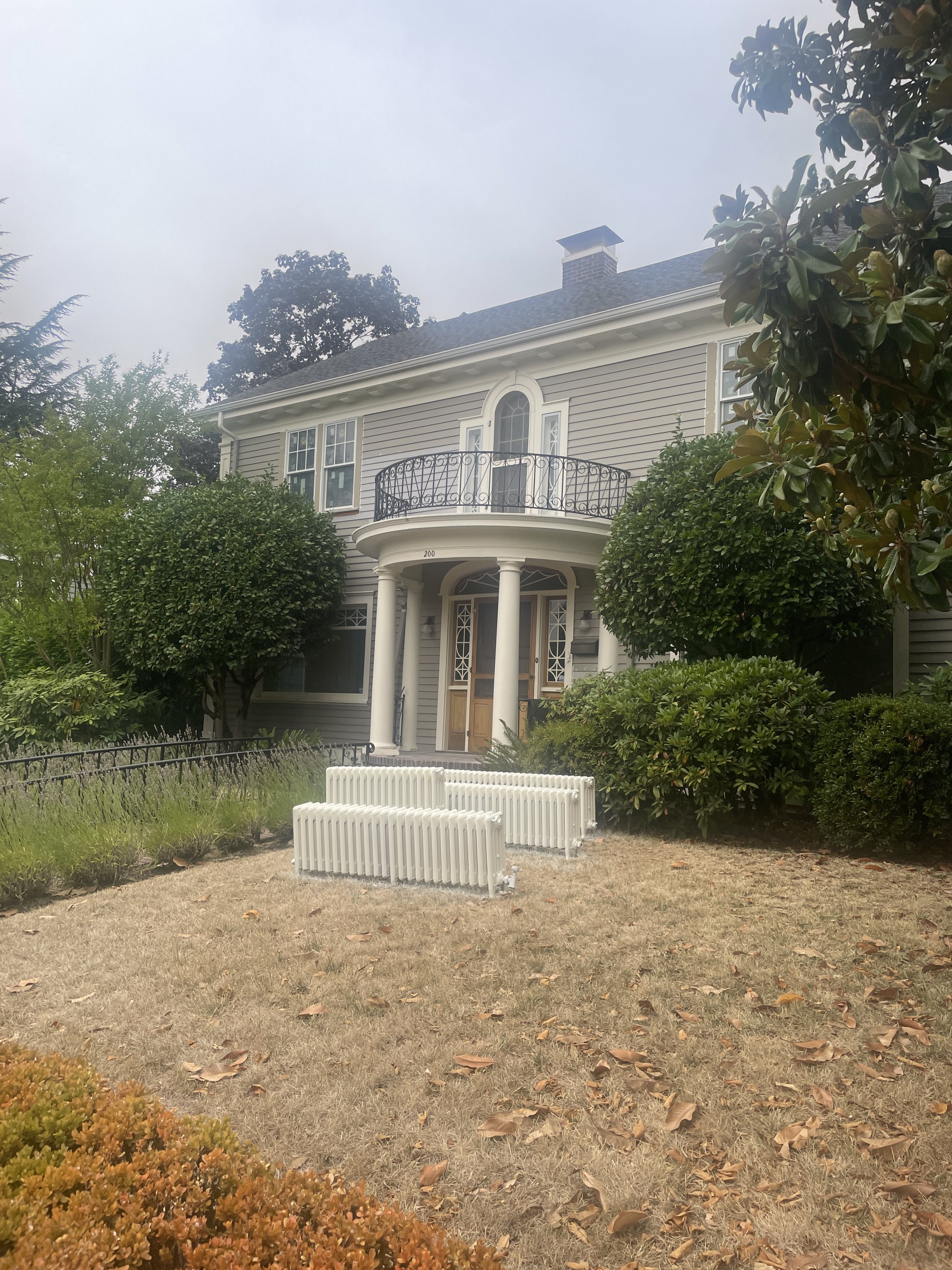

    PC7060 Posts: 1,980
    Saw this is same neighborhood; radiators being repainted during house renovation. Makes a change from the typical throw away jobs.
