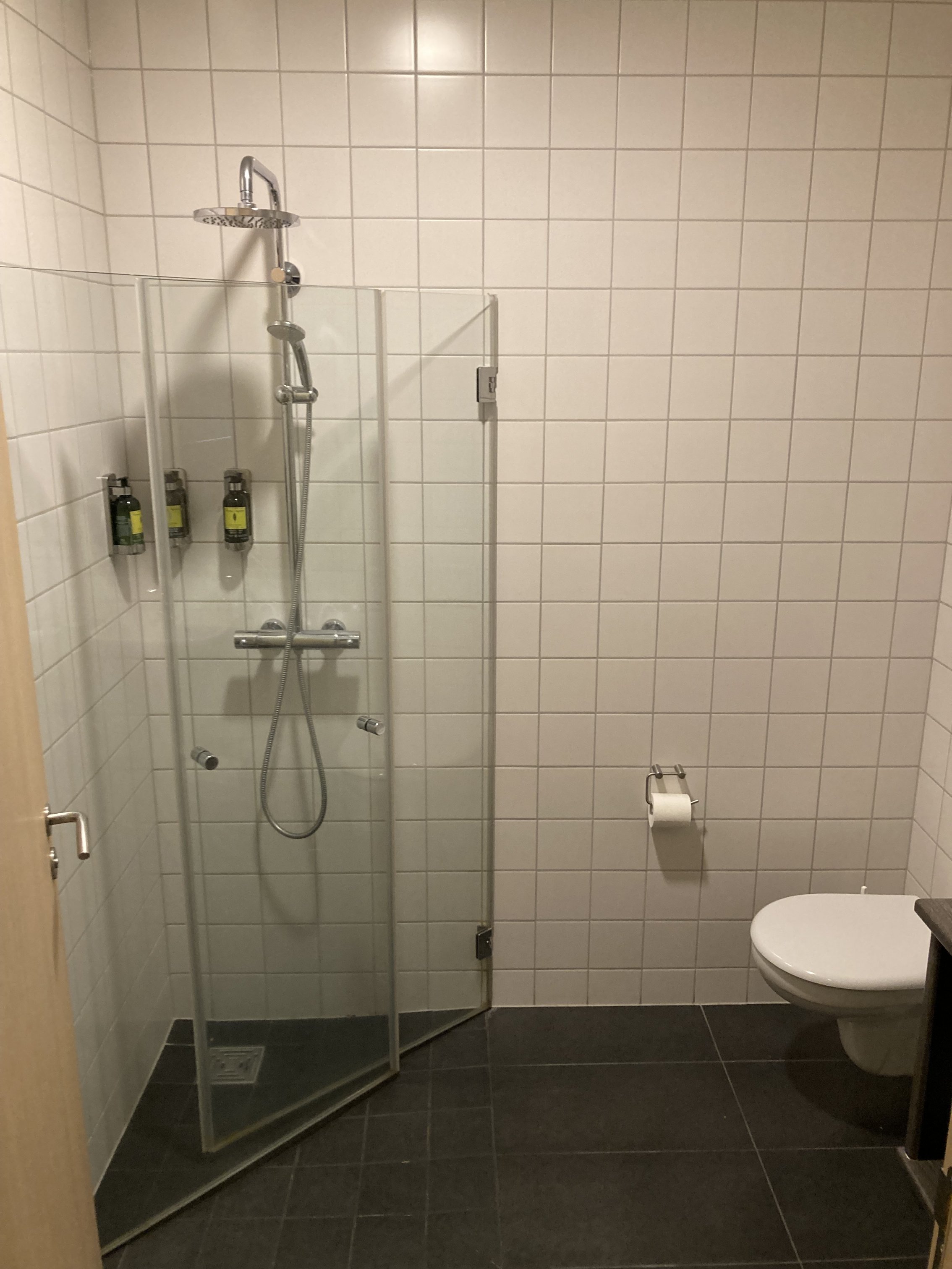

    There were clever shower configurations I saw in Europe for small bathrooms.
    This was simplest with shower panels folded in when not used to make space. Saw this configuration with curved panels as well
    GWTonKaGeosman

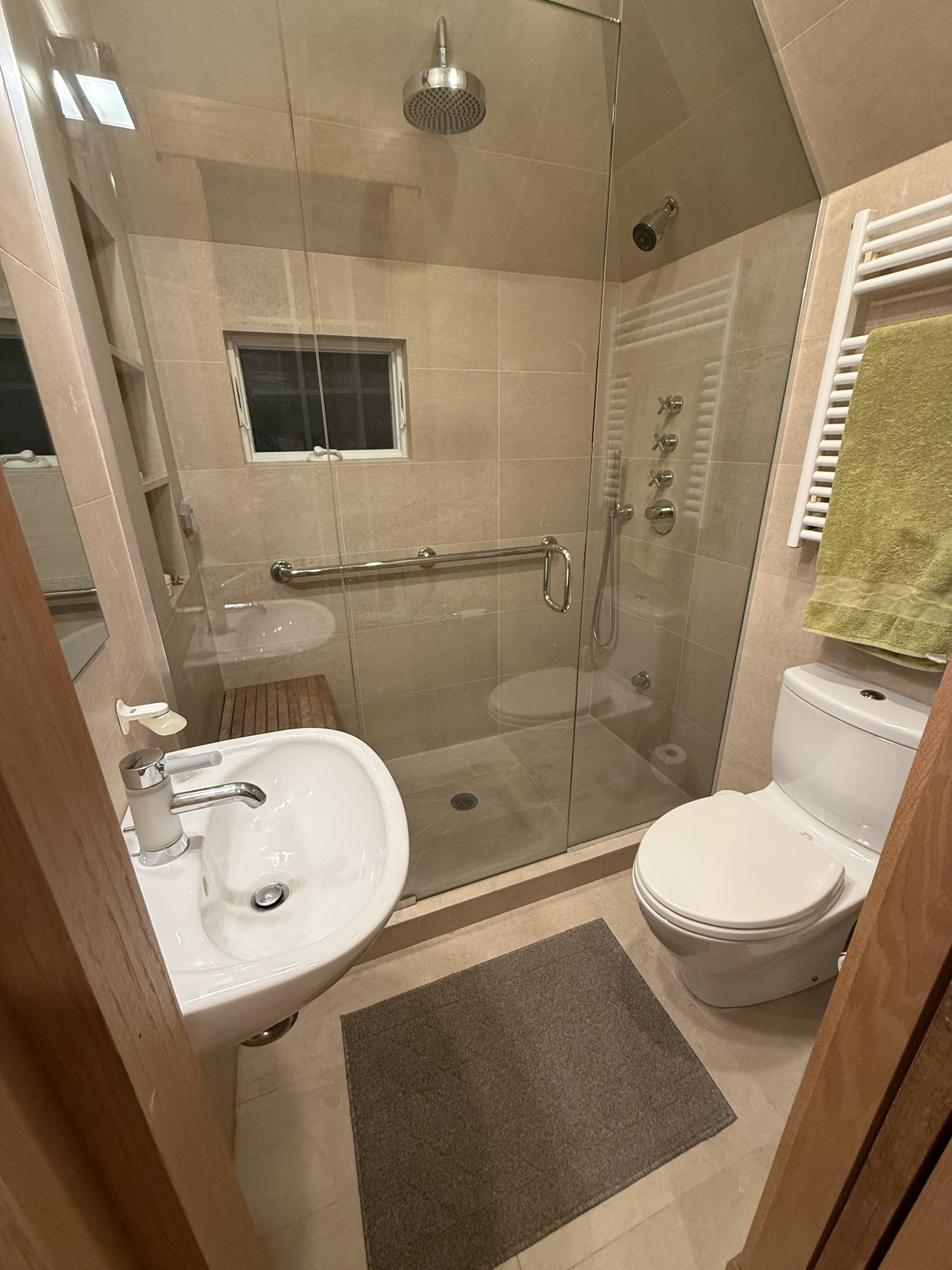

  • I’d ditch the tub. Ever been on a cruise ship or in Europe? Like others said is probably do toilet/vanity on left wall corner shower on the right.
    they even do curbless shower stall with floor drain
    this bathroom is 5' x 5'. very comfortable and easy with a pocket door
