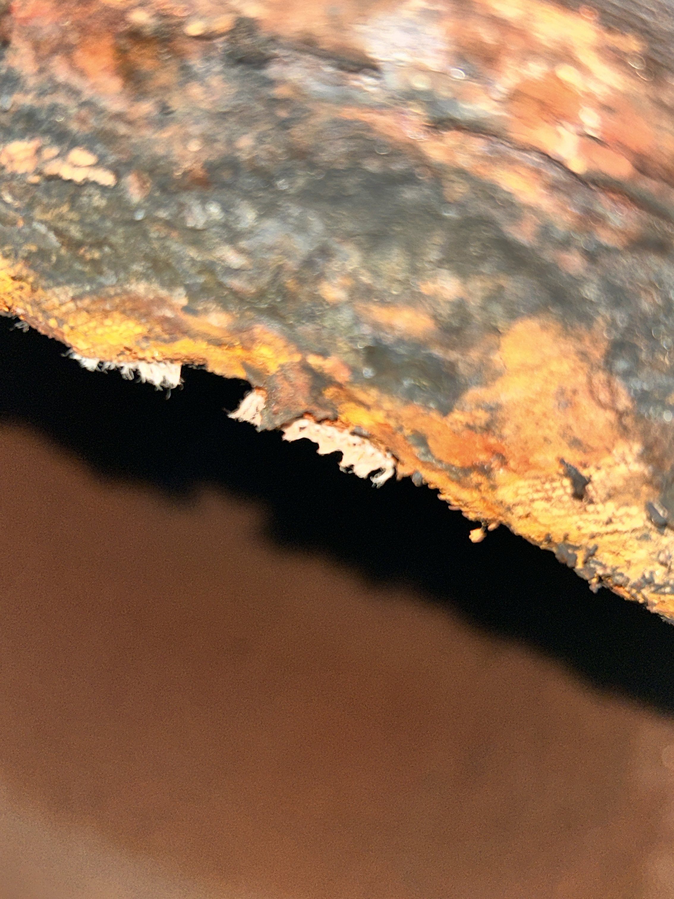

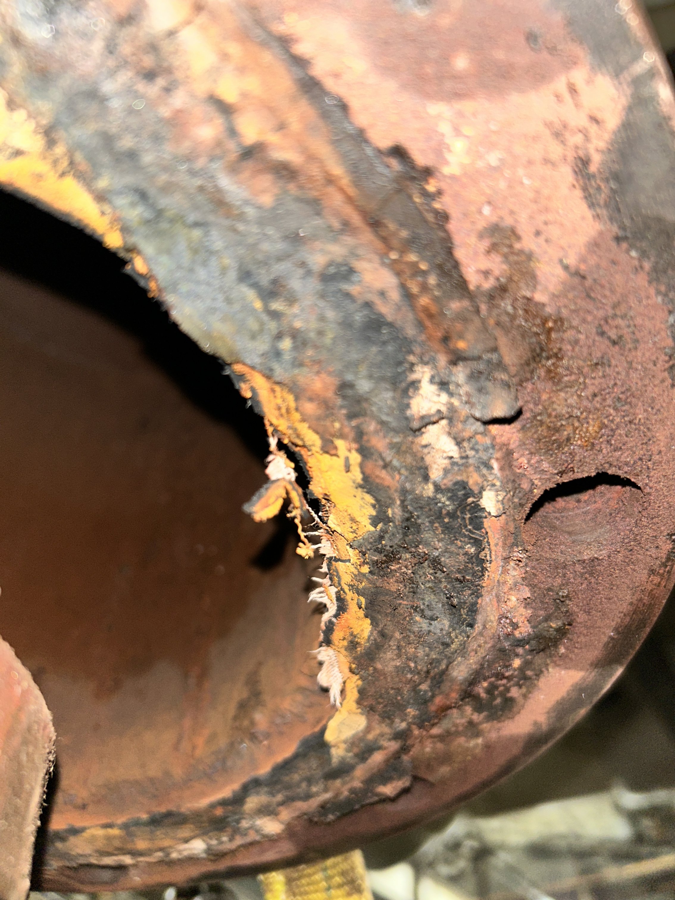

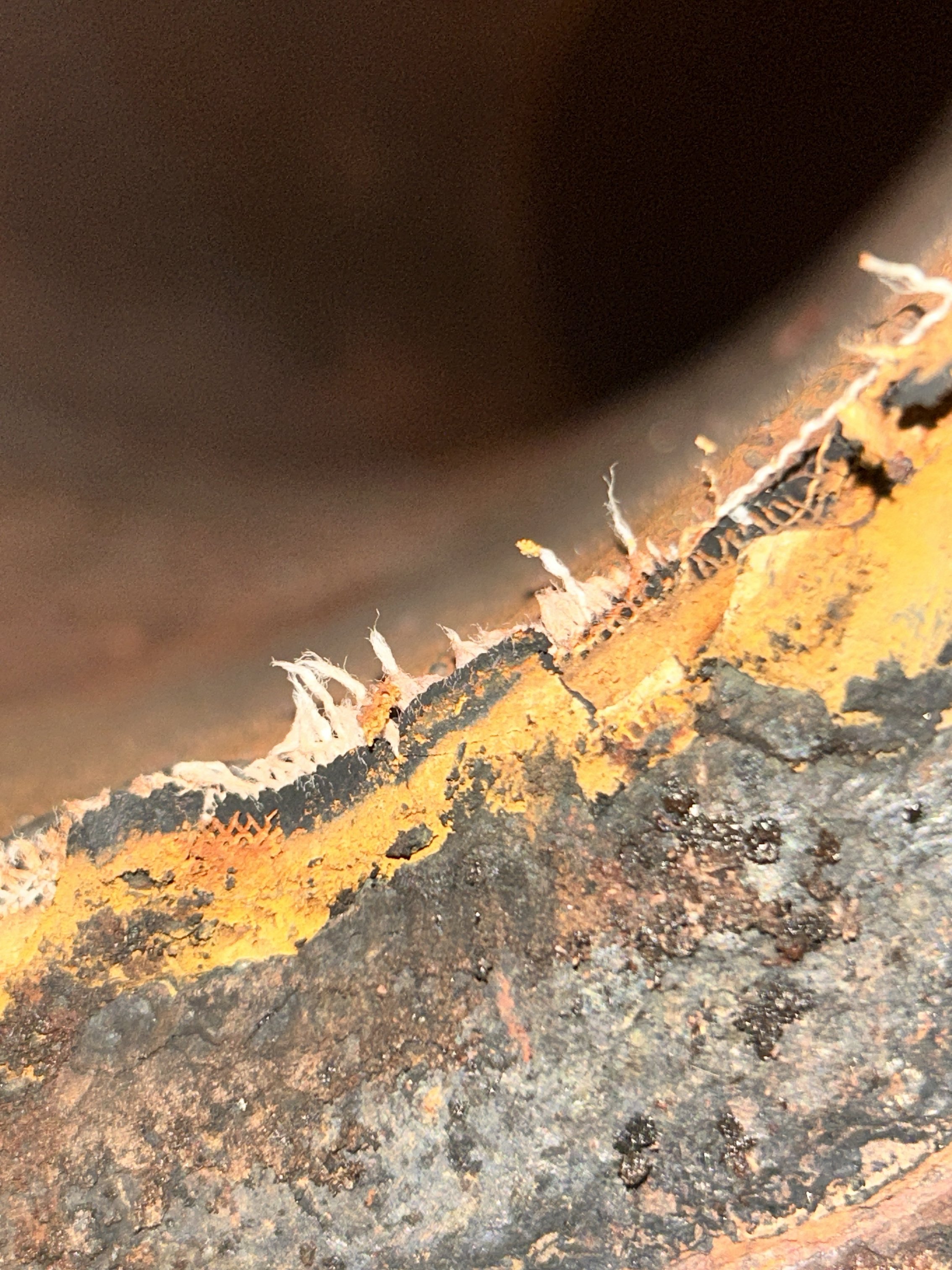

Trying to replace a flange gasket on this old Weil McLain. Looks to be some white fibrous material lining the gasket. Could be asbestos but not sure. Anyone seen this before?

    Have to have it tested to know for sure. Could be asbestos, could be cotton or wool or something like that.

    It is composition sheet gasket. there were all sorts of formulas, some that used asbestos as the base, some that use other fibers. It is like caulk or roof cement or glazing compound or spackle/joint compound. There are all sorts of things mixed in them.

    without having samples analyzed there is no way of knowing.

    When in doubt,treat it as ACM (Asbestos Containing Material). Mad Dog
