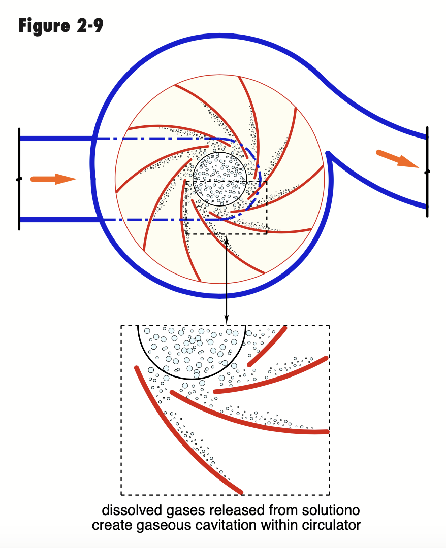

    Pumping away allows the pump pressure differential to be "seen" or added to the circuit. Really no need for that in a recirc loop. The recirc pump just needs to move enough gpm to over-come the temperature loss in the loop
    Rare but possible on a very low static pressure and very high temperature that the pump would lower pressure below vapor pressure allowing it to flash. Typical recirc pumps are not adding but a few psi ∆P
    Maybe massive amounts of air/ gasses in the water could cavitate a pump, but it takes a lot to cavitate those small output recirc pumps. Even choking down a balance valve on the discharge side rarely cavitates them.
