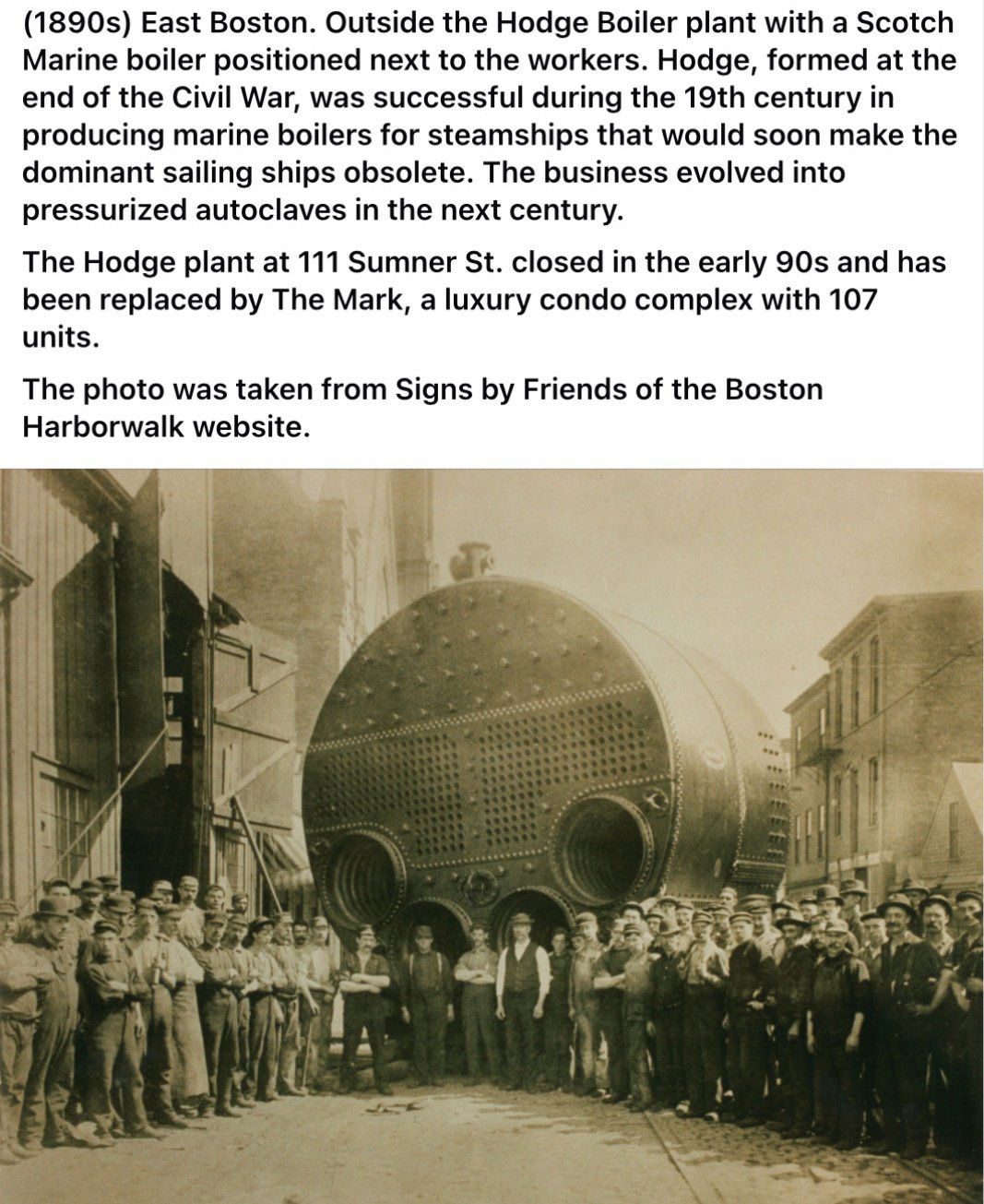

Hodge Boiler Plant Photo (1890s)
Thanks to our friend Steve for sharing this piece of history with us!

    Can you imagine the noise created from doing up all those rivets?

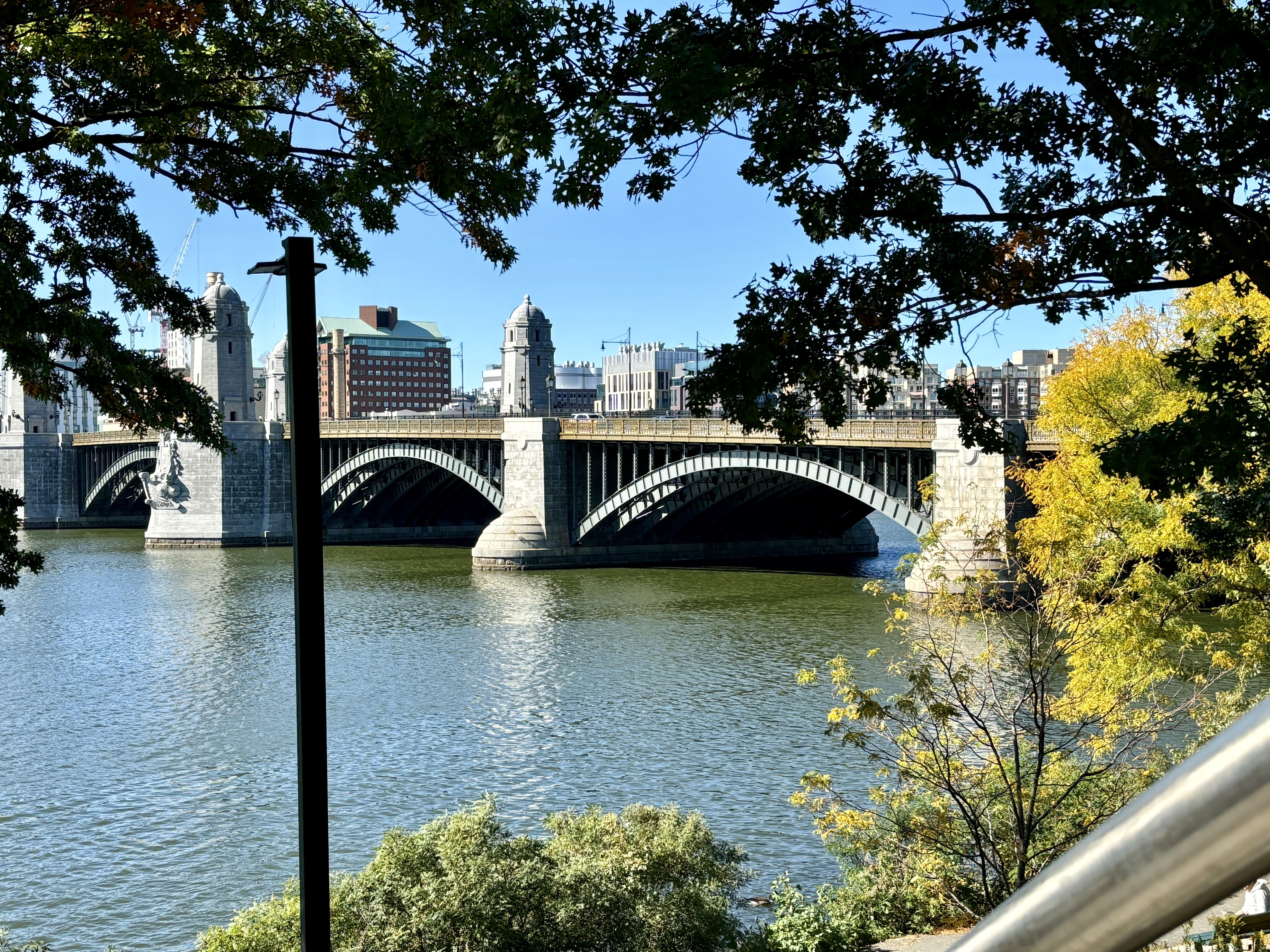

    When they rebuilt the Longfellow Bridge in Boston a few years ago, they trained ironworkers in old school hot riveting because they wanted to keep the historic construction accurate. They did a beautiful job, too!

    They had steam or pneumatic hammers to set the rivets depending on when it was built. They had steam/pneumatic drills although most of the holes were probably punched with huge presses in a shop.
    I cut up and removed an old Scotch Marine boiler about 8' in diameter and 20' long. Not nearly as big as the one in the picture. That is a monster!!!!!
    The one we cut up (into 2'square pieces) was made in 1929 and was all riveted although welding was starting around WW I it took a while and WW II to really get it going. They ran at 100PSI steam. It was a Dillon Boiler I think
    The boiler shell was 3/4" plate. As I recall the two plates butted together and it had a 5/8" plate on the inside and another 3/4" plate on the outside with rivets going through the whole mess. We cut it all with a torch and that's where I really learned how to cut with a torch
    I just can't imagine fabricating that back in the day with the conditions they worked under and the tools they had or didn't have.
    Never saw a Hodge Boiler but I remember hearing the name.

    Will "The Mark" have a cool picture like that to show in 100 years? I think no. That picture should be in the lobby.
  • What a fun time to work back then. You can just see all the smiles and happy faces just ready to get to work that day. Makes it hard for me to complain about bolting or push nippling a sectional boiler together these days. Harder but not impossible. I'll still cry about it Not that anyone cares
