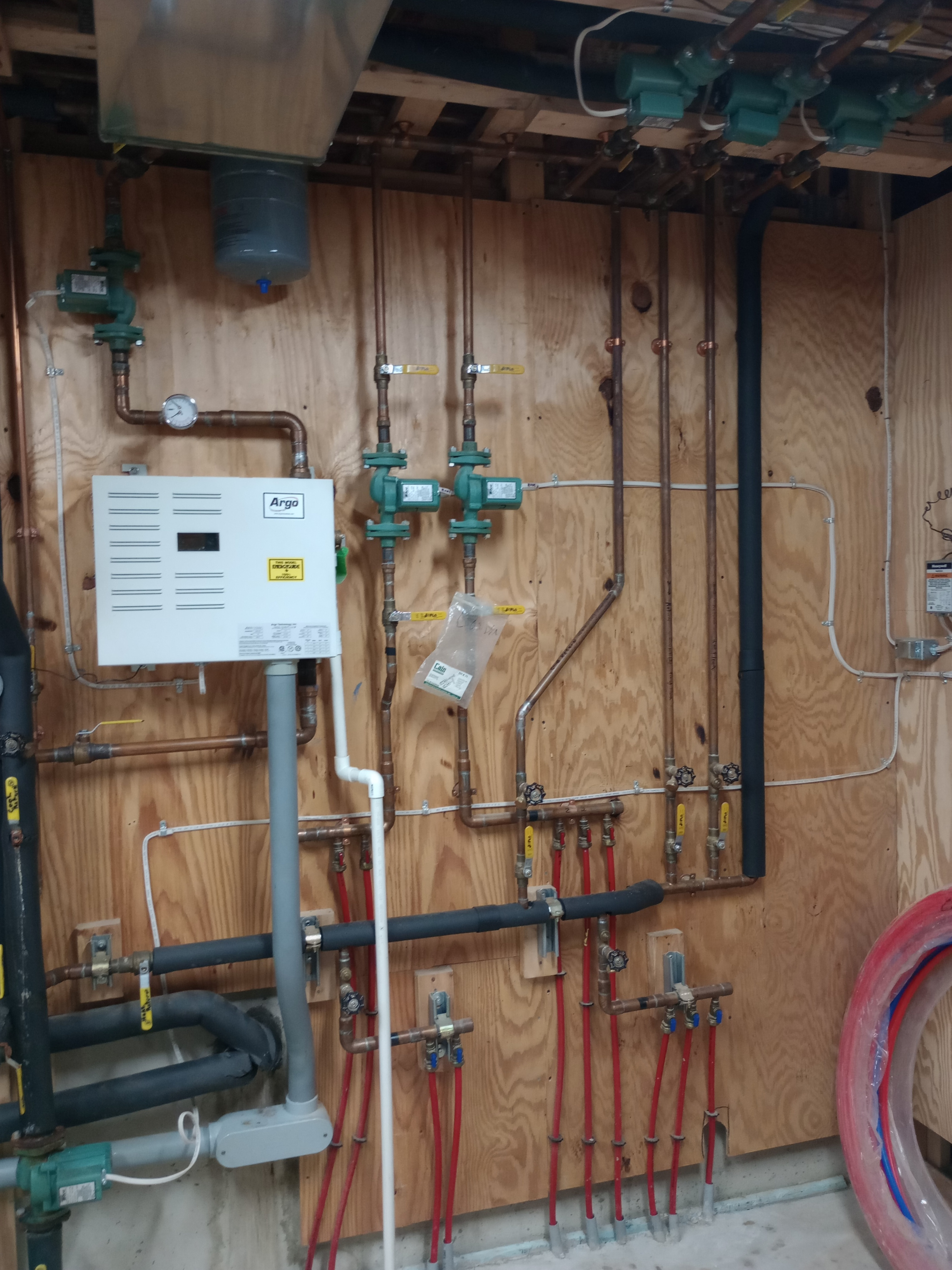

I need to replace my waterfurnace water to water geothermal heat pump (EW042) and the prices I've received to replace are eye popping. The lowest quote I've received was $$$$$. This was to replace with a waterfurnace 5 series 3d, geoflo unit and add a 80 gallon buffer tank (original system wasn't installed with one). I am hesitant about replacing the system because it has never performed very well and it's really noisy ( installed in basement directly below the master bedroom). Output has been nowhere near spec and the installing contractor could never give me a straight answer as to why. We have a 16kw backup electric boiler that switches on at an outdoor temp of 30 degrees otherwise the heat pump cannot keep the water up to temp at 110 and will go into freeze protection.
My current setup is 4" slab in basement and 1.5" gypcrete on the 1st and 2nd floors. All 1/2" pex. 5 zones using 007 circulators. 2 zones in basement, 2 zones on 1st floor and 1 zone on 2nd floor. I didn't have a heat load done when we built in 2007. I had energy vanguard do a manual j and i did have a blower door test done at beginning of 2025. Energy Vanguard came up with 25000 btuh roughly for whole house. I did my own awhile back and came up with 34000 btuh for whole house.
So I really can't afford $$$$$ right now. So I'm wondering if it would be worthwhile to switch over to a lp combi boiler or lp boiler with dhw? Or hang on a little longer and save some more $$$ and replace at a later date. Ive received a price of $7500 for the combi boiler working with current circulators and piping.
I would probably just install a unit for ac using the current ductwork.
Does anyone have any ideas of the best route to go?

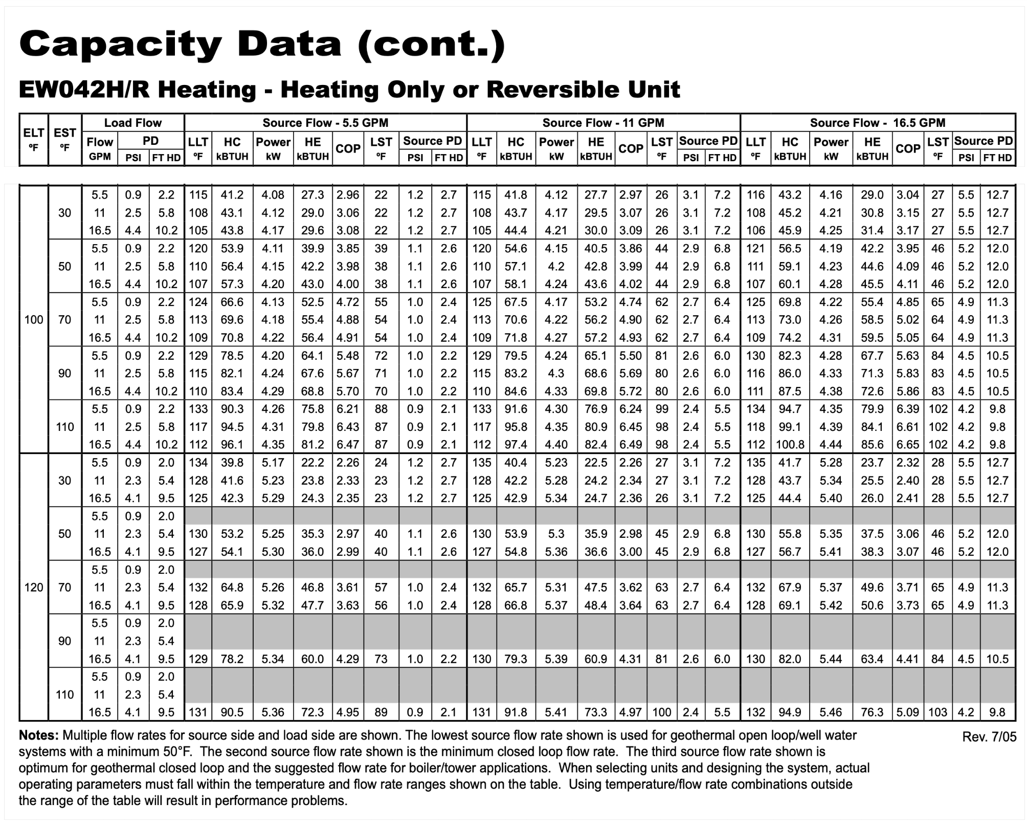

    If your WSHP is 3 1/2 tons which the model# looks like you need 10.5 gpm minimum on both sides of the unit. Call the well guy back and ask him if that is reasonable flow for what he installed. Is this a closed or open loop?

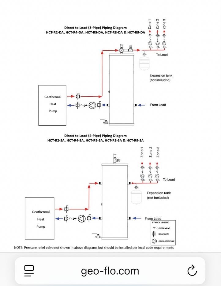

    They also have drawing of how to install with a back up boiler and a buffer tank

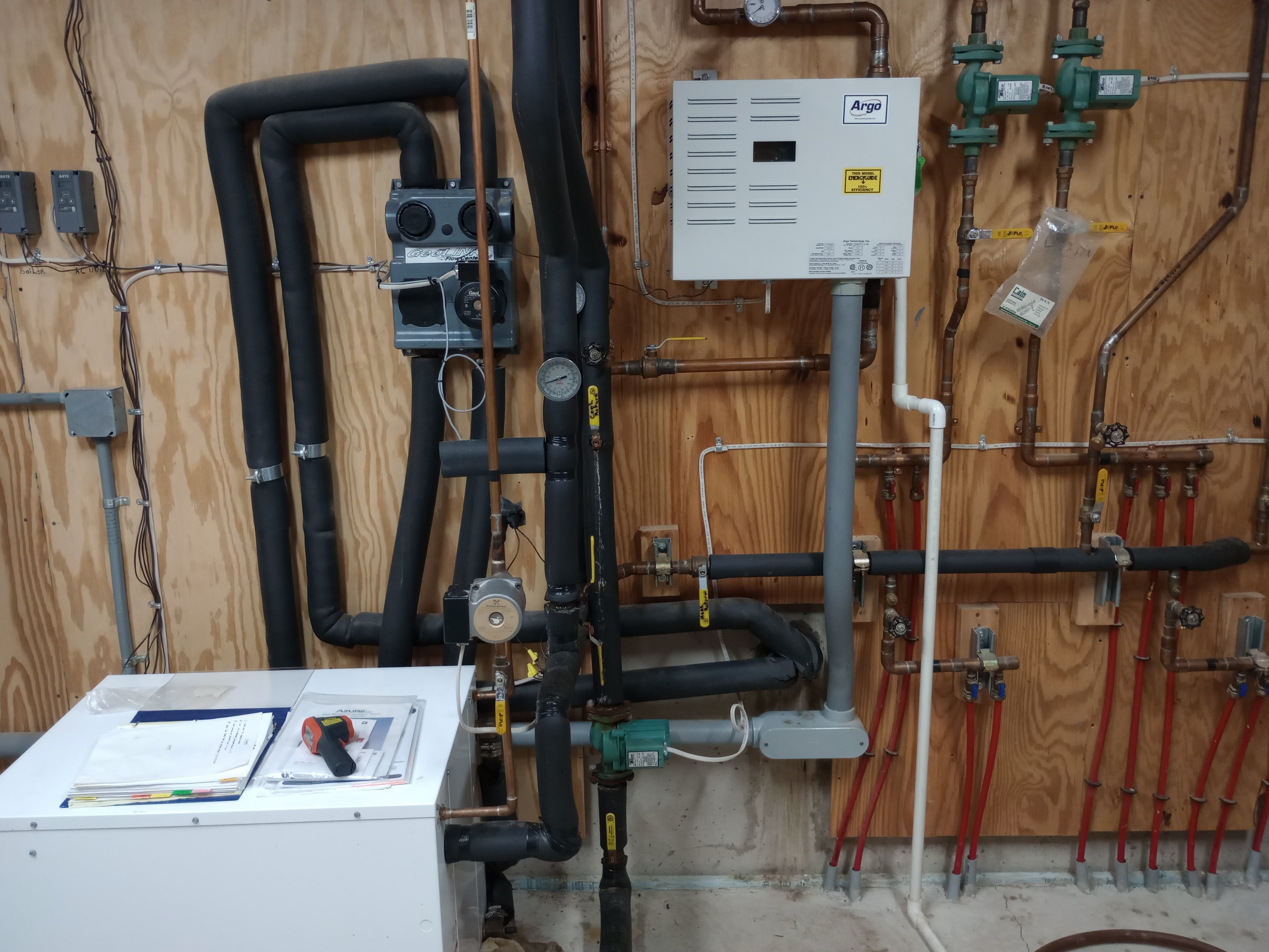

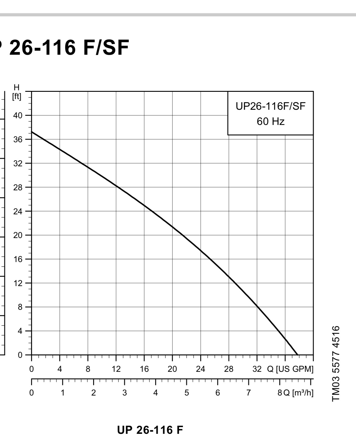

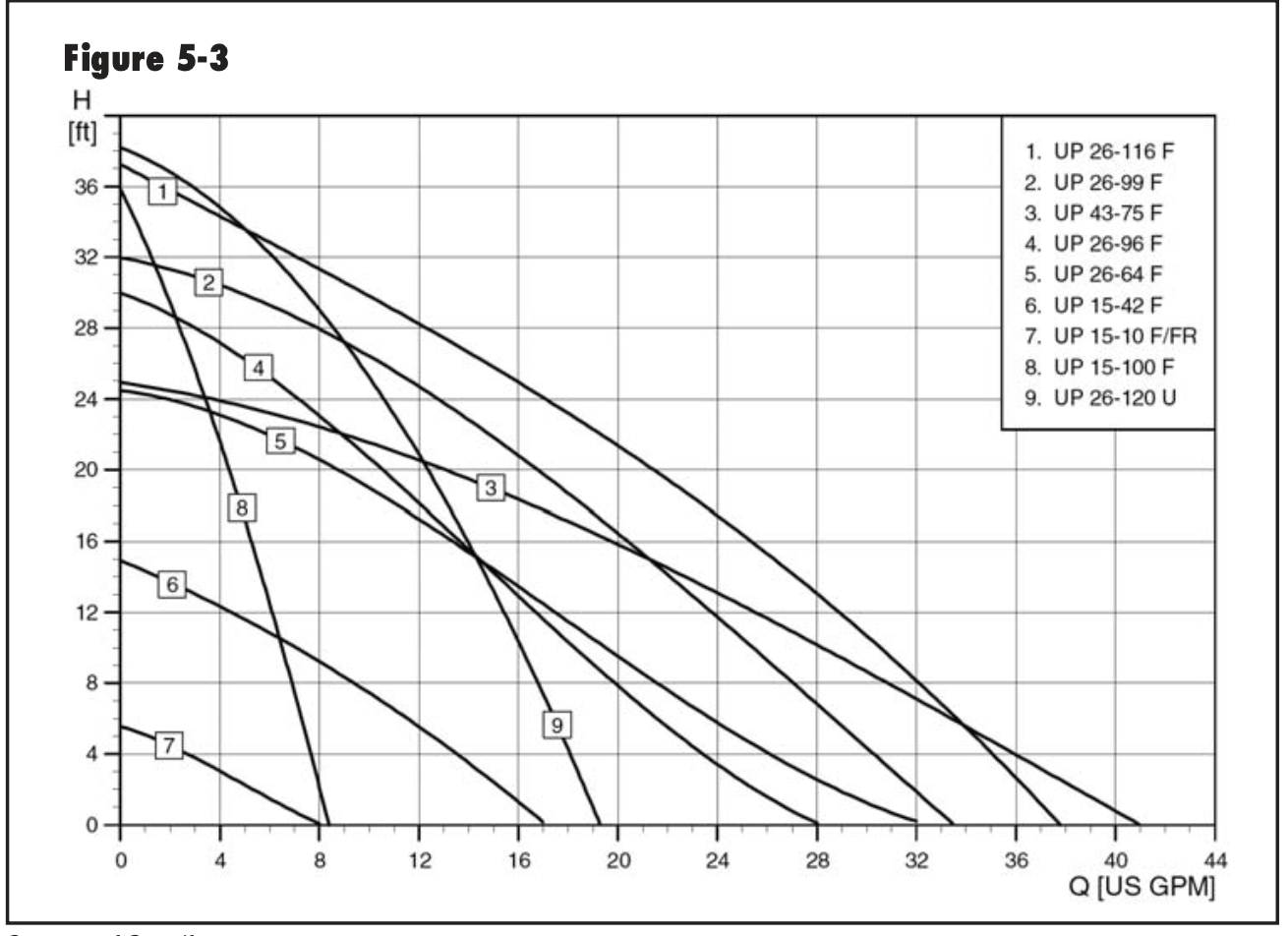

    A lot of times commissioning is not correct. Turn up the geo side pump speed if you can. Turn up all the pump speeds while you are at it for troubleshooting. The picture may not be representative, but I see many valves shut and a couple zones and pumps isolated.
  • klowden
    klowden Posts: 38
    This heat pump cycles on temp. In heating mode it will run until it satisfies the set temp which i keep at 110 in the winter, then the unit will shut down and go into a 5 min delay before it will cycle again. It will continuously do this cycle regardless if there is a heat call or not. In cooling mode it will run to 50 degrees then shut off the go into an antishort cyclw for 5 min before it will kick back on even if there is still a cooling call. It will however not continuously cycle like it does in heating mode. It hasn't run all day today since the weather is cooler. So once this thing satisfies set water temperature it shuts down.
    All the circulators are fixed speed including the geoflo circulator so there is no way to adjust as far as I know.
    I had the valves closed in the pics for winter for the basement loops because it will get to 85 degrees down there because there are no check valves anywhere in the system. So anytime the system pump is running and the unit is heating water it is siphoning hot water to every zone regardless if its calling for heat or not. At least thats my opinion. If you grab the supply piping in the basement where a zone isn't calling or hasn't called the pipe will be hot.
    This has always been an issue with our master bedroom which faces sw being way to hot in winter especially if the sun comes out for a little bit.
    mattmia2 Posts: 18,261
    It looks like it is 3.5 ton and single stage so it needs to move enough fluid on both sides to move that much heat.

    It should be piped primary secondary and there should be flo checks in the circulators or separate flo checks for the zones. It looks like it is just pumping in to the manifolds so it might not get enough flow through the hx in the heat pump. It may be blowing past the flo checks because the circulators aren't isolated.
    what are the return water temps out of the loops and to the heat pump?
    does it short cycle if you open the closed zones?

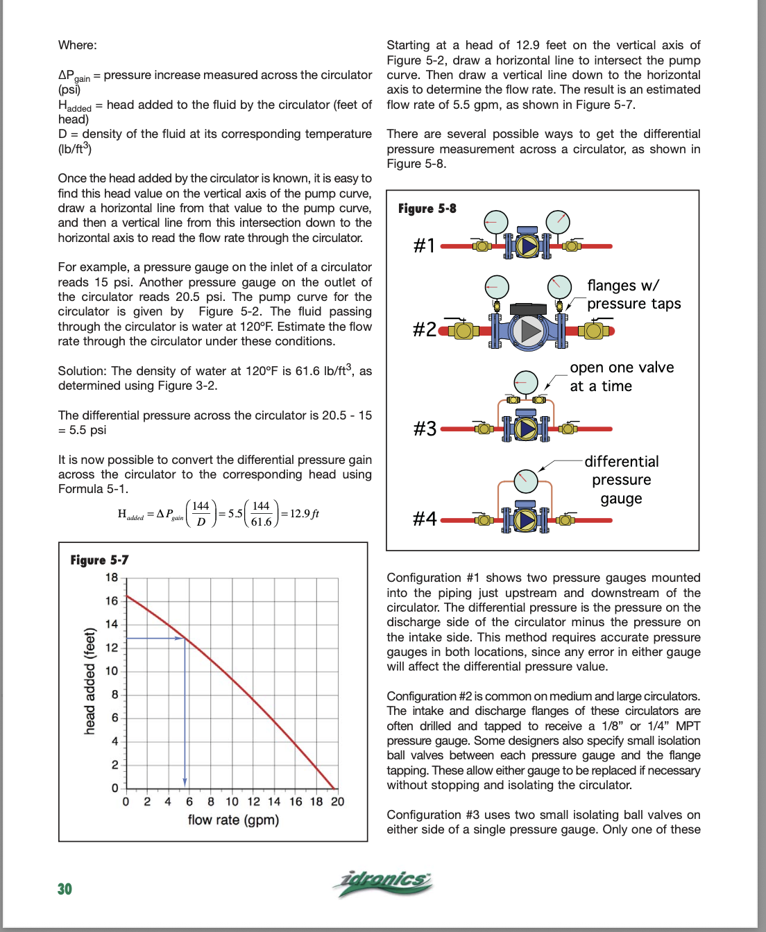

    This winter i checked and was getting an 8 degree delta t and 2 psi pressure drop on the well side of the heat pump. I did not however check the supply and return temp delta or pressure drop on the load side at that same time. But I think I may yave found a geo guy that is supposed to be very knowledgeable come out and do some testing on the system.
  • klowden
    klowden Posts: 38
    I could not find any p/t ports on the load side to make that happen.
