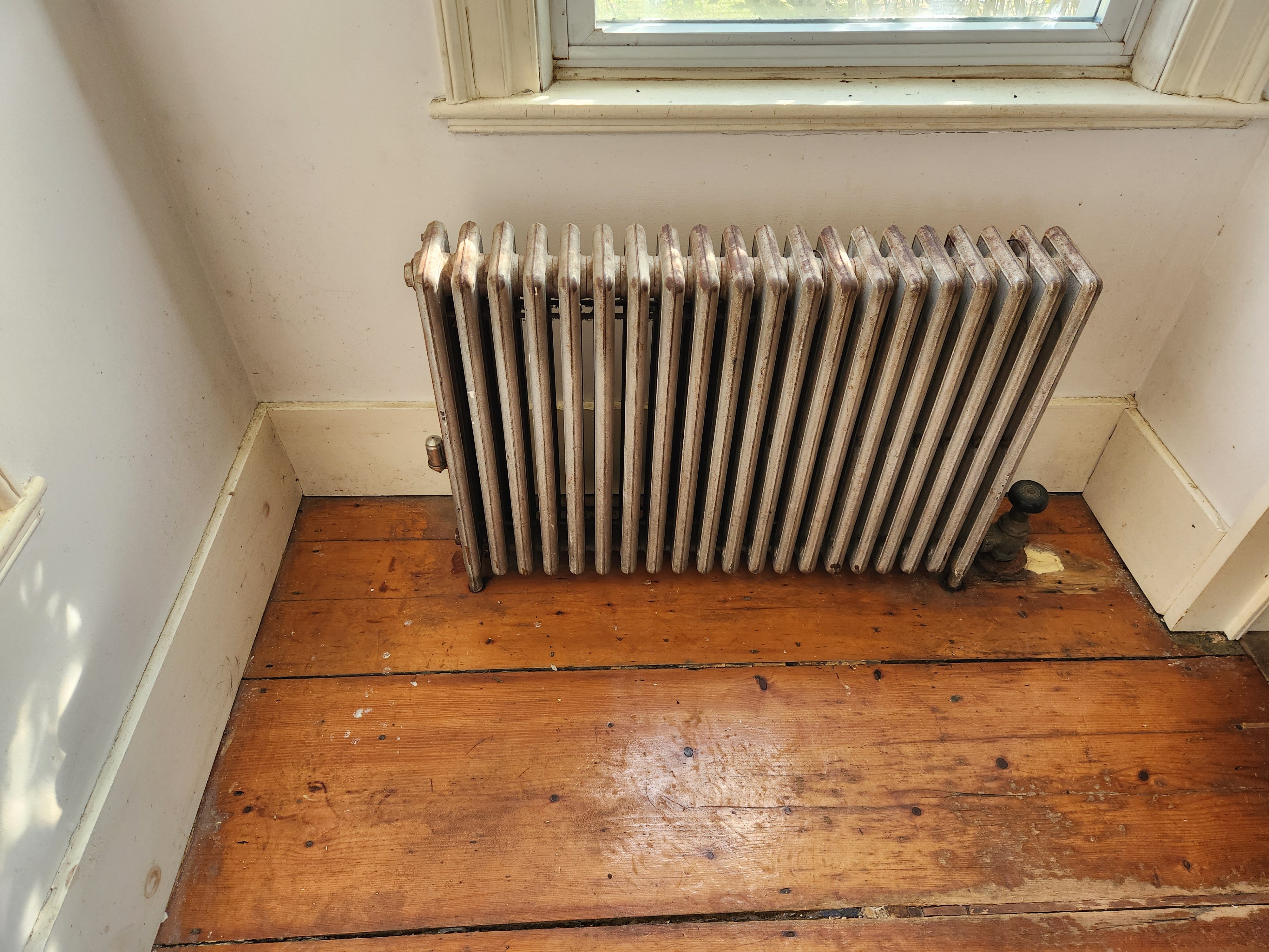

I've got single piped thin tube radiators I think are currently hot water. Boiler will need replacing. I'm hoping to find someone local to Barre VT that can help me with this sytem.
Any guidance or leads woulds be most welcome. So far I'm beyond the service range of those I've found.

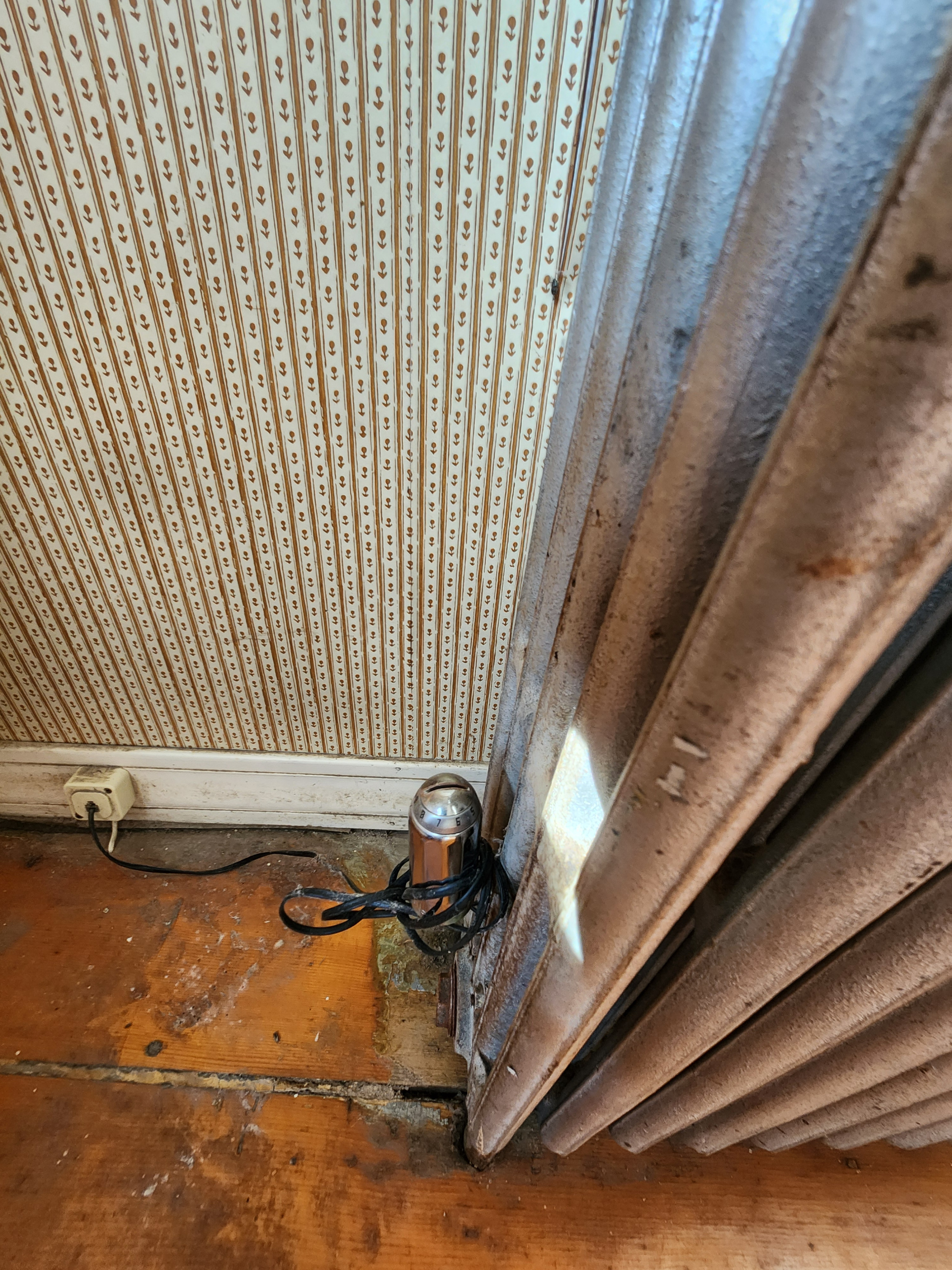

    @CMartinBarreVT , if there is only one pipe connected to the radiator, and an air vent on the other end, it's one-pipe steam.
    Semi-retired
  • @Jamie Hall Woah! You're quick! Thanks. Will follow up with @Tom_133 🙌

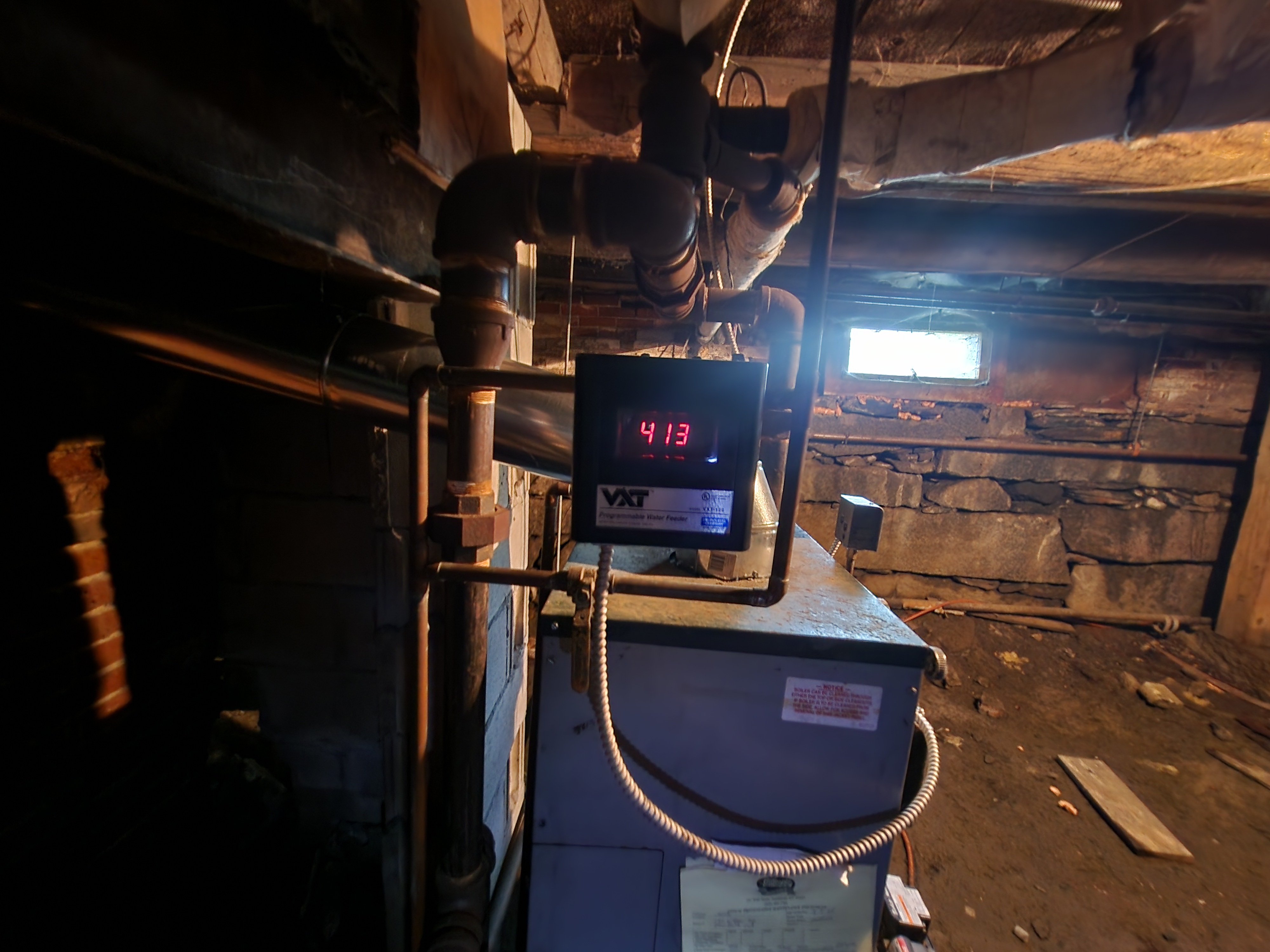

    @Steamhead I'm pretty sure I don't see vents, but I' looking at pictures at the moment, noy the actual system. So I'm concluding, 70% sure, it's Hot Water.
    Vermont is difficult. If you can't find anyone stop at FW Webb in Barre. (they are a supply house) Ask them to recommend some GOOD contractors
    CMartinBarreVTMad Dog_2
  • Well my guess it was Hot Water was wrong. It's clearly steam. It works. Started making heat at the rads 20 minutes after turning it on. And rads got too hot to touch when left on for another 20.
    Vents look 'new'. Not all are the same I think.
    The no venting the hour I had it running.
    Not that I want to break something that's working. .…But I hear so much about how nice 2 pipe steam is…. The day dreamer wonders if rads have to be moved to make room for insulation to be installed anyway…. Is two pipe reasonable at that point?
    Can't wait to hear the comments.

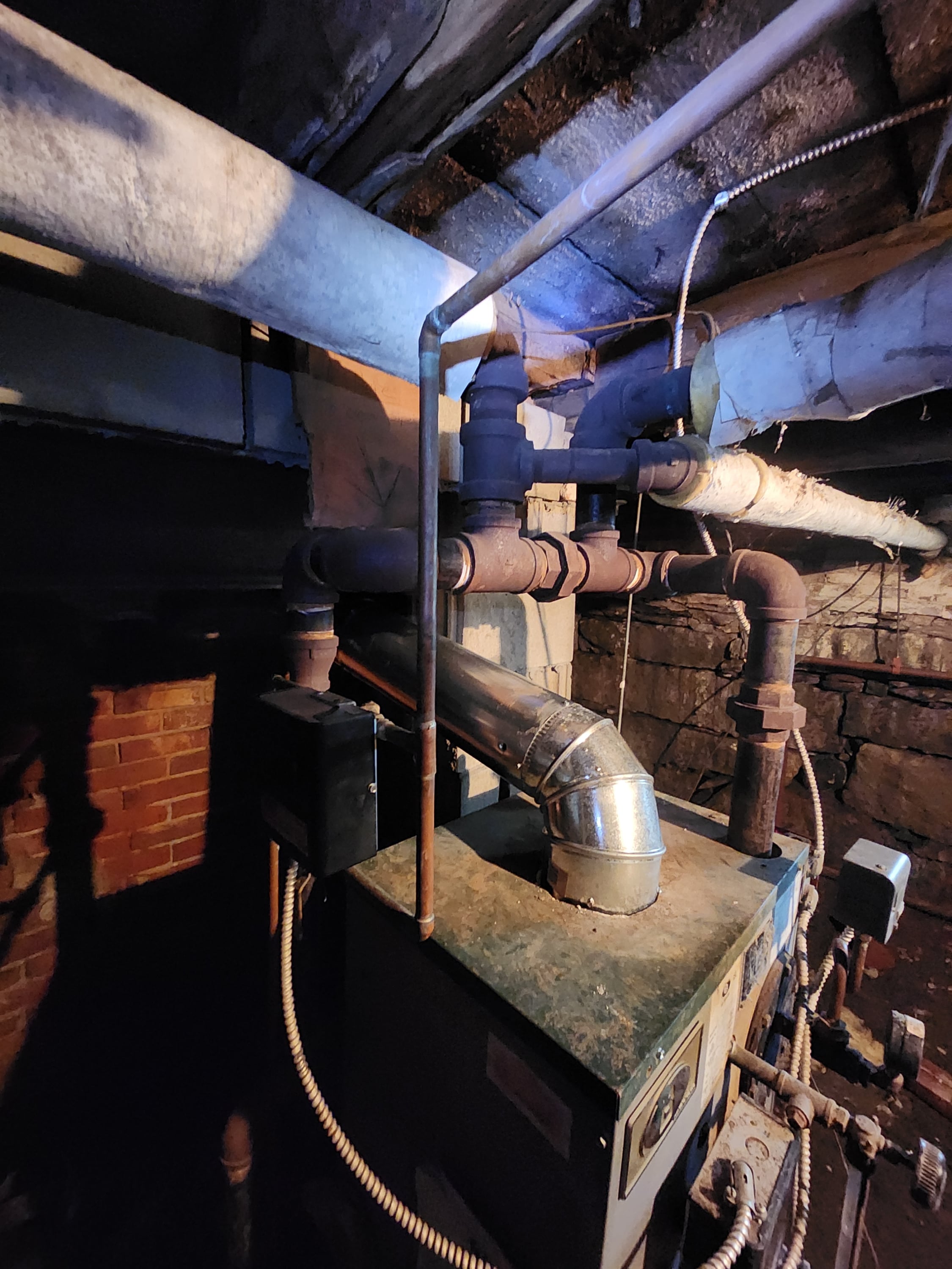

    No, Fix what you have. it would cost a fortune to make it two pipe and you will need a new boiler in the future.
    mattmia2CMartinBarreVTMad Dog_2
    You could make it 2 pipe but it would be a big job, a lot more than just moving some radiators a few inches. it wouldn't be worth it unless you had a good reason to do it.

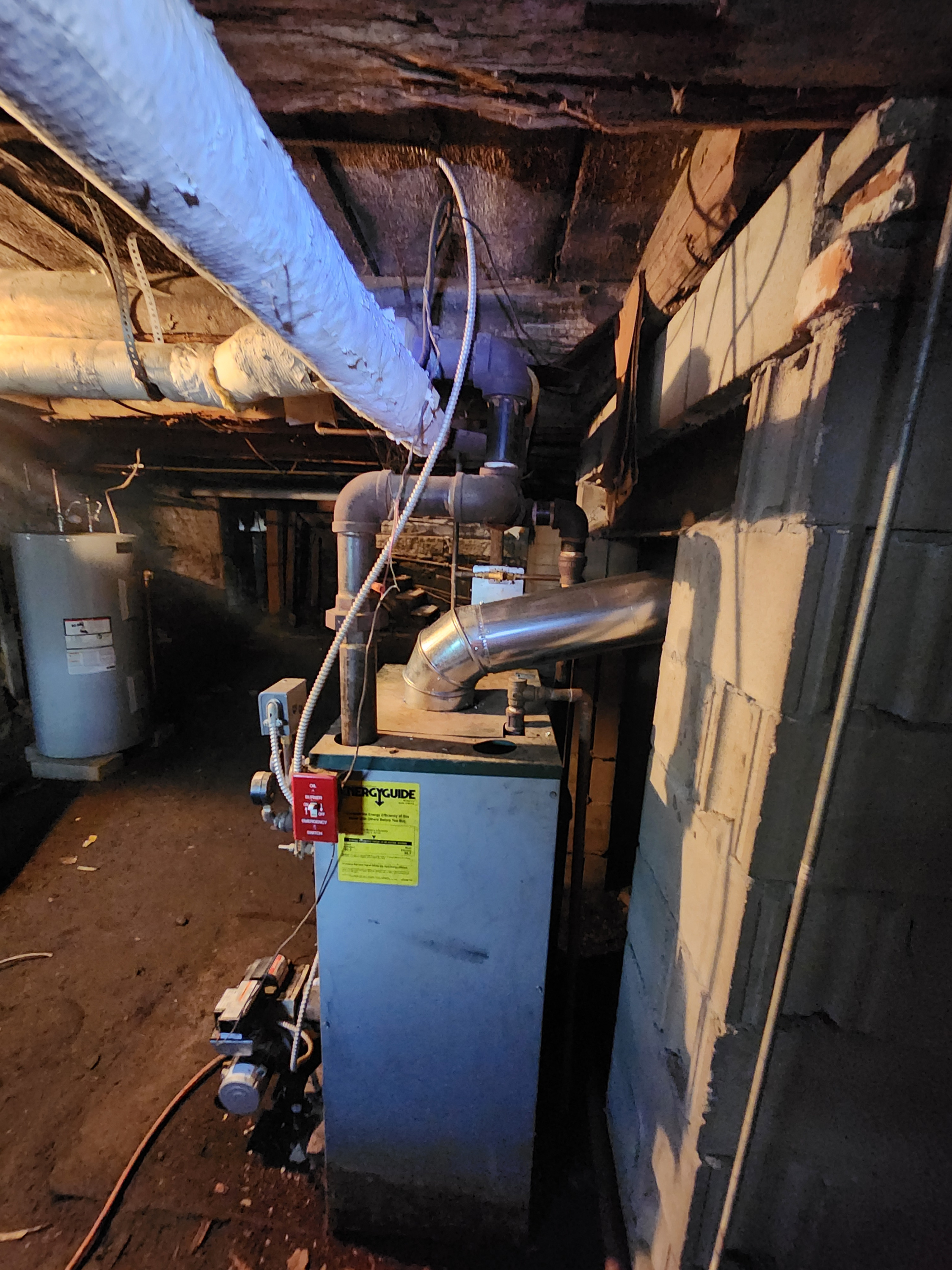

    the near boiler piping looks pretty close although a little odd, it is hard to see, it is probably close enough, especially on 1 pipe.

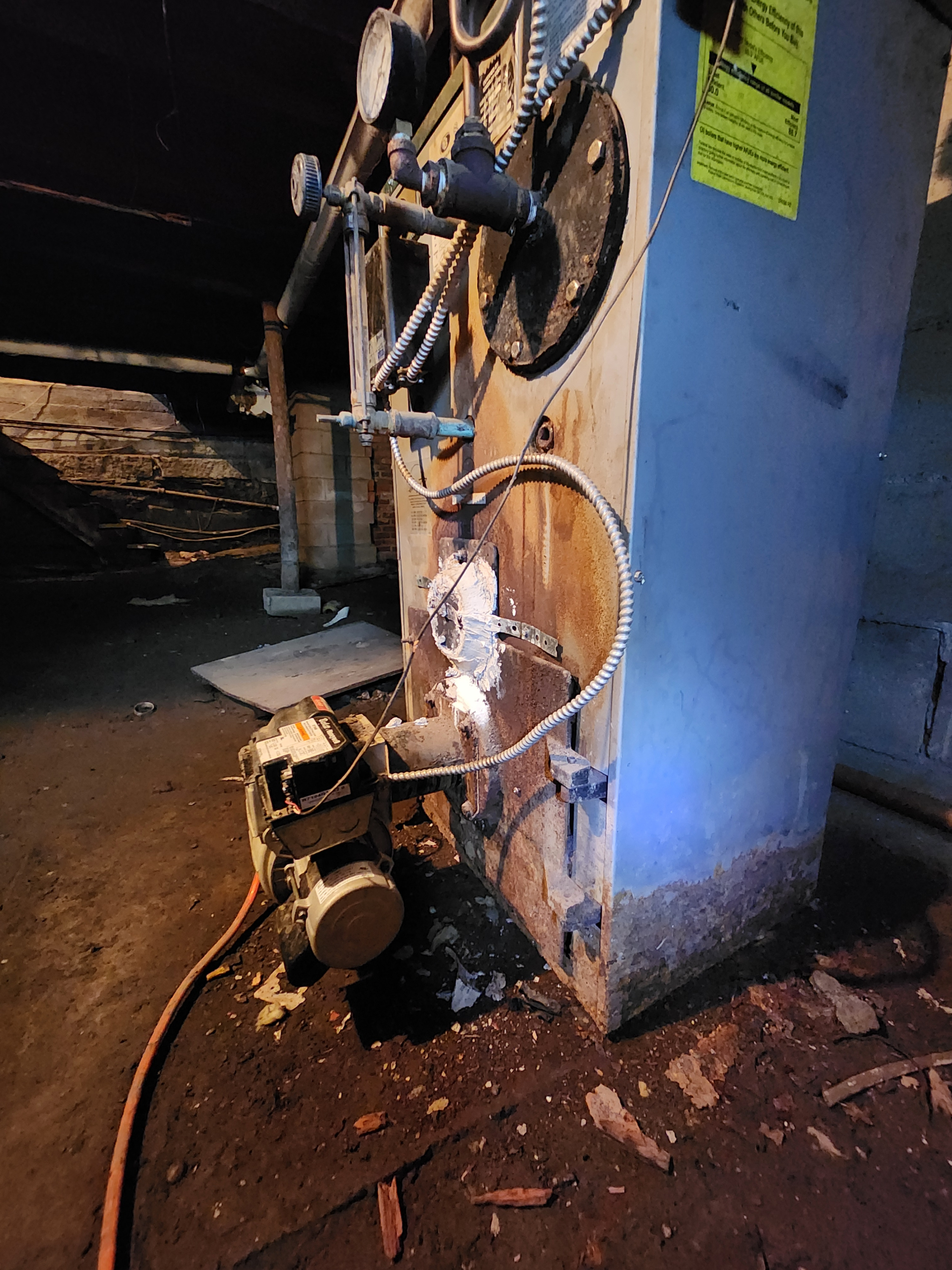

    the biggest issue is the moisture in the basement and the rust on the boiler and what appears to be asbestos in poor condition with something over it.
    make sure there aren't corroded and leaking returns out on the wet basement floor.
    CMartinBarreVT
    Don't think about going to two pipe. One pipe is a little trickier to get everything working well — but it does work perfectly well.
    The two key things are venting — particularly mains — and getting all the pipe pitches correct or at least reasonable. From the time frame you are mentioning, I'm thinking that some main venting either isn't adequate — or isn't there at all. For radiators, the name of the game is getting each one heating the space the way you want it — and it's much better to start by slowing spaces which are getting too warm.

  • No comment about the cemented hatch? What is that hatch?
    i kind of lumped the inspection door and hanger iron and furnace cement in with the corrosion.

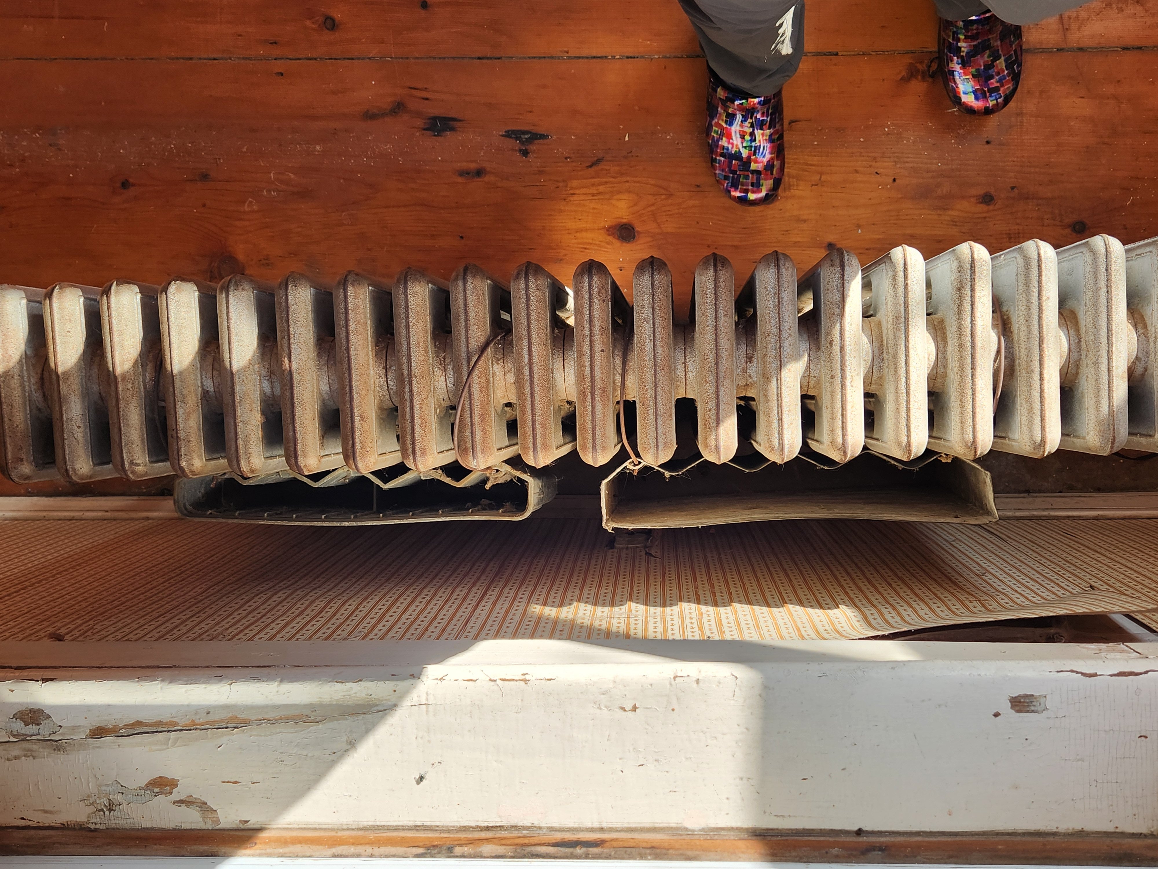

    Mostly looks like normal fiberglass insulation to me. If pipes were never painted they will rust after 100 years. Their exteriors don't mean much relative to state of system or boiler. What if any are the heating issues you are currently having? Can certainly help with your venting and balancing issues if you have any... You can do a leak test (fill till water in boiler comes up the riser) on the boiler to see if it is leaking. If it isn't it may be fine for a while.

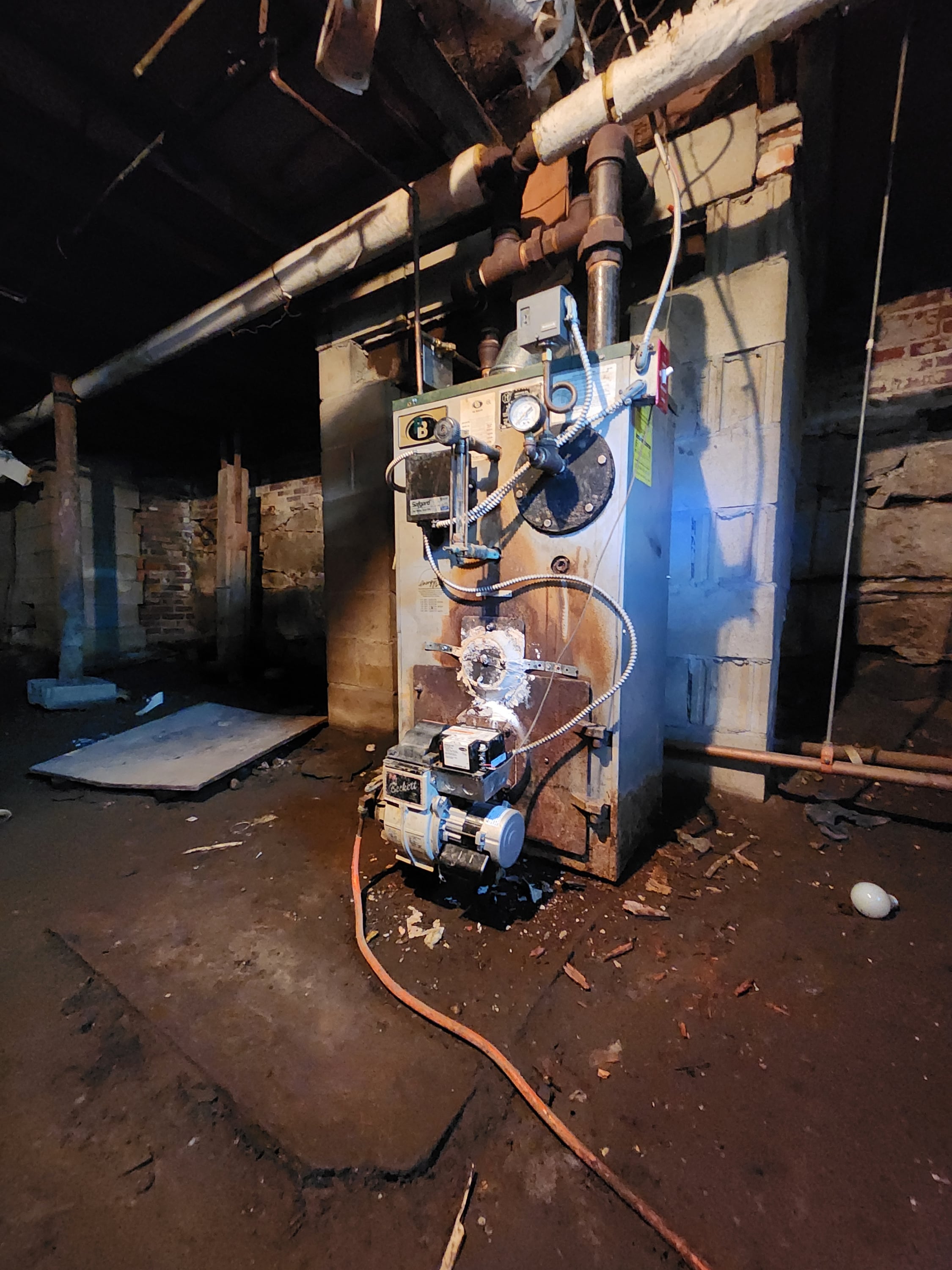

  • Well I just found out this Peerless is 17 years old. Ouch. That's a painful guage on the water situation down in that basement. 🫣😬
    Shouldn't the life of one of these boilers be 30 – 40 years if treated right?

    And regarding your actual boiler. Your basement in particular is a very unforgiving place. The water, humidity, etc. is going to degrade any appliance down there much quicker than a dry, clean basement. You can see some dry-rot on the floor boards and framing in some of your photos. Proof that basements don't like to be wet.
    You essentially have an outdoor boiler that is somewhat protected from outdoor temperature swings.
    I have one-pipe steam and my boiler is about 40 years old and isn't showing any signs of slowing down. The fact that you are getting heat in 20 minutes is a great sign! Despite this boilers visual condition it seems like it has more service life left in it.
    Take care of the water problems and plug up any above-grade cracks or holes in the foundations to try and seal it up a bit better. Put some crushed stone down over the dirt if it makes you feel better.
    Have a pro do a thorough inspection, service the safety mechanisms and replace the air vents on the radiators if needed. You'll be surprised how well it heats!

    someone already mentioned this, but flood the boiler(fill it up to the riser out of the top of the boiler) to make sure it isn't leaking above the water line
    CMartinBarreVT
  • bburd
    bburd Posts: 1,338
    Do this while the boiler is cold. Turn off the service switch. Open the feed valve and hold onto the riser above the boiler; turn off the water when the pipe gets cold.
    Let it sit for a few hours and look underneath for leaks.
    Drain the boiler back down so the water level is normal in the gauge glass before restarting.
