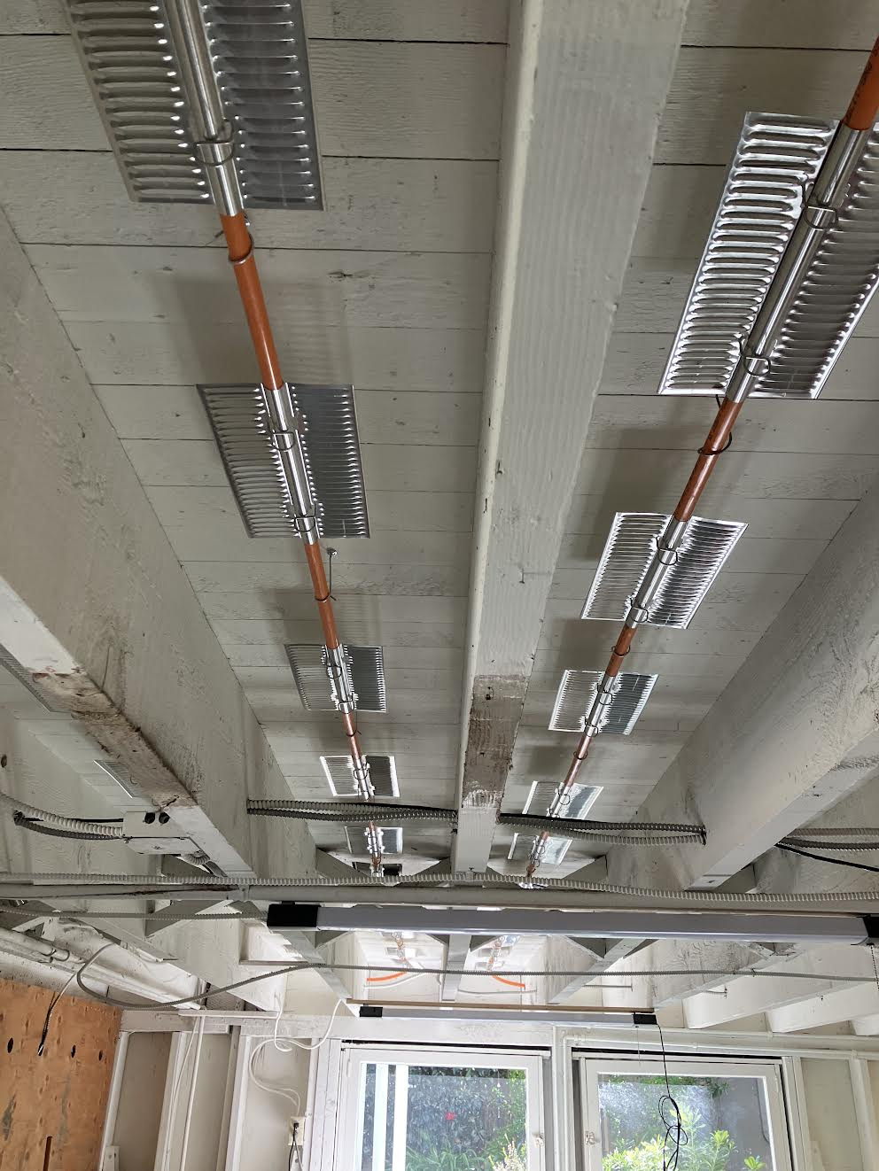

    Good under floor plates (not the beer can type) will work fine and probably be less expensive any of the manufactured above floor systems provided your R value doesn’t go above 2. Typically, you can get about 20 btus output per square foot at 120* SWT which should be sufficient for a properly insulated house.

    Most staple-up systems should not exceed 120F water temperature as the flooring can react at higher temps. Look also at the Ultra-Fin product as you can exceed 120F since this product does not heat by conduction, rather convection. I like it because you only need one run per bay instead of two.
    https://www.ultra-fin.com/

    I have aluminum plates on the underside of the underlayment under both hardwood and even carpet/pad. Not a problem. On a reset control with 120 degree water on design day. Runs most of winter in the 90-110 range, p/s, long cycles.
    A thermal imaging camera makes balancing much easier.

    I ended up going with hydronic hot water coils In my air handlers for the main source of heat.
    Going to install subfloor radiant tubing with aluminum plates as a secondary system.
    Can I have all my manifolds in the basement and vent from there, or do the manifolds have to be above the floor being heated for venting purposes?
  • Sure, you can install the manifolds in the basement. It's probably more convenient that way and you don't have to hide the manifold in the wall upstairs with an access panel.
    The only drawback is that the tails - from the floor, to the manifold - are longer and you may need more loops, but NBD.
    Insulate those tails so you don't get expansion-contraction sounds where tubing hits framing members.
