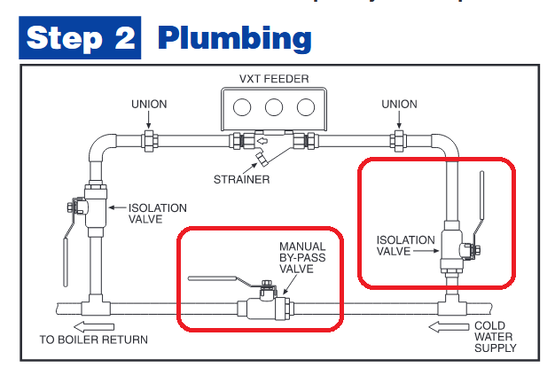

Brand new steam install last fall, highly regarding installer. We drained the boiler for some basement work, new gas line. I turned on the power switch and LWCO light turned on and it started auto feeding. After 5 gallons I hit the sight glass line and it won't stop. Looks like the dip switch is set to LWCO. We'd like to test the new gas plumbing but every time I turn on the power switch it keeps trying to fill. Anything I can look in to or bypass?
    Its one of a few things. Either the Low water control is telling the feeder to feed when it shouldn't or the feeder is defective, valve leaking by or feeder relay stuck. Low water probe could be dirty.

    If I shutoff the isolation valves for the feeder will it fire even if it's attempting to feed? Or will it not fire until it's stopped running? Just trying to test the boiler at this point.

    Maybe. It depends on whether the problem is in the feeder or the LWCO. If the LWCO thinks the water is low — even if it isn't — the boiler shouldn't fire. In fact, you rather hope it doesn't — much better to have the boiler shut off due to a faulty LWCO than keep running dry due to a faulty LWCO!
    On the other hand, if the LWCO isn't lying but there is something amiss with the automatic feeder, the boiler should run just fine. Just remember that you don't have any automatic feed…

    109A_5 Member Posts: 4,227
    For example if these two valves are present and functional and closed no water will go to the boiler (even if it needs water).
    You need to figure out which device is the problem. The LWCO (Low Water Cut Off) or the VXT feeder (electrical) or its valve (mechanical). Disconnecting the 'Feed' wire may help isolate between the two devices. An example;
    https://hydrolevel.com/wp-content/uploads/2021/06/VXT-24-Instructions-web-0321.pdf
