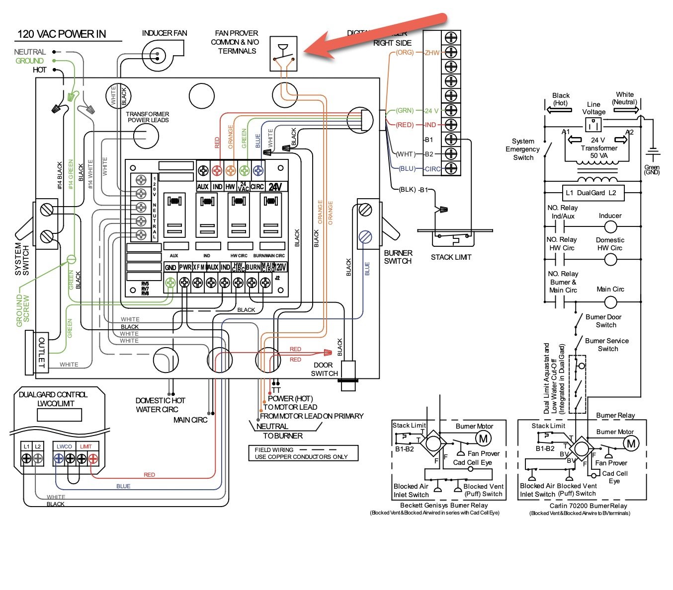

I have a Energy Kinetics System 2000 with a Honeywell R7284U controller with a Becket 51171U Power Light igniter. The system ran fine for the first 2 yrs after we purchased the house. Last fall we came back from a trip and the controller was in Hard Lockout. Long story short, we had a repair technician come in and do all the maintenance on the system. Oil filter change, cleaned the nozzle, new igniter, new solenoid valve, everything. Left the controller the same. It ran for the winter then this spring it started doing the hard lockout again. I replaced the Honeywell controller with a new R7284U and it is still going into hard lockout, so I put the old controller back on.
First off the heat is off so we are only calling for heat for the water heater which is roughly once every 24hrs.
Energy Kinetics System 2000 Energy Manager Controls the call for heat
Honeywell R7284U is the controller
For troubleshooting, here is what I am seeing. Sometimes the burner motor starts during the Valve On Delay,...sometimes it does not. It does start when it gets flame. I cannot tell from the HW manual for the controller if it should start every time during the valve on delay or not and therefore I don't know if this is part of the problem. I have read that the valve on delay is a purge step which would seem to me that it should run during the valve on delay.
It usually fails to ignite on the first try but will almost always ignite on the second try after the hard lock out.
I thought the controller was the issue but after changing it out i am getting the same symptoms, so I put the old on back on.
Having replaced everything but the burner motor, not sure what the problem is.

    Let’s make sure we’re on the same page. Unless you are talking about an inducer motor or power venter motor.
    The burner motor must start first, or nothing happens. The motor is connected via a coupling to the fuel pump. If the motor doesn’t turn, the pump doesn’t turn, and it would be impossible to light. No diagnostic code for that, just the gift of sight.
    As you are not the original owner, I would try to contact the original installer. If you can’t find that person, I would contact EK. If the boiler was registered, they can tell you the original installer. If not, they seem to have a pretty big presence in Alaska and should be able to put you in touch with a preferred technician.
    The set up is just a little different from all other burner/boiler combos, and without knowing that small difference could be the problem.

    I'm still a little confused as to what is happening. You say the burner motor will wait until it lights, which makes no sense. It can't light without the burner motor running. So, does the burner motor run, but then doesn't fire the burner, and then goes in to lockout, or does it run for a bit then shutoff on its own without a lockout? If it is the second case, sometimes it is just a bad timing thing, as the zone is just shutting down just after the burner starts to fire. Also, you never mentioned checking or changing the cad cell, which is what signals the burner to lockout if there is a problem.
    If it runs but doesn't light, then the the best thing to do is have a pressure gauge to make sure the nozzle is getting fuel pressure. That test would tell you where to go next.
    My wag is going to be fuel pump coupling slipping, or cad cell.

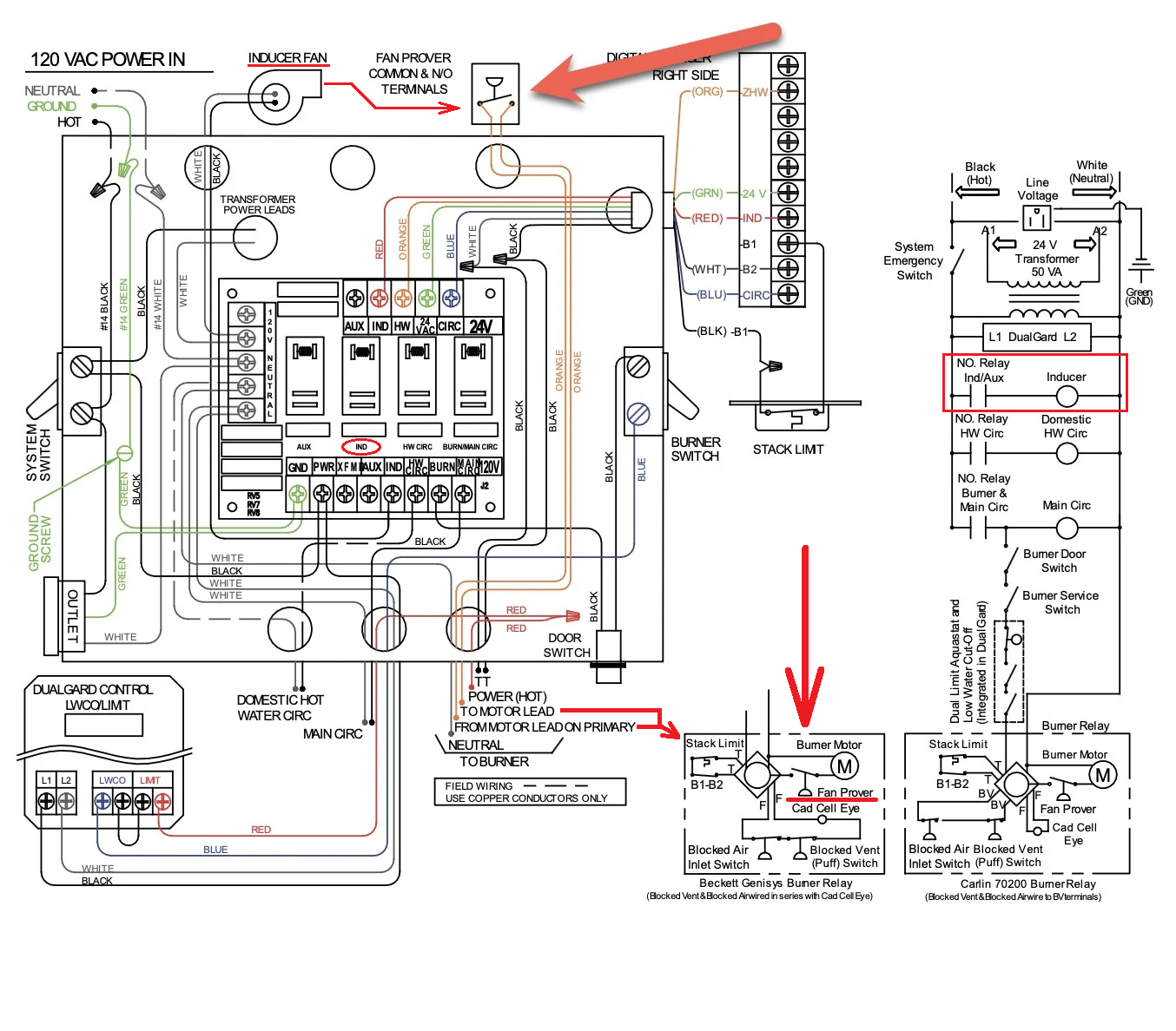

    109A_5 Posts: 4,759
    edited August 2025
    Good find !!!
    (" Sometimes the burner motor starts during the Valve On Delay,...sometimes it does not. "). I would imagine that restriction made the fan proving just at the point of being intermittent.
    Maybe that should be on the list of maintenance items to inspect.
    Sad the " repair technician " could not find it.
    How did you find it, Multi-meter, logic, visual inspection, all of the above, none of the above, other ?

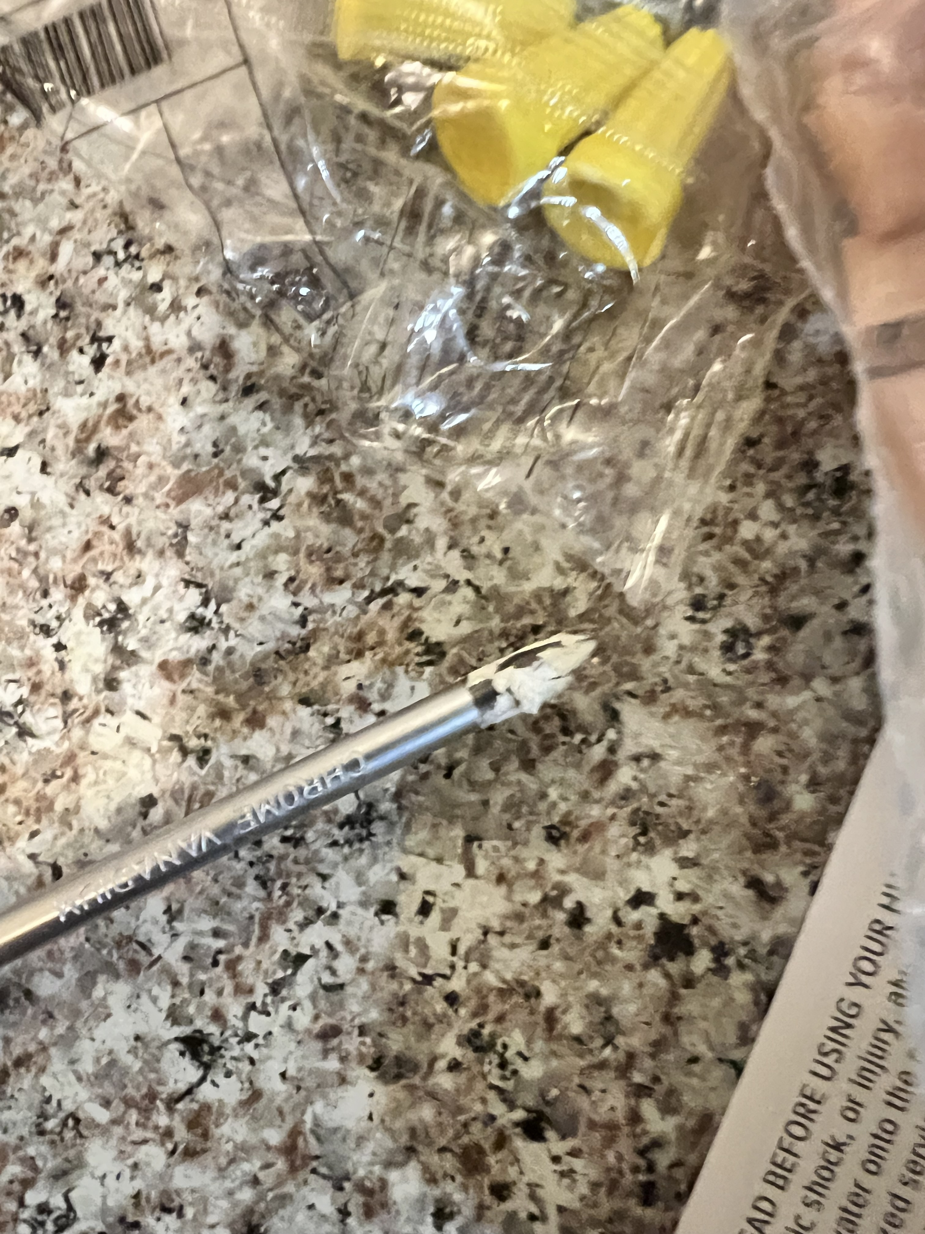

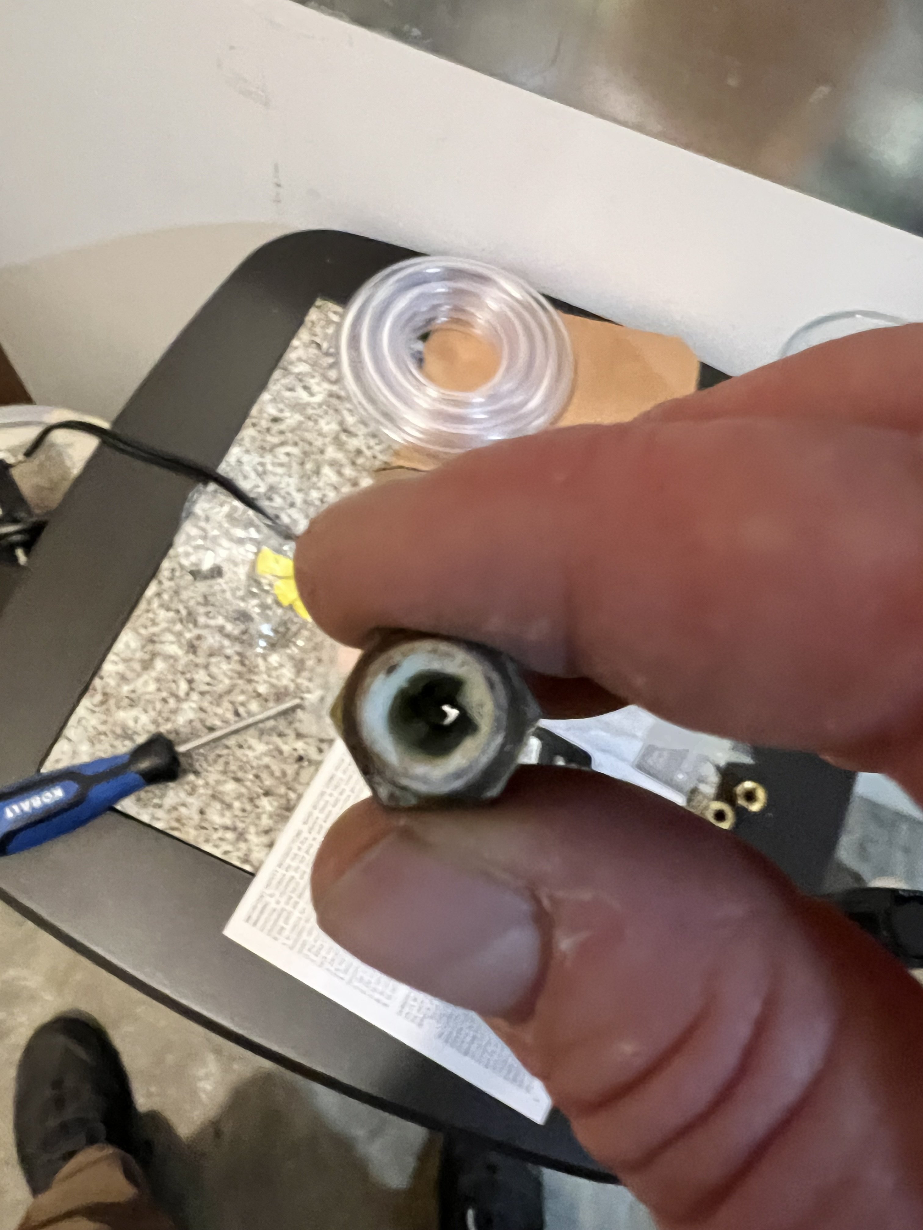

  • Well I fixed it after I replaced the pressure switch. At that point there was no reason to believe the pressure switch wasn't getting the right pressure. When I replaced it I lined up the High pressure tube opposite the low that was marked on the switch and it still didn't work. The person that cleaned it took that exhaust blower out and cleaned all that so it never occurred to me that it wasn't blowing down that tube…then I took the tube off of the barb and put my finger over it and nothing. Then took it out.
    All in all, definitely a tough one and definitely intermittent. Heck it ran for 6 months after all the work we had done on it after being flaky last fall. I don't think I would have expected a tech who didn't install it to check that. Especially since it worked for years.
    Anyway…the important thing is yes, the prover switch was what was giving me intermittent lockouts and consistently made it impossible to reproduce the problem.
    109A_5 Posts: 4,759
    OK a bit of logic & visual inspection. If the prover pressure switch has published specifications, the " repair technician " may have found it if he tested the inducer fan prover pressure switch with a manometer connected into that system.
