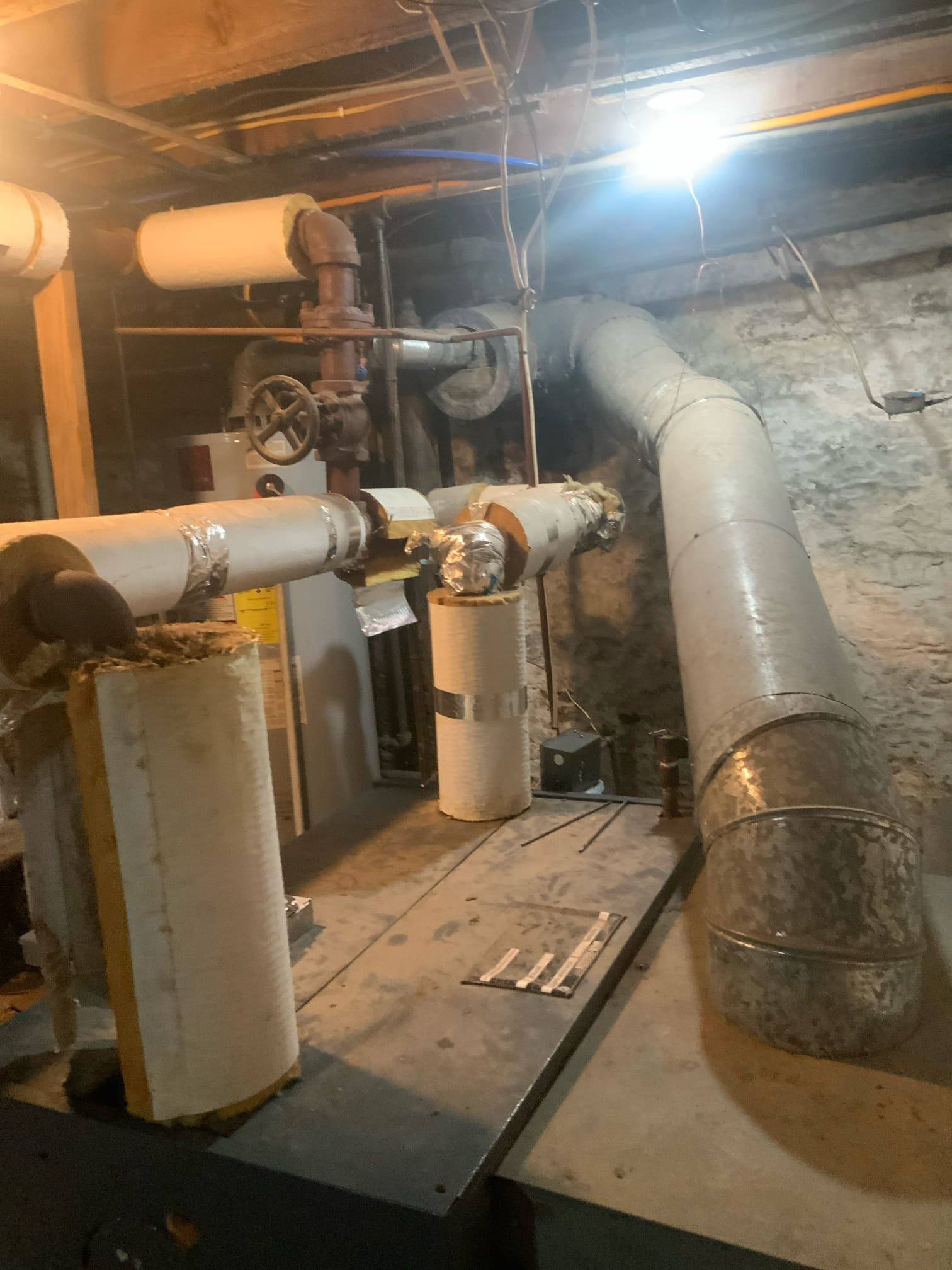

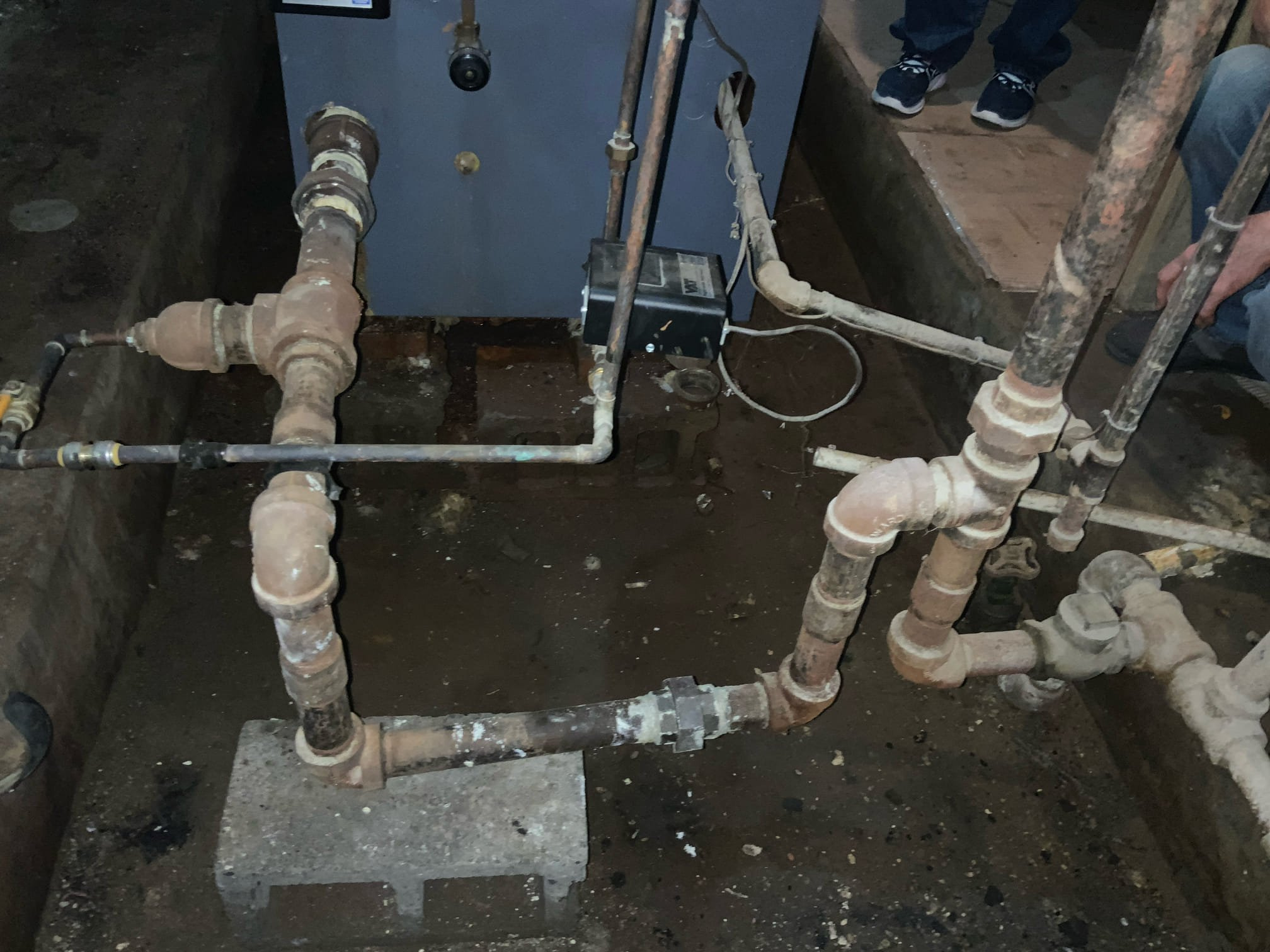

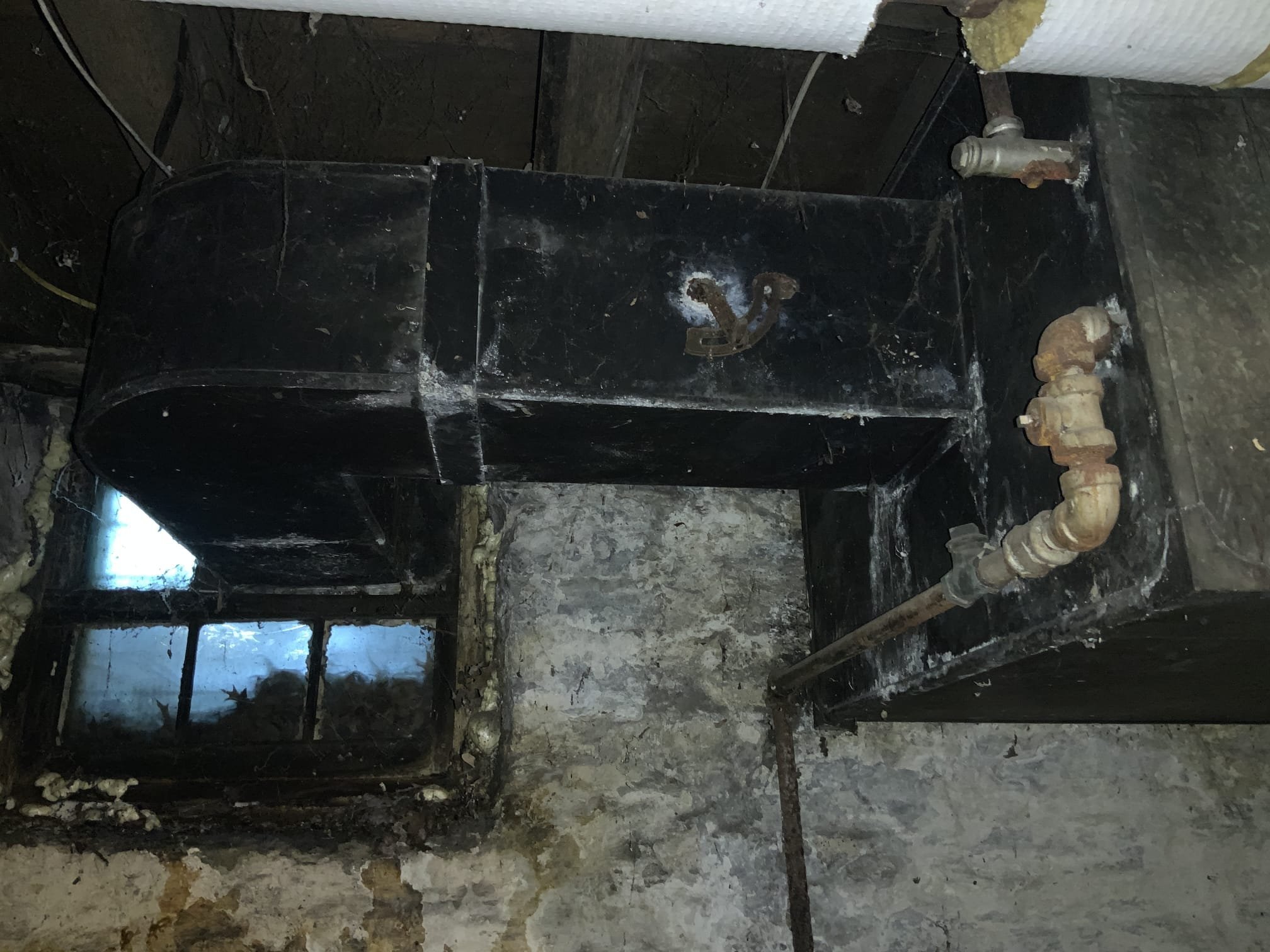

A contractor sent this to me Not sure what the tee is on the last pic. The header is piped wrong and the home has 4 indirect heaters. Such a cool looking job

    Do you mean the tee with gate valve above it? Mad Dog
  • Mad Dog_2
    Mad Dog_2 Member Posts: 8,538
    Oh.I see..."Sarco" ? Can he give you a wider angle to see how it's tied in?
  • Mad Dog_2
    It's similar looking to the Richarson Air Expeller to me. Mad Dog
    Steamhead Member Posts: 18,457
    The odd looking tee is either an air vent or a safety valve, or maybe some sort of ejector. Is it mounted on the steam main or the dry return? Can we get a close-up of the lettering on the side?

    Those fenestra windows that the indirect air intake is through didn't show up until about the 19 teens.
    That was a lot of work to get the header wrong.
