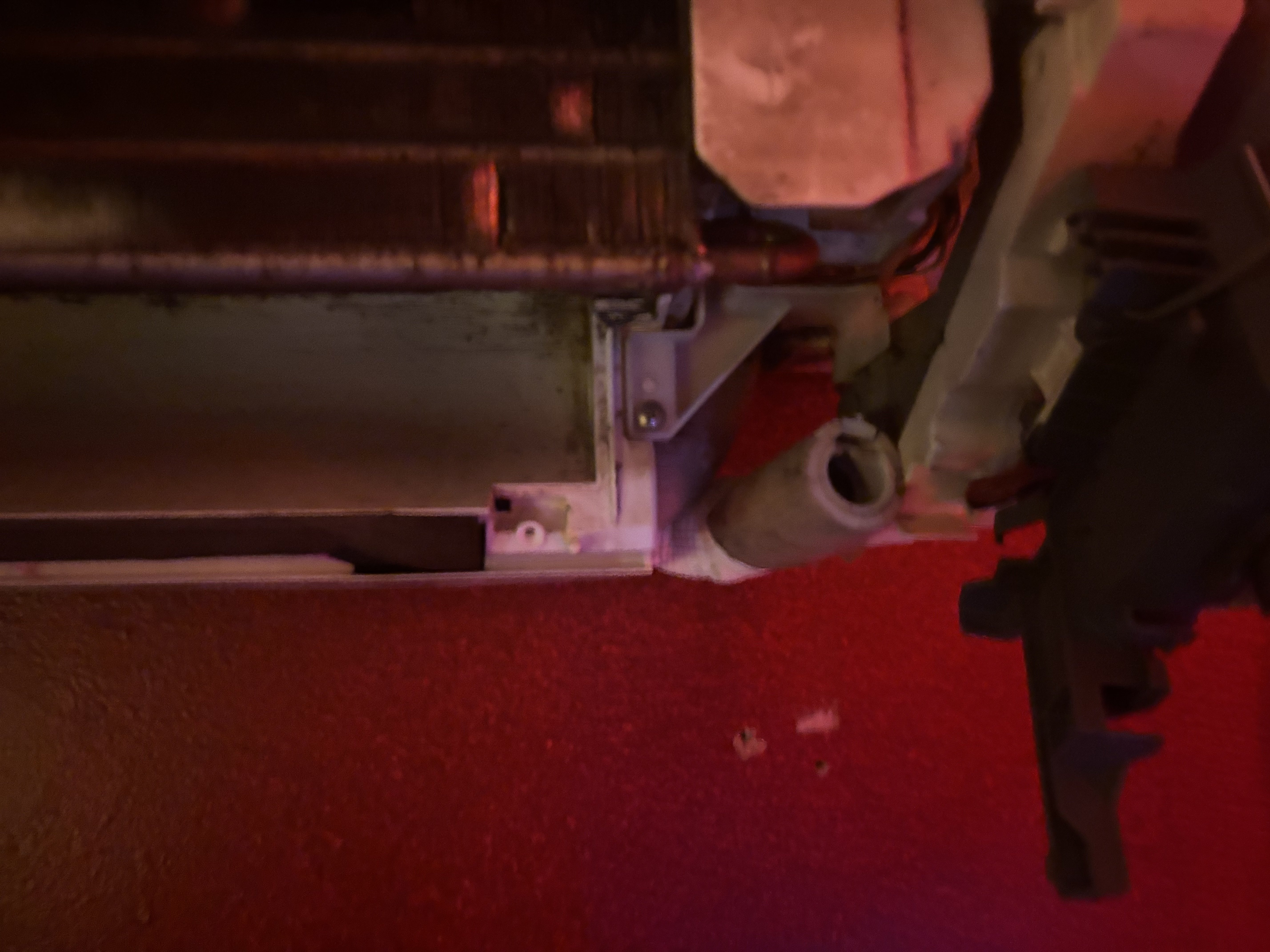

my split unit started leaking a few days ago. I took it apart cleaned the drain pan, used a shop vac on the outside drain line and the one inside multiple times, ran a thick cable thru 3 feet of the condensation drain hose and flushed 15 times with hot soapy water and vinegar. Only to pour water into the condensation drain hose attached to the unit inside. And the water just sits there. Even if I hold the hose up it doesn’t drain down. Is there a mechanism in the beginning of the hose that can allow a cable to pass thru but not water? And does the msz-gl09na have a condensation pump? Please help.

    post a picture of the trap, or drain coming from the pan,

    I removed the drain pan. This is the hose that goes into the back of it. I poured water in it and hold the hose up and it just sits there. Doesn’t drain at all.

    109A_5 Member Posts: 4,346
    " ran a thick cable thru 3 feet of the condensation drain hose and flushed 15 times with hot soapy water and vinegar. "
    Often spiders and critters get in from the outside and the debris in the drain pan washes down.
    Was the thick cable you used longer than the drain hose ?
    When you flushed it with the hot soapy water and vinegar, did it drain then ?
    I would say you need a thick cable (or the like) that is longer than the whole drain hose and work out the blockage from both ends. Spinning the 'Snake' may also help dislodge the blockage so it can be flushed out.
    Once you get it running flush it good.

    mattmia2 Member Posts: 17,906
    Some bleach in the hose might help break down the mold, just be careful not to spray bleach on yourself.
    You need something like 1/4" wire rope or the outer sheathing of a bicycle hand brake cable that is longer than the drain hose for a sanity check that it will pass all the way through. Can the drain hose be easily removed from the building to force water through it with a garden hose ?
    or put a barb fitting and valve of some sort on a garden hose and flush it through with the hose.

    so in case anyone runs into this anomaly. There was negative pressure in the hose within the first 2 feet. Cut it there and spliced pvc pipe for the remainder
