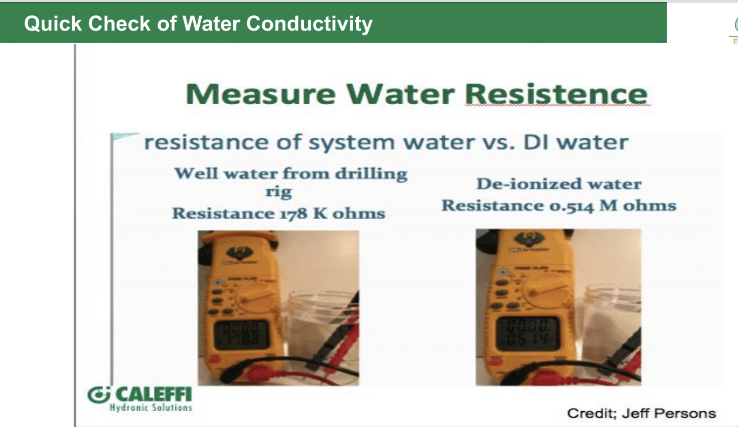

    hot_rod Posts: 28,699
    The more "stuff" that is in you water the higher the conductivity. A basic VOM could show you this, test before and after the softener.
    You can get pure water a few ways RO, generally just at the drinking water, kitchen sink for treating bad water.
    DI or DM deionized or demineralized water, this uses a resin bed similar to a softener.
    Distilling, boil water to steam, collect the condensate..
    All 3 are fairly expensive for a whole house solution, Also, pure water is not so good for drinking, some minerals are good for you, give the water some taste. Pure water from one of the 3 methods will also be low ph. Until they pull some from metals in the system. It is hard to keep pure, hungry water pure for much time, ph will balance back to neutral.
    As you see water can be a very complex product to adjust and get to where you want it. You really want a water treatment pro that can explain what you have, what you can do, and how to do it.
    Unscrupulous water treatment people sell softeners, or RO or carbon block filters as a fix all, it is not always that simple and can make matter worse, depending on what is in your water.
    Complicating it even more is the water can change over the course of the year depending on the source(s). Spring runoff in snowbelt areas may show high chloride levels for the deicers. That goes away or lowers as the roads flush clear.

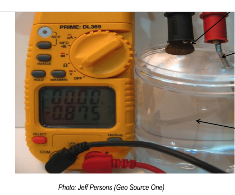

    Screenshot 2025-08-29 at 10.24.01 AM.png Screenshot 2025-08-29 at 10.23.46 AM.png
    the penny and galvanized metal are a battery, you need the meter set to dc volts, not resistance. that isn't measuring resistance , it is measuring the voltage created by the battery but the meter is trying to interpret that voltage as the voltage drop in its resistance measuring circuit. to measure the resistance you need probes of the same metal. the actual resistance of the hard water s probably in the megaohm range and essentially infinity for the di water though that will depend on how much CO2 is dissolved in it.
    Intplm.
  • Hi @barbap , Just to clarify. You said "I thought grains of hardness was the same thing as TDS!" … TDS means total dissolved solids. Hardness usually refers to calcium and magnesium, but sodium can be a dissolved solid as well. Particularly with softened water, where salt is exchanged for calcium and magnesium, it's important to measure sodium directly, so you know what's really in your water… if it's safe to drink … and if it's okay to use in stainless tanks and copper plumbing. High salt and low pH as @hot_rod brought up is a combination ultimately lethal to the metals used in plumbing.
    Yours, Larry
    I think the meter in the pic is set to voltage? Reading just under 1 volt. Adding salt to the water would increase conductivity.
    oh, sorry. i thought there were differing electrodes in all 3. the resistance will depend on the area of the electrodes too. there is an old style of dummy load where iron plates are lowered in to a vat of brine.

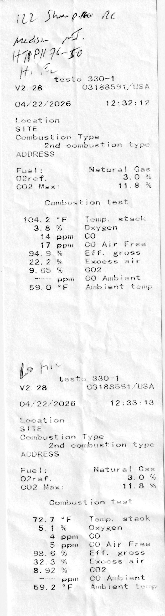

    @PlumbrUSA I saw your post from years ago regarding HTP... Do you think my F82 error is from my burner getting wet?
    did whoever installed it do a combustion analysis?
  • barbap
    barbap Posts: 12
    @mattmia2 He said he did a combustion test…
    the installers should leave a copy of the combustion analysis. Some analyzers can store that info, ask him to send a digital copy with the date and time to match when he was there
    If he cannot provide that , hmmmm
    looking at the manual it doesn't seem they are as concerned with combustion as with the mod cons.

    @mattmia2, @hot_rod I found the test!
    Also, the gas company has been doing work throughout our town, upgrading old cast iron pipes — do you think that could cause instability in our gas feed / mess with our regulator? It's a very long shot, since the error coincides with our new unit, but I'm hoping this issue will pass without having to pay for out-of-warranty parts plus labor.
