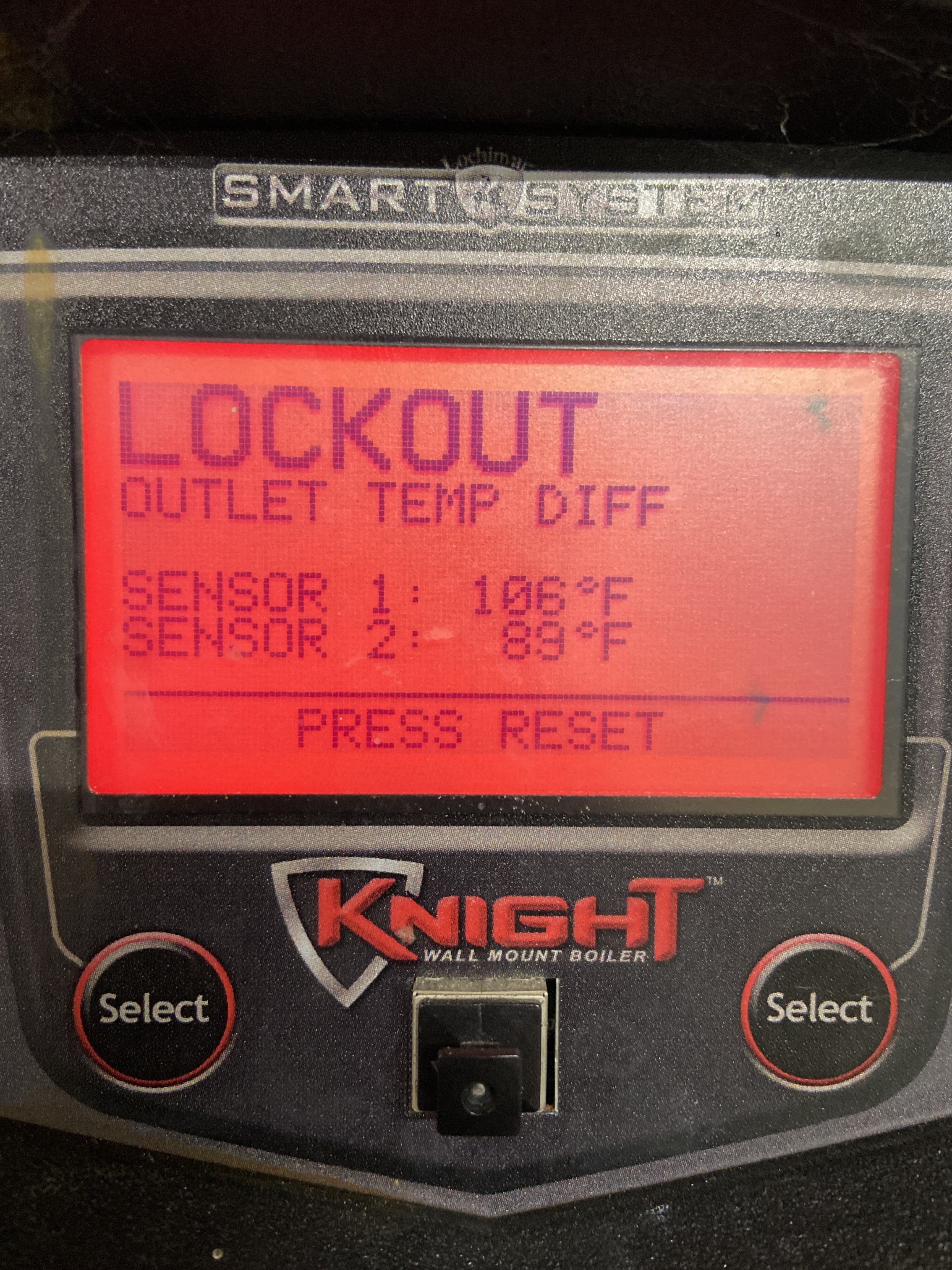

The system keeps locking out after i reset it
The indirect tank is reading 89° on the gauge

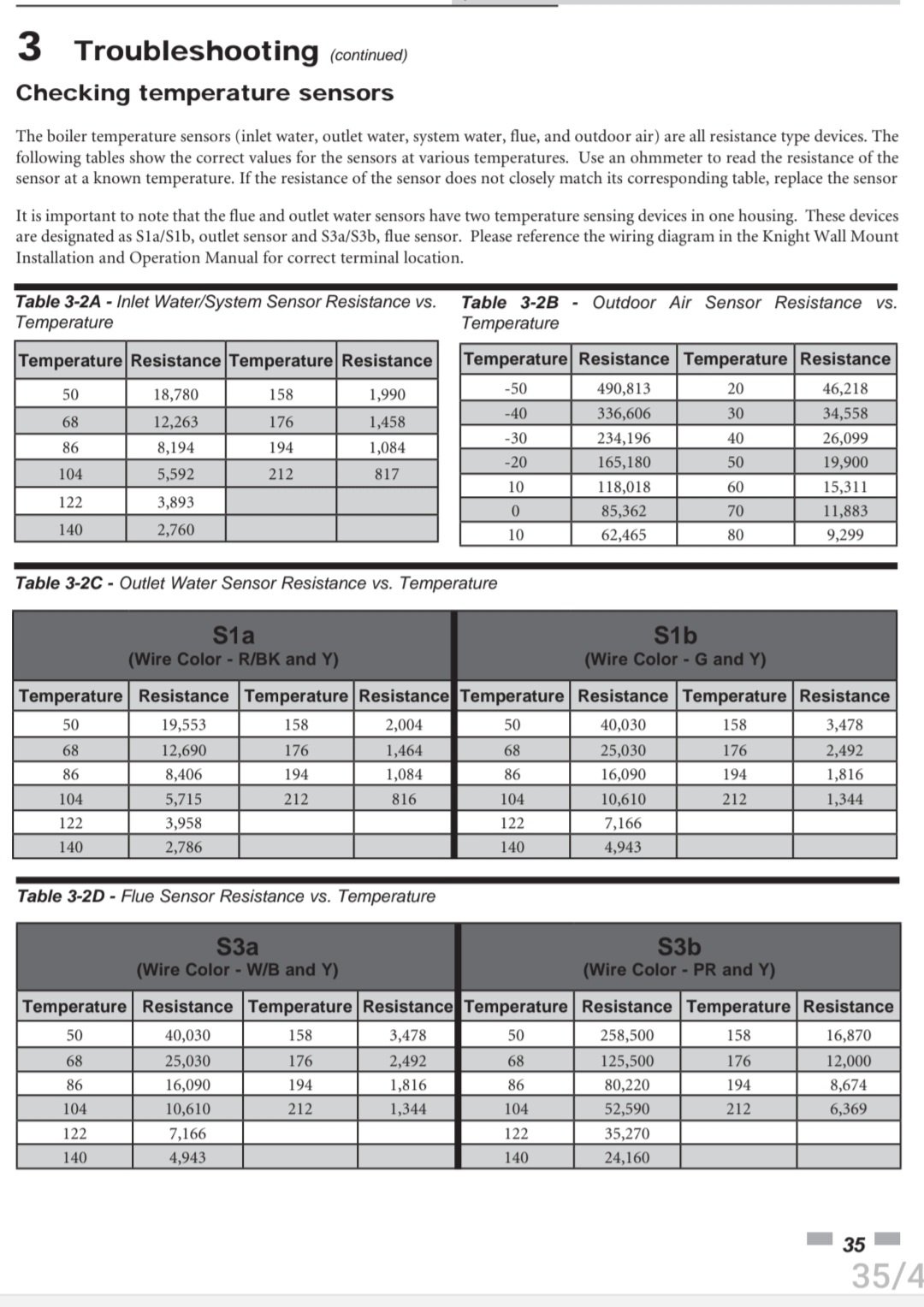

Should i ohm out the sensors and see if they’re bad?

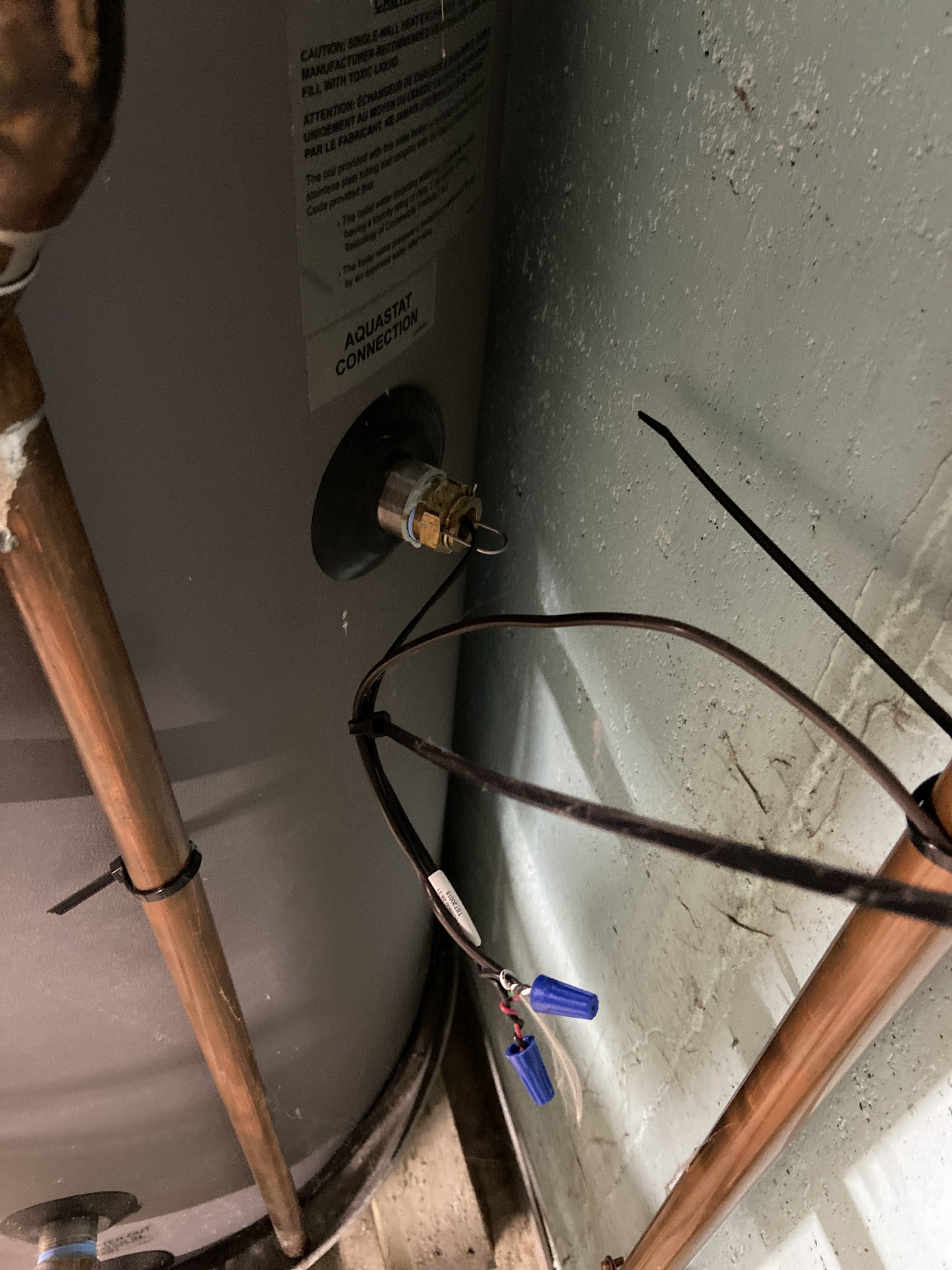

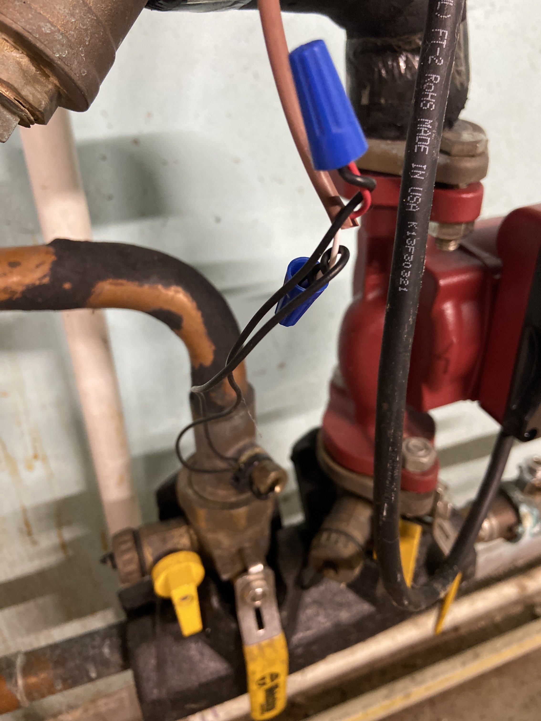

    first photo is the system sensor,
    Second is the Indirect tank sensor

    so I’ve reset it again, it ran for 4min before locking out again. The outlet side going to the tank was getting hot and the return going through the circulator and to the inlet were warming up. I don’t have the magnetic tester to see if the pump is actually spinning but it is letting hot water through and i do feel it vibrating.
    The circulator is a grundfos
    TYPE:ups15-58cifc

    didn’t quote your reply but i posted the pics of the sensor locations
    mattmia2 Member Posts: 17,906
    are you sure those are the sensors? there are probably half a dozen temp sensors at various points. what makes you think those are number 1 and 2? one looks like the system or dhw recirc sensor and the other looks like the dhw tank sensor.

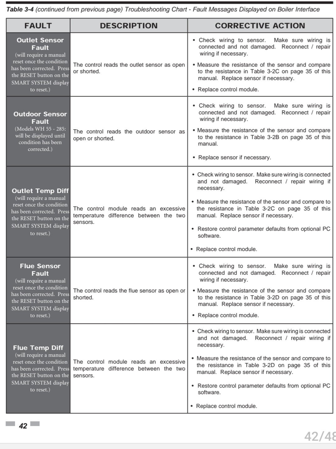

    HVACNUT Member Posts: 7,613

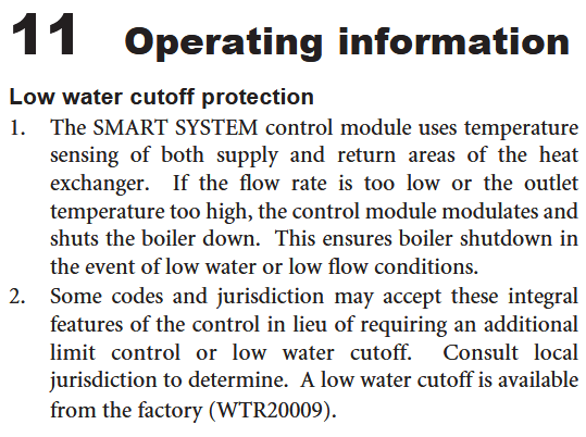

    As mentioned, its not the tank sensor. The boiler has inlet an outlet temperature sensors.
    Screenshot_20250814_064023_Samsung Notes.jpg Screenshot_20250814_064055_Samsung Notes.jpg

    If the system is allowed to sit idle for a while, do the temperatures the system displays for Sensor 1 and Sensor 2 seem plausible (basically approaching ambient temps) ? If so I still think it's a water flow issue through the heat exchanger.
