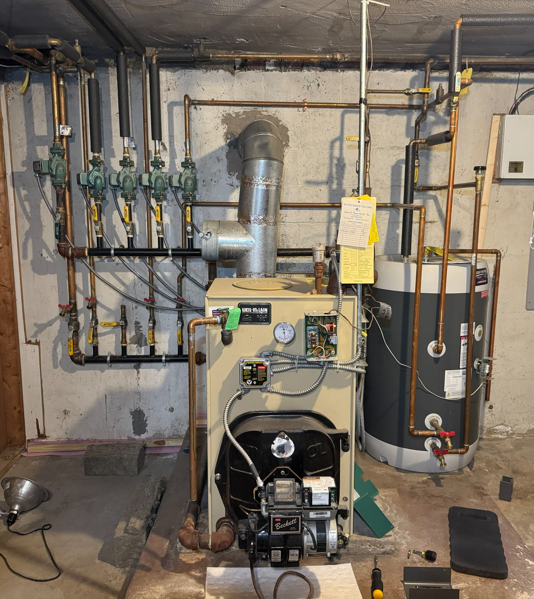

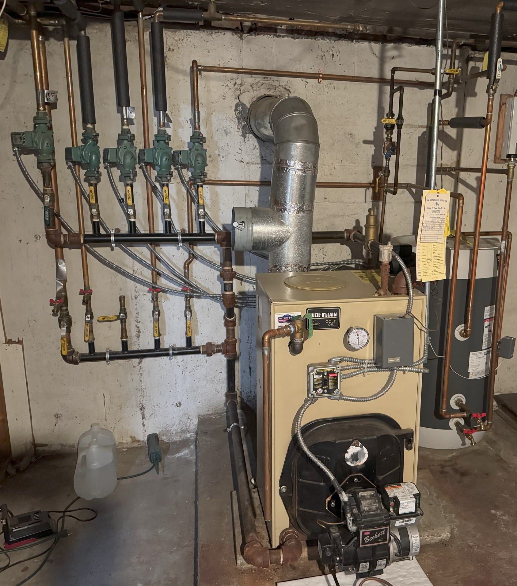

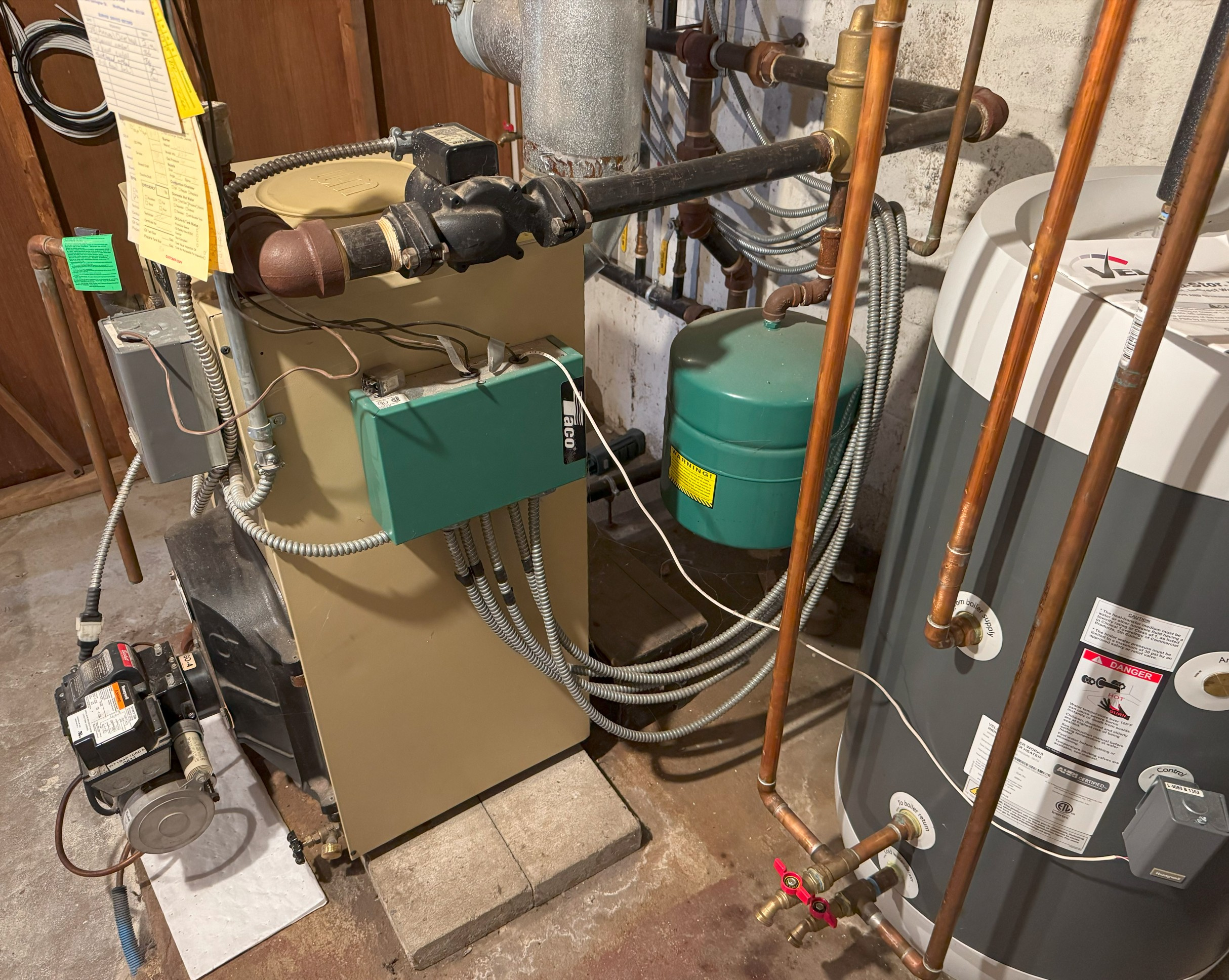

Hi, new homeowner trying to learn my system and figure out if the aquastat is why my boiler is firing every ~2hrs for ~5min, heat off, in 90+ degree weather, using ~1.25gal oil/day. 2-person home, 5min showers, DW 1x/wk. Most times the boiler fires the line to my indirect HW tank stays room temp.
Boiler: Weil-Mclain P-WGO-4, series 3 (installed 2004)
Beckett AFG
Taco 007-F5 circulator on the boiler and each zone
Expansion tank HTX 30 Flex2 Pro, manuf. 12/11?

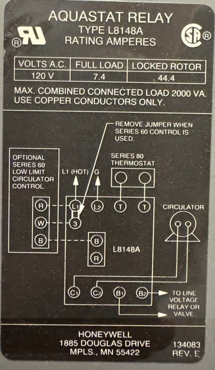

Aquastat: L8148A, HI at 185F. No low. Uncle has similar boiler with a L8124A,C L8151A
4-Zone Switch Relay Taco SR504
Zones: 4? Please see image. I only have 3 thermostats in the house. House is 1400SF. Combo of 1-1/4" (bit over 1.5" OD) black iron (original 1950s part) and 3/4" copper (renos and 1980s addition).
WH: Velocity Boilerworks MS2-040 (40-gal indirect), set at 120F
Serviced 4months ago by oil company. I'm going through manuals and have spare electrode kit, nozzle, filter cartridge.

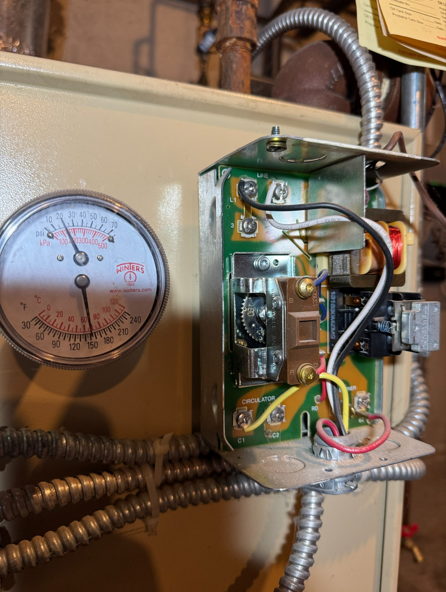

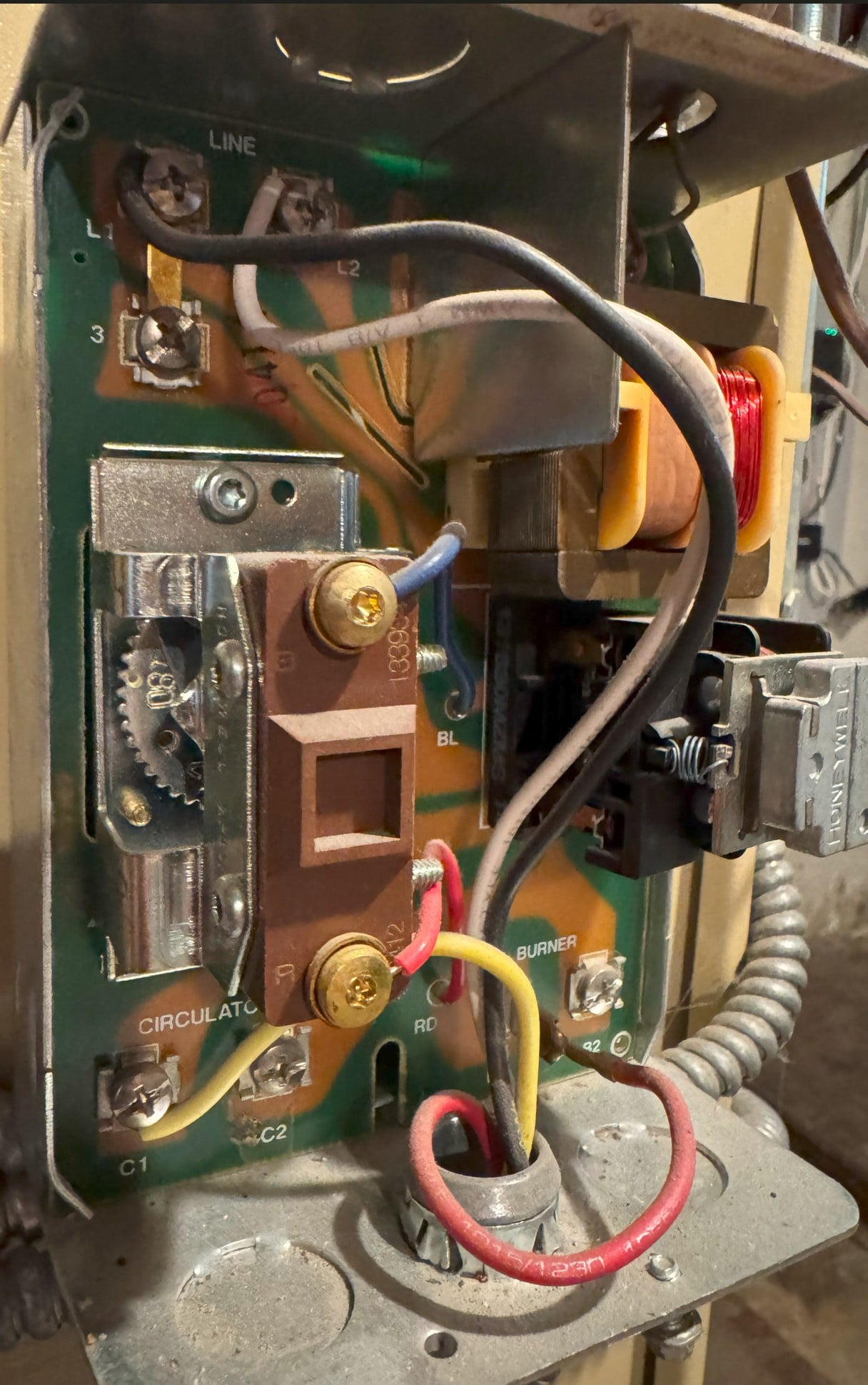

    what does it look like under the cover of the boiler aquastat?
    could be the circulator for the indirect isn't running and the boiler is just sitting at high limit and heating the tank by convection, possibly through the return if there is a functioning flow check in the circulator.

    Here is what the sequence of operation for your system should be.
    1. Start with a cold boiler on a summer day when there is no call for heat. The boiler should be the same temperature as the room the boiler occupies.
    2. The water heater is maintaining a temperature based on the setting of the water heater aquastat. (120°)
    3. The water heater temperature drops below the temperature set-point of the aquastat as a result of hot water use, or just because of off cycle loss over several (16 or more) hours of non use.  The aquastat calls for hot water
    4. The call for heat reaches the Taco SR 504 (or SR 506) control and the LED indicates that there is a call for DHW (Domestic Hot Water)
    5. The DHW circulator operates to move water from the boiler to the DHW tank
    6. The oil burner operates to heat the boiler water.
    7. The burner continues to operate until
      1. The call for DHW is satisfied and both the calculator pump and the burner stops.
      2. The high limit on the L8148 is reached and the burner stops but the circulator continues to operate until the call for heat is satisfied.
      3. The burner may restart once the boiler water temperature drops enough to allow the high limit to close contacts. The circulator is still operating.
    8. The call for DHW is satisfied and the burner and circulator both stop.
    9. The boiler temperature will slowly drop over time and eventually get to the room temperature of the boiler room.

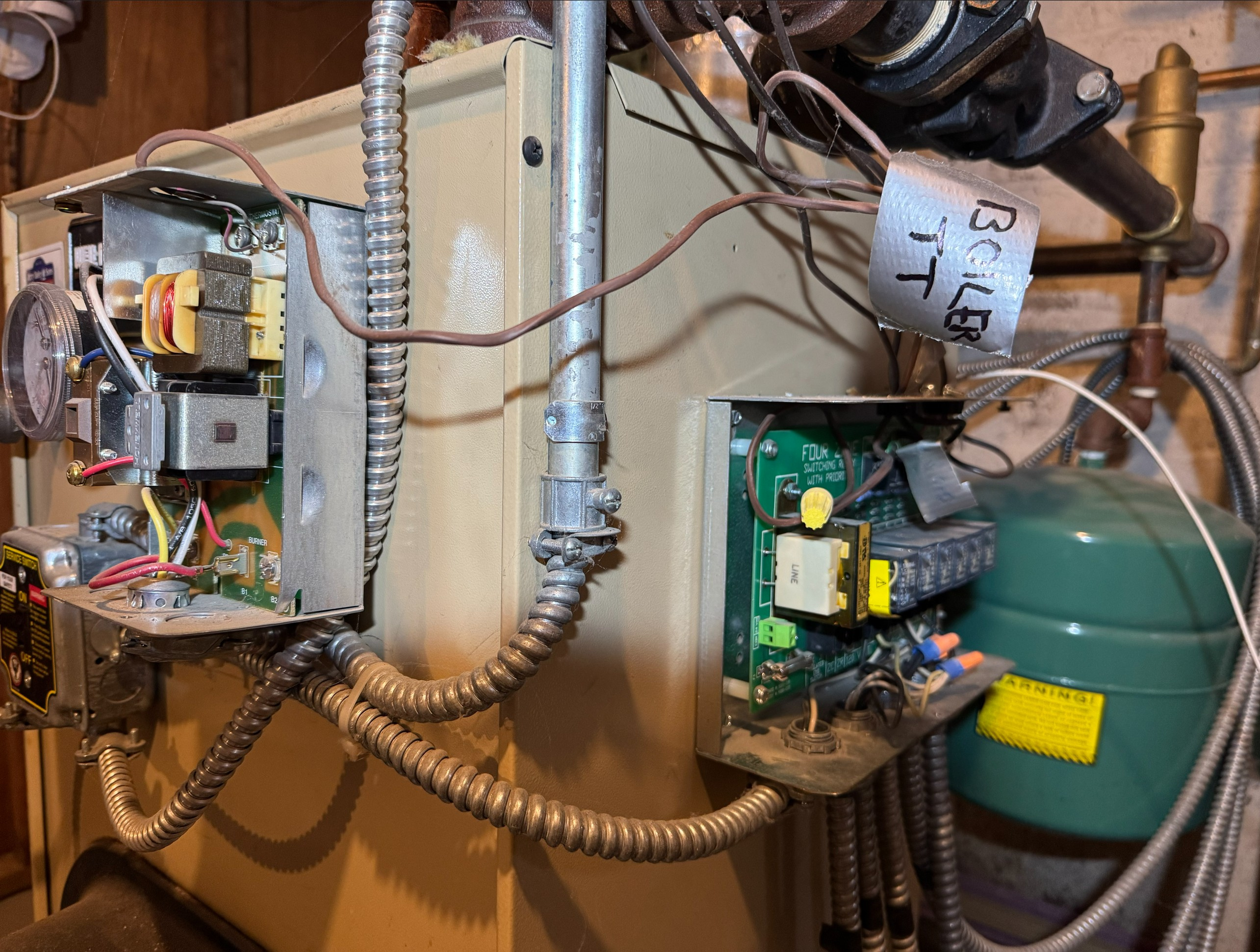

    My first step is to see if the circulator for the DHW is operating.  They are very quiet so I take a straw and use it like a stethoscope and place it on the pump motor and the other end close to my ear to see if I hear anything.  (unless you are in the medical field and you own a real stethoscope)
    If the circulator is not operating then I would check the wire that goes from X X on the Taco SR504 relay to the T T on the L8148 aquastat.  If that wire is damaged and connected (often called shorted) then that is the problem and the wire needs to be replaced.  You can test that by removing one of the low voltage wires from the T T on the L8148 aquastat if the burner continues to operate, then the L8148 is defective, if the burner stops operating then the wire is defective or the Taco SR504 X X terminals are defective.  To see if that is the case, I would need to see inside the cover of the Taco SR relay.

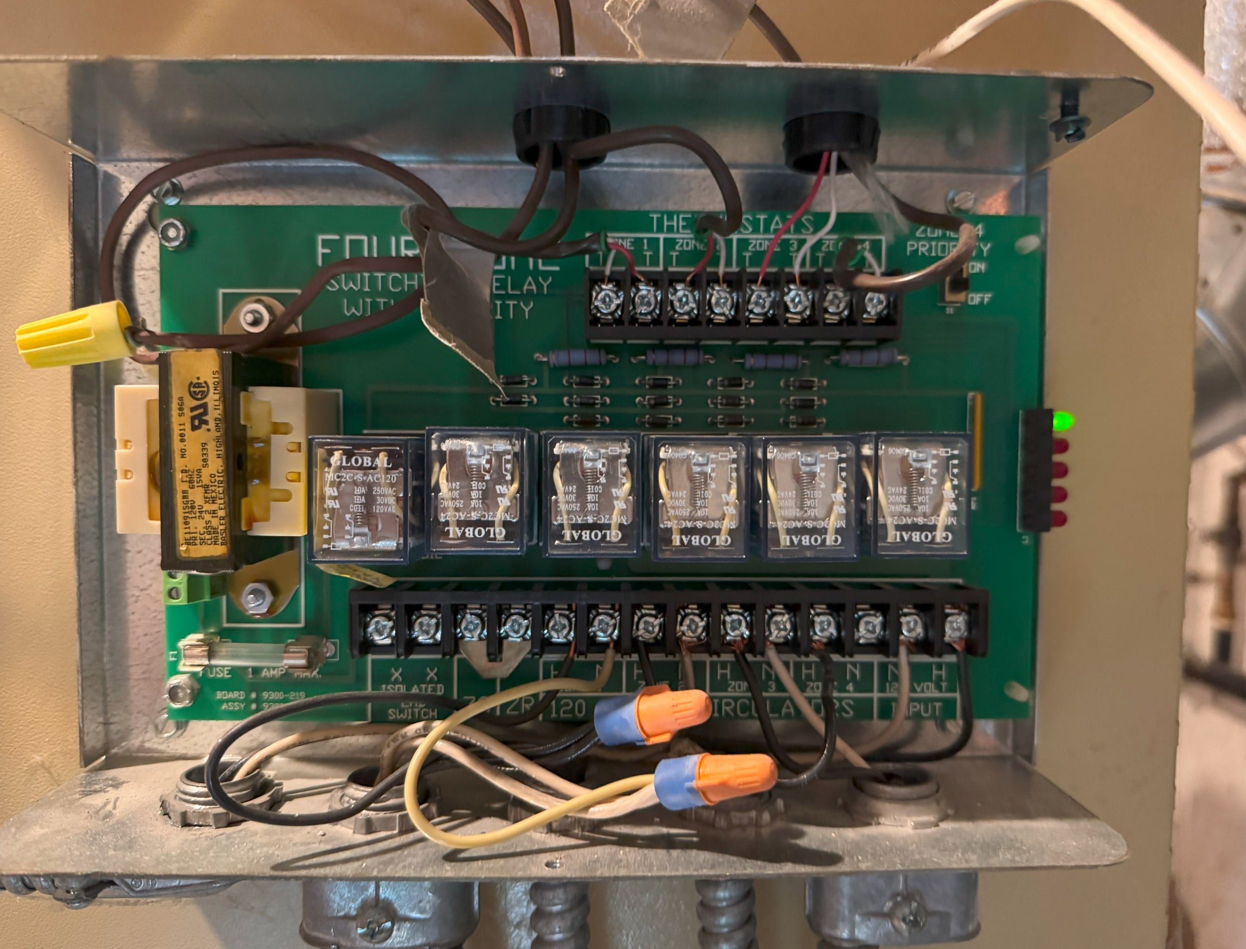

    Post a good quality picture of this box with the cover off. What zone indicators are on (if any) when you believe the boiler should not be firing but is.
    Is it easy to catch it in the act ? Do you have a multi-meter ?

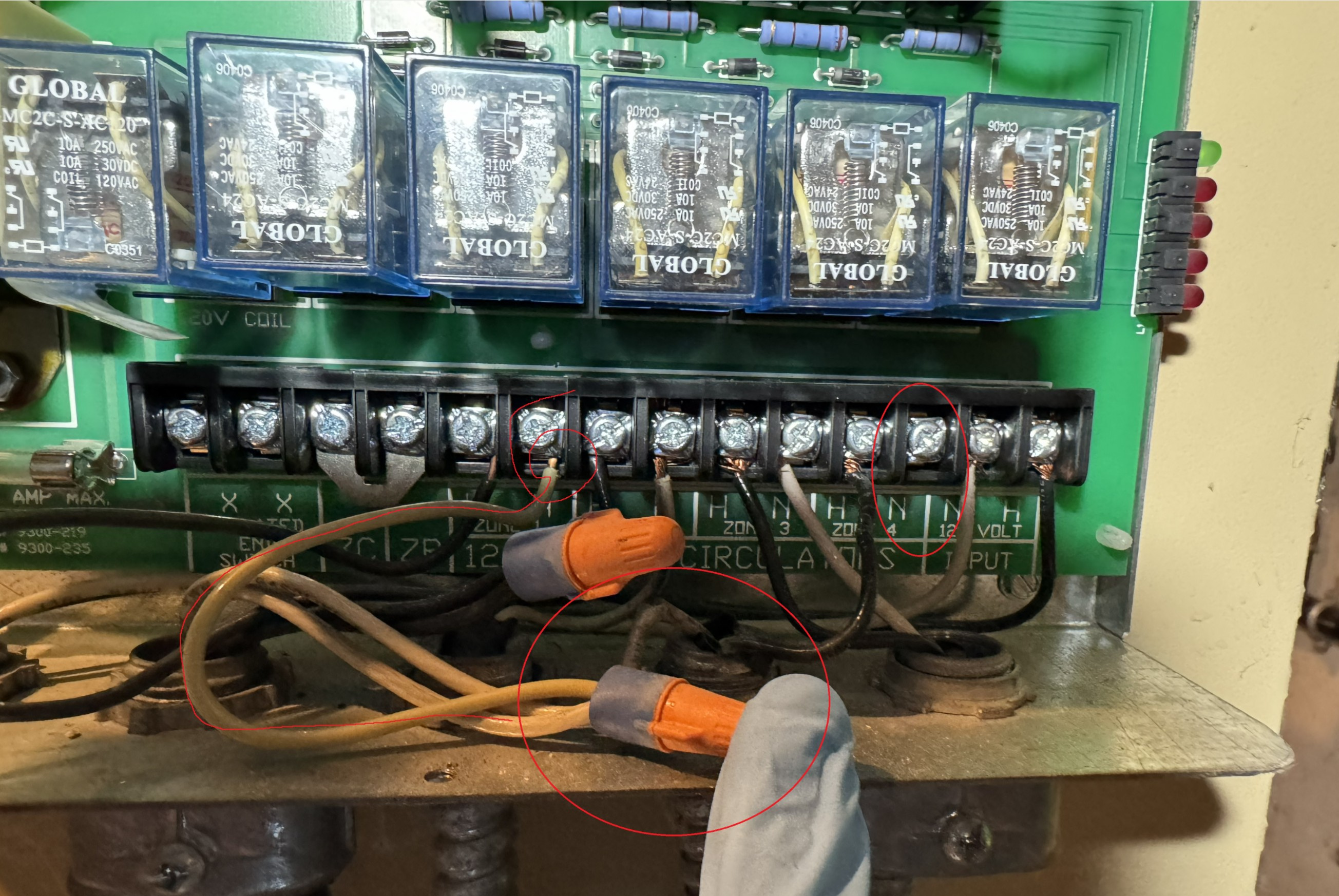

    There are 5 zones that go into the zone panel. Terminals XX in the Zone Panel should connect to TT in the aquastat, with nothing else attached. When the boiler is on, and nothing is calling, are any of the Red lights on at the zone panel?

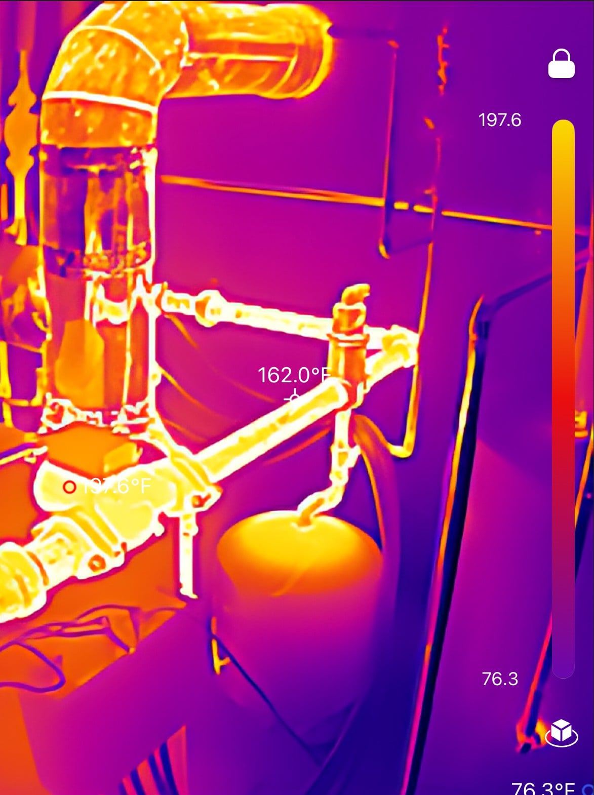

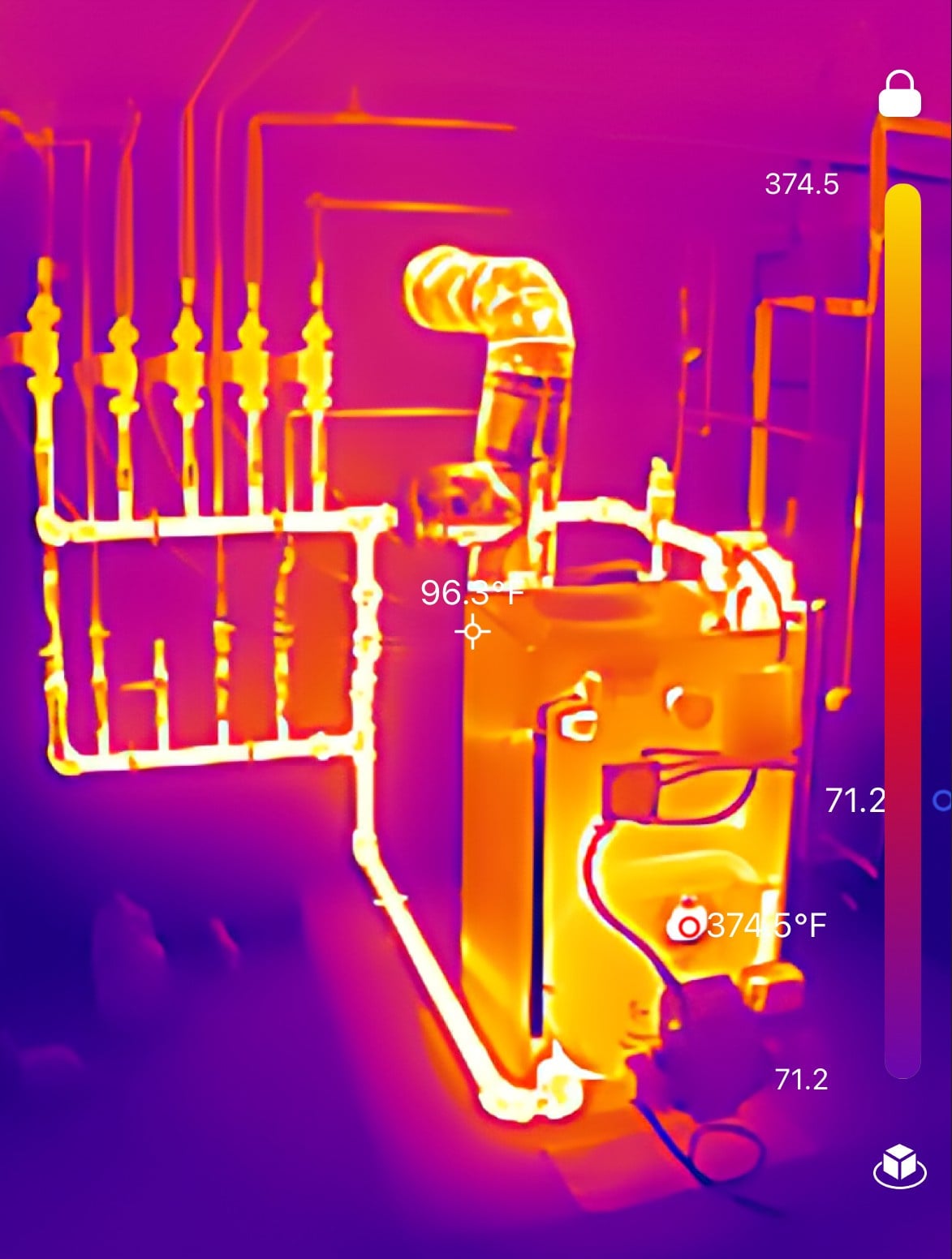

    You say when the burner is on, and there's no heat demand, "the ~180+ heat doesn't run past any zone circulators."
    C1 in the aquastat is connected to this circulator. Its got some type of bypass at the back wall. And that circulator is pumping into the expansion tank.
    If no Red lights are on at the zone panel, but the burner comes on, see if TT is closed. If yes, go to the zone panel, or there's an intermittent short between TT and XX. If no, bad aquastat. Though I've never seen an L8148 magically aquire a differential.

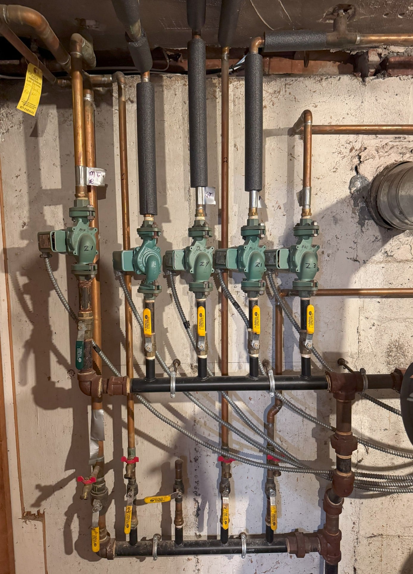

    At the zone panel, there are 5 BX cables feeding the 5 circulators. However, I only see 5 total low voltage wires going into the zone panel. There should be 6. 5 for the zone thermostats, and 1 for the isolated end switch between XX and TT. Something isn't wired correctly.

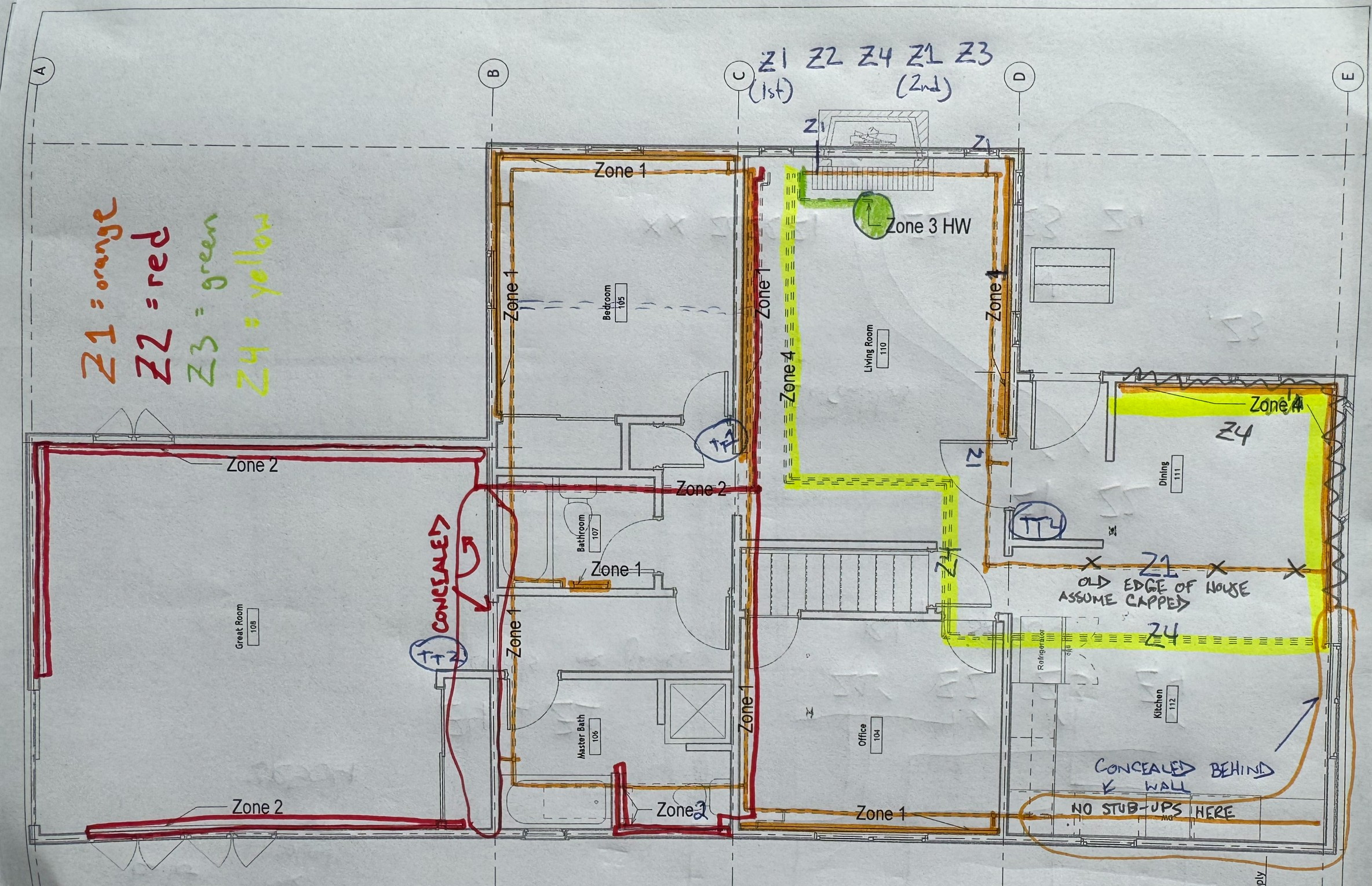

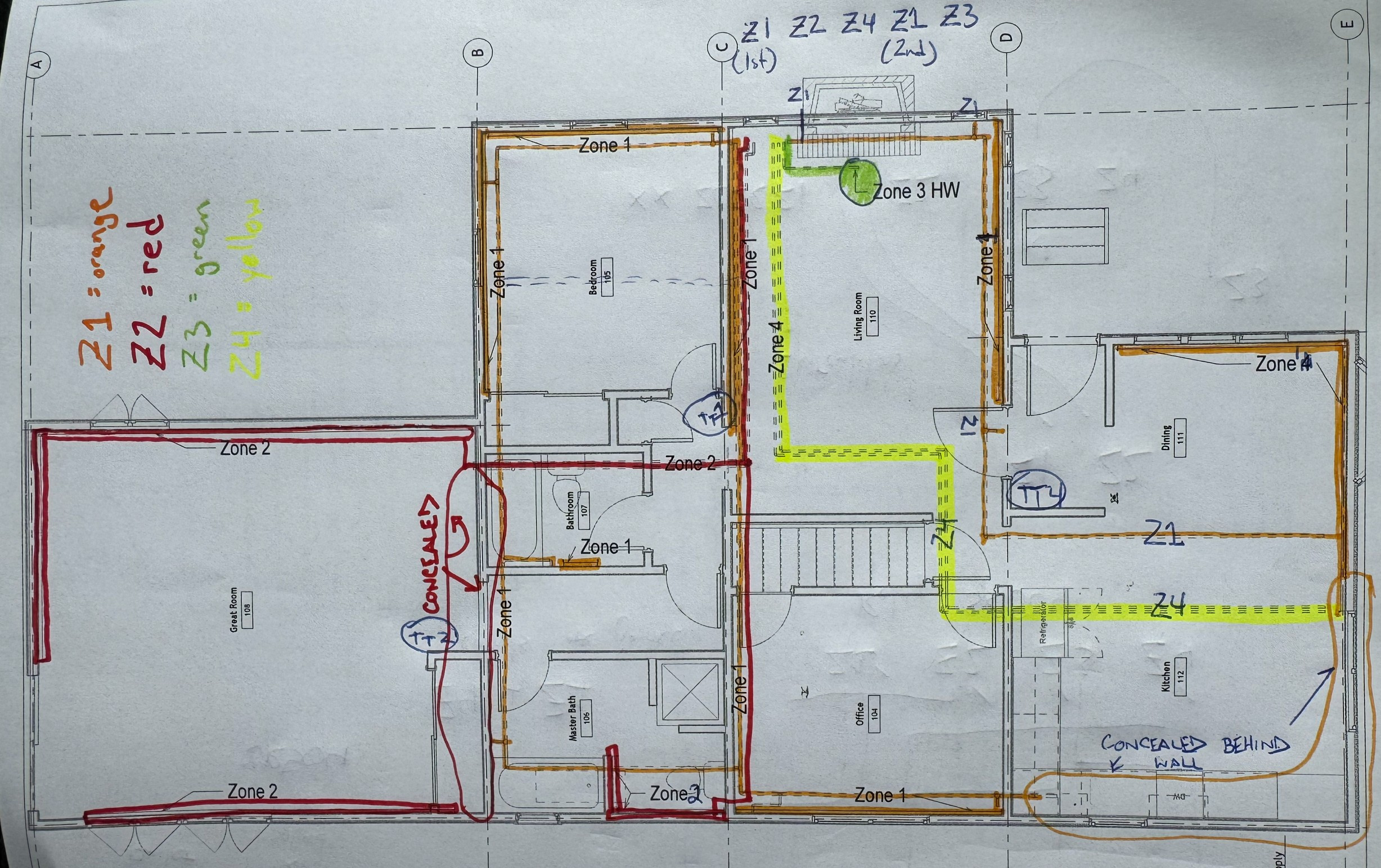

    Edit: Got curious and traced wires during a break. When we were buying the house we saw 2 apprentices replace the water heater in a rush.
    -Z1 = Hallway TT near Guest BR
    -Z2 = Addition TT
    -Z3 = HW tank
    -Z4 = Kitchen/dining TT
    Zone 4 priority is off. Isn't HW typically Z4 w/ priority?
    Thermostat wire from boiler is disconnected and capped.
    Outbound from SR504 to circulators:
    -Z1 goes to circulators leftmost and 2nd from right
    -Z2 goes to unmarked Z2 (addition)
    -Z3 goes to Z3 for HW
    -Z4 missing a neutral
    -The bypass circulator next to the boiler is only wired to bottom right part of the service switch?
    See attached. I took this while the boiler was firing, ~10min after showering. No zone lights are on. HW appears to be on Zone 4, but the pipes connecting to it were all room temp. It shut off after a few minutes.
    I'll try calling for heat from each thermostat after work to confirm the zone in the Taco matches the labels on the circulators.

    Connect t-t from the boiler to x-x on the zone control. for some reason they shorted t-t in the zone panel to keep the boiler at full temp constantly.

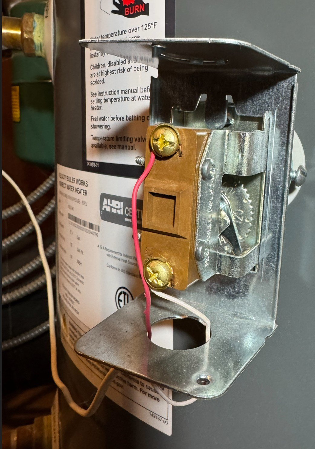

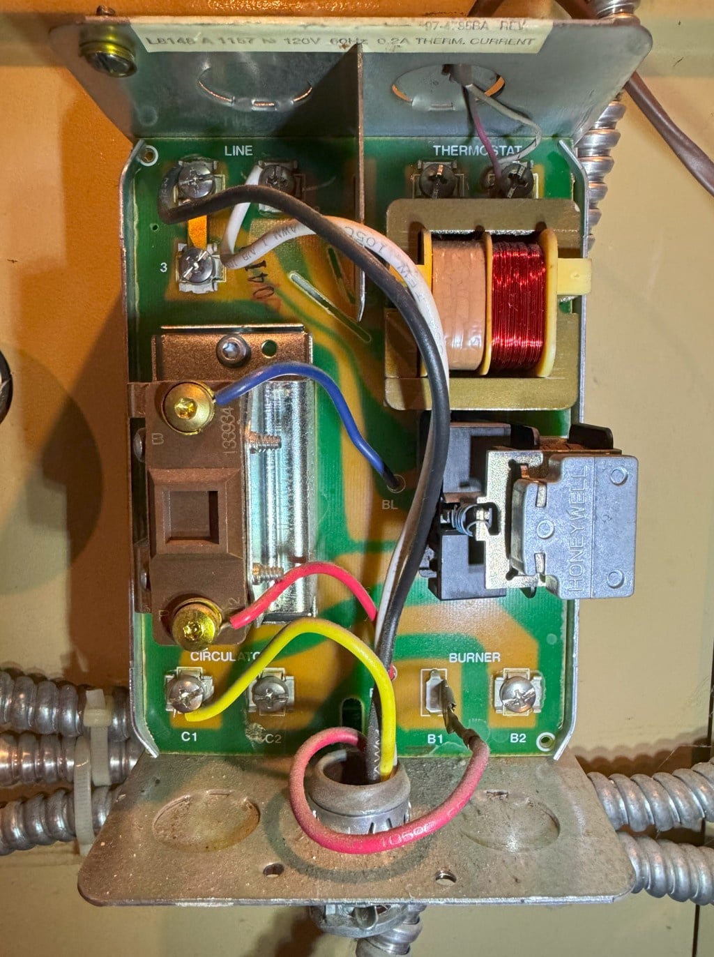

    Are these wires (1 each) connected to the thermostat terminals ? And not shorted inside the L8184A, by design or mistake ? Where does this cable go ? Those wires should go to the XX in the Taco SR504. There seems to be nothing on the XX terminals on the Taco SR504. From here it look like the wires that should go to the XX of the Taco SR504 are just connected together under the Yellow wire nut inside the Taco SR504. I would connect them to the XX terminals of the Taco SR504. If needed move the DHW to zone 4 (thermostat and circulator) and turn the priority on.
  • masscat
    masscat Posts: 14
    The 2 wires connected inside the top right terminal in L8148A are disconnected and capped inside the Taco SR504 (yellow cap). Any idea why someone would disconnect it? The manual cautioned not to if you have a 3-wire zone valve, but I don't see one on my system.
    109A_5 Posts: 4,759
    edited August 2025
    It appears you don't have any Zone Valves, systems usually have one method or the other, Zone Valves or zoning using circulators, yours uses circulators. The isolation your documentation requires is provided by the " X-X Isolated End Switch " terminals provided by the Taco SR504. The X-X Isolated End Switch is an isolated contact closure when one of the zones is calling for heat. That isolated contact closure is how the Taco SR504 tells the boiler to fire.
    I suspect one of two things why it was wired as found.
    Not enough DHW in the Winter so they forced the boiler to maintain 180 degrees with only the High Limit of the L8184A as the boilers temperature control. IMO that wastes a lot of fuel and adds to the wear and tear of the system.
    and/or
    They did not understand the Zone 4 priority for DHW, so in the Winter time there was insufficient DHW so keeping the boiler water at 180 degrees solved that issue at the price of a lot of fuel use to keep the boiler at 180 degrees constantly.
    As mentioned above I would connect the L8184A thermostat terminals (T-T) to the Taco SR504 X-X Isolated End Switch terminals and move the DHW thermostat and circulator wiring to Zone 4 and turn the priority switch on.

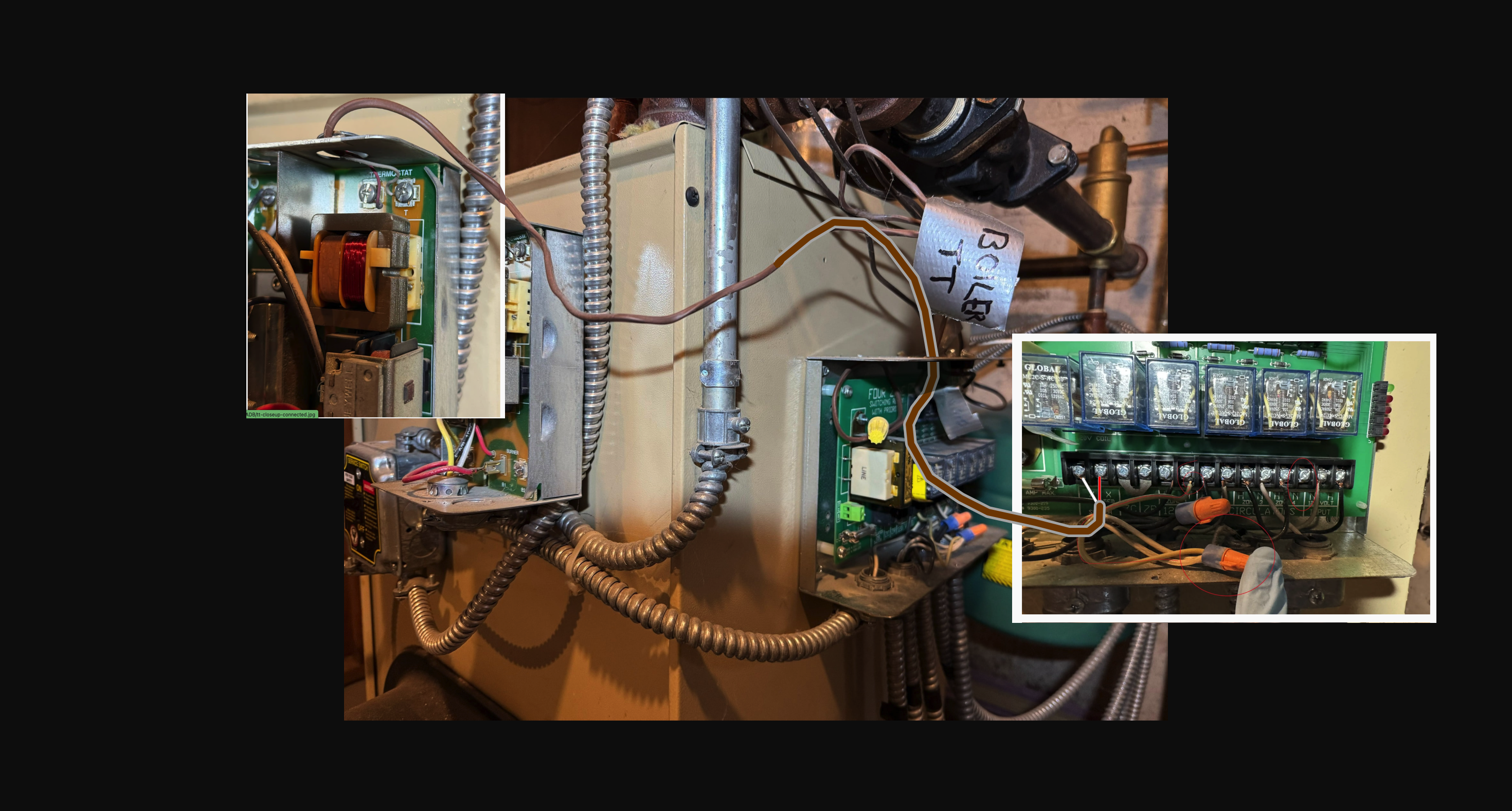

    Another thought;
    I saw a stray or spare relay on top of the Taco SR504's cabinet. If the relay that provides the " X-X Isolated End Switch " functionality is defective or the Taco SR504 is defective not providing the " X-X Isolated End Switch " functionality, connecting the L8184A thermostat terminals (T-T) wires together inside the SR504 may have been a quick and dirty fix.
    IIRC the relays are not all the same (however that may be a different model). Maybe the replacement relay was wrong and did not function correctly.
    It may have been done in the hopes that no one would notice. But you did notice.
    dxfhczz
    109A_5 Posts: 4,759
    Yet another possible scenario. Possibly a troubleshooting attempt that was basically not fully completed.
    See image below. Since the L8184A Aquastats have a known issue of the solder joints (on the other side of the circuit board near the Orange arrows) fail where the relay (Red box) is soldered to the circuit board. It often starts out as an intermittent firing situation.
    With the L8184A thermostat terminals (T-T) connected together (Yellow wire nut) inside the Taco SR504, if the boiler runs continuously with only the high limit (180 degrees) interrupting the boiler's firing the L8184A's relay solder joints are probably OK.
    Since the DHW does not appear to be on Zone 4, the previously posted scenarios may be more plausible, the Taco SR504 was just not installed correctly, so the 'Fix' (for possible insufficient DHW) they came up with was goofy too.
    BTW (possible information for the future) should the L8184A's relay solder joints eventually dilapidate, they are easy to repair if you have the tools and skills. However most of the time the Aquastat is just replaced.

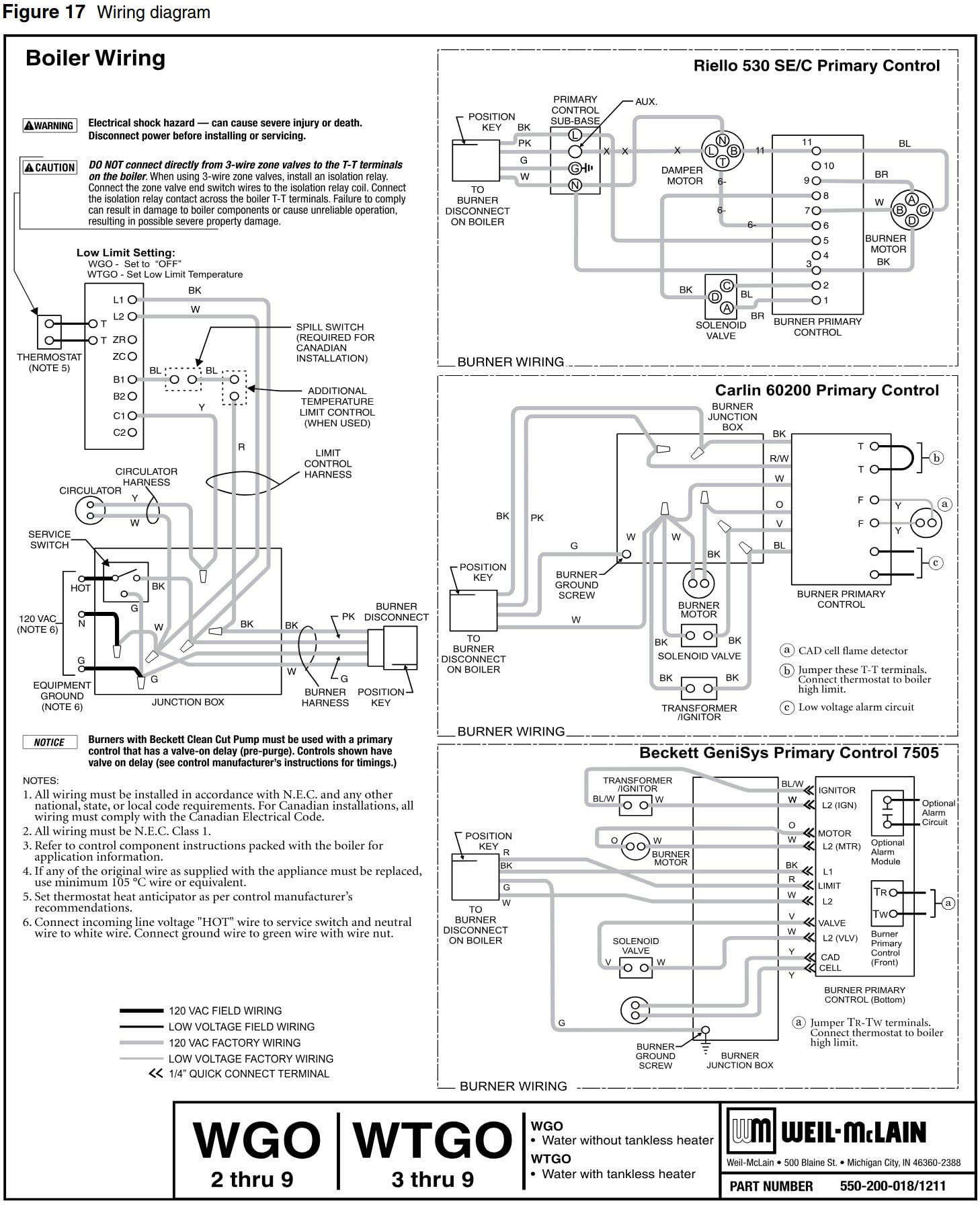

    P.S. I was reviewing the installation manual for the WH and noticed the 1st wiring diagram/install option is a non-priority configuration (priority is the next page). Makes me wonder if that's why it was installed that way.

    Yeah, when installing equipment the installer should find the correct diagrams that best fits the system, otherwise things may not work correctly.
    I believe it should look something like this (edited from other drawings). Is there 2 circulators on Zone 1 ? That may shorten the life of that relay.
    Also there appears to be a Neutral (white) wire missing (Red arrow), maybe it is under the wire nut (Yellow arrow) and I can't see it, maybe it is connected elsewhere. (You did list this earlier, I missed it) Does that circulator presently connected to Zone 4 work ?
    Shut the power off before doing the rework.
    I would probably just connect X-X to T-T and swap Zone 3 and Zone 4 (circulator and thermostat wiring), turn the priority on.
    Find the missing Neutral and/or find out what's going on with that. Make sure that circulator works correctly.
    Then see how it all works.
    Also the boiler's circulator is controlled by the L8148A Aquastat, Yellow wire C1 (Red arrow). I suspect the boiler's circulator was running continuously too with the T-T connected under the wire nut. The 180 degree High Limit (the Brown Microswitch connected with the Blue and Red wires) only shuts the burner down not the circulator. When you get it all working as it should be working, your electric bill may go down a bit too.
    109A_5 Posts: 4,759
    " P.S. I was reviewing the installation manual for the WH and noticed the 1st wiring diagram/install option is a non-priority configuration (priority is the next page). Makes me wonder if that's why it was installed that way. "
    Maybe the manual I found is different than yours. The first drawing in this manual states "Non-Priority" and uses circulators, however in this second drawing it uses Zone Valves. If this diagram (or one like it) was used it may have been confusing, I don't see any provision for DHW priority in this second drawing.
    Item C. below (Red arrow) should have been consulted.
    However your Taco SR504 is the older version so some of the connections are in different places, if you don't have the older documentation. I like the older version better since it has easily replaceable relays in sockets, with the newer version the relays are soldered to the circuit board.

    Sorry for the long period without updates. I put this off until today because of other house problems. I re-read everything and re-verified how the system is setup (traced lines, etc).
    3 neutrals are combined under the Z1 neutral spot in the zone relay. 2 for separate Z1 circulators, and 1 Z4 circulator. See photo. I'm planning to re-wire it. I know the Z4 circulator works because it's to 1 radiator in our dining room.
    The water heater was installed before we closed on the house. Is it possible previous owners disconnected the thermostat from X-X and switched zones 3 & 4 as a workaround for a failing water heater? They also had the anti-scald for a shower too low (since fixed).
    The house: 1400sf built 1950 w/ 1 major addition and an enclosed porch (120sf) to expand the kitchen/dining room.
    Z1 is ~60% of the house
    Z2 is the 400sf addition
    Z3 is HW
    Z4 (Edit: This is a homerun to the radiators in the enclosed porch. See updated plan)
    -TT from boiler is disconnected and capped instead of being connected to the isolated end swich
    -Z4 priority is shut off
    Boiler and HW overall.jpg TT from boiler and disconnected capped XX.jpg 3 combined neutrals z1 and z4.jpg Aquastat cover off.jpg water heater cover off.jpg TT closeup connected.jpg Layout piping-r1.jpg

    Edit: Works as expected now! Boiler kicked on for Z4 WH on priority while running laundry. Started at 60F and shut off while I stepped out (at 160F now).
    Got to try out my clamp meter! I shut power at the boiler service switch and breaker, but wanted to verify.
    Waited 1hr after separating the X-X wires. Boiler didn't fire, despite L2 call for heat and circulator was working. Z4 called for heat 50min in w/ circulator working, but boiler didn't fire despite dropping to 120F.
    Boiler fired after connecting T-T to X-X and calling for heat by raising Z4 thermostat. Swapped WH to Z4 and turned on priority.

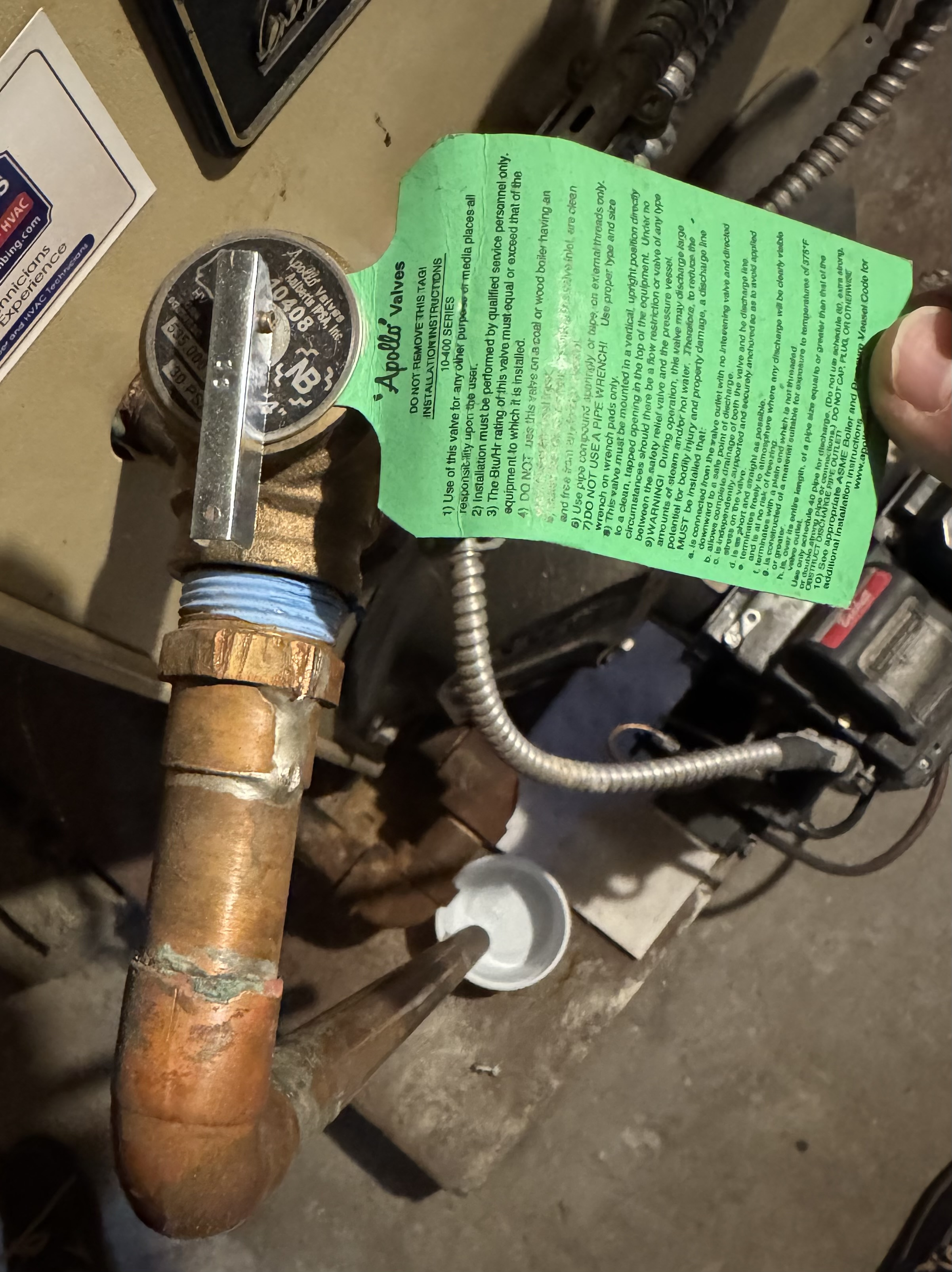

    Today I noticed the boiler pressure relief valve has some water dripping out of it. I never noticed this before. Maybe it always dried before puddling.

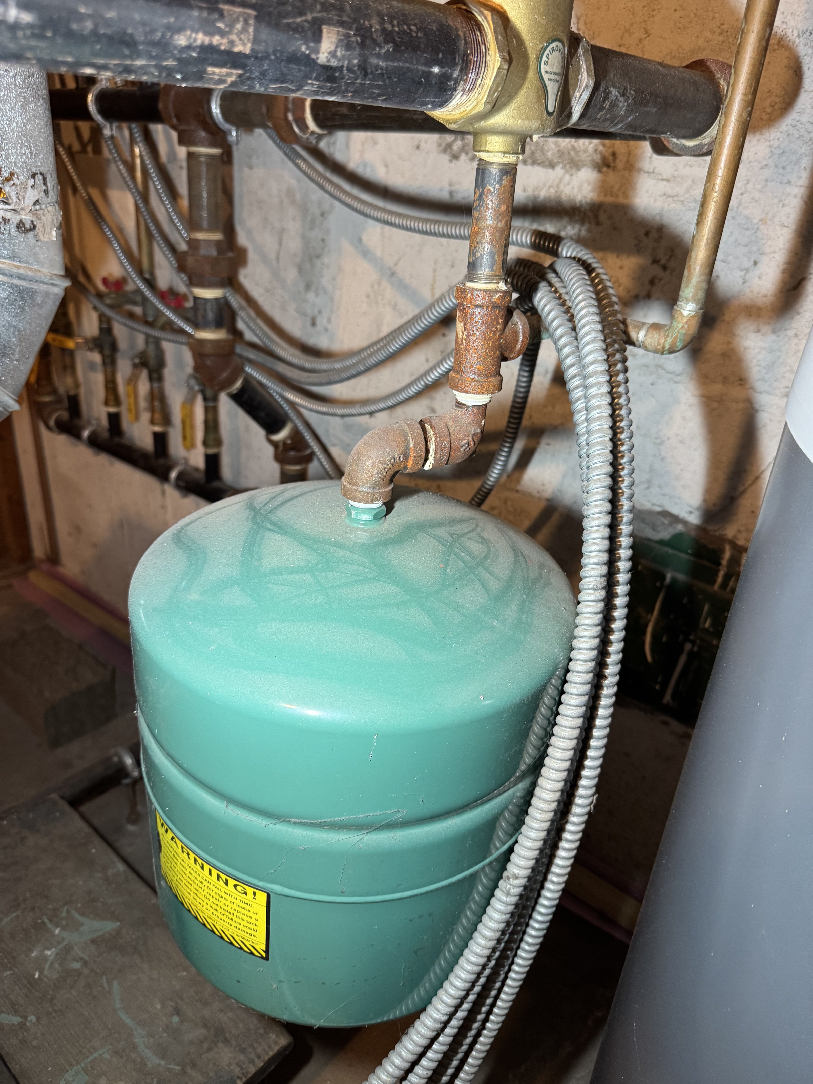

    Is it possible the expansion tank needs to be replaced? Date of manufacture 12/11. 4.5gallon Flex 2 Pro HTX 30. 5yr warranty. I didn’t think they lasted 15yrs. When tapped the expansion tank didn’t sound hollow.
    The relief valve was replaced 4yrs ago.
    Boiler pressure is ~20psi, valve rated for 30psi.
    HVACNUT Posts: 7,784
    There's only one way to find out. Drop the boiler pressure, remove the tank and test it.
