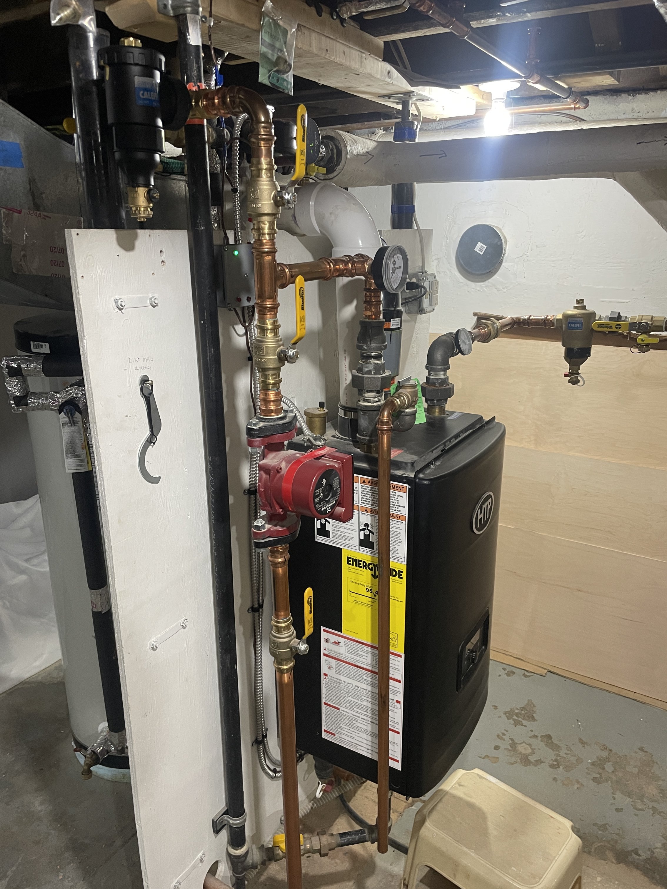

Actually I bought TWO of these UFT-100Ws, for $1,000 each. Our 50 yr old boiler went kaput in March and I am going to try to DIY my way into a heated home over the next few weeks.
They haven't arrived yet but the seller said they were manufactured in 2020 or later, so I am assuming they won't have the control board problems I have read about on here. I will check the info when they arrive to confirm. I know I probably won't qualify for any warranty for these discontinued units purchased on ebay, but $2k for TWO boilers was hard to beat. They are advertised as brand new, unopened. Pictures look like this is true and I will confirm of course.
I am planning to install them in a cascade setup so the heating load is shared between the two, and so that if I have to service one, I can bypass it and still have heat. My calculated heat load is about 93k BTU (DIY manual J and HDD methods both agree), so the pair of these will provide more than enough for the coldest days. The EDRs of all our rads can't even put out more than 130k at 180 degrees, so I am certain these two 100k boilers will be much more than enough, haha. But with the modulation, cascade mode, outdoor reset, etc etc they should do a good job of keeping everything efficient.
On a scale of 1 to 10, how dumb was this purchase?

    If you want fancy control i'd go with a viessman or lochinvar of the appropriate size. the control on the uft can do some stuff but it is fairly limited.
    hot_rod Member Posts: 28,078
    Doesn’t sound like often, maybe ever, both boilers will need to fire?

    I have UFT-80 installed in my home and picked up a second one cheap as spare. Pretty simple install, just follow the manual. I'd install the single unit and keep second for hot spare. Use the time and $ you save to improve the air sealing and insulation of the home envelope. Will pay off all year long.
    Be sure to install a DirtMag prior to the boiler.
  • GroundUp
    GroundUp Member Posts: 2,544
    Fair price IMO. I was paying about $1800 for a 100W in 2019 when I stopped using them but as long as you don't have all low temp radiant or need any tech support, they're a pretty good boiler. As was mentioned above, I'd probably just install one with unions and keep the second for parts/spare rather than a cascaded system but you're welcome to do as you please.

    I ended up deciding to only install the one boiler and keep the second in storage after y'all's discussion. Thanks!
    Also it's the first week of November in southern Ohio and I'm still working on this hahahaha. I just posted a LONG thread about the saga of cleaning out my old existing system.
    I have the boiler hung and the gas and the intake and exhaust done. Started the piping panel, after that just have electric, condensate and commissioning. Then later the zones I am adding on to parts of the house we have heated with space heaters for the last 7 years (our winter bills have been crazy for a long time!!!).
  • RickT
    RickT Member Posts: 87
    Finally got this thing installed and up and running. It was too cold to wait for the very busy tech I want to come check my work later this week, but it seems to be working flawlessly.

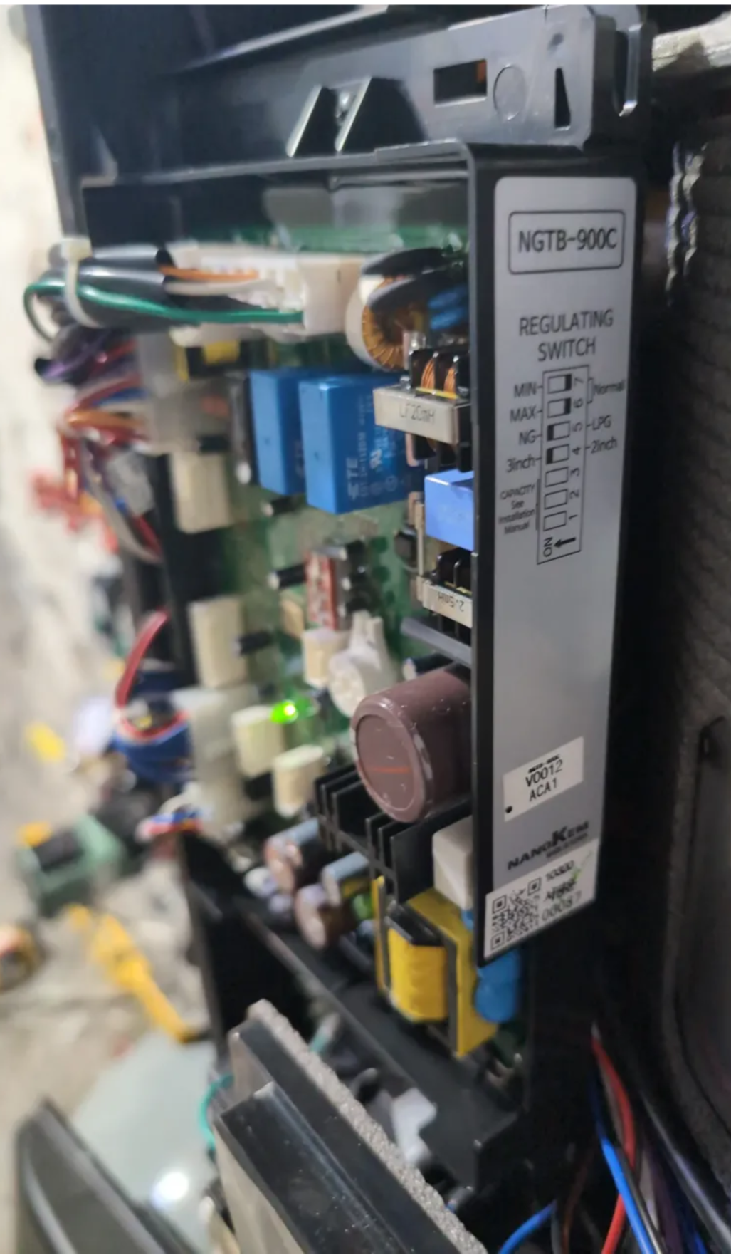

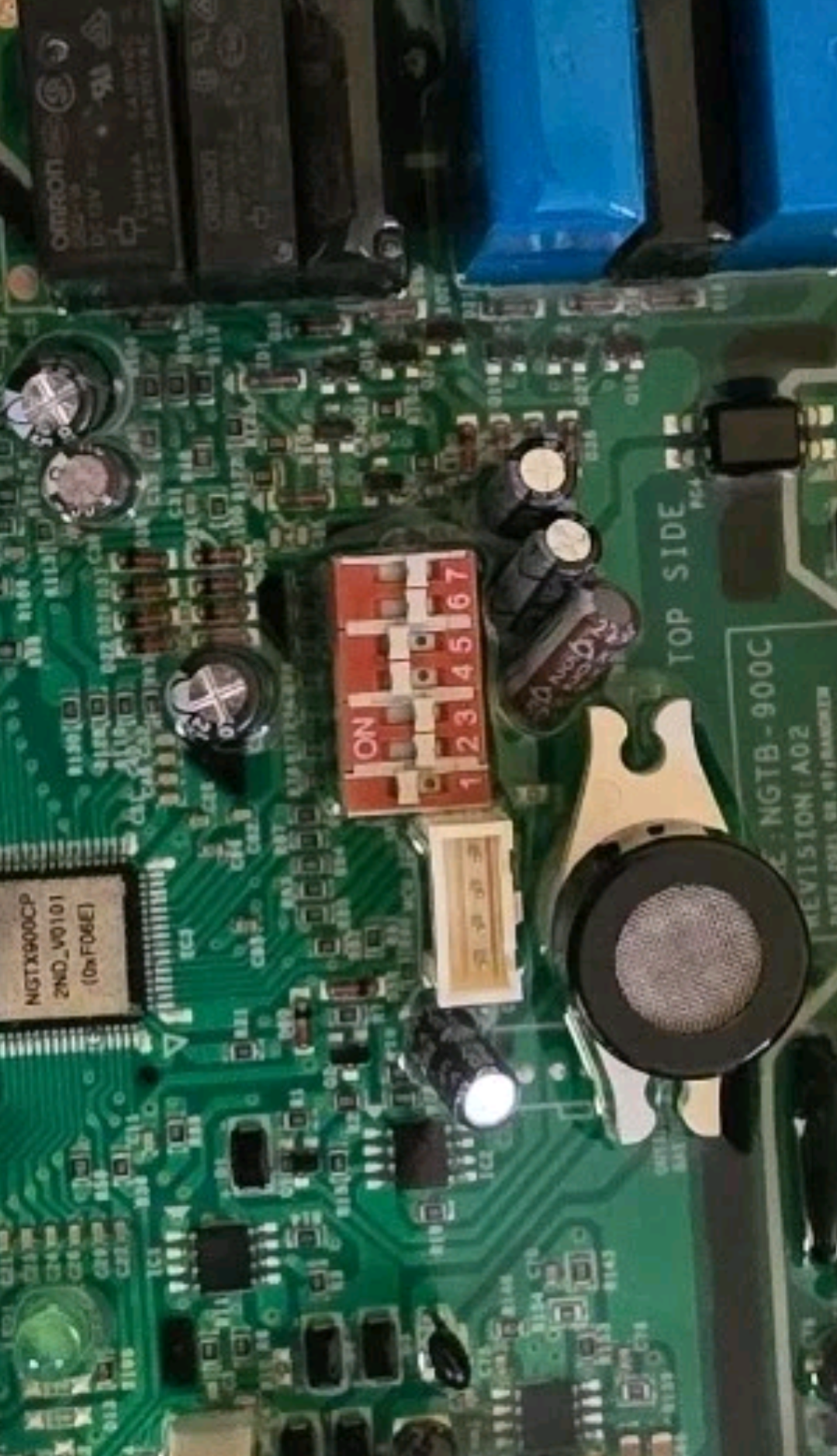

    However I cannot for the life of me find the friggin DIP switches. Can anyone tell me where they are on this boiler (HTP UFT 100W)? I've looked everywhere. I need to switch one from 3" vent to 2" vent. I found a DIAGRAM of the DIP switches on the PCB housing!!! But for the life of me I can't find the actual switches. There is nothing in the manual showing where they actually are, it just says how to set them properly.
  • RickT
    Ugh I'm an idiot nevermind.
