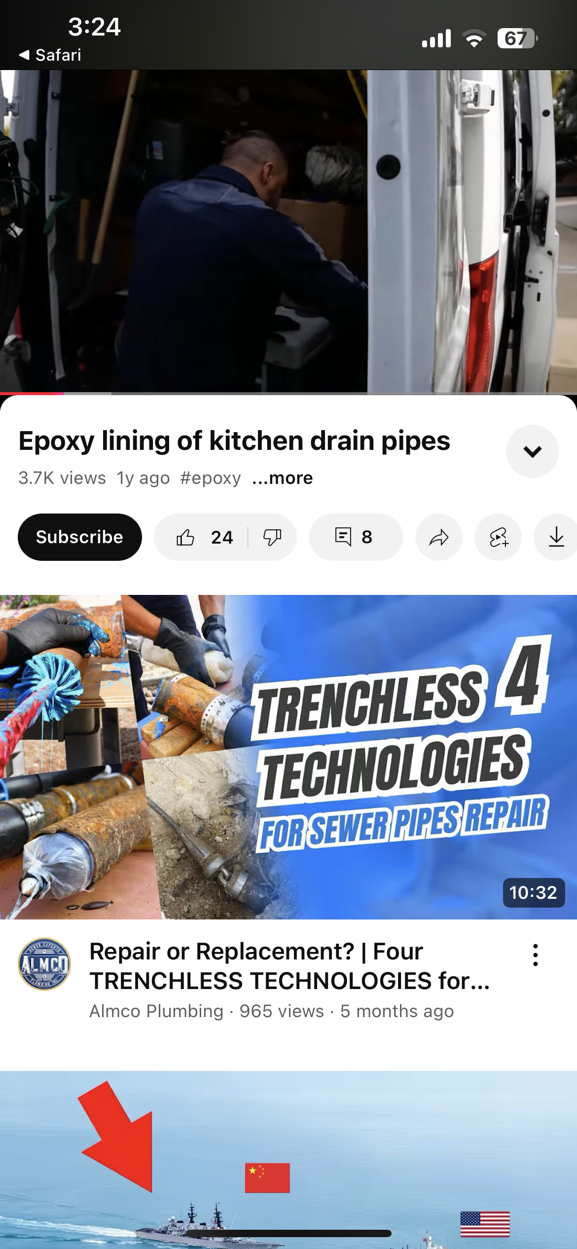

4. finally, I understand from researching online there is some possibility or re-sleeving the existing drain (depending on diameter and direction/turns) with a narrower pipe, or an epoxy-coated liner, but these seem to be not recommended due to long term reliability concerns…?

    lots of options for relining 2” pipe also. Many You Tube videos show the methods
