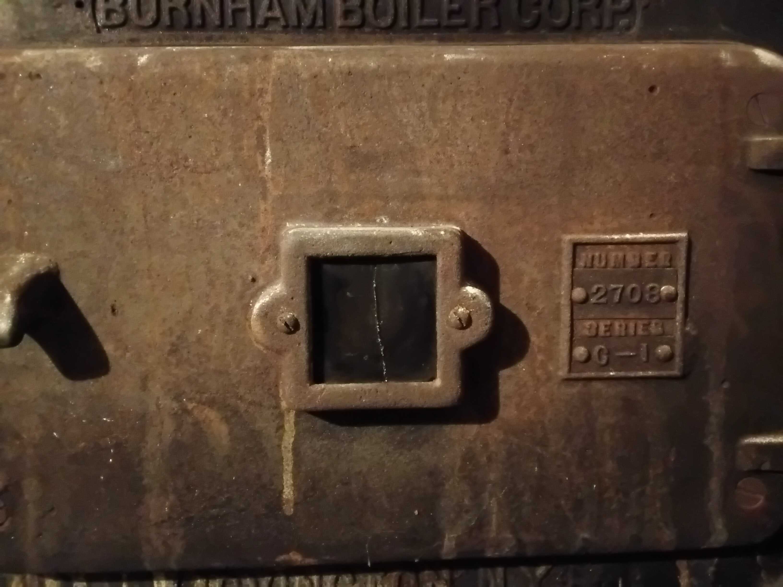

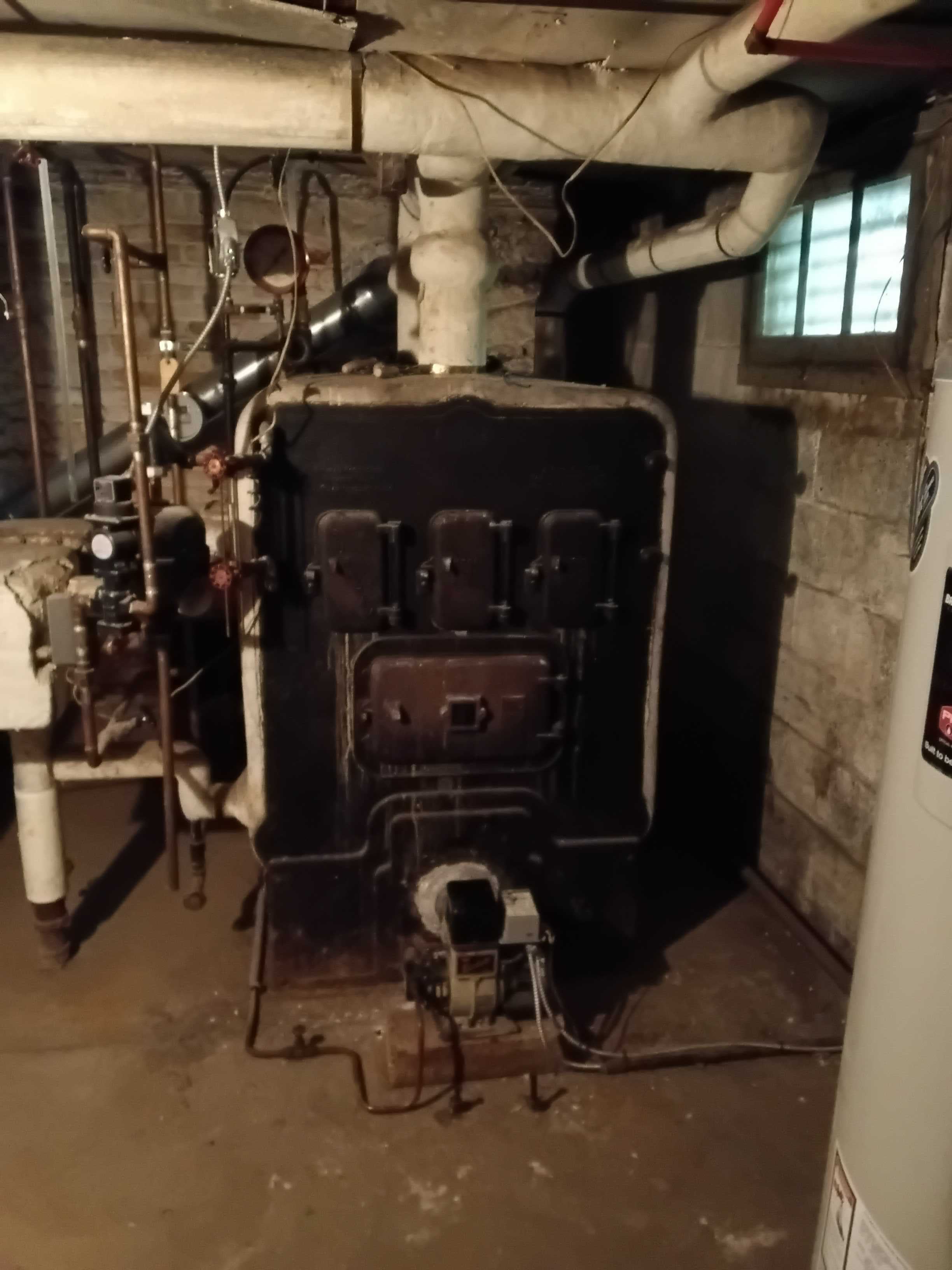

I recently purchased a house that has quite a history. Original house was built in 1820, but redone in 1933. A newer section was constructed in the 80's. The older section (approximately 3800 sq feet is currently heated by a Series G-1 Number 2708 (Included pictures of the boiler and the data plate in this message). I've been attempting to find out more information on the unit without success. I found a post with a catalog https://www.heatinghelp.com/assets/documents/185.pdf
but I can't correlate what I see on the data plate with what is in the catalog. Can anyone assist me in finding information on the unit / understanding the spec sheet? I am seriously considering replacing it with a modern unit as my heating bill was quite large. I'd like to know more information about how it is currently sized to compare it with my notes for selecting / deciding about a replacement.
The system is a 1 pipe setup with two feeds and two returns, one for the back of the house and one for the front. The burner has a 2 GPH nozzle on it.
Some thoughts that I had that I would like to double check if my logic is sound
When the heat was running during the winter, standing in the boiler room, it must have been 100 degrees. Seems to me that if the boiler is outputting that much heat into the room, its heat that's not heating my house (while a basement shouldn't be freezing, I don't need it to be a sauna).
I am aware that the boiler and pipes are asbestos covered and that would need to be remediated for any replacement plan. I am also understanding that getting the old boiler out of the basement is going to be fun (but its something I have accounted for).
The boiler must have at least a hundred galloons of water its heating up before it can make steam, it seems as if the newer boilers have significantly less water capacity which means they spend less money heating water mass before they make steam.
My main purpose right now is to decrease my oil usage and increase the temperature that the house can be set to.

    EdTheHeaterMan Posts: 12,896
    You don't need to know anything about that old boiler to replace it with a new boiler.  You need to find out how much equivalent direct radiation is connected to that old burnham.  With that info, you can select the proper replacement  boiler

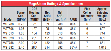

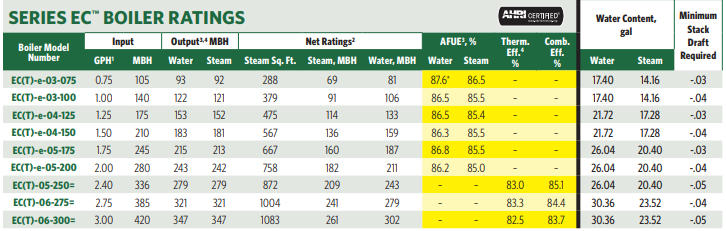

    I measured a requirement of 634, but the closest boilers between MegaSteam and Peerless are 629, 667, and 758
    I was leaning towards the megasteam boiler, but it makes me round up to a higher btu output then the peerless, not sure if that means that the megasteam would just significantly higher or if it would just run for slightly shorter and heat up faster (which would make the additional btu a wash)
    and what do you mean by perfect? or are you saying that there is more margin with a 2 pipe and a 1 pipe has to be sized correctly as an undersized system will no heat the end radiators

    Ok, so it seems like an MST 629 with 629 square feet of steam to fill 634 would work (my math says it would be 898 square feet without the pickup factor)
    Does anyone have any recommendations between the peerless and the megasteam? The megasteam seemed to be a newer design which is why I was leaning towards it, but that opinion isn't really informed by very much.
    Also if I have an third story that is finished, but I am currently using as more of an attic. Could I turn off some of the radiators in that space to gain some cost back? I don't want to heat that space to the same degree so I was hoping I could shut off one or two of the radiators. No idea if that would accomplish anything. If I am reading how a 1 pipe system works shutting off radiators would lower the total volume of steam and should decrease the time the boiler is on (even if only by a little).

    The Megasteam is supposed to be the better boiler. I have no experience with it but I dislike anything with the Burnham name.
    Steamhead Posts: 18,993
    If that were my house, I'd go with the MegaSteam.

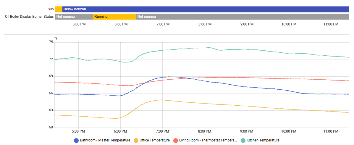

  • When I said doesn't heat well, most of the rooms hold temperature for about an hour, in which time the boiler has cooled down enough where it takes 30 to 40 minutes to make steam. If I ran it to keep those room perfect, it would be running about half the day.
    The room where the thermostat is holds heat much better, so it doesn't turn the boiler on very often.
    The rooms holding heat better is clearly not the boilers fault, but if the boiler heated up more quickly then I would be spending less oil to get heat to the rooms. So I'm attacking it from two angles, I would like to get the boiler better and I need to fix the rooms to reduce the heat loss.
    I was wondering if I might have a main venting issue, as the vents seem undersized. Is there a recommend method for testing to see how well the mains are vented?
    As for the other stuff, I'm open to trying pretty much anything. I would say that I'm pretty mechanically inclined, but am new to steam.

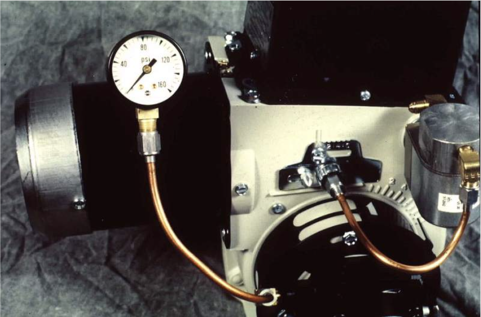

    How do I know what pressure the nozzle is getting to know if its a 2 gph at a higher pressure?

    @os2man4 asked: "How do I know what pressure the nozzle is getting to know if its a 2 gph at a higher pressure?"
    A zero to 200 (or 300) pressure gauge in connected to the high pressure line of the fuel pump. Operate the pump and adjust the pressure adjusting screw on the fuel pump as needed.
    Gauge must be equipped with flare adaptor to do this test.

    Might be a good idea to move the thermostat, or, switch to one that allows a wireless sensor, to a cooler room that doesn't hold heat well. Then install a TRV in the current thermostat room that does stay warm, as well as any other rooms that tend to stay warm. This will get the boiler running more often, and hold back the rooms that don't need heat.
    The Honeywell Prestige allows wireless sensors, as well as running 2 and 3 CPH, which will make it run more often. I'd recommend 2 CPH for you, 3 will probably be a little too touchy. The more often the boiler runs, the faster it'll make steam each time.
    mattmia2 Posts: 18,303
    edited December 2025
    Sounds more like you need to balance the system better. Faster vents on the slower to heat rooms, slower vents on the fast heating rooms.
    How long does it take from when the boiler starts making steam to when the ends of the mains get hot and does it happen within a few minutes of each other? You need to vent the mains as fast as possible but also balanced before you can balance the radiators.
    The speed the mains can heat is limited by the mass of the mains, the steam needs to get the main steam hot where the steam currently is before the steam can move further along the main.

    I've been doing more digging, not sure if this is worth the electrons…. but its cool to me. I might even be right!
    My boiler is a 2708 which was a Series G Sectional. It was designed to be built as needed and could be ordered in 5 - 12 sections (seems like the 5 section was only offered certain years).
    They also offered a Coal A Series version. The middle sections were the same between the two boilers and you ordered an S27## for Smokeless Coal and O27## for Oil and they shipped for assembly a different base for the different fuels and a different fuel door. It was assembled on site as there is no way you are moving this thing once its put together.
    The numbers we were looking at were for the Smokeless Coal version that specific 1500 square feet of EDR. My boiler is a O2708 which means it outputs 1945 EDR at 5.18 GPH. So my boiler is just a tad oversized (more then we originally thought) for a 745 EDR load. 🤣 It seems like the catalogs gave the low number and then when you ordered it the specific versions for oil had a higher rating for the same size.
    I have no idea why in the catalogs and spec sheets reference S and O, but the boilers are labeled A for Coal and G for Oil.
    I tried calling Burnham, but they did not have any information on either unit.
