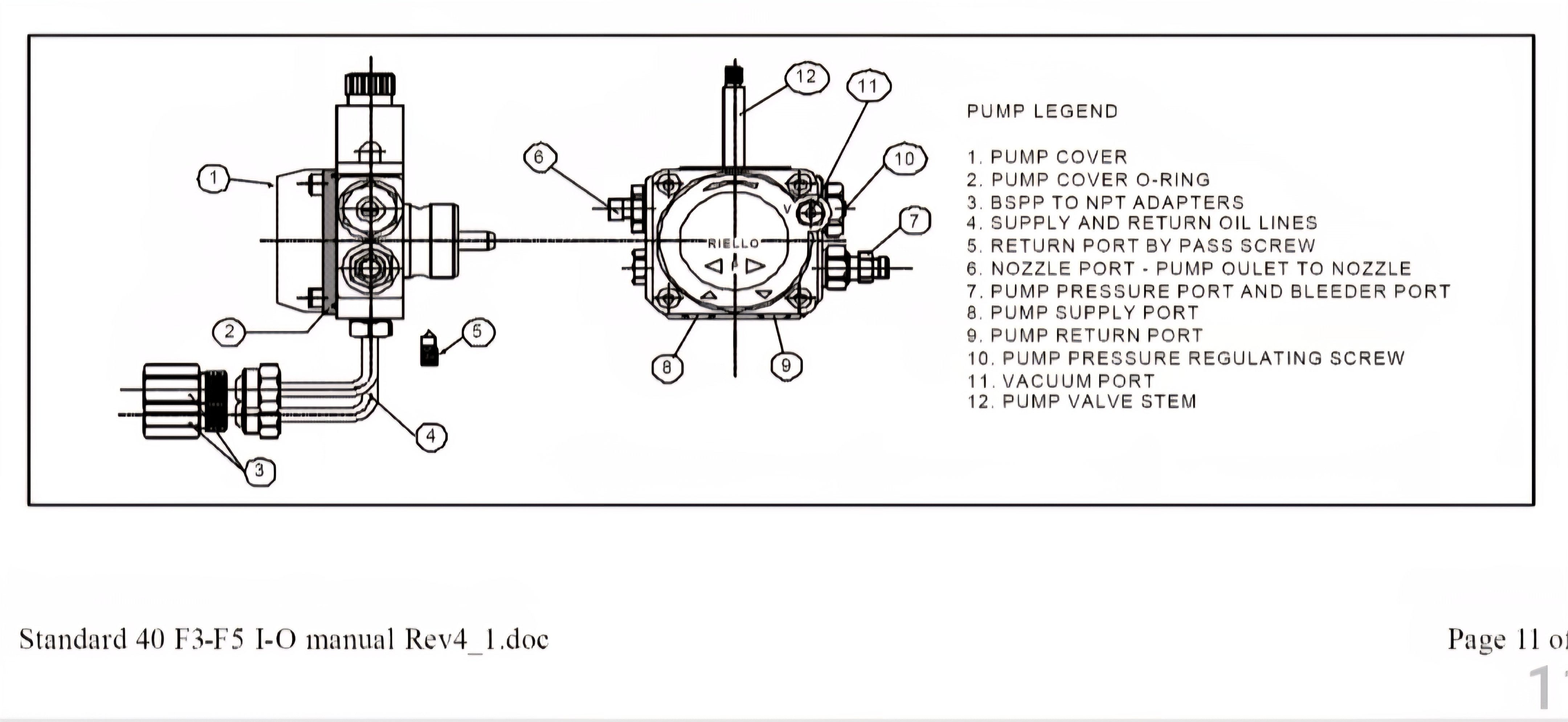

Hi, my gauge connection is top right as you look at the pump, I have the the nozzle supply pipe disconnected from pump and no flow,

Can you post some pics? We have no idea of what model burner, or what "top right" is.
This is from the 40 Series F3,F5 manual. Bottom right is where pump pressure readings are taken. And how good is your ohm meter? 110 Ohms isn't 100 (+-5).
Put everything back together, including the nozzle assembly. Prime the pump. Put the pressure gauge in the correct port and start the burner. There will be 5.5 to 6.9 bar during prepurge, then increase to the rated pressure for your application when the solenoid opens. If pressure doesn't increase, its the solenoid.

Did you check the piston (pump valve stem)? Two screws under the solenoid coil take those out to free the piston. Shake the piston it should rattle if not replace the piston.
