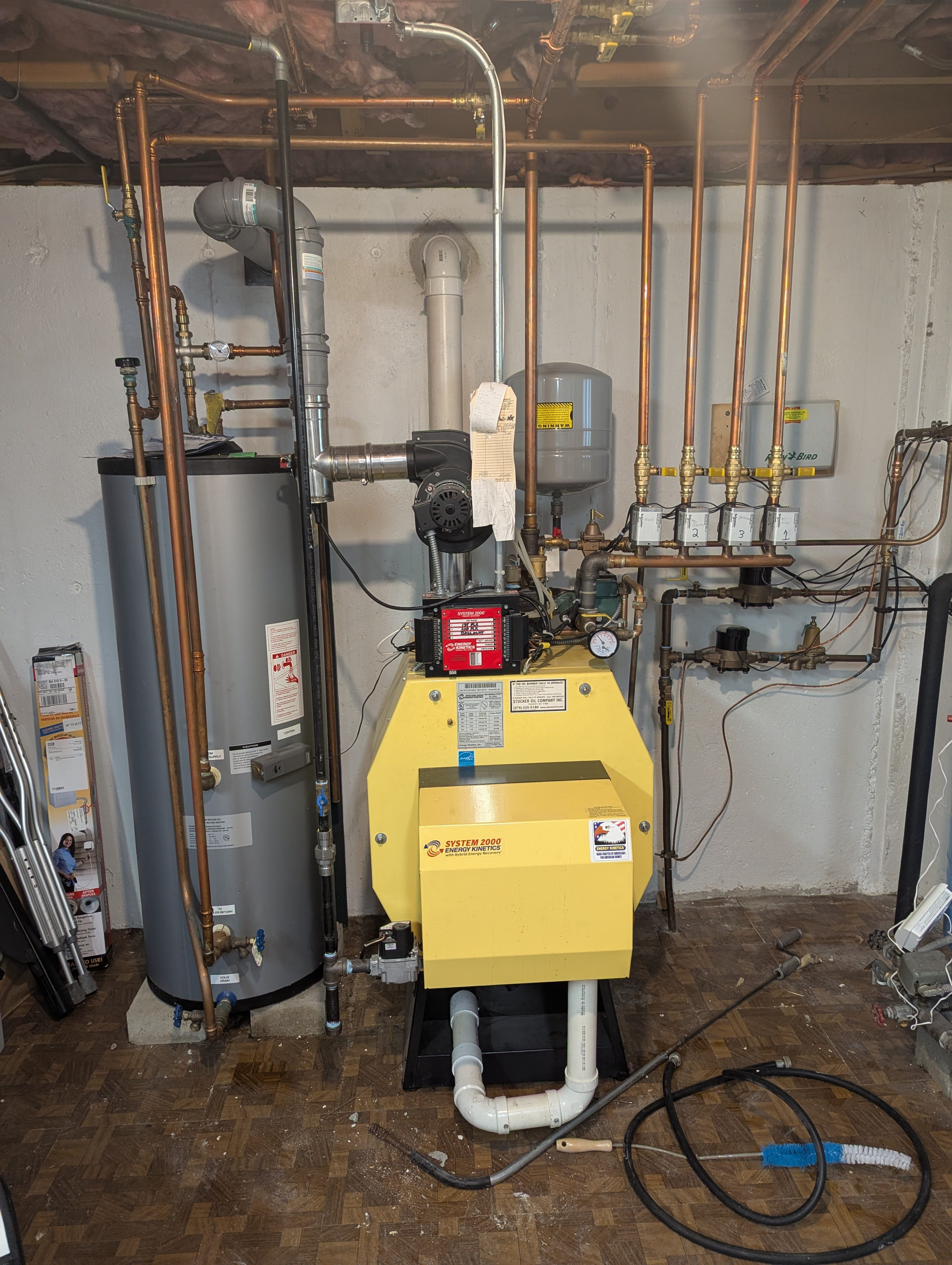

I have a Megastor 40 gallon indirect water heater that was installed 14 (or maybe 12) years ago. 7.5 years ago, I had my boiler replaced with a EK Resolute 90+ system, also having the new system moved across the basement, and the Megastor with it. A few months ago, I got rid of my oil tank and had my EK Resolute 90+ switched from an oil to propane burner.
That brings us to the present. I'm in the middle of a major remodel of my home. The GC's plumbing subcontractor is not familiar with EK systems (but I don't think this is relevant). Since we are re-routing forced hot water baseboards, he needed to drain the system, cap off the old baseboard supplies, and then re-fill the boiler. Coincidentally, there has also been water main work being done in town that has led to frequent brown water (i.e. sediment) from the city. A day or 2 after the system was drained a refilled, I noticed water dripping from the boiler's pressure release valve. I ALSO started to notice occasionally creaking sounds coming from the indirect tank. The plumber identified that the boiler was over-pressurized at 40psi, so he let some water out, which stopped the leak temporarily. However, after a day, the pressure had climbed back up and the pressure relief valve was leaking again. I thought maybe the problem was that the sediment in the water had fouled the watts automatic fill valve for the boiler (which is supposed to keep the boiler pressure at 15psi), so I lowered the pressure back to 15psi, and then shut off the fill to the boiler entirely, BUT the pressure still climbed up to 25psi after a little while.
At this point, I'm worried that the boiler system water is getting pressurized through a leak in the indirect's coil heat exchanger, so I ran the same experiment, this time shutting off the supply and return between the boiler and the indirect. Now the boiler pressure gauge is staying at 15psi. I talked to one of the tech's from the company that services my heating system, and he agrees that there is likely to be a pinhole leak somewhere in the heat exchanger.
So it sounds like I'm going to have to replace my indirect, and I don't think I can reasonably blame the GC or his sub for any of this, given that draining and re-filling the system is a routine thing and the hot water tank was 12-14 years old already.
Along with any other thoughts and comments about the situation that people might be willing to offer, I'm wondering whether I should replace the hot water tank with another "generic" indirect tank, OR if I should replace it with the EK System 2000 branded tank that uses an external heat exchanger. I'll find out more tomorrow, but I suspect I'll have to wait longer to get the EK tank if it needs to be shipped from NJ, vs. whatever regular indirect tanks are stocked locally (I'm in Massachusetts). I don't think the limited lifetime warranty on the Megastor applies anymore since the tank was moved from its original install location.
Also, can I continue to run my hot water heater for a few days while waiting for a new tank, or is it best to just shut off the supply and return between the boiler and the indirect and go without domestic hot water in the interim? I don't expect any water from the boiler will make it into the domestic water system given that the domestic system is pressurized to 60psi.

    The EK water heater is specifically designed to receive the retained heat at the end of any zones cycle. They were made for each other. If the plate heat exchanger is already there, its a no brainer.

    I don't have the heat plate exchanger. When the EK Resolute 90+ was installed, I already had the existing Megastor indirect, and although the installer COULD have pushed the EK heater, he judged that it wasn't worth it so he just piped the Megastor like a regular indirect.
    At the time, the Megastor wasn't all that old. I recall that he also reasoned that there was no point in replacing it given that it had a limited lifetime warranty, but neither he nor I was aware of the fine print which says the warranty is only valid in its original install location (I had it moved). Not clear if "original install location" means "in the same house" or LITERALLY in the EXACT same spot.

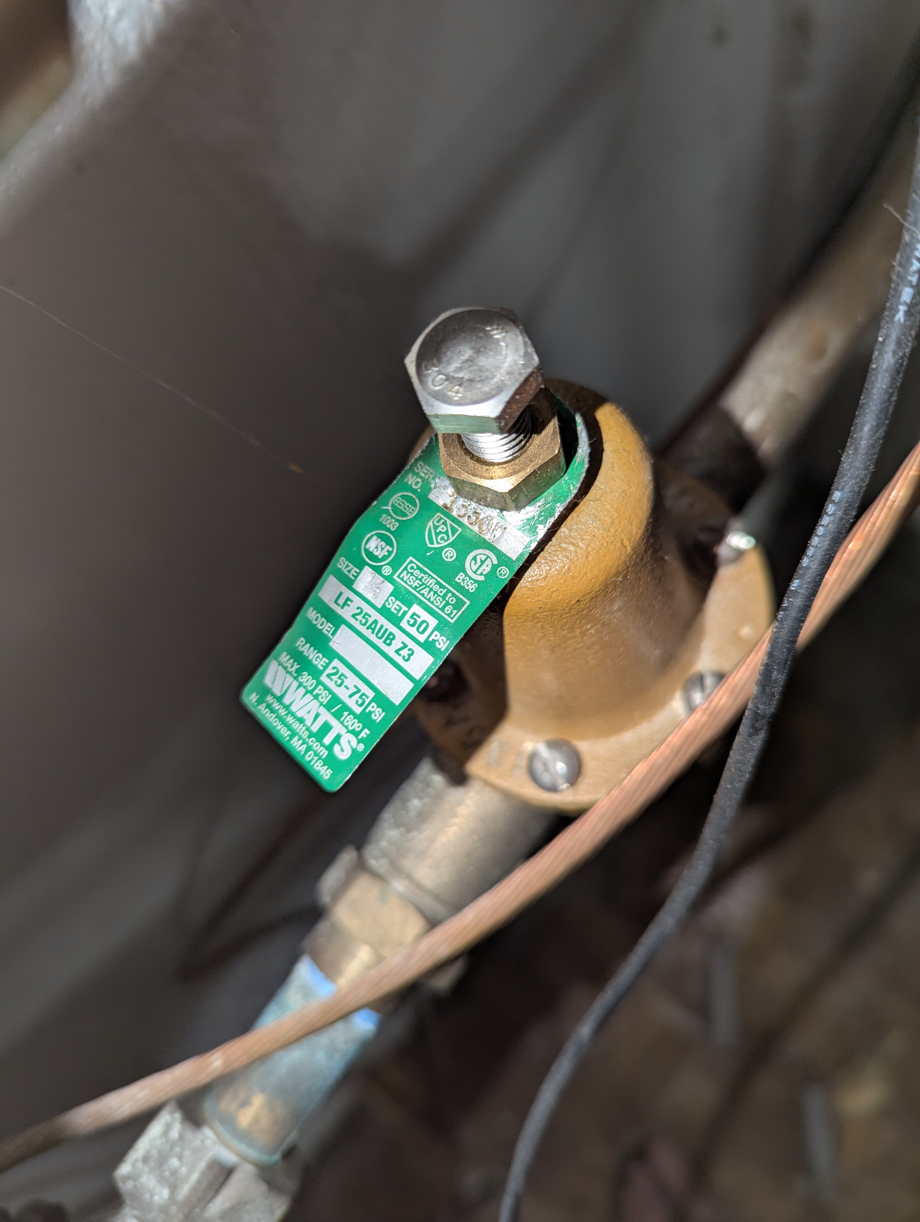

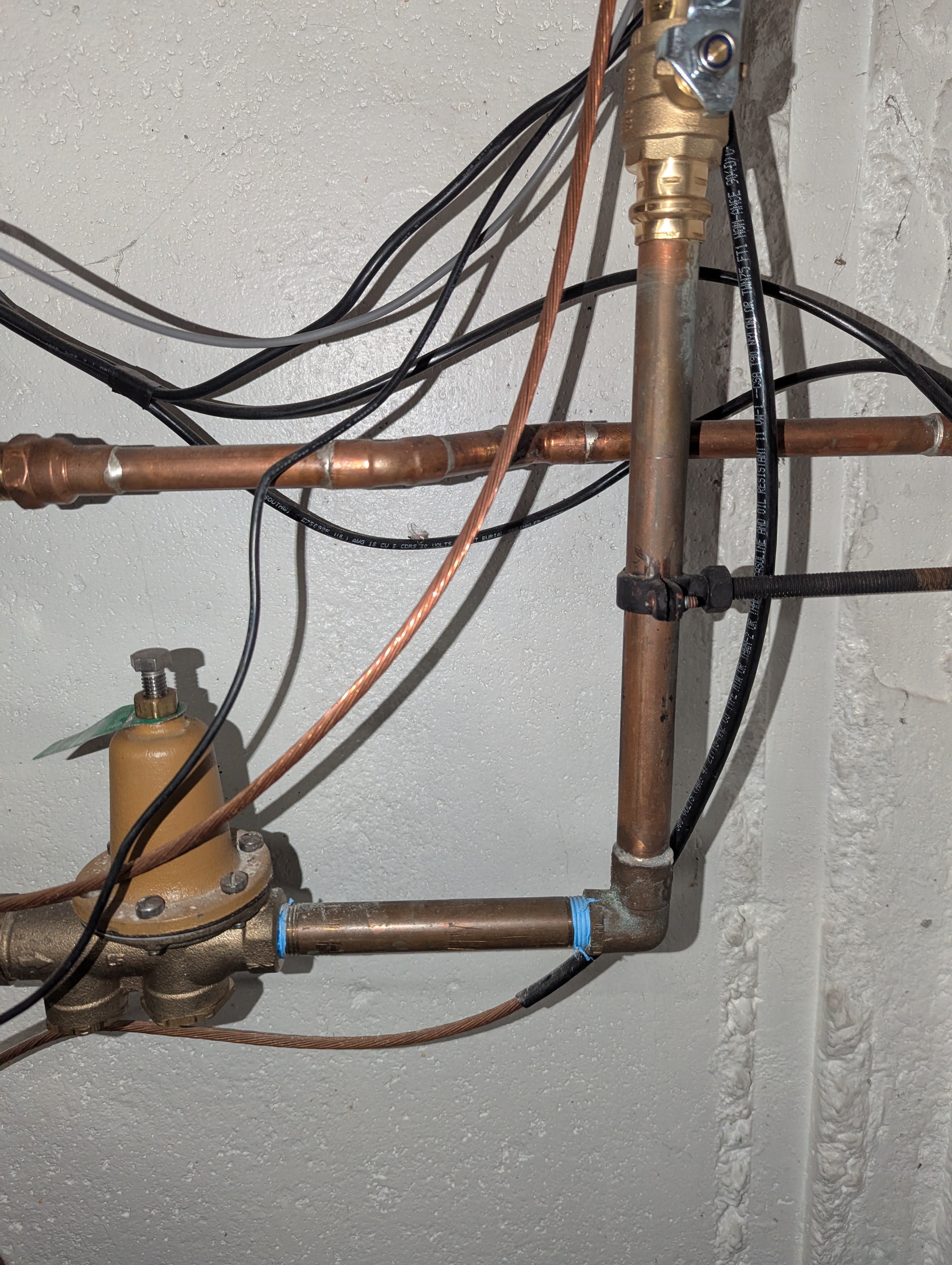

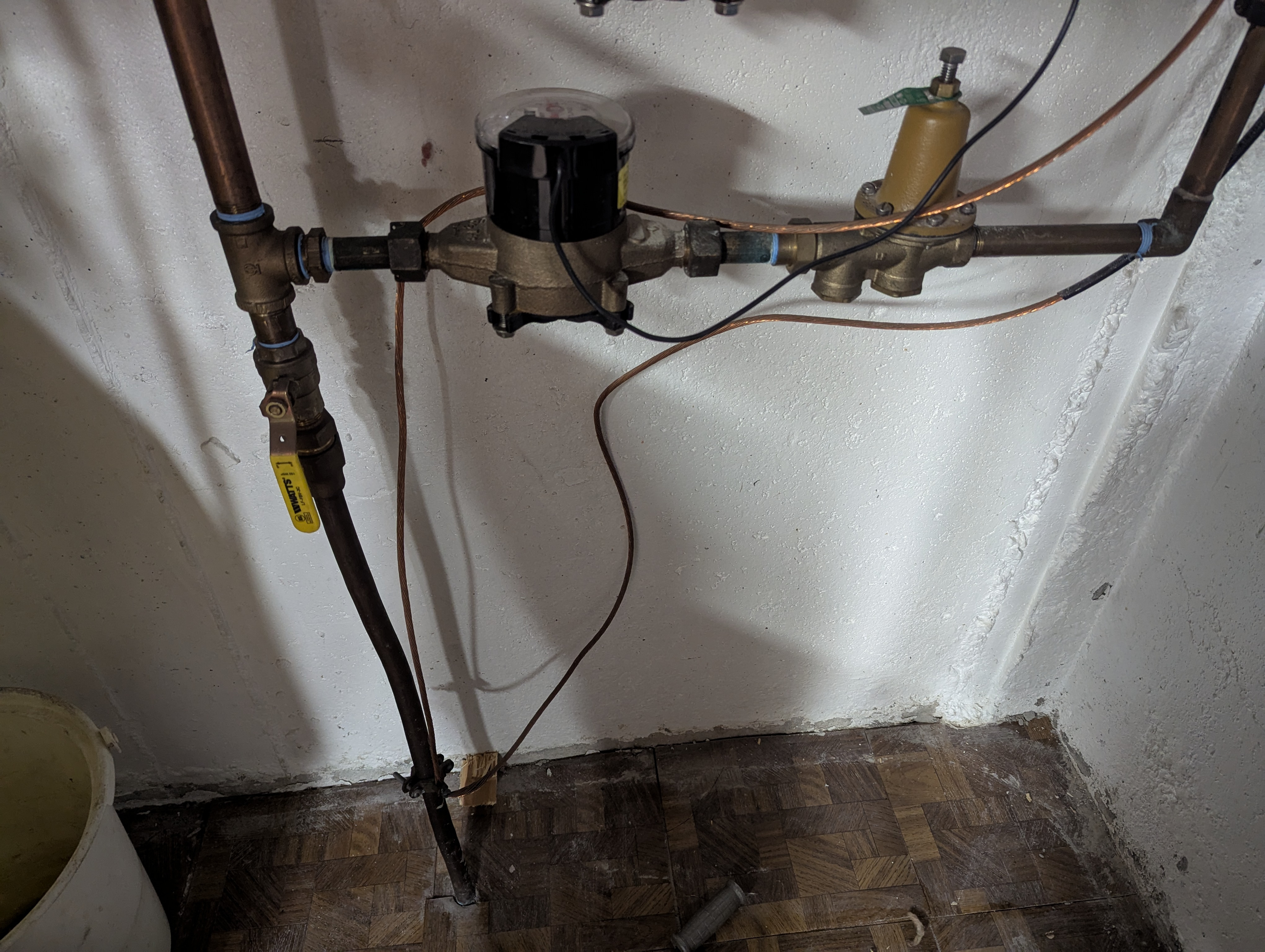

    How do I tell if this is an open or closed system (see attached photos)?
    The main shut off is on the left, in the middle is my water meter, and to the right of that is a Watts LF25AUB-Z3 1/2" pressure reducing valve. Up top out of frame is the irrigation meter etc. which I don't think is relevant.
    Is it weird that the PRV says 1/2 when the pipes connected to the inlet and outlet appear to be 3/4"?
    mattmia2 Member Posts: 14,752
    because of the laws of physics, water can't flow from low pressure to higher pressure so you need a dhw expansion tank with a pressure reducing valve. perhaps this is why your tank failed.
  • thomase00
    thomase00 Member Posts: 62
    So, even though there may not be an actual check valve, the higher pressure on the street side of the PRV effectively makes my system closed from the perspective of needing a DHW expansion tank?

    Before backflow preventers were required on incoming water services, the expansion would just flow back into the water main. The PRV almost certainly contains a built-in backflow preventer which creates a closed system on the house side of the meter, so the expansion has no place to go—and it will cause large pressure variations that will stress the hot water tank. There is sometimes enough pressure to trip the safety valve, usually set at 150 psig.
    This is why a small expansion tank is now needed at tank type water heaters.

    The 25 AUB is a bypass type PRV and will allow pressure back into the main. But a DHW expansion tank is always a good investment.
    The valve pictured is for the entire home? It is not a boiler fill valve, wrong pressure range for a fill valve.

    It was hard to tell in the small picture, but I think that brass at the pressure reducing valve for the house is 1/2". Typically residential water meters are 5/8" so the 1/2" piping around it is probably just fine.
    I'm sure @Roger will answer your hx question.
  • thomase00
    edited August 5

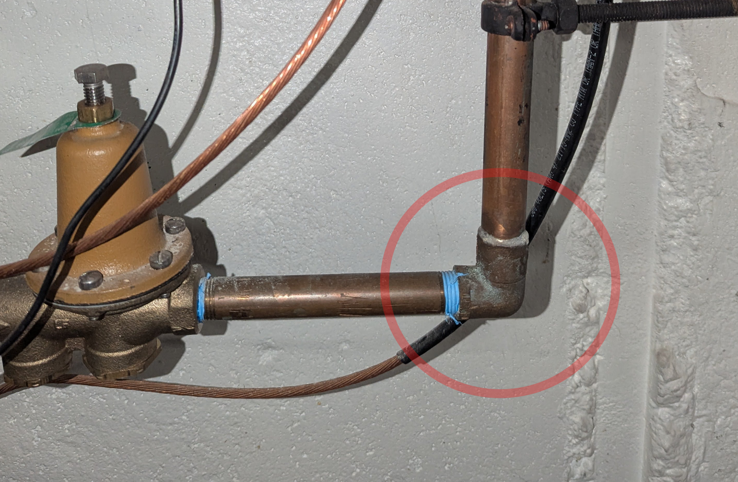

    Here is a closer picture of the PRV from the side. The outlet is to the right and the pipe threaded into it looks noticably thicker than the 1/2 pipe running perpendicular above it for irrigation. I'm pretty sure that the vertical section after the 90 to the right is 3/4, and it appears to be the same diameter as the pipe threaded into the PRV outlet.
    This looks like a 1/2 npt x 3/4 copper reducing ell. Remember the wall of brass and steel pipe is much thicker than the wall of copper pipe so 3/4" brass is quite a bit larger od than 3/4" copper pipe.

    Oh I didn't realize that the pipe connected to the outlet was brass and steel! That makes sense. Will I get better flow in the house if the PRV is changed to 3/4"? The street pressure is 100psi, but I've never been thrilled with the fixture flow rates in the house, even at 60psi. Not sure if it's the PRV, distribution sizing, or built up deposits reducing flow somewhere.
    It is brass but brass and steel pipe are both the same dimensions. Look at the aerators in the fixtures before you get carried away, they could be clogged or if they are relatively recent they may have significant flow restrictors in them, usually a little o-ring.

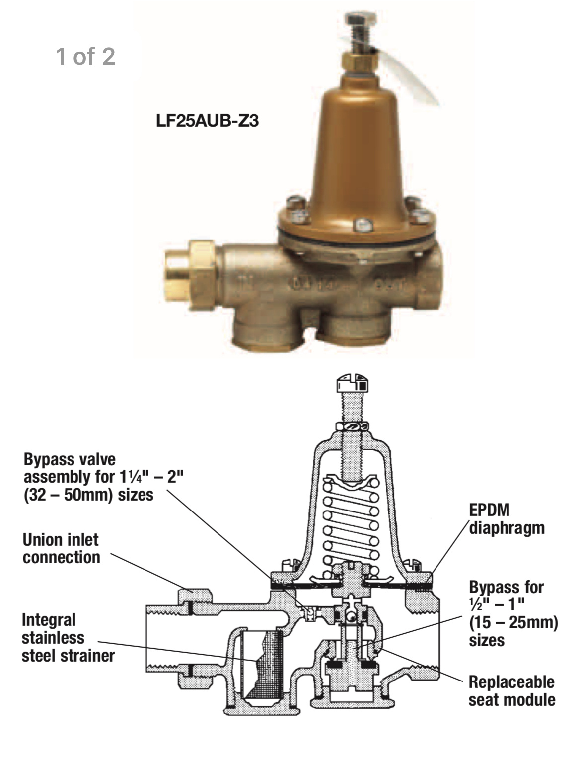

    I think there is a screen in that pressure reducing valve too. Look at the specs, not sure what the flow rate is for that valve but 1/2" pipe should supply a single fixture without a problem.
    hot_rod Member Posts: 26,028

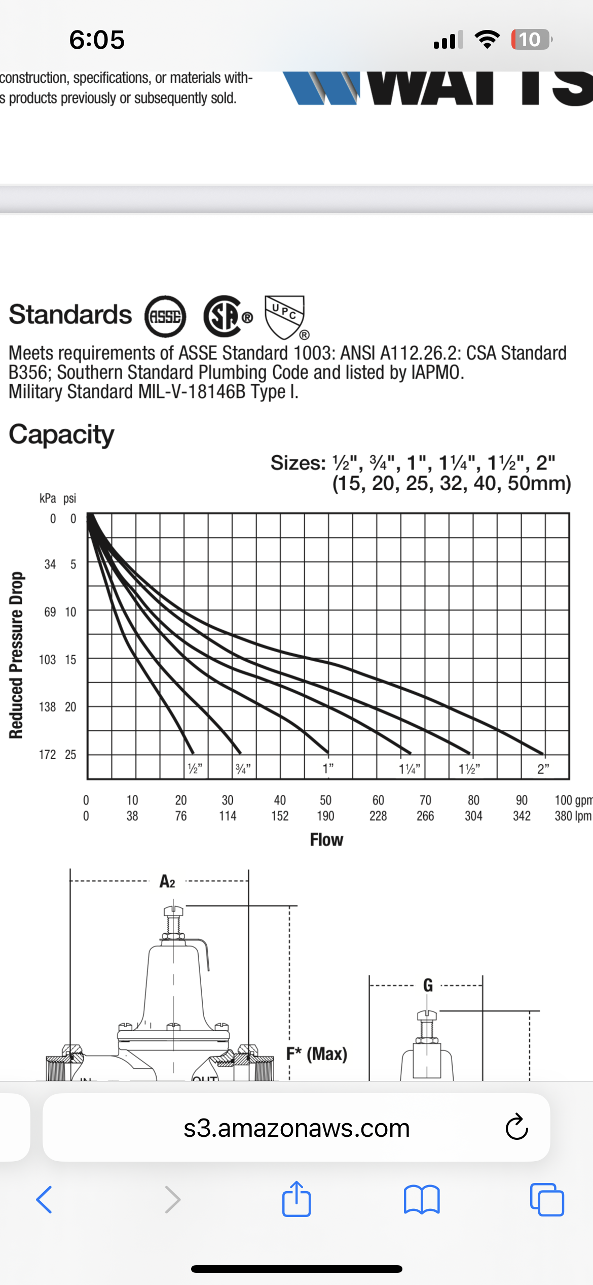

    The way to test that PRV is to install a pressure gauge, somewhere, anywhere in the house. Get one that connects to a hose bib
    See what the pressure reads
    Next start opening some faucets and observe the pressure change
    This is called fall off pressure test. Ideally with everything flowing, it should only drop 7 psi.
    If it drops quickly with only a few faucets running, check the strainer under the first brass cap on the PRV
    Generally you have a flow obstruction when pressure drops quickly. Or you are trying to flow a lot, over 6-8 gpm all at once
    Here is the fall off pressure chart, and a pic showing the screen

    I have a slop sink in the basement piped with 1/2 pex. I also have a pressure gauge mounted on an outlet close to the main with a quarter-turn valve. Just now, the pressure started at 76psi. When I turn on the cold water at the slop sink, it drops to 40psi. When I turn off the water, it goes up to 60psi and climbs very slowly after that. Could the slow pressure increase be due to thermal expansion from the hot water? Also, I'm pretty sure the screen in the PRV is clogged, we have had tons of brown water lately due to water main replacements going on in town.
    you will only get a pressure increase from the water heater if the boiler is firing and heating the water heater, so if it isn't firing it is probably because the seat in the pressure reducing valve is leaking. does it keep increasing over longer periods of time or does it eventually stop? as the pressure differential decreases a marginal seat might stop leaking.
    that much of a pressure change is going to make it seem like you have a lot of flow at first that suddenly slows down which will be rather disappointing and probably indicates that the strainer is clogged.
    Sounds like an obstruction.The strainer in the PRV is where you should start.
    You could take a 5 gallon bucket and see what the flow rate of the slop sink is. Even at a 5 gpm flow it should only drop 7-8 psi.
    It is normal for the PRV to increase to setpoint slowly at the end.
    How old is the PRV? They can be rebuilt, or probably replaced for not much more $$

    I've had the house for 16 years. I've already replaced the PRV once, but it don't remember how long ago. Should I replace with 3/4" PRV?
    I adjusted the PRV nut and now it's staying at 60psi.
    Cold water at slop sink is roughly 3.3gpm with a 20psi pressure drop. Cold and hot together simultaneous at the slop sink is about 5.5gpm with a 28psi pressure drop.
