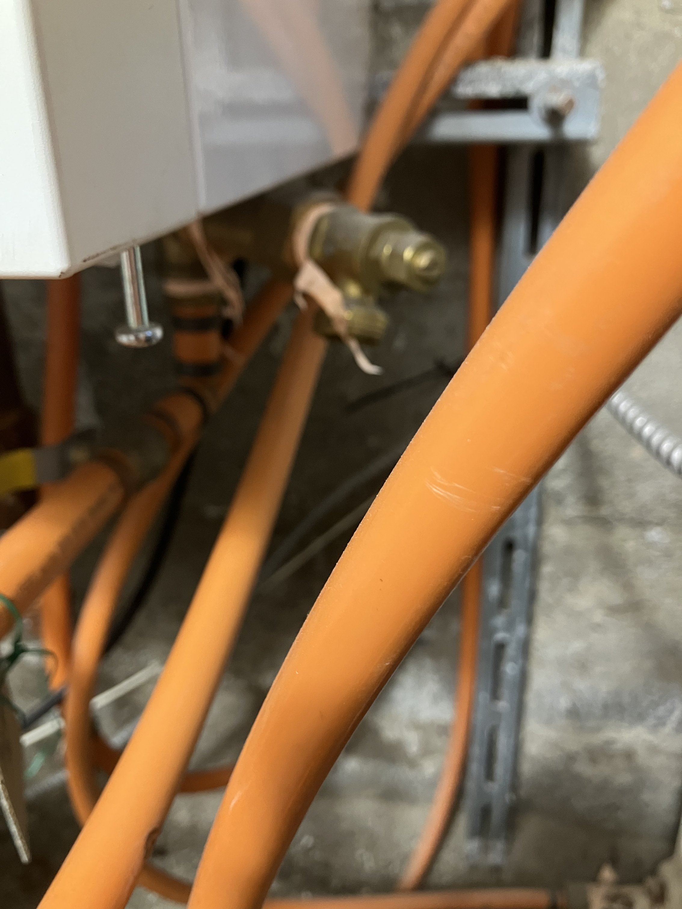

first of all, can someone help me identify this valve and tell me how to torn it. Do I have to buy a handle or do I use a wrench?
camello
  • Looks like all you need is a flat-bladed screwdriver. And from that drop down screw, you have a Viessmann boiler.
    Why do you want to flush your boiler? It should not be flushed unless there's air or a clog you want removed.

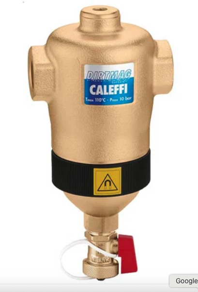

    To protest the boiler from debris and such, a DIrt Mag should be installed in the return line
    Bob Boan
    camello
    hot_rod Posts: 28,704
    A device like this in the piping.
    Think of it like an oil filter and magnetic drain plug on an engine. It filters to 5 micron, and a magnet pulls small ferrous particles, like magnetite, a .05 micron particle.

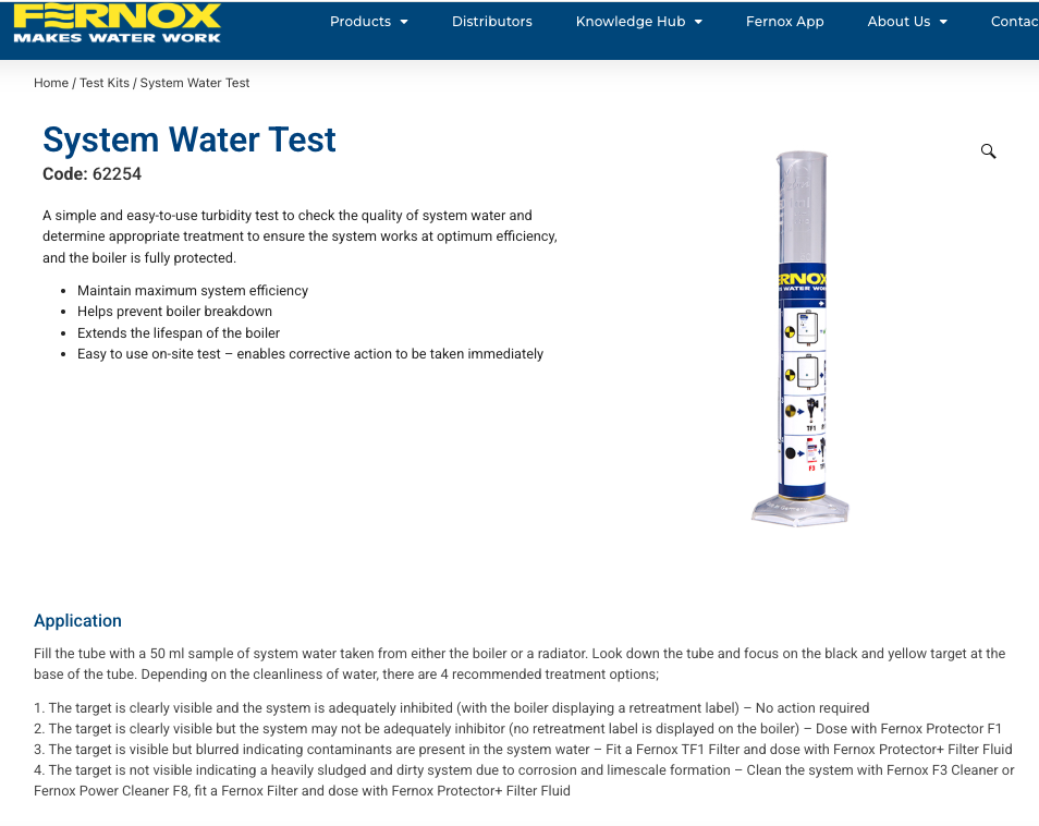

    A small water sample from that valve in a clear glass, let it settle for a day, see what is in the water.
    With iron pipe the oxidation layer helps protect ir. As long as the piping is not disturbed the rust and corrosion tends to stick to the piping.
    If you want more info you can use an at home test kit, or send a boiler water sample to Rhomar, Fernox or other boiler treatment manufacturers for analysis.

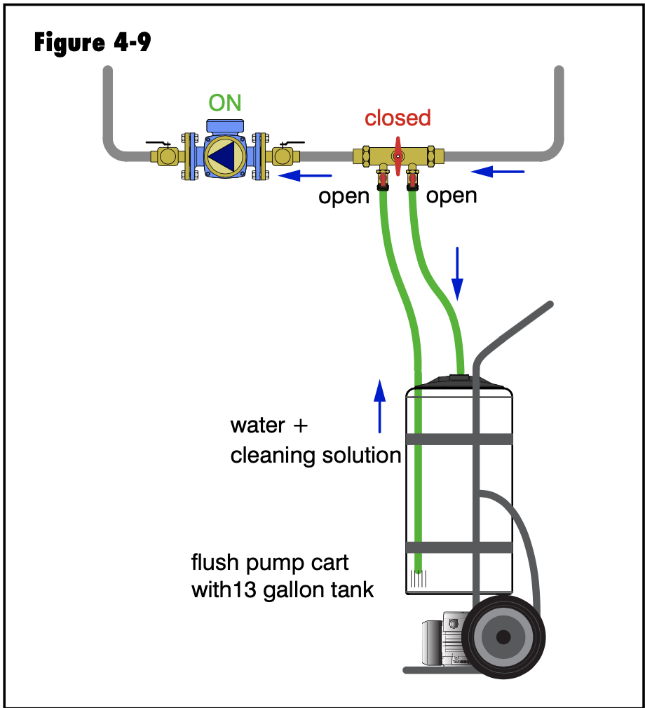

    The have screw on aerosol cans now to inject the cleaner. Otherwise you need a fill/ purge pump
    You need several flush valves in the correct location to flush and purge.

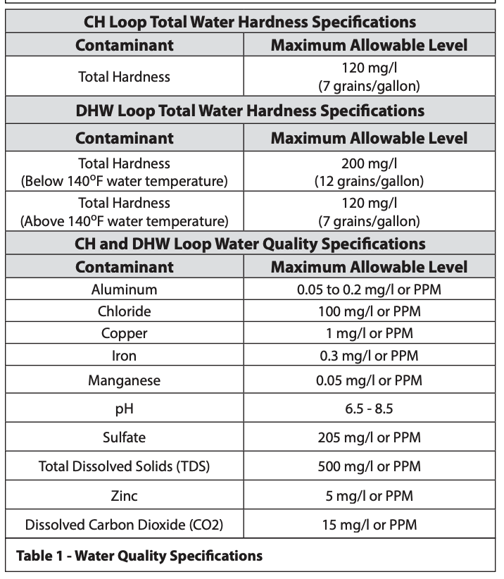

    Also an example of a boiler water spec for stainless boilers. Check your water.
