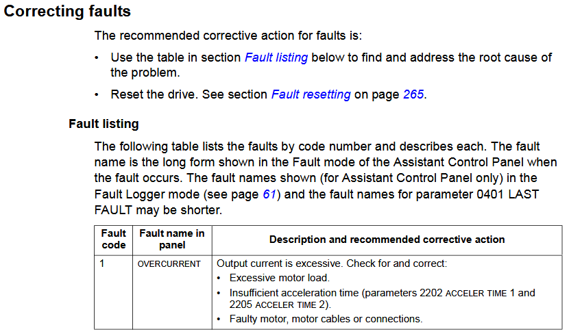

Does anyone know of a test to determine if a VFD has a defective CT? Other then swapping out the drive with another one? I am aware of the test to test the diodes .We have an ABB 550 that is only two years old, but since ABB no longer makes this model and it is out of warranty they (ABB) does not provide support.
The VFD about every 7 days goes off on overcurrent. We have disconnected, and megged the motor windings and they are all over 100 meg to ground. It is in a packaged ac unit so the length of the wires from the drive to re less the 6 feet. The only thing that I can think of is the component that measures the current in the drive (the CT) may be bad.

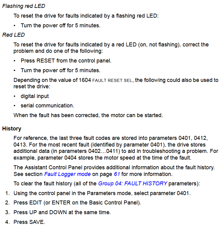

    There are different sizes of the ABB ACS550 Drives and the CTs are most likely different depending on drive size. They do go bad. I believe they are Hall Effect sensors since the AC waveform the motor sees is generated from switching a DC Buss. Were you able to get the actual fault code(s) ?
    For example; the Blue Doughnut like parts. For the effort to get in there to test them a shop may just change them if suspected bad. Small Electrolytic Capacitors go bad too, however not sure if that would give that error.

    thanks so much for the responses. Yes I have increased both the accel, and decel. Speed to 60 seconds. The strange part about it is that the max current for the motor is 81 amps. When checking the fault logger when the drive faults out the current shows at time of fault 34.4 amps
