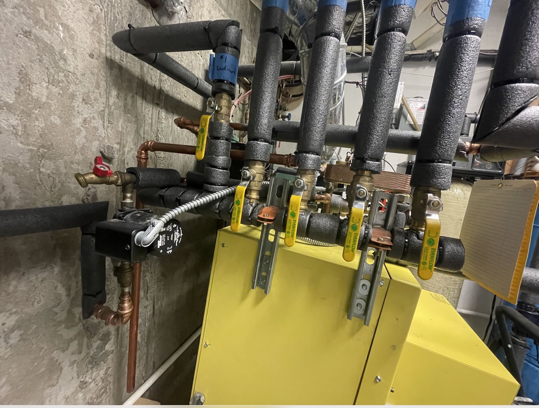

My first guess is a restricted heat exchanger? I don't seem to have ball valves on all four corners of it, so if that's the next step then I'll leave it to the pros.

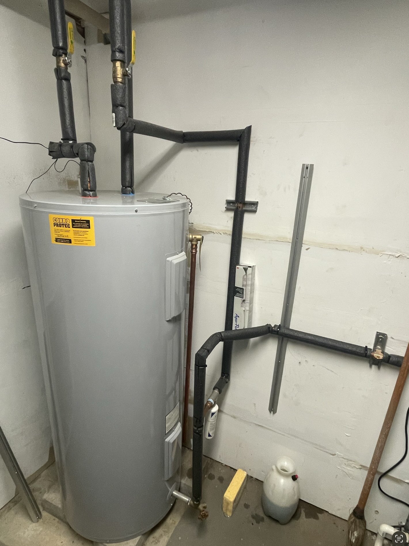

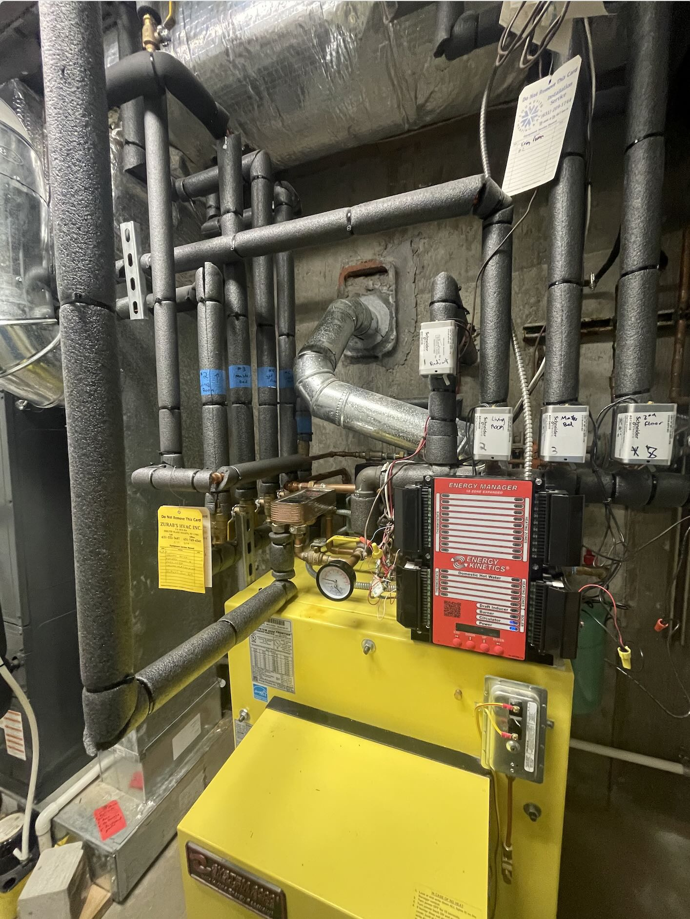

    I don't see any mixing valves in the boiler room. I've traced the hot water supply and there are no valves apparent.
    See pictures below:

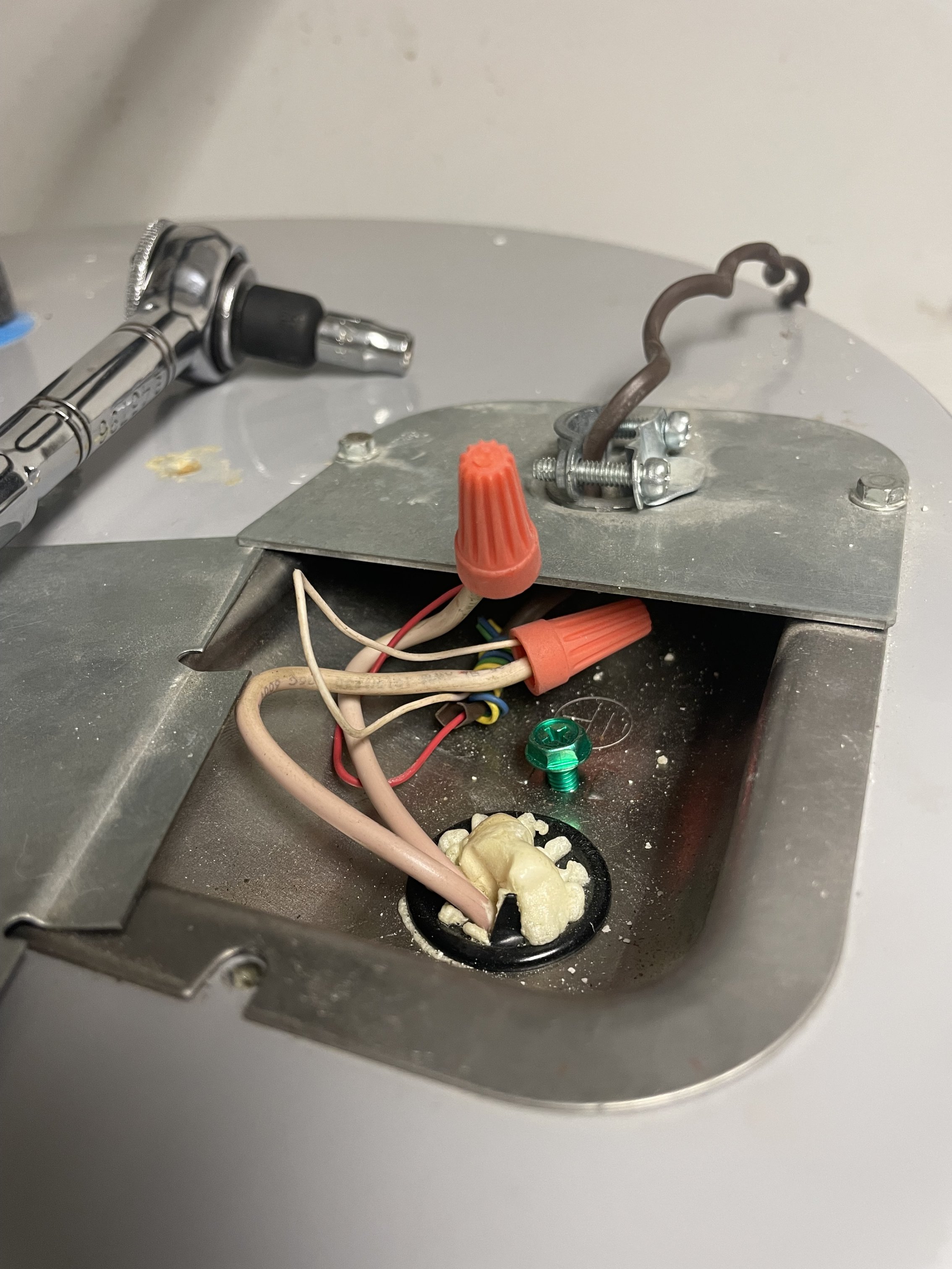

  • Hi, I may be off the mark, but how is temperature in the tank sensed? If there is a brass well for the sensor, there is a chance it has been coated over with scale/hardness from the water by the action of the anode. I've seen this mechanism mess with sensor readings.
    Yours, Larry

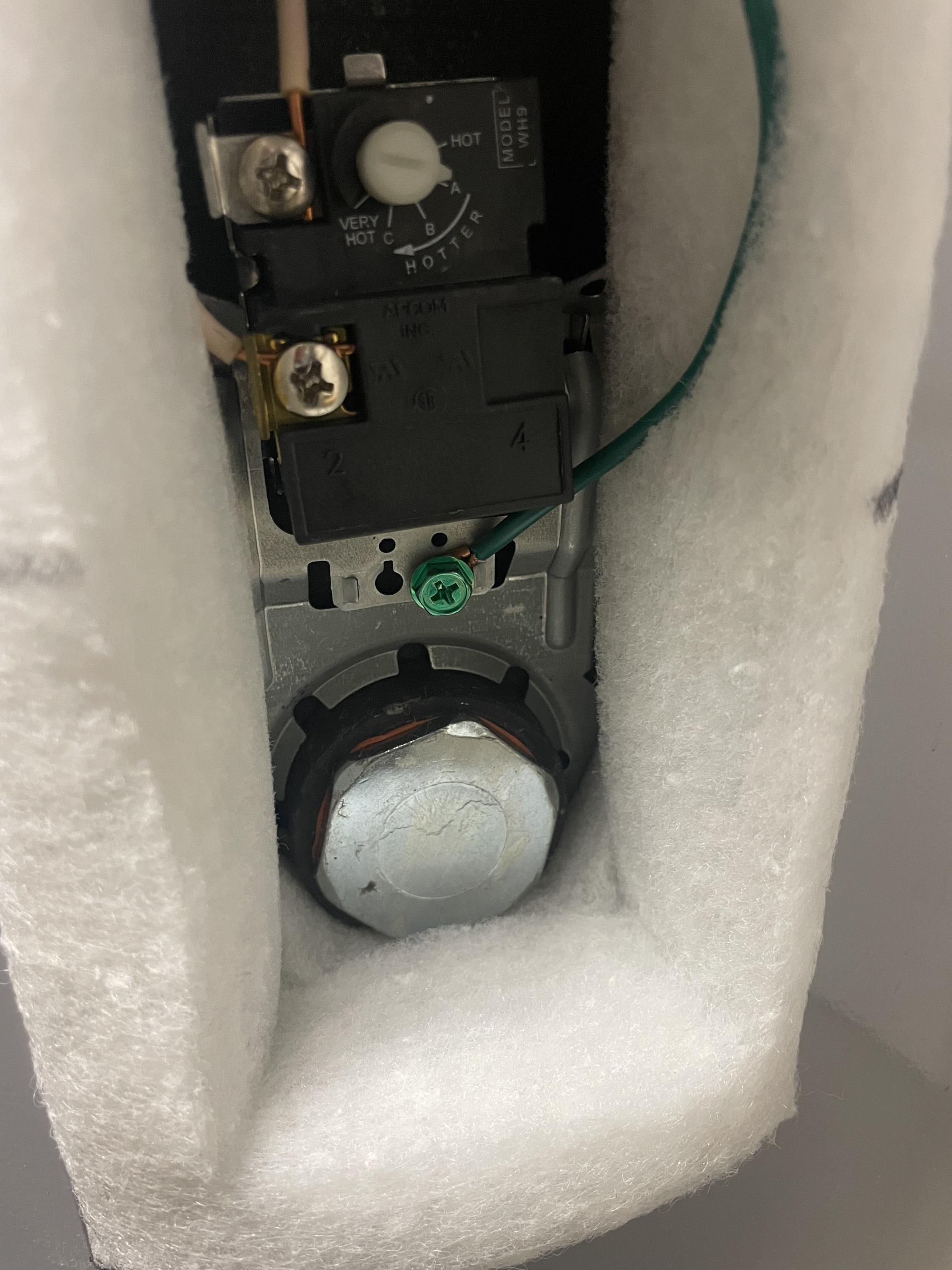

    @Larry: Attached is picture of the exterior of the Aquastat (I know this won't tell us anything, but took it just the same). When I replaced the anode last year, it was severely degraded and absolutely covered in scale. It was down to a thread at some points.
    @John: I've had the hot water heater turned off for the past day by disconnecting the hot water call wire going into the Digital Manger. I reconnected the wire and, using an IR gun, measured the temperatures at several locations. These temperatures were taken after 5+ minutes of the boiler burner cycling on/off and the circulator running the entire time.

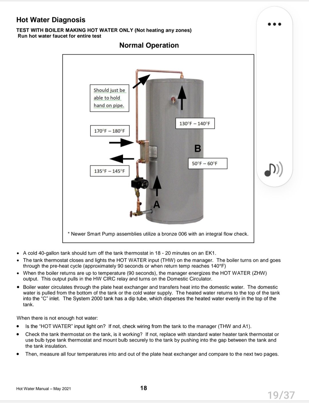

    @heatdoc1 What are your thoughts on my 70 degree differential on the domestic side, with 80 degrees being my domestic in?
    If the issue is with the Aquastat for the hot water heater, do you have a part number for that? I've checked the PDF (https://energykinetics.com/wp-content/documents/hot-water-tanks/installer-manual-tanks.pdf) and I don't see it listed in the Hot Water Manual (replacement part list, hot water diagnostics section, drawings, etc.). The "Hot Water Systems" section on pages 28-30 mention a mounted tank thermostat and I see on page 31 under "Typical Indirect Water Heater Installation" it mentions a surface mount type Tank Aquastat. I am assuming the EK system also uses a surface mount aquastat? Is the APCOM WH9 (in my picture above) the actual thermostat and only part that would need to be replaced?
    Are there any other tests I can perform to isolate things?
    Thanks everyone for the input and suggestions so far.

  • Hi, It's a surface mount thermostat, so no brass well to get covered in scale. Another question along this line… is there a piece of insulation over the thermostat when the sheet metal cover is in place? If not, it isn't sensing tank temperature as well. Thermostats like that are notoriously inaccurate, so good insulation helps.
    Yours, Larry

    @HVACNUT Yes, it's an EK tank. The light for the DHW thermostat on the Digital Manager turns on and calls for heat. It stays on while the system does its thing (burner and circulator go on, burner goes off, circulator stays on, burner goes on again when needed). After long enough, all lights go off and the system rests for a while. However this seems to happen after the hot water itself gets to too hot a temperature.
    The domestic in is reading via IR around 80-85, the out measures 140-150 via IR gun and 151 with an instant digital at my kitchen sink on full hot.
    I'm thinking it's worth replacing the Apcom WH9 to rule that out as the problem. It seems very easy to do and is only a $15 part…
    Edit: I did not have my hot water faucet running during the IR tests, so I'm assuming that's why the domestic in wasn't dropping. I can repeat that test if necessary. However I still don't normally see 151 degree temps at my faucet…

    @Larry Weingarten Yes, not shown in my picture is the thick, white insulation moved out of the way. It is normally covered by the insulation and plate.
    I think a swap of this part is an easy place to start. I've already backflushed my heat exchanger. If the thermostat swap doesn't work, then it sounds like further cleaning or replacement of the heat exchanger might be needed and that's when I'll call in a pro…

    Good morning, All. Not much left to cover here as everyone seems to have hit the nail on the head. I've attached a sheet that may help with trouble shooting. I would confirm with a clamp on thermometer, if you can, those temperatures. Based on the IF unit your using and the patina of the pipe the readings can vary. You'll also want to check out the boiler side and look for a 35 ° drop there under the same conditions of a tank re-heating. If your temperatures are outside the 70° rise and 35 ° drop, confirm your smart pump 006 is operational. Confirm the check valve is holding. At this time i would replace the plate exchanger.
    It appears that the thermostat is turning on and off, but really that's all it's supposed to do. It doesn't control the temperature per say just confirms when the tank is totally hot. I didn't see a mixing valve in the pictures, but installation of one will give you more consistent hot water outlet temperatures.
