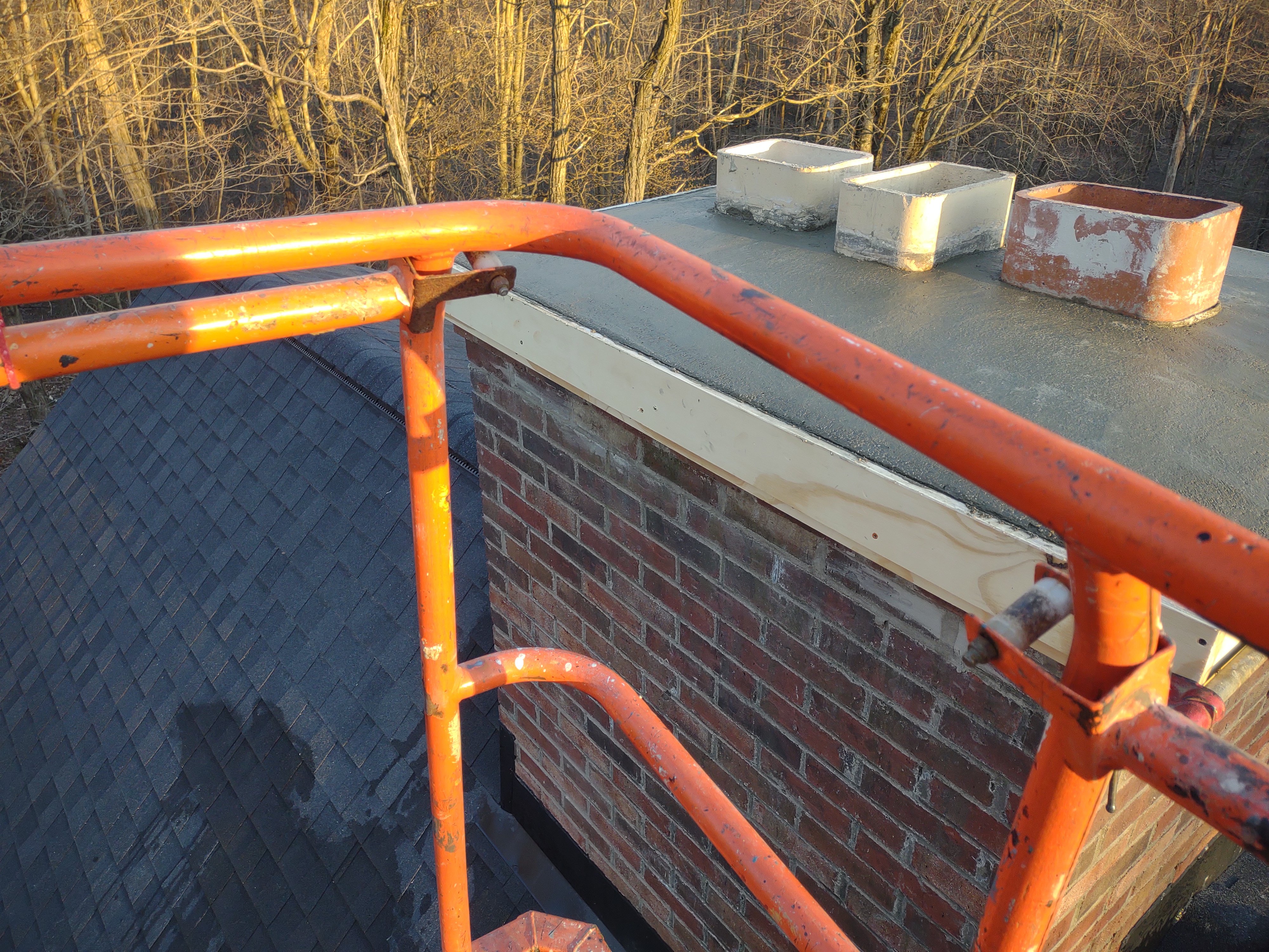

Thanks for your replies! Now it has me thinking about a project! So I have been considering learning TIG welding and the idea of fabricating a cap that will cover all 3 flues. I have a design in mind but pondering the way to attach it to the cap. I rebuilt the chimney 2 years ago and poured a new cap. The chimney is 4'x5' so there is alot of real estate up there. Not sure is fastening it directly to the concrete cap with say Tapcons?
Thoughts?
Tapcons work good when used properly and in the correct applications.
I've seen a lot of guys use them very wrong and then say they suck.
I'd consider some stainless 1/4" Tapcons for that and don't overtighten them. I don't know where you're located but if your area gets very high winds I'd design accordingly.

I'd also put silicone or osi quad around the heat and surface of the tapcon so it doesn't act as a path for water to get in the masonry cap.

Hi @Cyclist77 , Any chance of a photo of what you have up on the roof? I'm wondering what options exist for solidly attaching a cap (other than lead weights). 🤔
Yours, Larry
Hi, It would take some sheet-metal skill to make a single cap, but it seems to me that stainless band clamps can be used to attach to the three outlets, pretty much eliminating any risk of damage to them. 🤠
