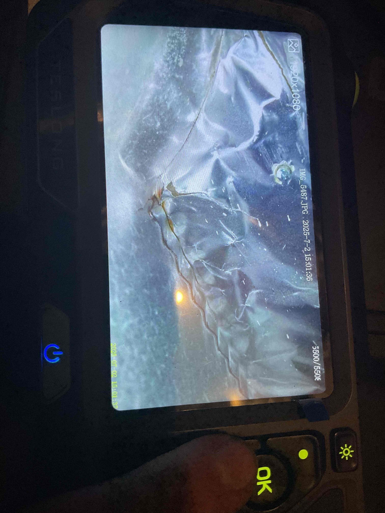

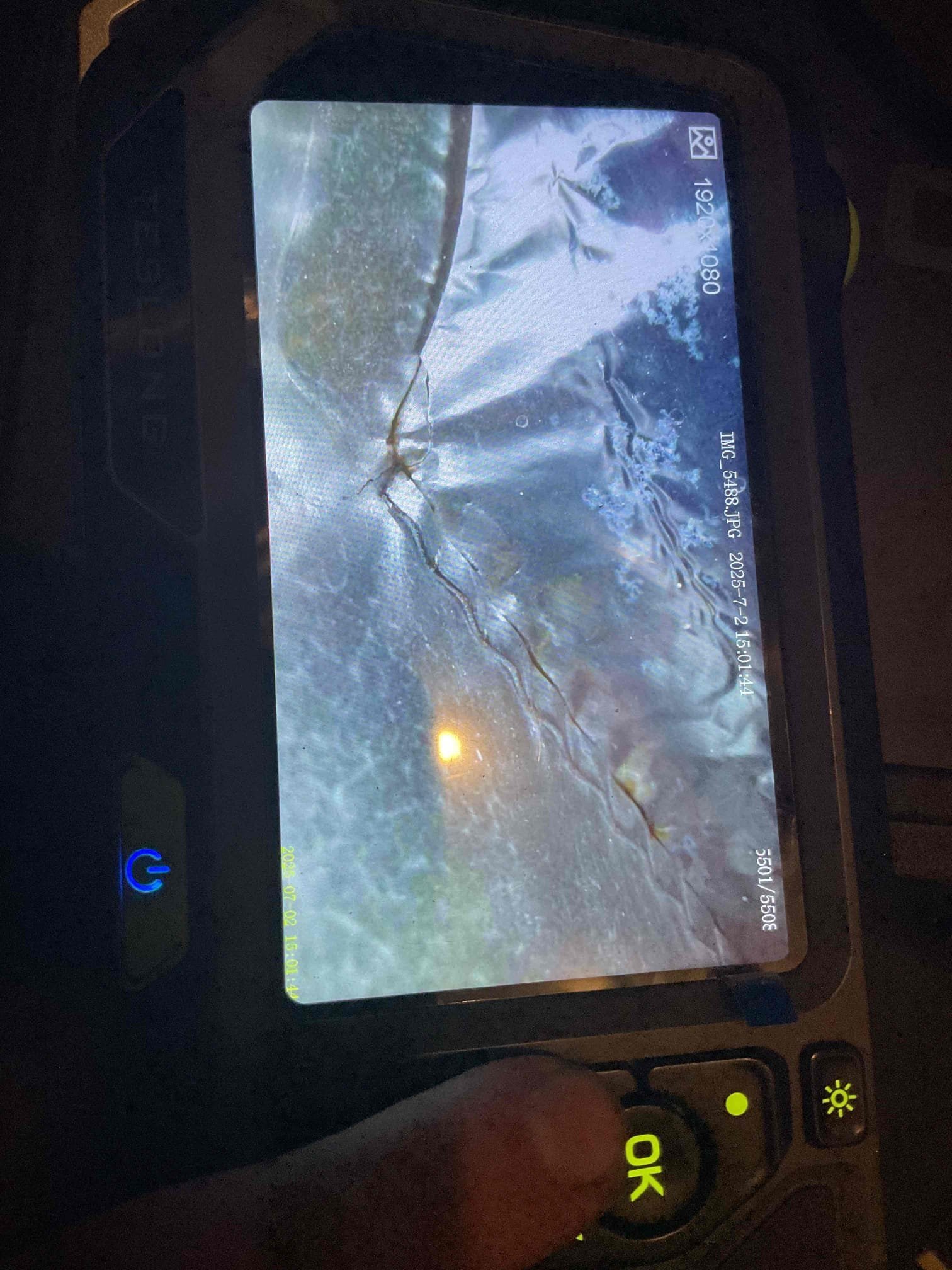

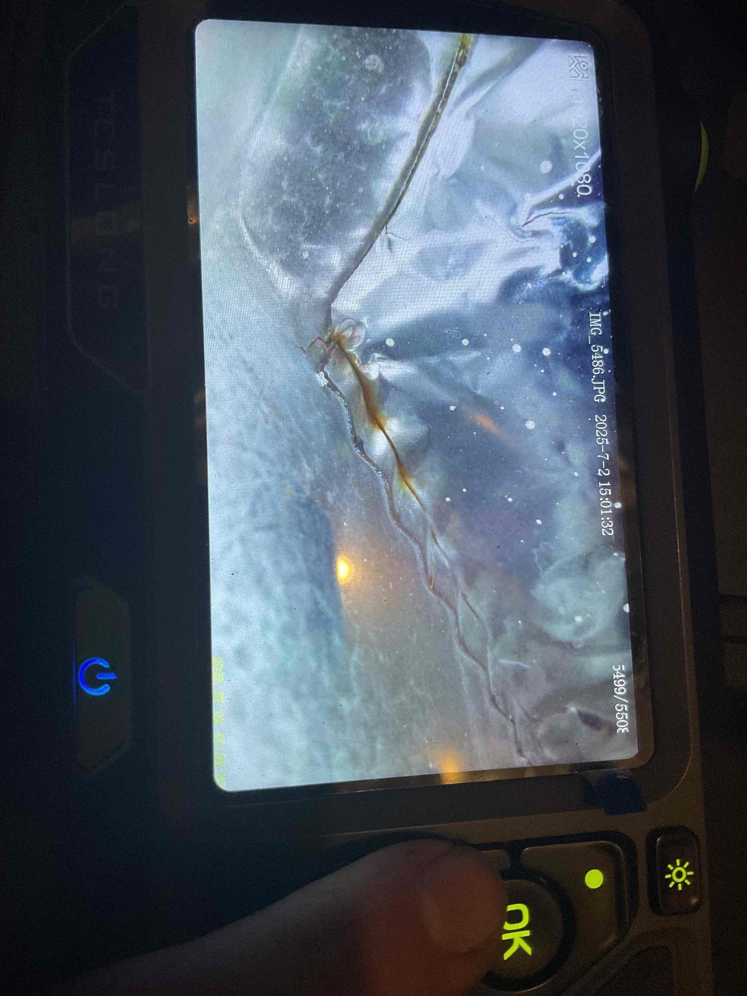

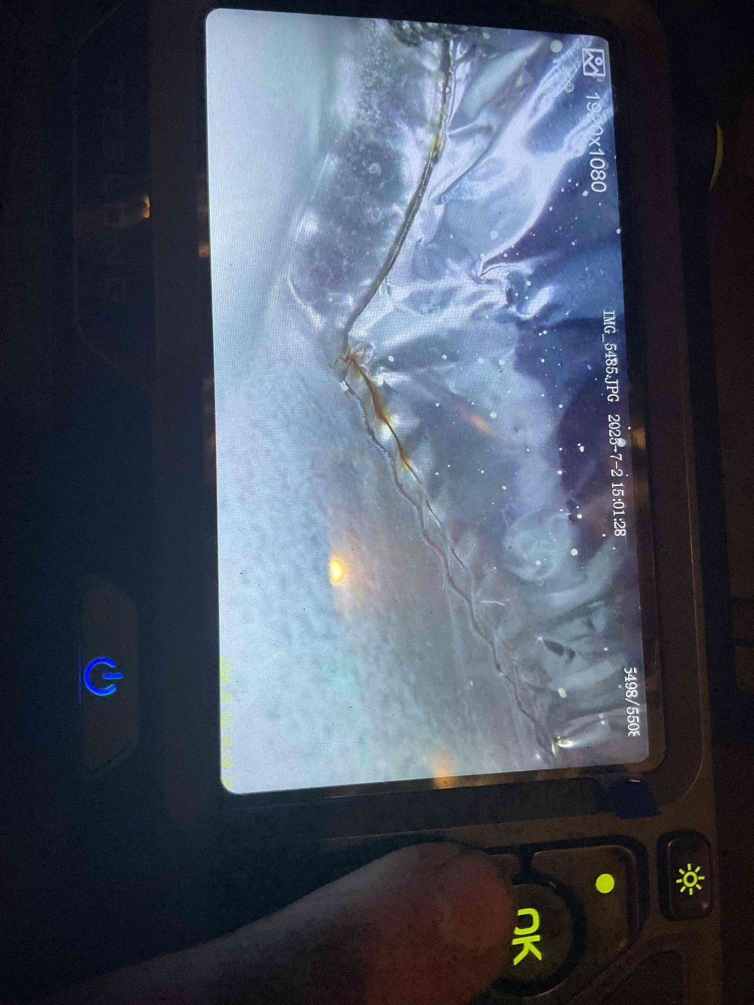

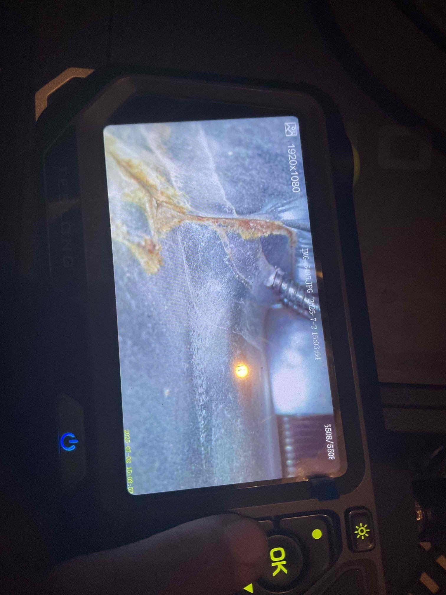

My parent's have Trane XR90 furnace and recently had an inspection where they were told their furnace needs to be replaced soon, as there are cracks in the heat exchanger. I don't trust this company for various other reasons, and wanted to get the opinion of pros on here. Here are the pictures they took and wanted to get a good feel on what everyone things. If it needs to be replaced so be it, but want to confirm. This company deemed this unfit for service and should be replaced asap.

    Hard to tell from pictures but it looks bad to me.

    Those pics do not look like a tranTrane heat exchanger.
    109A_5 Member Posts: 4,227
    Is that the Heat Exchanger or some sort of insulation or a heat shield type barrier.
    mattmia2 Member Posts: 17,565
    It looks like the hx against the foil faced insulation inside the jacket. i don't know enough about how that hx is built to know if that is open to the fire side or is just a byproduct of how the metal is folded at the edge. also is it still under warranty, it looks very new.

    That's an interesting observation. I don't really know myself, I was given these pictures by my sister who was present when the guy was trying to tell them they need a new furnace.
    Good question, as above, I don't know. Pics were provided by the tech, or rather my sis snapped pics from the screen. There was always some corrosion on the furnace around the exhaust pipe, think from condensate, so for all I know this is a picture from somewhere inside that isn't actually the main physical part. I do have a scope similar to that, I think I will go and do my own inspection on it as well.

    A couple of tests. Start the furnace with the blower off and the stat set to auto. Watch the flame closely and see if it changes when the fan starts. If it does the hx is toast.
    The other way is to cover the flue outlet outside with plastic wrap or plastic bag secured with a rubber band. Have someone start and stop the fan while you watch the plastic bag for movement

    I don't recognize the pics, but whatever it is there are definitive cracks present.
