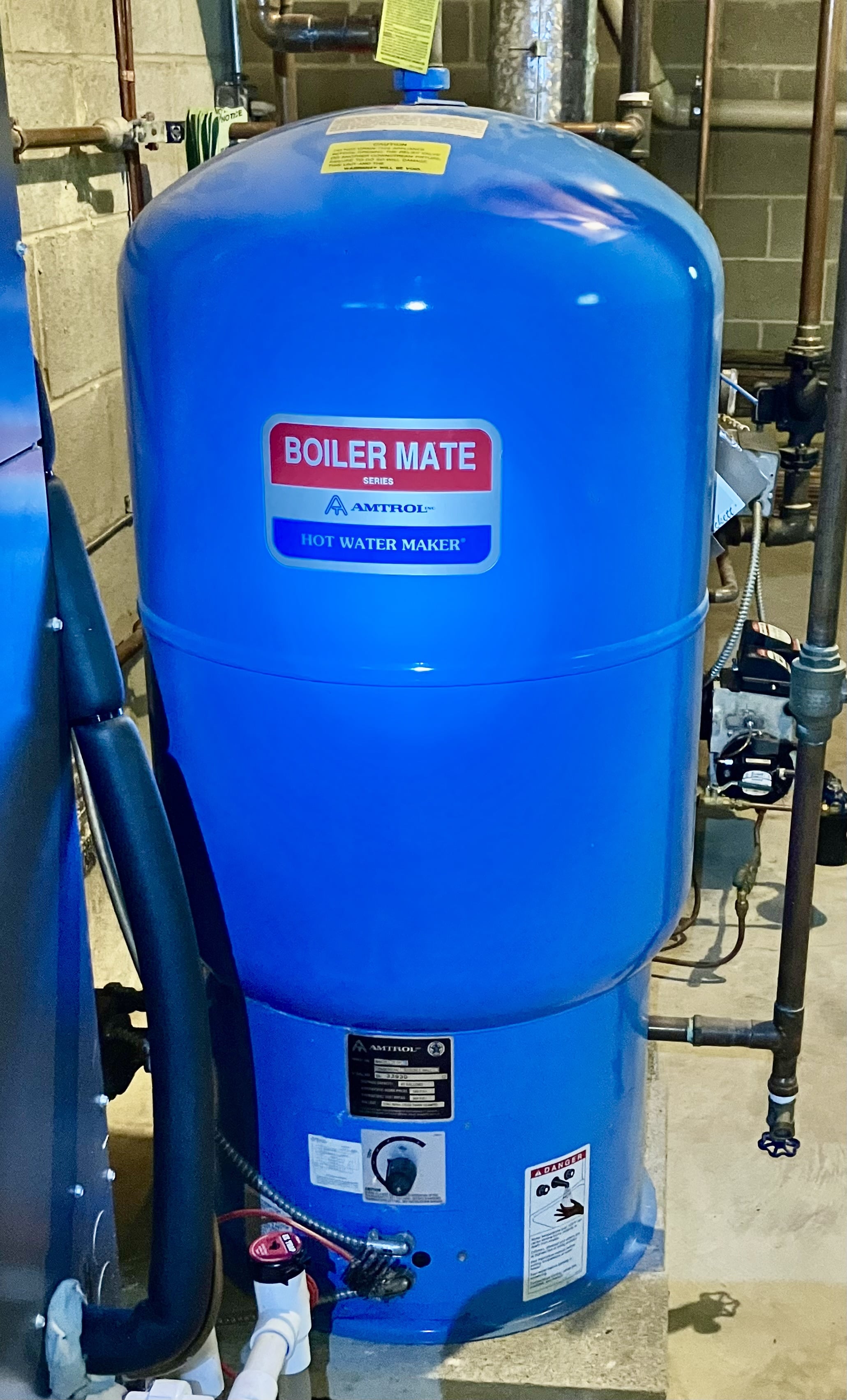

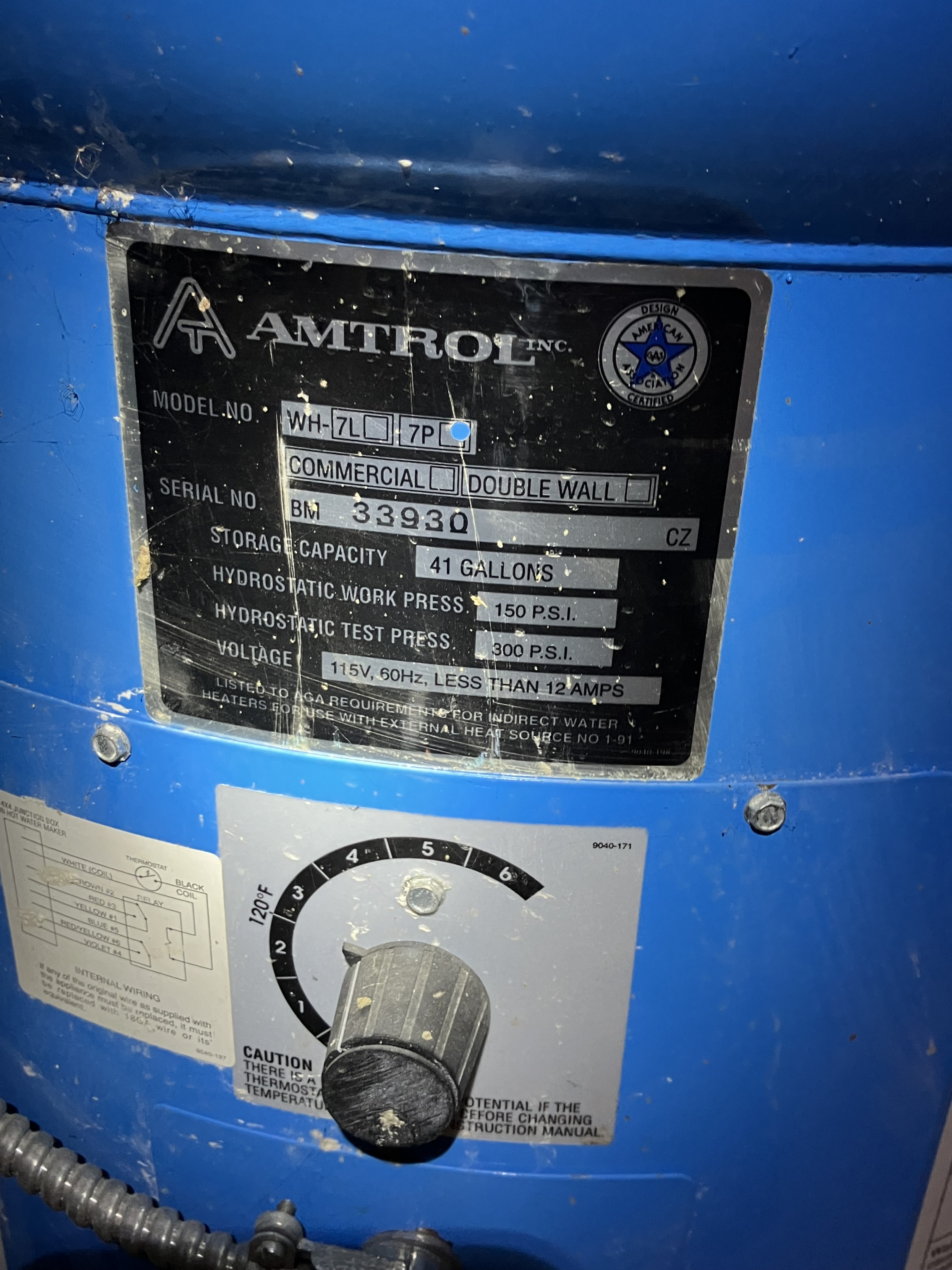

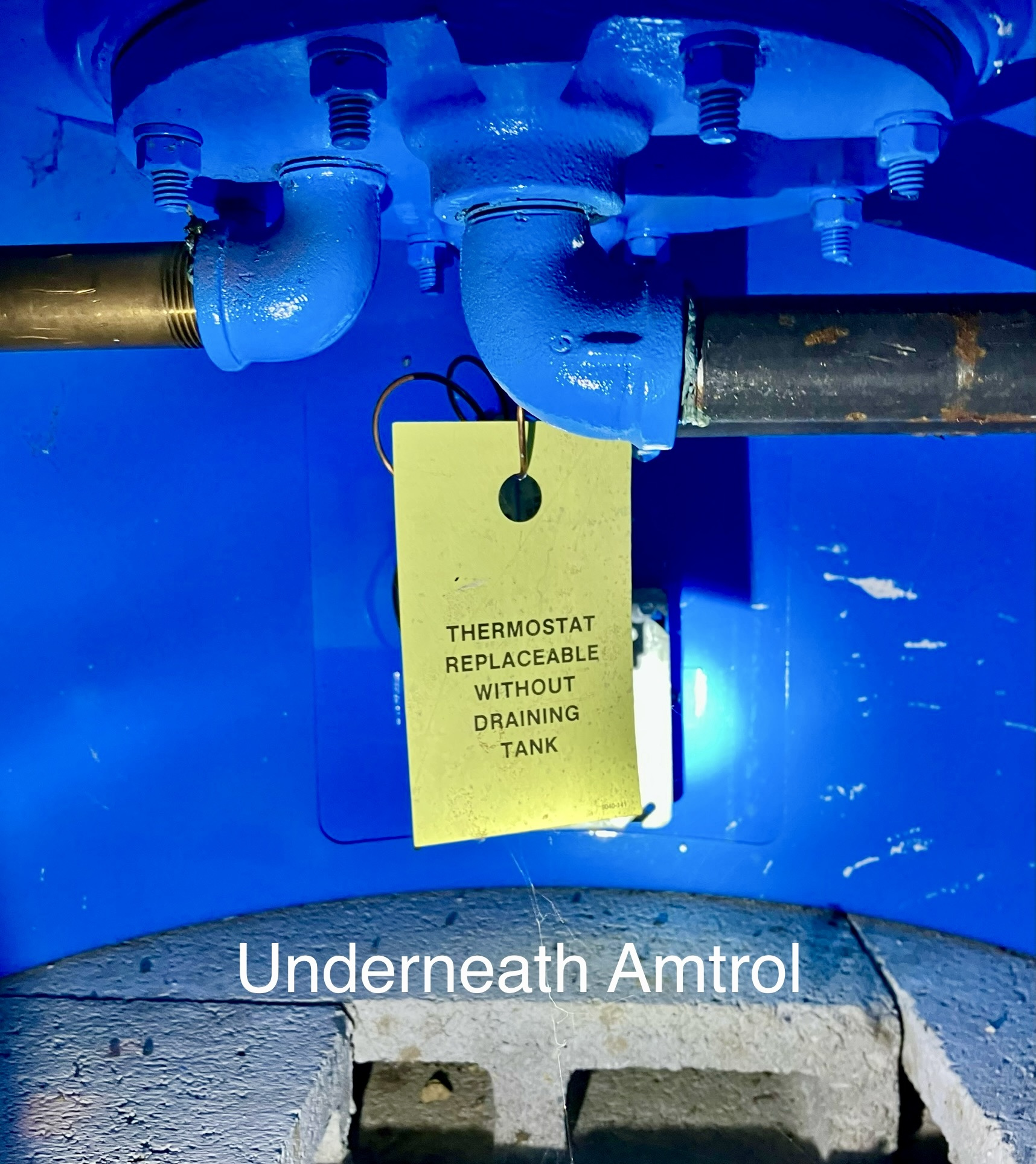

    Regarding the comment on scale coating the coils in an indirect, I’ve had my Amtrol Boilermate for 30 years, and had ZERO problems or issues with it. ZERO.
    My question is, should I replace it just because it’s 30 years old? I’ve included some pictures below.
    I was also told that I could tell if there were problems within the tank by touching it. That the top and bottom of the external tank should feel the same temperature, and it is cool to the touch everywhere on it.

    Ask the contractor to quote on the indirect as a separate item. Cry on his shoulder and tell him money is tight and you want to replace the indirect but maybe do it in a year or 3. You shouldn't need anything for the boiler in the first few years. If it was me I would take my chances.
    Unless there is something obvious with the indirect I would run it as is.
    In this day and age new isn't always better unfortunately. Since you probably have decent water quality it could last a while.

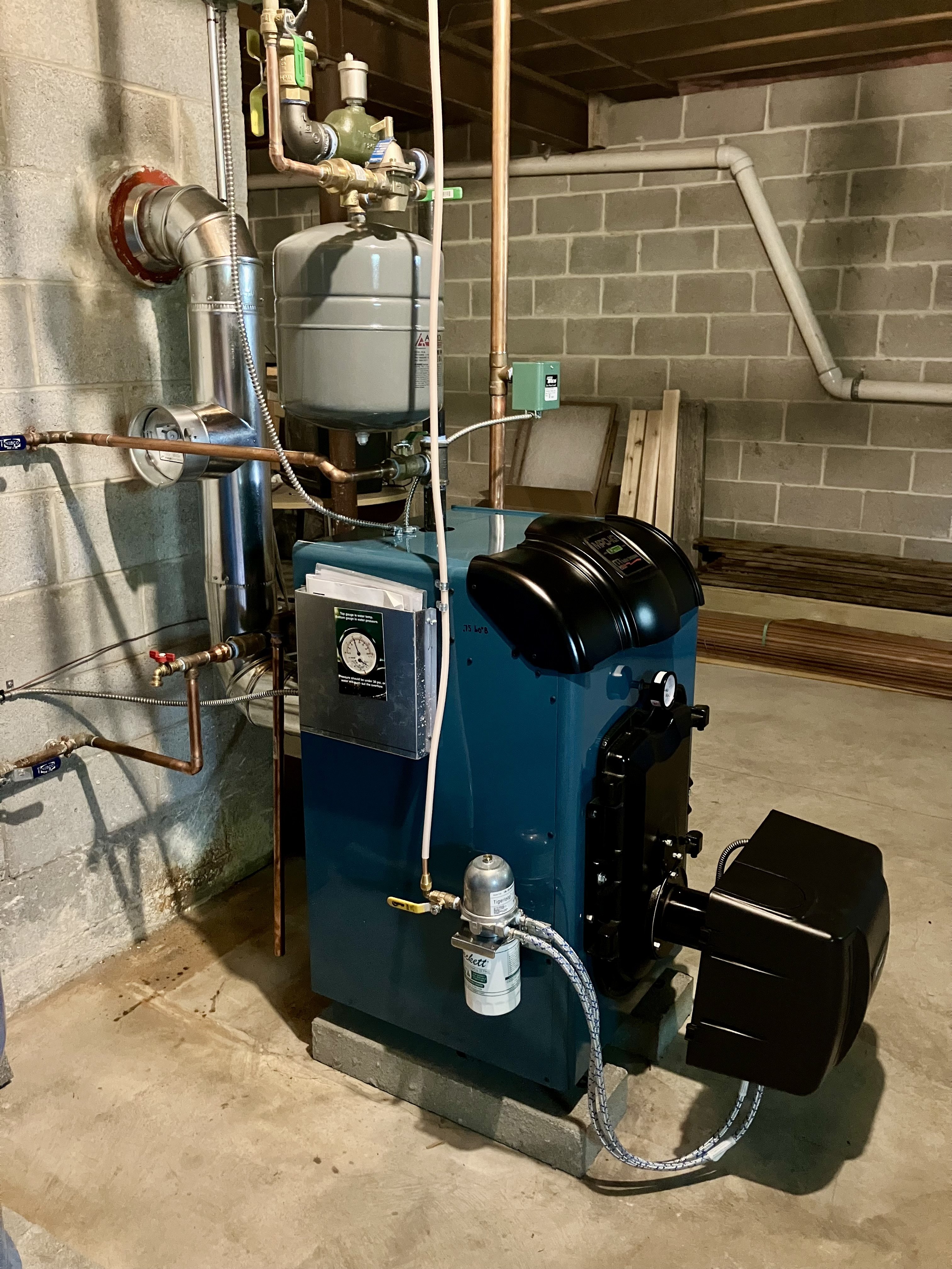

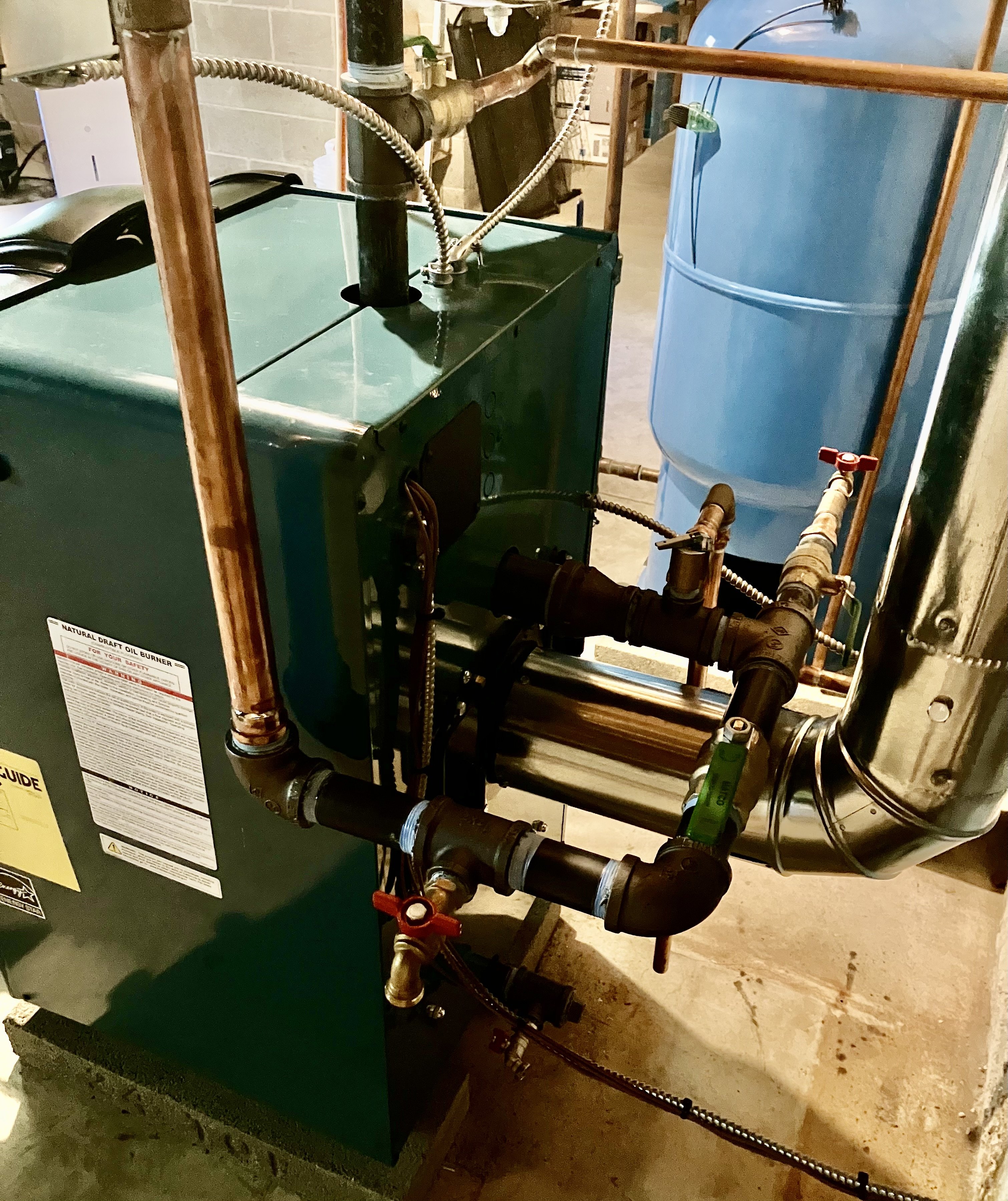

    Just following up to thank everyone for their input on helping me make this very important decision.
    I went with the Burnham MPO-IQ 147, with outdoor reset. I did not replace the indirect water tank, based on suggestions here and because it looks in perfect shape.
    I couldn’t be happier with this new boiler. It’s very quiet and even though we’re only using it for hot water now, anyway, it barely runs.
    Been monitoring it, and it seems to lose only 10° of water temperature per hour, according to the gauge, and when it runs, it runs to 170°. So it takes approximately 8 to 10 hours for it to just run without being called for domestic hot water.
    They installed something called a ‘tiger tail’ on this, so that I only have one oil line going to the oil tank…..so I no longer hear that drip of the oil going back into the tank, which is situated right below my bathroom, and always drove me nuts, hearing that dripping, echoing through the tank.
    The outdoor reset is mounted on a north west wall, because in order to get a dead north wall, they would’ve had to go underneath the porch, which is enclosed with lattice.
    Couldn’t be happier with the job they did on the installation either.
    Yeah, it wasn’t cheap, but at least I have something really nice and efficient for my money…..I just spent more than 10 grand on school taxes and I’m getting nothing out of that!!
    Thanks, again, for this forum. It really helped give me alternative voices to just the sales people.
    Looks like the contractor did a decent job. They installed a "TIGER LOOP" not a "Tiger Tail.
    Happy sailing!!!!!😊
