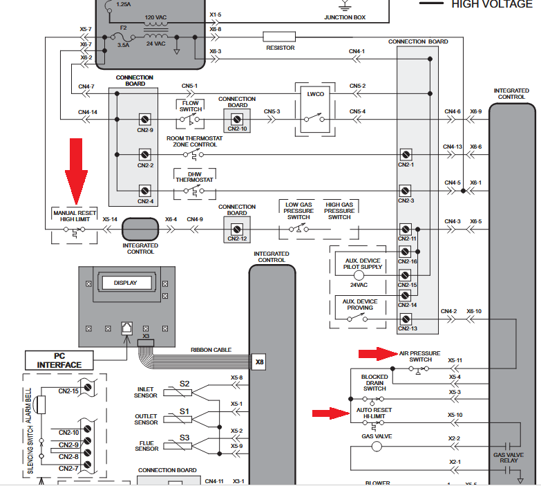

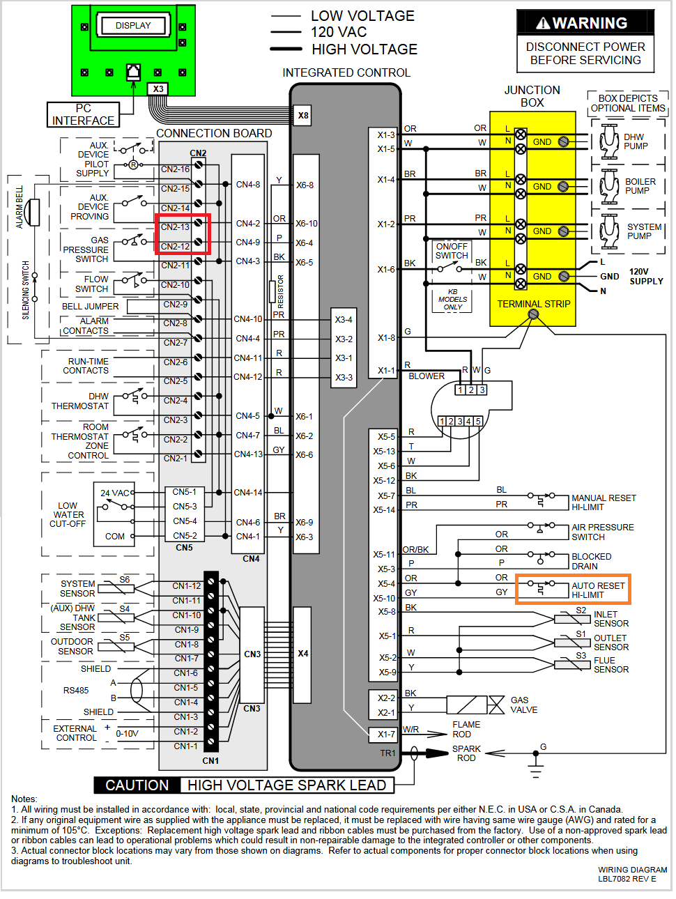

    Since the Auto Reset High Limit sensor and the APS (Air Pressure Switch) sensor circuit is fed 24 VAC power through the Manual Reset High Limit sensor / switch I would check that.
    It appears the control board expects to see 24 VAC at X5-4 and X5-10, I suspect the 24VAC is missing there due to the Manual Reset High Limit sensor / switch is open or tripped. May explain the E01 error too.
    Appears the Manual Reset High Limit sensor / switch may be an option kit, if it does not exist with your unit I would check for 24 VAC at CN2-13 and/or X5-4, and X5-10 to start.

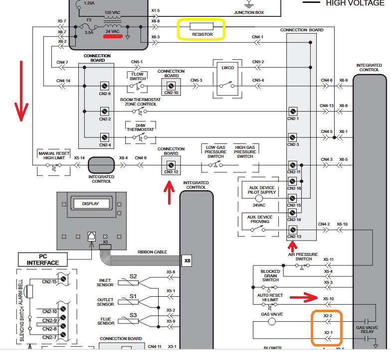

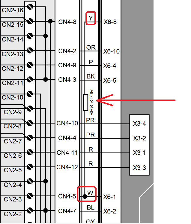

    one more thing… there is a rectangular thing that looks like a ceramic dropping resistor on the water jacket. its high on the right hand side and about middle of the heat exchanger/jacket. it is not in any of the parts books. it has 2 white wires on one side, and 1 yellow wire on the other, it measures about 225 ohms
    109A_5 Posts: 4,759
    I suspect it is a power resistor. Its values may be printed on one side. Also it is shown near the top of the partial schematic posted above.

    The ceramic resistor looks like a 'Pull Down' resistor for the DHW Thermostat input, not sure why it would be needed on the DHW input only OR it adds a few watts of added heat to what it is mounted to during a DHW call for heat, maybe some kind of hysteresis.

    pretty convinced the resistor is just a voltage dropper, and not a factor.

    which terminals on the board are 12 and 13? how is it numbered?
    and…. WHERE IS THE .. Auto Reset Hi-Limit Sw????

    You mentioned the resistor, so I commented about it. It appears when the DHW thermostat is closed there is 24 VAC across the resistor. When the DHW thermostat is open the 24 VAC is removed from across the resistor, so not sure the intent of the resistor without reverse engineering the board. Yes, I believe it has nothing to do with the current issue.

    I have seen some boards where the a Gas Valve full wave bridge rectifier is on the board just before the circuit leaves the control board towards the Gas Valve. Apparently I erroneously assumed that was the area that you damaged.
    " then I went after the 24v rectifier. it was giving me a funny reading I think comes from another component in parallel so I lifted one leg of the chip off the board and,,, I broke the trace. "
    Quite often the rectifier is in the connector at the gas valve.

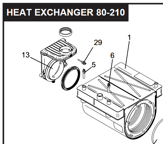

    I would think item number 6 is the ARHL (Auto Reset Hi-Limit). I think there was another thread where a similar boiler had an intermittent dual sensor in that area, it had 4 wires going to it IIRC. Maybe I can find that thread. Found it. That thread reads a lot like yours. I think the fix was to replace the sensor, when the sensor leads were flexed it was intermittent. The other thread is three pages long.
    CN2-12 and CN2-13 Red box below, ARHL (Auto Reset Hi-Limit) Orange Box below. You could chase out the Orange and Gray wires from X5-4 and X5-10 to the ARHL (Auto Reset Hi-Limit). Keep in mind this diagram is Rev. E your unit may be slightly different.

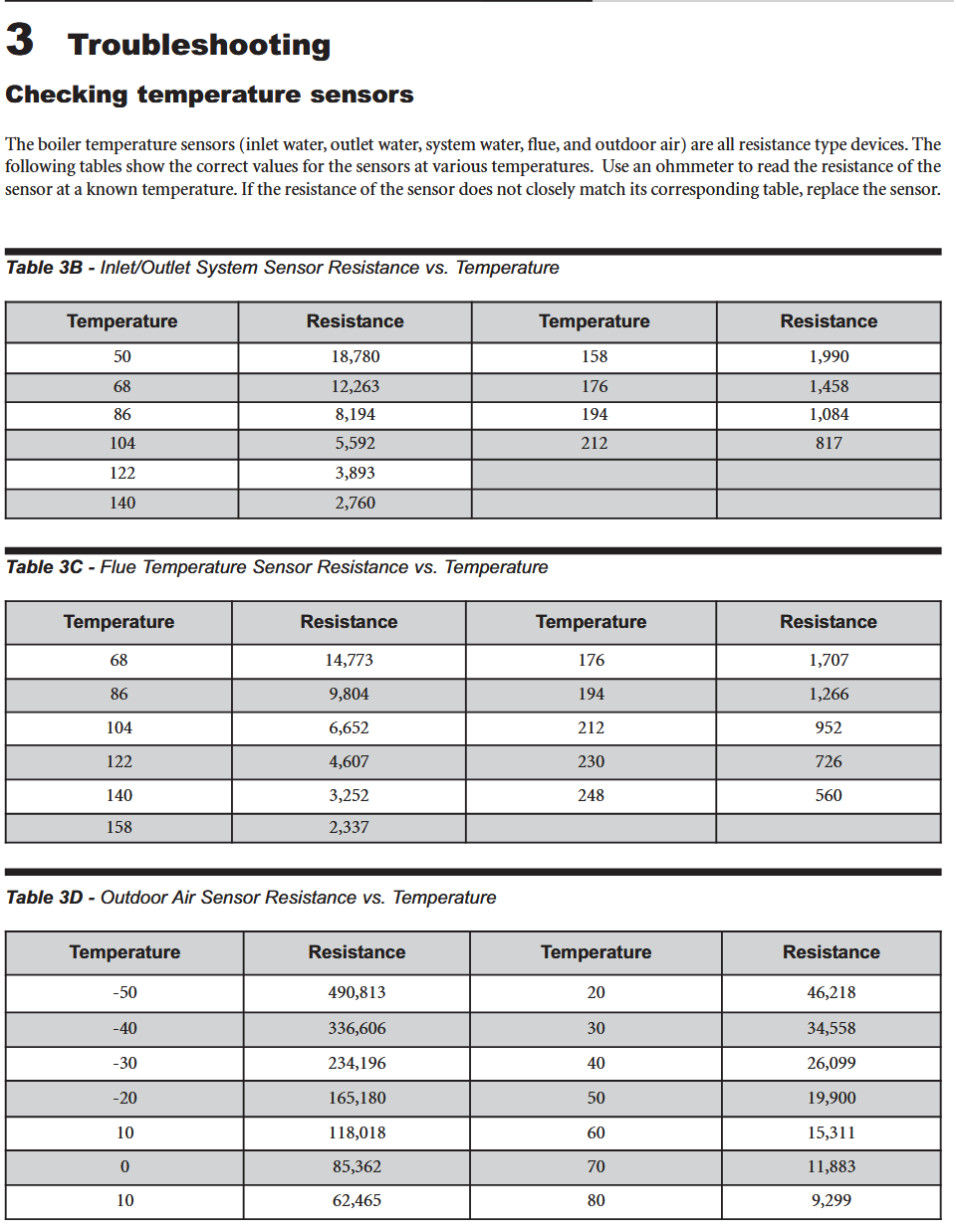

    I believe the dual sensor is (1/2) sensor is a thermistor (S1 on the diagram), so variable high resistance that changes with temperature, usually NTC (Negative Temperature coefficient), temp goes up the resistance goes down. The other (1/2) sensor is a (needs to be) thermal snap switch type (Auto Reset Hi-Limit, Orange / Gray wires) which when closed at room and normal boiler operating temperatures has a very low resistance, like less than 1 Ohm to support the load current of the Gas valve. At least that is what the wiring diagrams are telling me. You should have the original documentation, are they significantly different than my postings ?
    You may have the wrong sensor. Or your new sensor is defective. If you prefer chase out the 24 VAC that powers the Gas Valve and see where it stops.

    Here is a resistance chart from the manual of the other model in the other thread I posted. Keep in mind this is for thermistor type sensors. Self resetting Snap type thermal switches are usually open (infinite resistance) or closed (low resistance). I believe 1/2 of the ARHL (Auto Reset Hi-Limit) is NOT a thermistor and actually is a Snap type thermal switch. Having thousands of Ohms resistance in series with the 24 VAC current path to the Gas Valve makes no sense.

    thank you 109… (and I have that chart in the manual that came with my boiler)
    heres the update… everything seemed to keep coming back to the sensor so I bought another one. comparing ohm numbers with the 1st replacement shows they are different. the 2nd replacement has "zero" ohms on the orange/gray pair (auto reset), thats the same as the original. the 1st replacement switch had something like 8K (all tests done prior to installation). resistance on the outlet temp sensor was all different. the original was about double the chart numbers. I expect that was read as "open" by the control board. the first replacement was a little high, the 2nd sensor was pretty close. I made readings with sensors in cold, warm, and hot water. conclusion…. wrong part.
    so…… I put the new sensor in and it fired right up. it ran fine, but shut back down last night. code is "NO FLAME RUNNING, E01. it reset and is back running now.

    OK, I thought you said your resistance chart did not go down to room temp.
    From that chart all the thermistors seem like they may be typical 10K at 25 degree C or 77 degrees F. however they may have different curves since at other common temperatures listed they have different resistances.

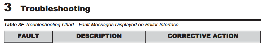

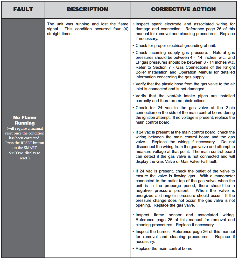

    If "no flame running" & "E01" is actually two independent but related codes (possible E01 codes listed earlier in thread), the flame may have dropped out and the boiler was unable to relight.
    E01 (No Ignition): This is a general ignition failure code and can usually be resolved by resetting the boiler.
    I would review the Corrective Actions below. Also when the unit is running gently (strategically) wiggle the wiring harness to verify there are no intermittent connections that would cause the flame to drop out.
    Also I think I saw a thread where you cleaned the combustion chamber. Maybe it needs a combustion analysis and tuneup. How is the Flame Signal and flame quality ?

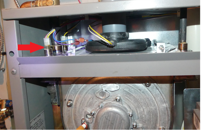

    I suspect the connector on the sensor. both the connectors on the top of the boiler are fragile. the ones below on the fan, valve, and board look fine though. and my, how time flies… the boiler is15 years old. I searched for connectors… no dice, they sell the harness though. I may have alternatives

    Pin fitment or the the pressure the female part of the connector exerts on the male pin needs to be adequate. Also poor crimps or crimps that the wire has oxidized or corroded inside of the crimp are also suspects. A vendor like Digikey.com or Mouser.com may have the connectors and pins, matching it up correctly may prove time consuming, there are many connectors and often subtle differences.
    Do any of the connectors show signs of discoloration due to heating (loose connection) ? In the event of a poor connection the boiler may shut down quickly so connector body heating may not be evident.

    the lockouts continue. once a day, sometimes more. I paid a tech to come out and he found nothing wrong. 450 down the drain because I knew more about the system than he did. plus, he didn't bring a gas analyzer. the oxy sensor for my Bacharach sniffer arrived right after he left so I tested it. hi and low combustion are in the range but not optimal. I might fool with it more this afternoon.
    I still get "no flame running" and "E01". the "no flame" will clear but E01 stays, but is says "no fault stored"
    I have disconnected the outdoor temp sender in order to uncomplicate things a bit
    is there a way to completely reset the brain box???? go back to all factory settings
    this is commencing to annoy me

    109A_5 Posts: 4,759
    Intermittent problems are typically the worst to find. Although this issue seems consistently intermittent.
    So, to me, the question is what is causing the flame to go out OR why does the control board think the flame has gone out ? Is the Flame Signal consistently good ? Catching it in the act, if possible may reveal some data. Can a normal run cycle(s) be delayed so you can watch it closer while it is running ?
    I would think there is a way for a complete factory default reset, if so I have not found it, maybe the PC software is needed, maybe only the Software Engineer knows.
    Possibly the E01 may only go away after a certain number of boiler cycles with no issues, again maybe only the Software Engineer knows.
    Is the 120 VAC to the boiler stable ?
    Is the 24 VAC stable ?
    Does your unit have the On-Off switch on the Gas Valve connector ? I think I may have read that it was eliminated due to intermittent issues, not sure.
    Is all grounding and internal ground bonding intact ?
