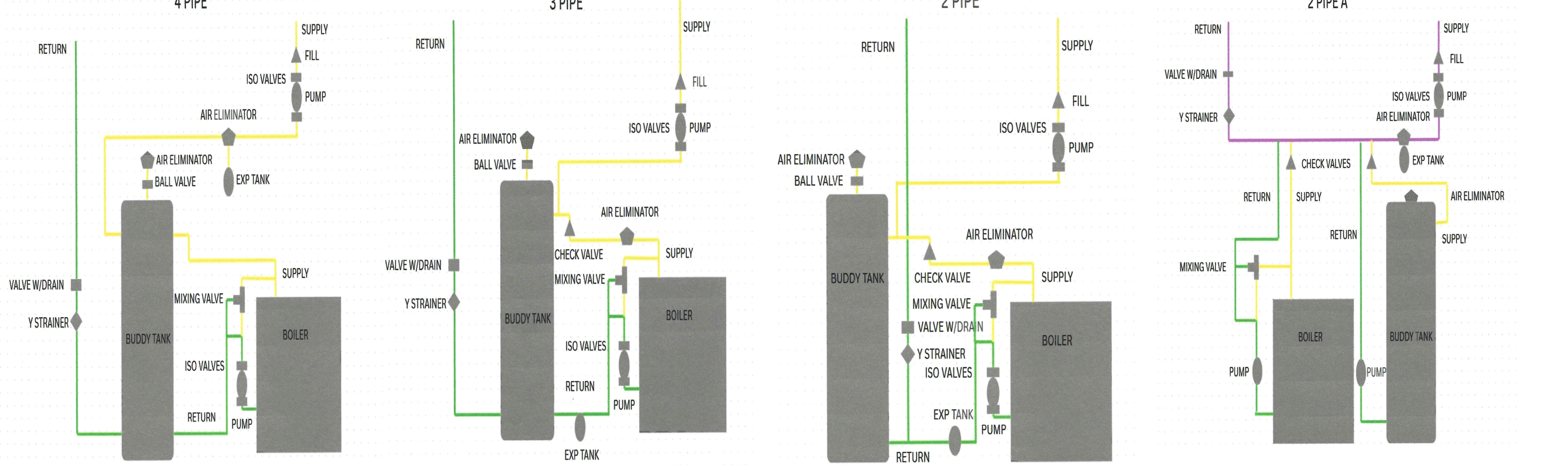

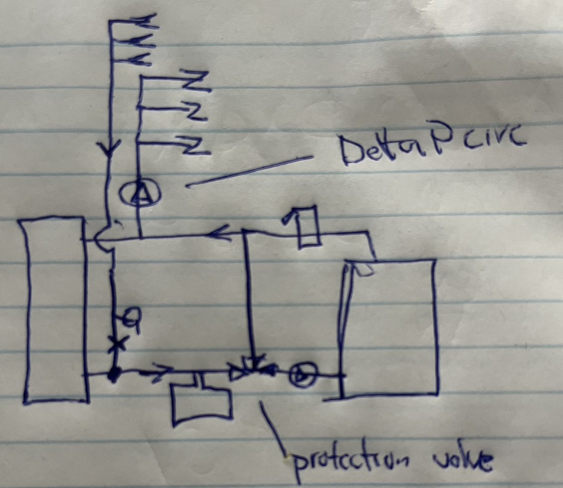

Hi,
We installed a 80% boiler with mfg outdoor reset (160 DEG) but it short cycles. There are 3 zones, but the loops are ½" instead of ¾".  We are figuring that we will have to install a buffer tank with primary / secondary loops.
Just wondering which diagram you would recommend & why? Also would you recommend a variable speed delta T or delta P pump. I was thinking we could also add a taco outdoor reset that goes down to 140 deg also…
Would you also recommend only running the boiler pump when the burners are on?

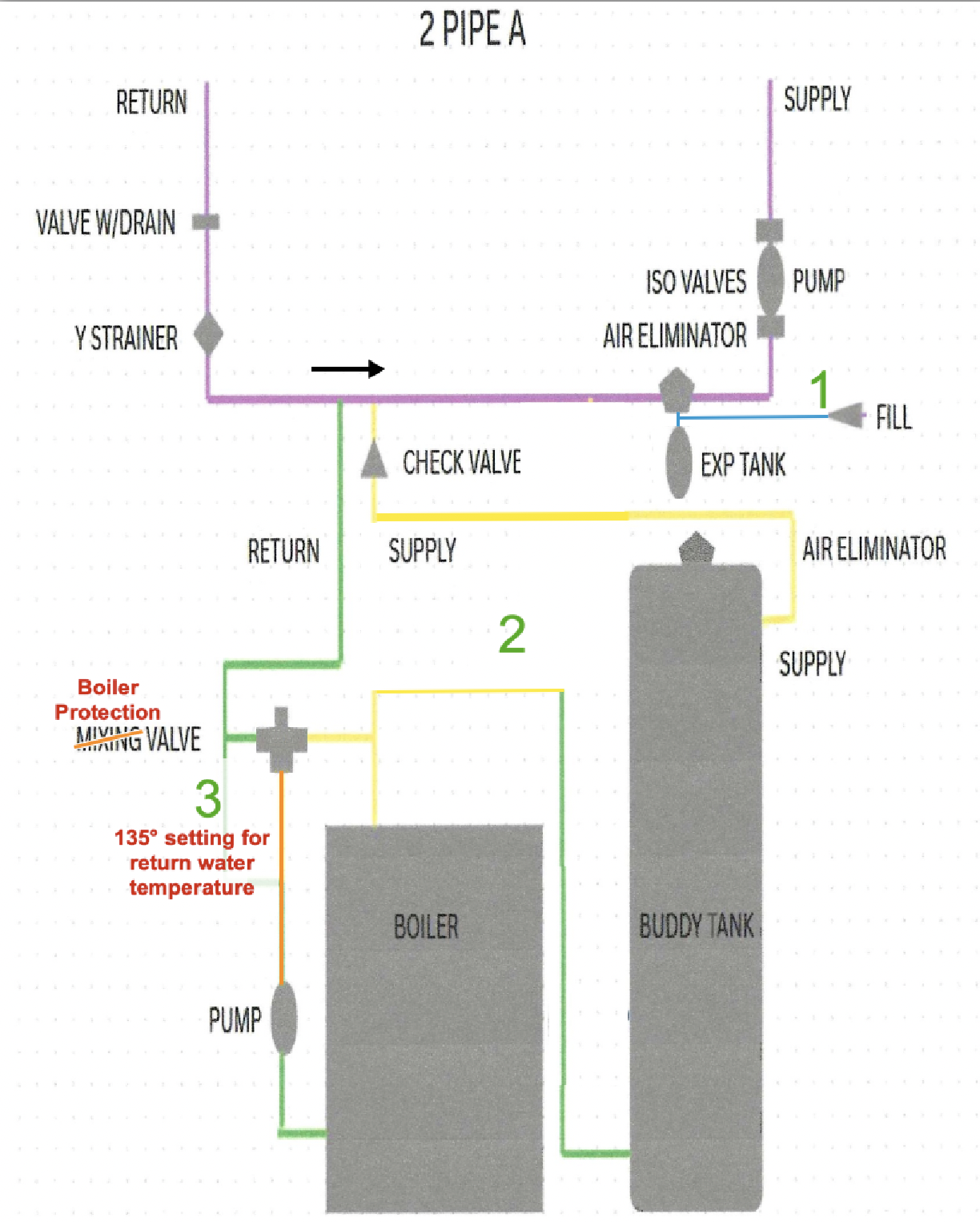

    EdTheHeaterMan Posts: 12,946
    I looked close at your 4 different piping diagrams. I believe the 2 pipe A is the best choice.
    I would make some minor changes though.
    1. I like to place the water feed valve at the same location as the point of no pressure change (PONPC) which is always at the expansion tank.
    2. I also don't believe that you need to have a separate circulator pump for the buffer tank if you pipe it in series. having another secondary loop just for the buffer tank is just adding unnecessary parts and pipes.
    3. Finally remove the return pipe bypass around the boiler protection (mixing) Valve. that bypass defeats the purpose of the boiler protection valve Screenshot 2025-07-01 at 8.17.15 PM.png
    Of course there is not really enough detail in your post to find a definitive "BEST" piping design. With a 15 foot of heating element zone and such a that might only deliver 6000 BTUh from a 77,000 output boiler (See Note1), you can be sure that the boiler will heat up very fast if that is the only zone calling for heat. There are others like @hot_rod who design this kind of stuff all the time and might suggest another piping arrangement with something called a Hydro Separator that will perform the job of the primary secondary piping design, add a little extra water volume like the buffer tank and have the function of boiler protection without the mixing valve, when designed properly. There is a lot of math involved that he has built in to the filing cabinet in his head. ( I would need to spend hours on the design to get it as good as he does in 5 minutes.)

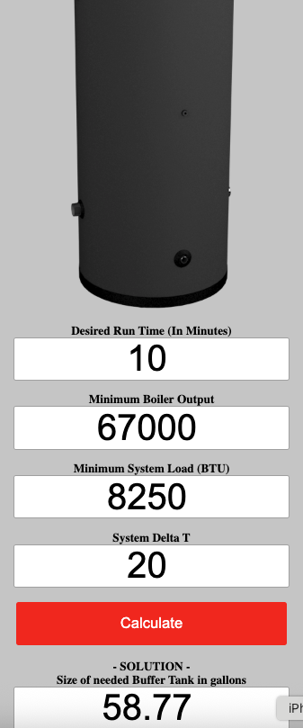

    Zone 1 being 8250 BTU/ hr (550 btu/ ft X 15')
    Call the boiler 67,000 out. 10 minute minimum run time. So a 60 gallon buffer fits nicely..
    Lochinvar U for the Tank Simulator program.
    A 2 pipe buffer like this, 280 boiler return valve, delta P circ with 3 zone valves.
    A well insulated buffer should not lose all that much heat, and it is inside the building anyways.

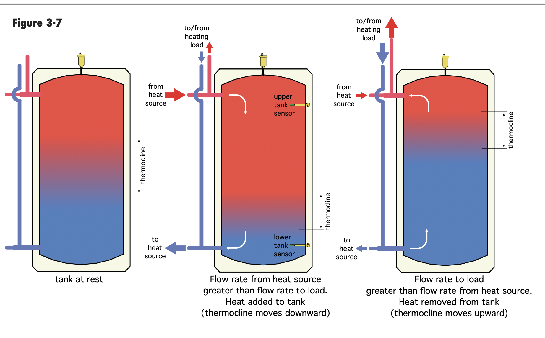

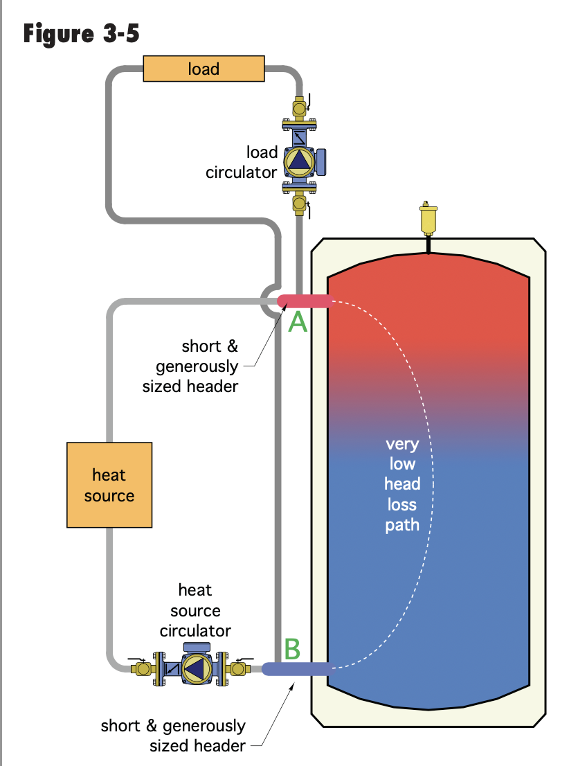

    This is a direct to load buffer piping. When all zones call little if any flow through the tank. The large piping at the tank is your hydraulic separation function.

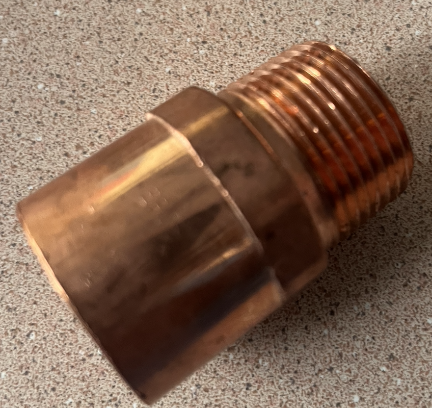

    I have used electric HW tanks as buffers. Remove the elements and increase those 1" ports to 1-1/4" A 1" MIP X 1-1/4" copper adapter for example.

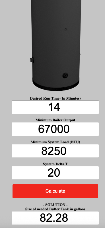

    hot_rod Posts: 28,704
    80 gallon gets you about a 14 minute run time. If you go to the expense of installing the buffer, go with the 80. 50 gallons only gets you 8 minute run time.
    There is no code or hard and fast rule for what a short cycle is defined as. 10 minute run time is generally an industry accepted number.
