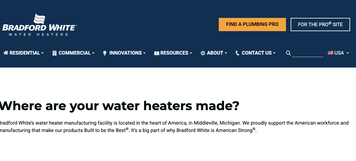

    wcweaver3
    I believe BW used to have their plant in rural michigan somewhat near me, I know others are in the south somewhere. There are a couple manufacturers but nowhere near as many manufacturers as brands.

    Thank you @Larry Weingarten @Alan (California Radiant) Forbes @Mad Dog_2 @MikeL_2 @Intplm. @EBEBRATT-Ed @STEAM DOCTOR @hot_rod @mattmia2 I really appreciate the great responses and strong guidance!

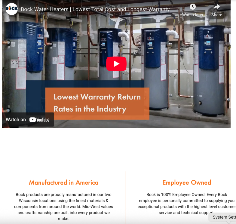

    hot_rod Posts: 28,708
    Bock is another tank built in the US. Their tanks used to be thicker steel cylinder and heads, thicker glass coating, even thicker sheetmetal jackets. You could tell by the weight listing compared to others.
    Screenshot 2025-06-30 at 8.05.25 PM.png Screenshot 2025-06-30 at 8.06.18 PM.png
