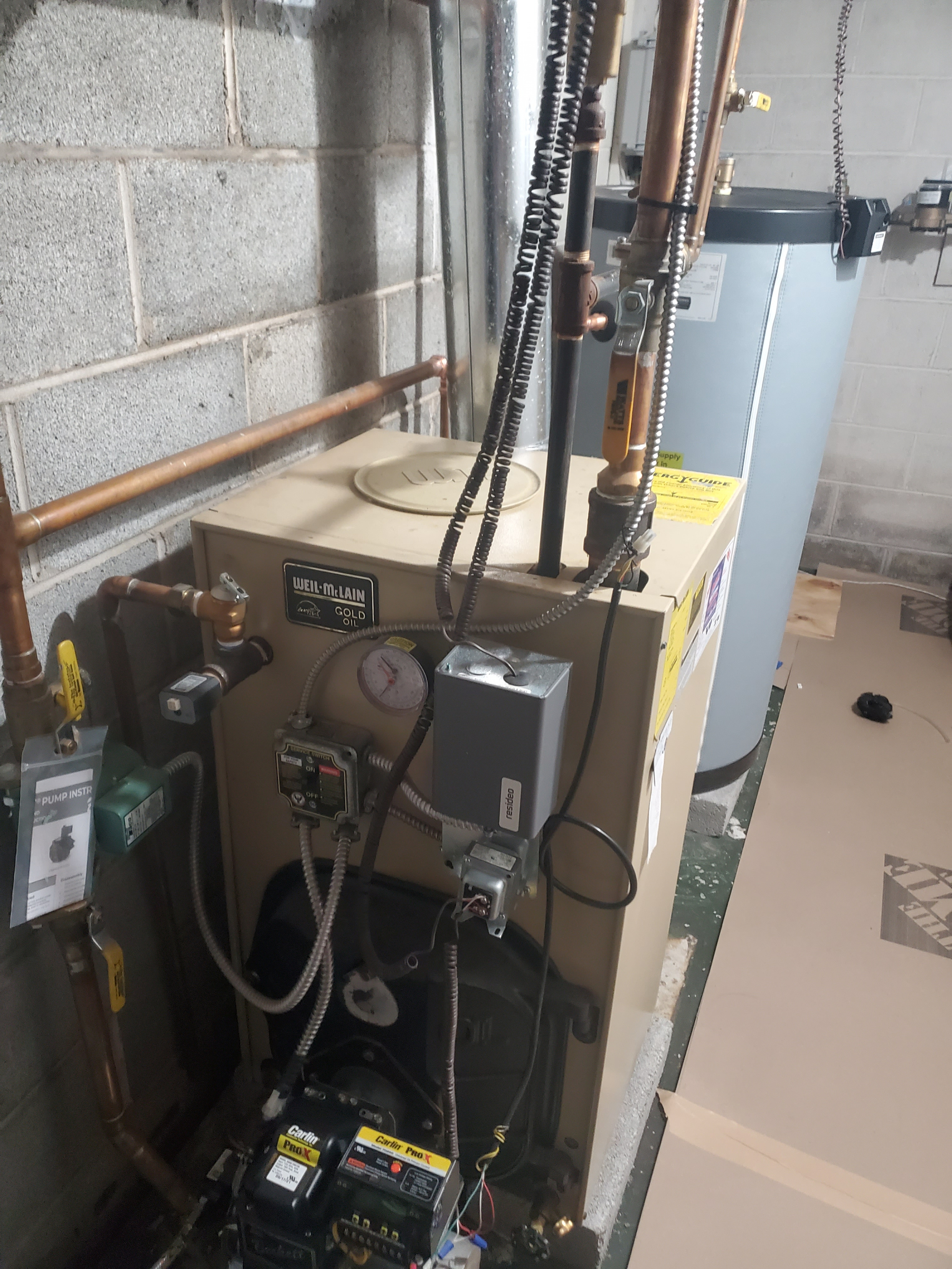

    Can you take a Photo of the boiler from far enough away so we can see all the controls, the oil burner, and the pipes that reach the ceiling of the boiler room. Maybe from two different angles. This will reveal a lot of information about your system.

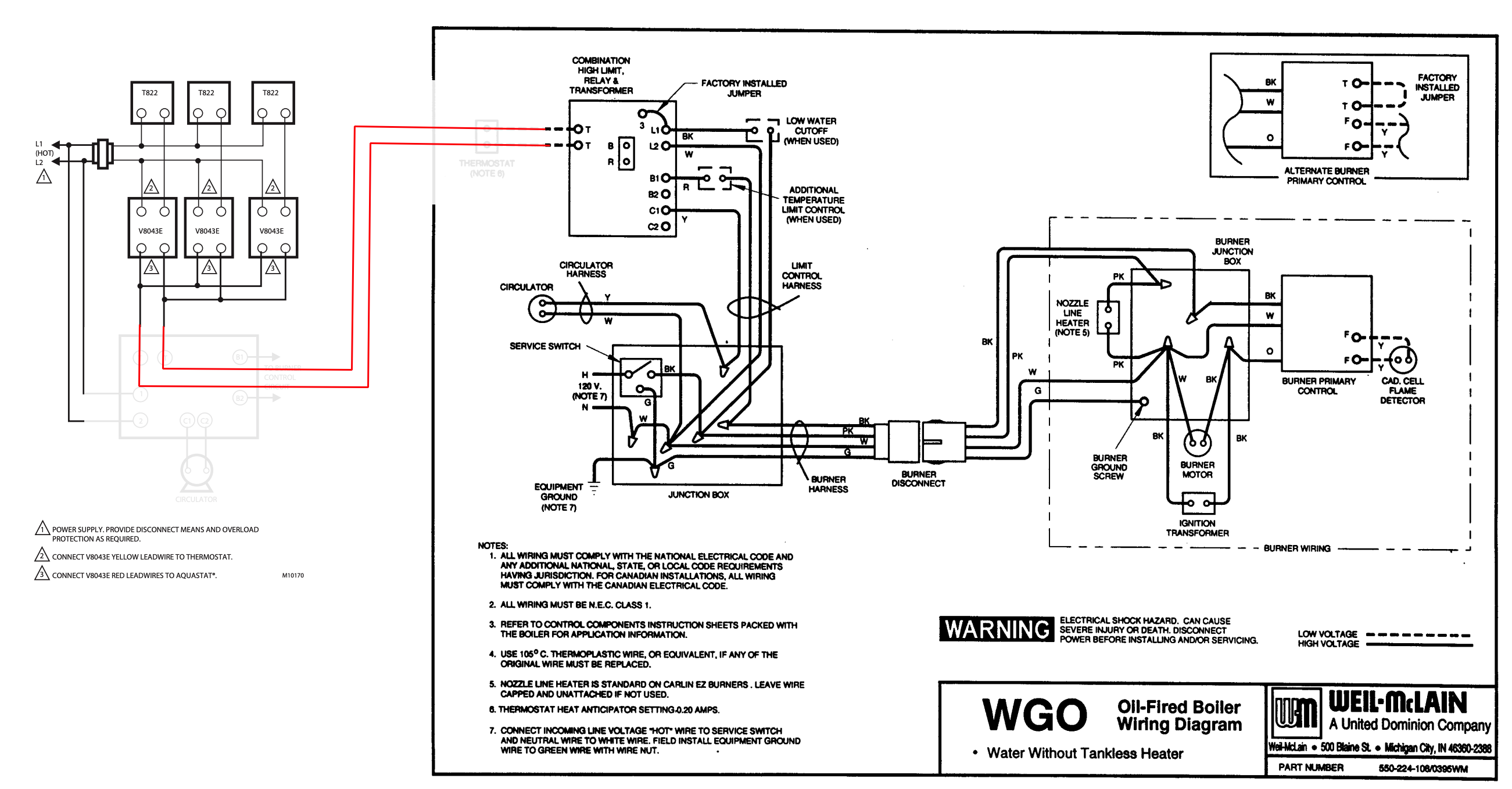

    Here is the water heater Sequence Of Operation (SOO) for a Weil McLain WGO series 1 that is using Honeywell zone valves.
    1. Boiler on stand-by with no call for heat of DHW
      1. The house needs no heating at this time
      2. The water heater is up to temperature and is not in need of additional heat at this time.
    2. Call for heat from the DHW as a result of stand-by loss over several hours of no hot water use.
    3. DHW zone valve receives the call for heat from the DHW aquastat
    4. Zone valve opens, the end switch closes (turns on) to signal to the L8148A aquastat that there is a call for heat
    5. The L8148A relay pulls in and contacts for the oil burner and the circulator are closed (turned on)
    6. The limit on the L8148A measures the water temperature of the boiler and determines if the water temperature in the boiler is below the limit temperature set point and will power the oil burner primary control.
      1. if the boiler temperature is below the limit set point, the burner is powered immediately
      2. If the boiler temperature is above the limit temperature the burner will not start until the boiler temperature drops below the cut in temperature of the limit aquastat
      3. regardless of when the burner starts, your oil burner may have a time delay in the sequence of operation that prevents it from starting as soon as it gets power from the L8148A
    7. The circulator will start at the same time as 5 above with no restriction to what the boiler temperature is.
    8. Once the call for heat is satisfied at the DHW aquastat, the circulator and burner will stop operation as soon as the zone valve closes and the zone valve end switch is open (Turned off).
    So as long as the 160° water temperature in the boiler is lower than the limit setting of the L8148A, the burner will start at the same time as the circulator, absent any time delays that result from the oil burner primary control’ Sequence of operation.  These oil burner delays may be prepurge timing on the primary control along with power venting devices not normally associated with oil burners that are vented thru a standard chimney.
    The above SOO is based on Weil McLain and Honeywell recommended control wiring design.
    You may have a wiring design that differs from "best practice" or recommended wiring designs or may have a different Weil McLain boiler. The SOO for Zone Valves and the L8184A is the same regardless of the boiler it is attached to.

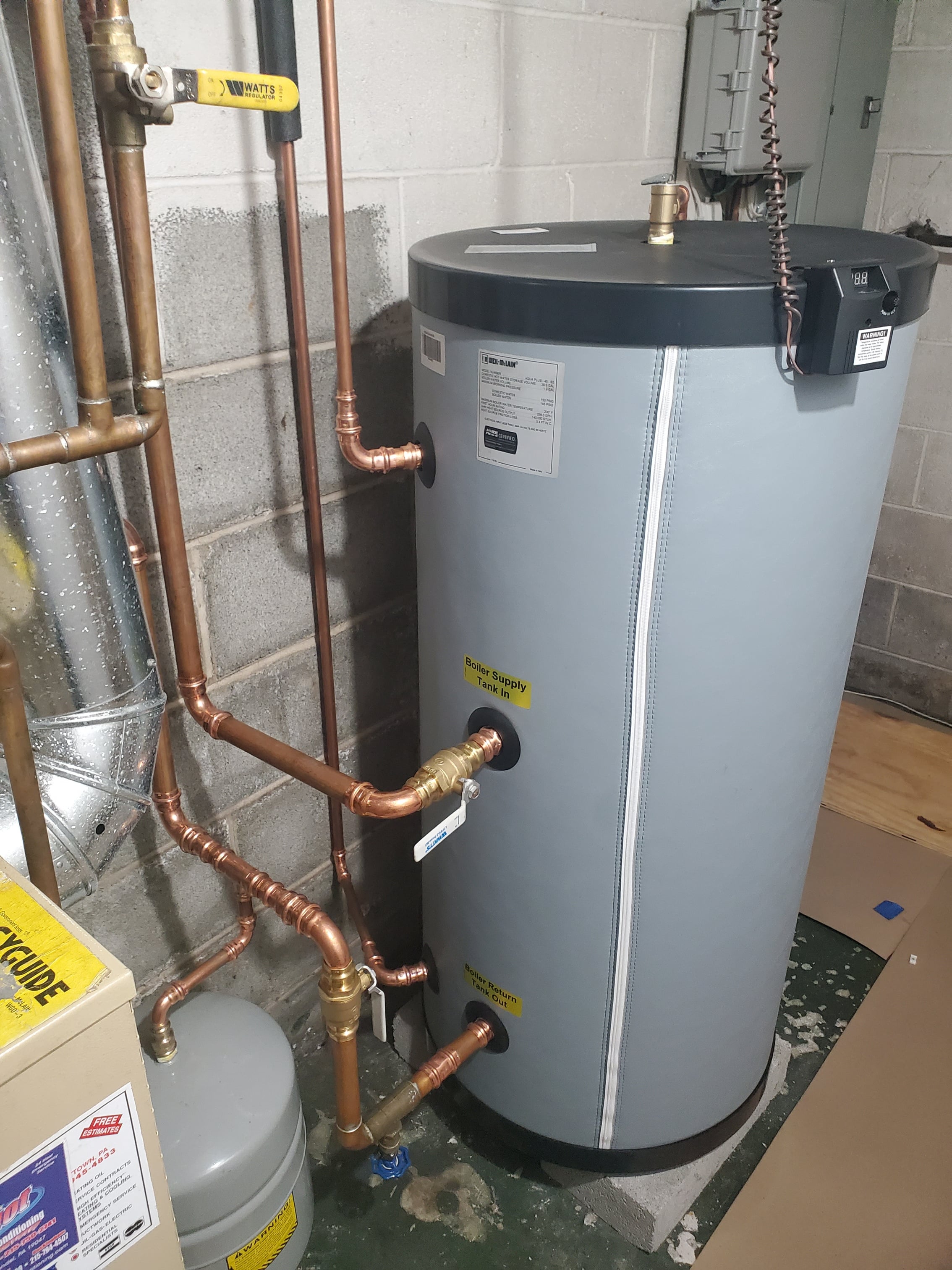

    It does seem to me that the boiler is short cycling when it runs to make up the loss of heat from the tank due to standby losses. During those periods it may only run for 1 to 2 minutes since the boiler always seems to start at 160 degrees.To provide some more information the boiler is Weilmclain WGO with 100,000 net btus feeding a Weilmclain Aqua Plus 45 gallion tank set at 135 with no mixing valve. There are two adults in the house
    and my wife loves "hot" water. There is 1 inch piping from boiler to tank. Tank was installed last week. Never had a tankless coil in boiler.

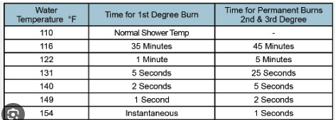

    hot_rod Posts: 28,704
    Be careful with DHW set that high, caution guests, especially small children, elderly adults, to the hot water being "hot" It only takes a few seconds to get a burn at 135°
    Most single handle tub shower faucets have a temperature function now a days.

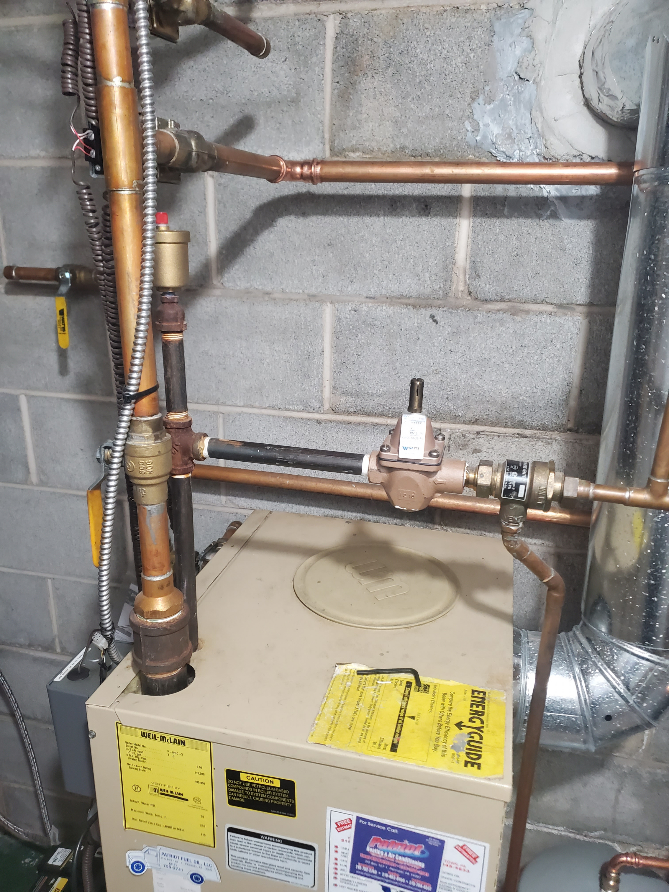

    Piping looks fine for maximum input from boiler to tank.

    HVACNUT Posts: 7,784
    So many variables just looking at it.

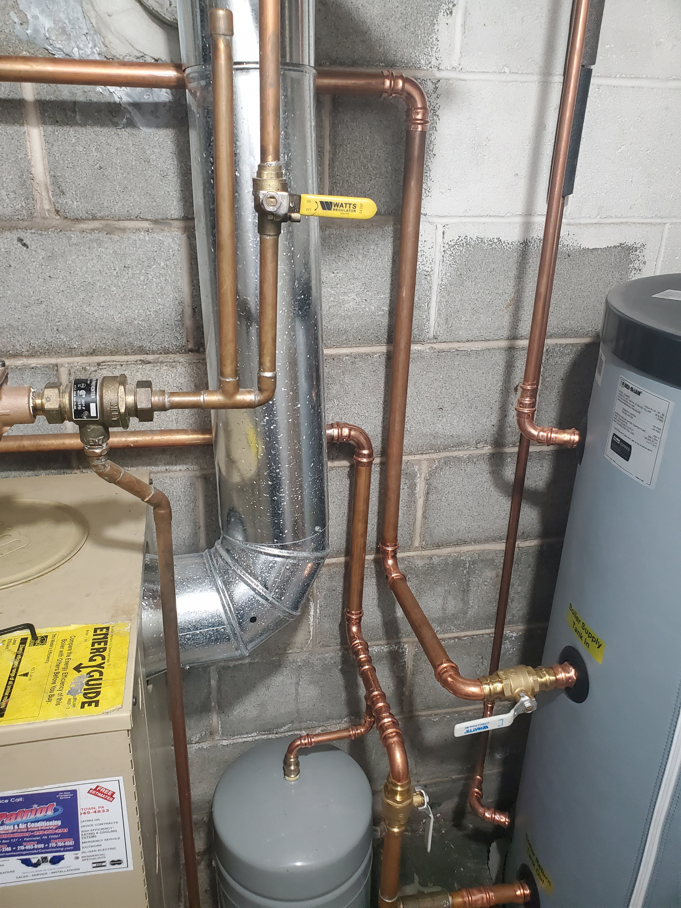

  • The piping work looks well done, but they should be insulated, the expansion tank should be fully supported and - maybe it's out of the picture - there should be an accessible shutoff valve on the cold supply to the indirect.
    Cute the way the low voltage wires are festooned, but they should be strapped to the insulated piping.
    also way more resistance since they are 3x as long as they need to be

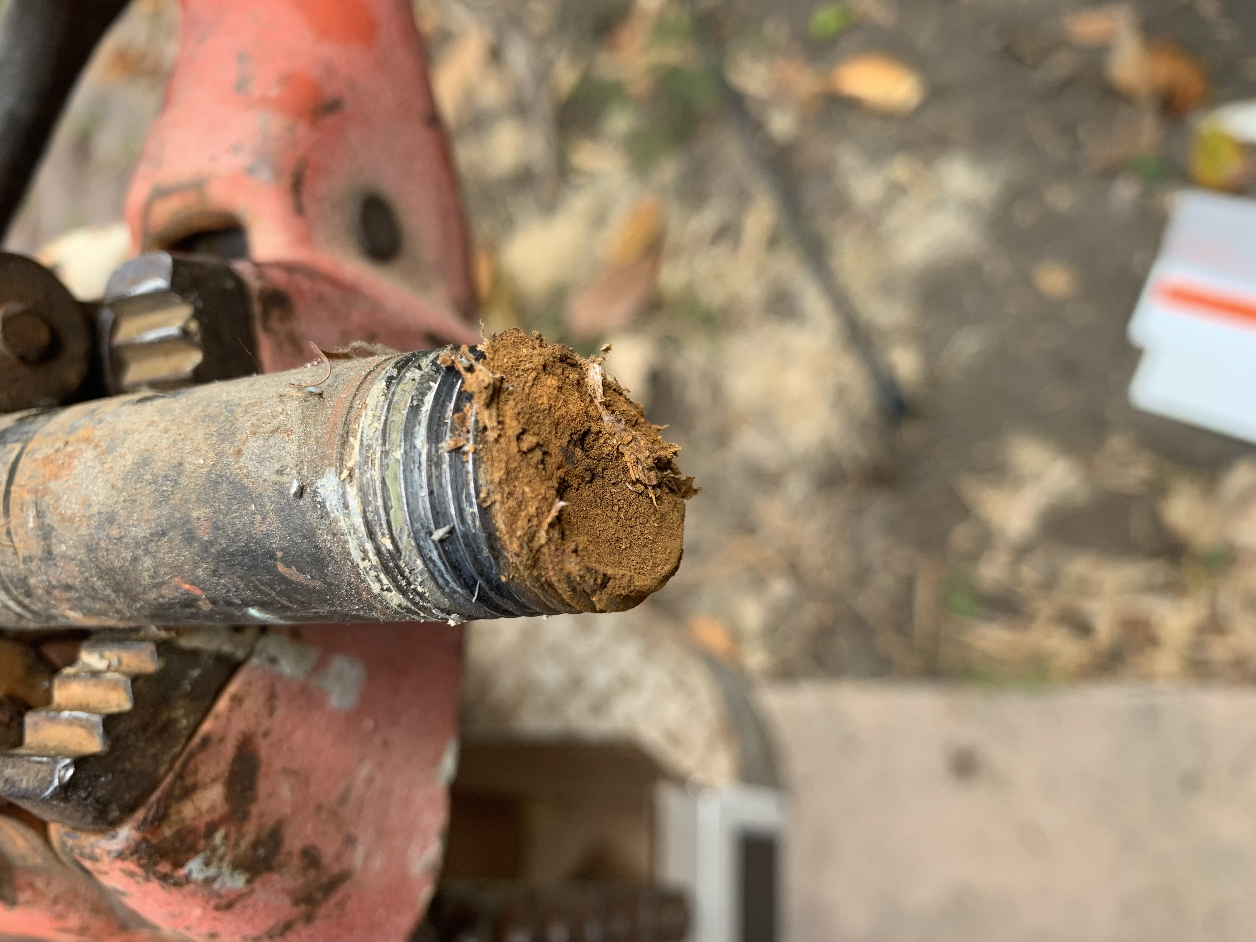

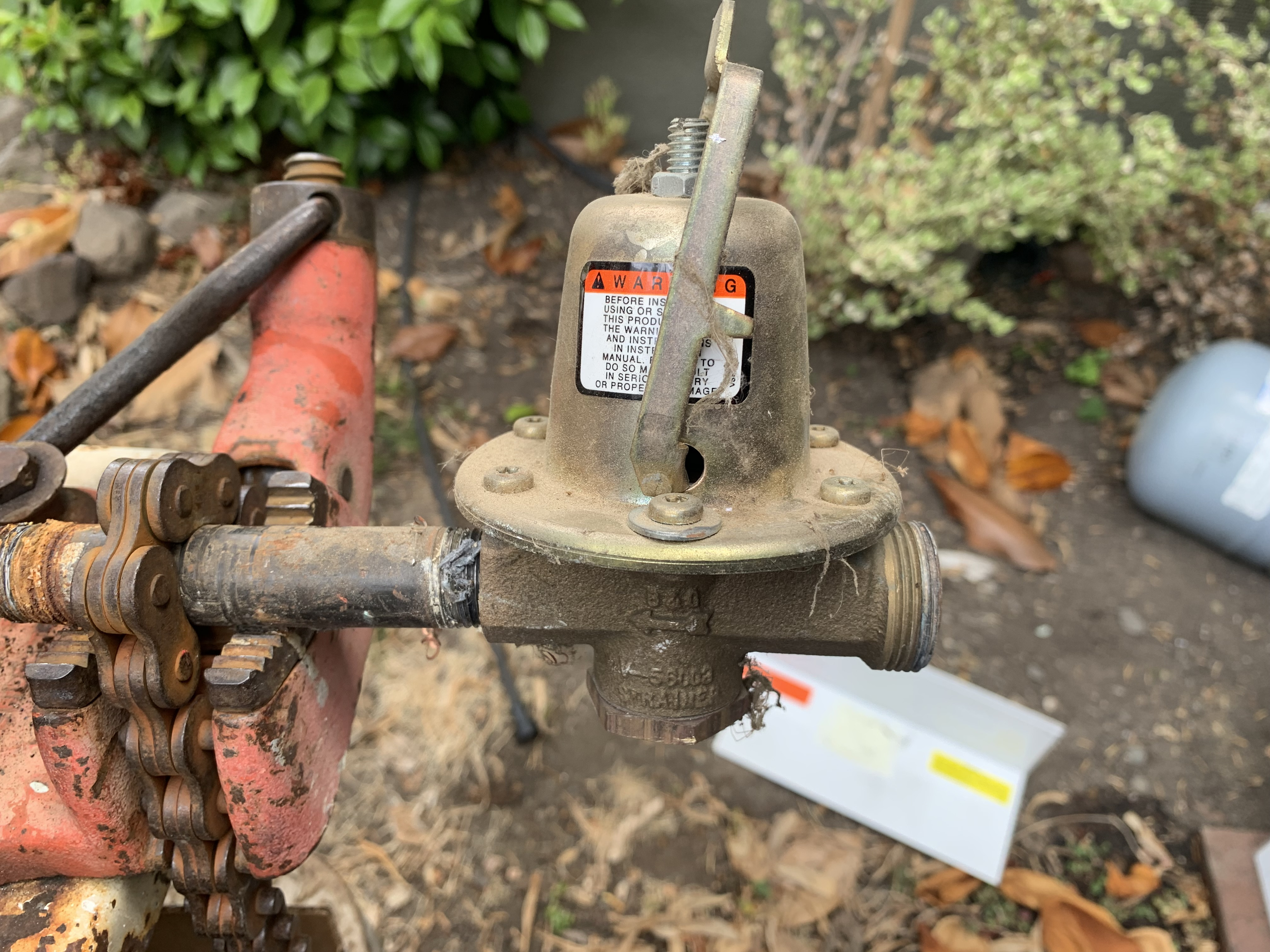

  • Why I don’t like fill valves screwed to black pipe.
    Larry Weingarten
    Putting black pipe in the water MU line even after the feeder is just stupid if you ask me. When the feeder stops you have cold water with oxygen in it sitting in black pipe. Once it is tied into the heating system where it mixes with the boiler water then BP is fine.
