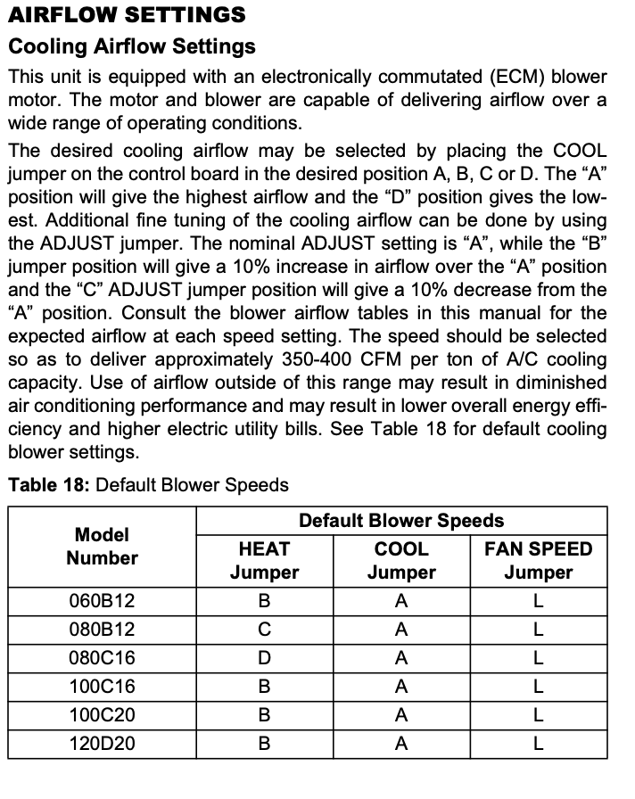

    You might want to set the fan based on these instructions: From page 33 of the manual.
    There are more details in this manual: TM9V C Series I believe the York and the Johnson are identical units
  • emerald
    emerald Posts: 9
    Thank you for the information ed. No booklet left from the installer. This is very helpful and I am going back tomorrow. I will let you know how I make out. Thanks again
