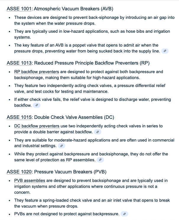

the water company is asking for a backflow on the water main at a funeral home i work at i already have 009s to protect the embalming room seems unnecessary any thoughts thanks mike

    A main premise, BFP might be a code requirement for that type of business in your area. Its more likely that the department of public health requires a main premise BFP as well as point of use protection in the form of a vacuum breaker VB or BFP.Go ahead and put one in. Better safe than sorry… for so many reasons.
    hot_rod Posts: 28,704
    BFDs at the equipment protect the water inside the building. A BFD on the mainline assures that no water that has entered the building can go back into the mains.
    The type of BFD required depends on the hazard level there are many different types of devices, both back pressure and back siphon type. I'm guessing the AHJ may require one of the high hazard versions, ASSE 1013. They need to be tested yearly and recertified. Some cities, most of Florida keep a data base to know that the device does get tested yearly.
