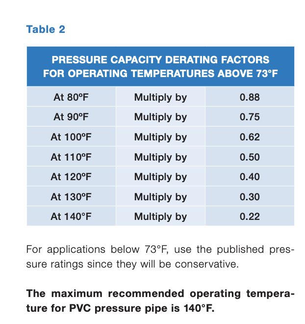

This morning maintenance back washed the pool and didn't turn off the boiler. Turned the pvc into spaghetti. Though im not sold this wouldn't have happened anyways.

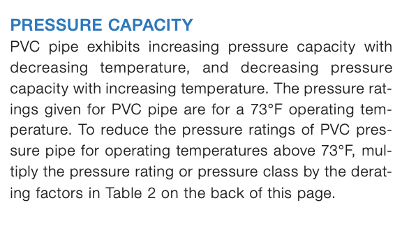

The hot water supply to the pool easily gets around 100 degrees. Maybe 110. PVC shows a rating of no more than 73 degrees so no wonder.
So im going to replumb that pvc in copper tomorrow and go to pvc at the pool plumbing. Likely pvc also but could be cpvc IPS I forget now.
Any issues you can think of besides its definitely going to turn green? Any experience seeing copper fail quickly in a pool room?

    Schedule 40 PVC is rated for 140 degrees so I don't know what pvc your using that says 73 degrees. You can't heat a pool with a 73 degree supply temp. it would take forever to heat up if it even heats up.
    Why would backwashing the pool turn the PVC into spaghetti? The boiler is on its own boiler side loop and should have its own aquastat to set the temperature of the boiler side loop. the pool side loop of the heat exchanger should have its own set point control.

    I dont think I mentioned this but the aquastat I found was also wired close on rise. So when it got hit it just never shut off. Have already corrected the controls. Not sure why the boiler never shut down but it was set to 185 anyways so there's lots to go over before I start it back up.

    hot_rod Posts: 28,704
    73 is commonly seen on PVC. There is a pressure temperature correlation
    . Sounds like a temperature control or high limit failed causing the excessive temperature? If temperature at the boiler was set to 150°?

    Resolved:
    The backwash had nothing to do with it. Controls were a mess. I tidied it up and put a boiler kill switch in the pool room. Straitened out the pool temp controller, brought that boiler loop down from 180 to 150. Limit to 200. And pool temp at 80.
    Replumbed in copper and tested all the stats and safeties. Running good.
