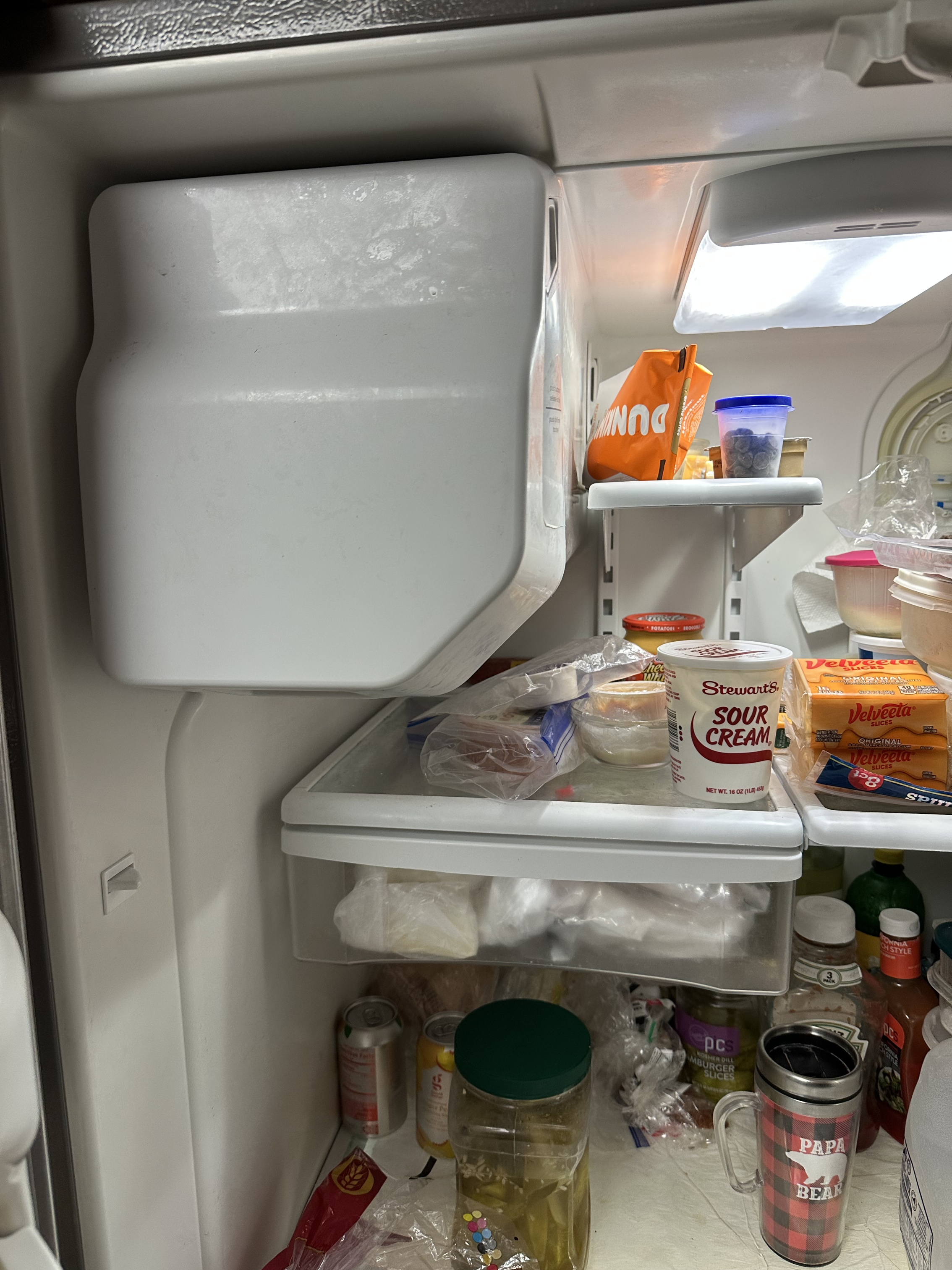

I have a Maytag French Door refrigerator, MFX2571XRM1, purchased around 2011. The icemaker, W10300024, and ice bin became full of ice. Upon removal of the ice bin, it was found that the movable arm for crushing ice cubes had become disconnected from one of the pivots and was jammed. It is not known how or when it happened. The arm is the plastic piece with the metal rod end in the picture.
With the ice bin removed, I removed all ice cubes and other frozen water from the bin, including breaking up cubes in the tray and in other places in the bin housing.

  • I don't see any duct for cold air to circulate around the mold. The arm I show in the picture is at the bottom of the bin assembly. It looks like it rotates to close off an opening for cubes and directs the cubes to the crusher.
    I don't fully comprehend how the thermostat, fill valve, fill arm and ejection motor interact. Obviously, the fill arm has to sense the need for more ice, then the fill valve actuates for a specific period of time (not volume), when the ice is frozen, the heater comes on to loosen the cubes and the motor turns the "fingers" to remove the cubes from the mold and let them fall into the ice tray (referred to on the web as ice bucket).
    You should be able to find the service/installation instructions for that ice maker somewhere.
    The arm at the bottom of the ice bucket doesn't have anything to do with the icemaker, it is part of the dispenser in the door.
    The arm at the top right of the icemaker is what controls if it ejects cubes or not. If it is down far enough when the cubes freeze it starts another cycle. If the ice or the stop is holding it up, it doesn't cycle.
    The duct may just be a cutout in the back partition or the way the vents are oriented in the back of the freezer compartment. My side by side has a little duct that snaps in to the back partition that directs cold air on the ice mold.

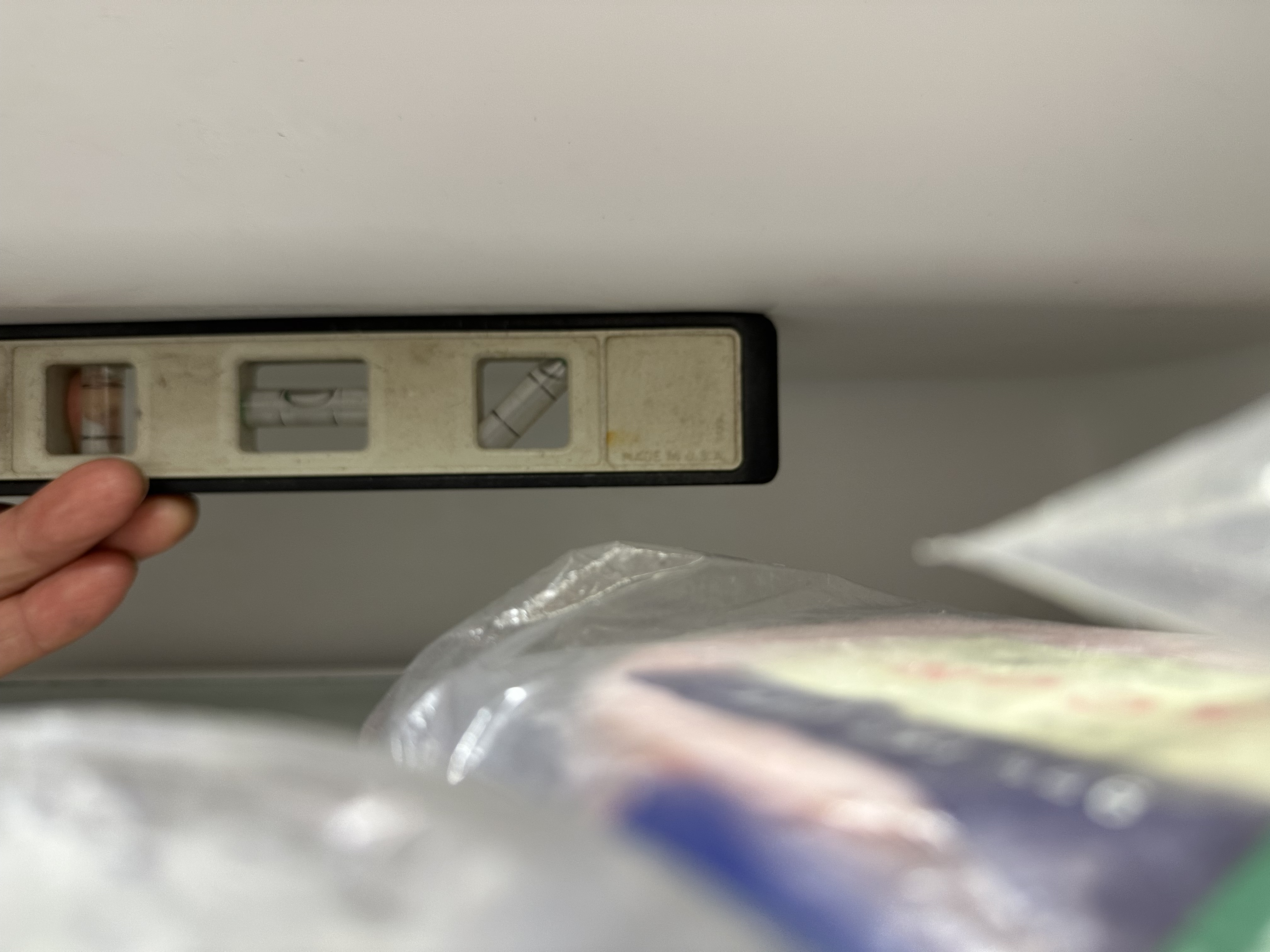

    When this started happening, I checked the level of the refrigerator cabinet at the top of the unit. It was dead on level. In one of the earlier runs, the cubes were different sizes from one end of the mold to the other, hinting at a level problem. I speculated wildly that my house had moved in the spring (no pun intended) and was now out of level. I have no idea how level the refrigerator was a year ago, when everything was fine.
    Since replacing both the icemaker and the dual valve, individual runs about an hour apart show the following amounts of water (ccs) in cubes (after melting) and in the bin (both water and ice).

  • I just checked the floor and top of the refrigerator. They are level.
