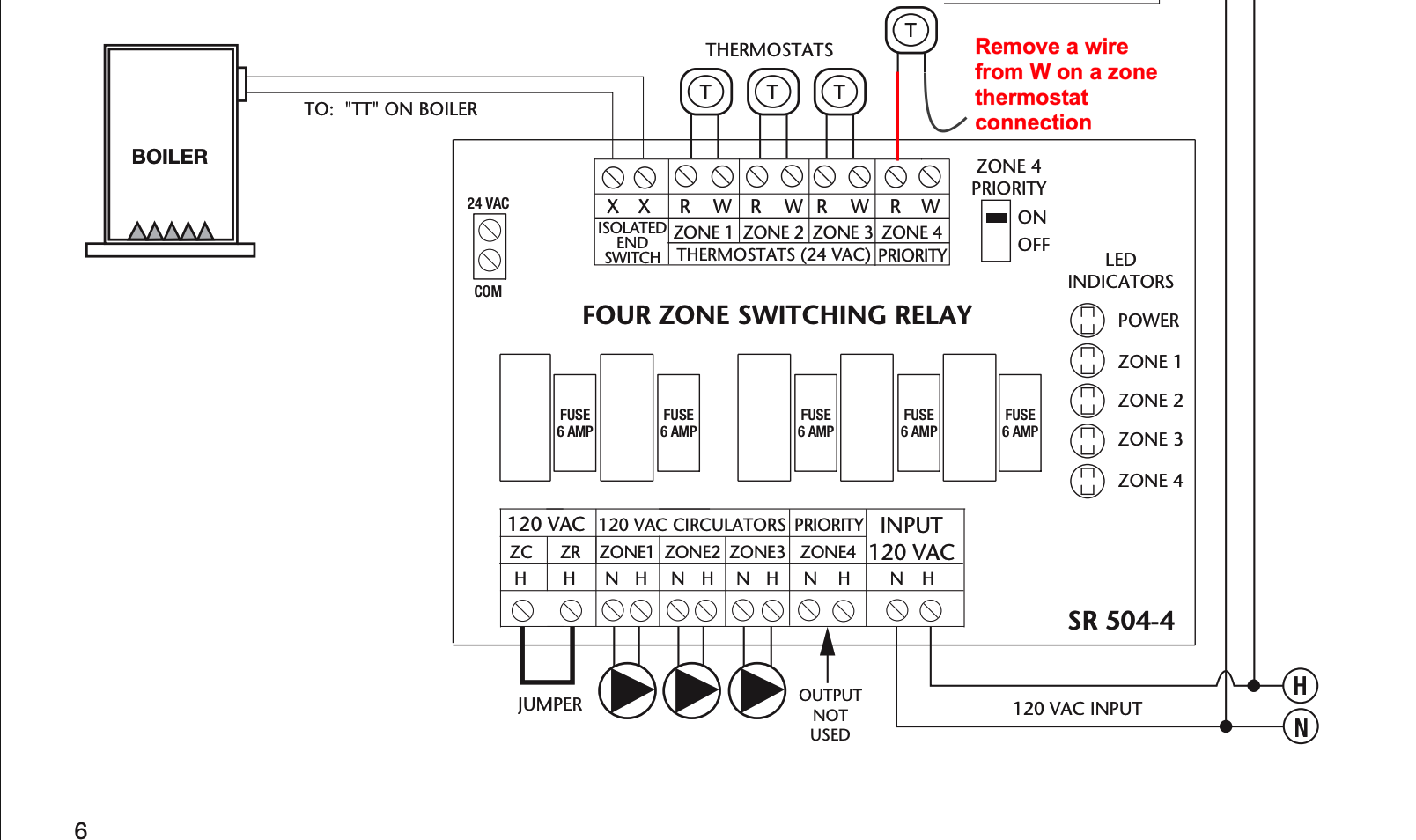

I have both zones turned off and I noticed my boiler kicked on and opens the zone valve for one of my zones. Even with that zones thermostat taken off its mounting base it still runs so I'm thinking maybe it is the aquastate?
I replaced the L8148j1009 aquastate in February so I'm hoping its not defective but with no other change to the system and me removing the thermostat from its base, the aquastate is probably the culprit.
What are the testing procedures I need to follow with my multimeter to varify how everything is working?

    It should work the other way around. The thermostat opens the zone valve, and the zone valve requests the boiler. The aquastat will run the boiler — or not — depending on whether the boiler is hot enough.
    What you need to do is to disconnect the wires from the thermostat at the zone valve and see if the zone valve closes. It should… If it doesn't, there's a problem in the wiring, assuming the thermostat is off its base.

    EdTheHeaterMan Posts: 13,030
    edited October 18
    Taco and Honeywell make more than just one control. Let me guess: your Honeywell control is an L8124-type control. The A, B, or other letter in the sixth position will tell us more about that particular control.
    As far as the Taco control is concerned, does the model number start with a Z or an R? If it starts with the letter Z, then you have zone valves, and the red light indicates that the end switch is closed, meaning the valve is in the open position.
    If the red light is on on either control, that indicates a call for heat. Therefore, the thermostat wires may be connected in some fashion, either intentionally or unintentionally, as in the example of the screw or nail connecting the wires above.
    @abro42, to start the problem diagnosis you remove a wire from the Taco Zone thermostat that you believe should not be calling for heat. If the call for heat stops then the Taco control is operating properly and the problem is related to the thermostat and wire connecting it to the Taco Control.
