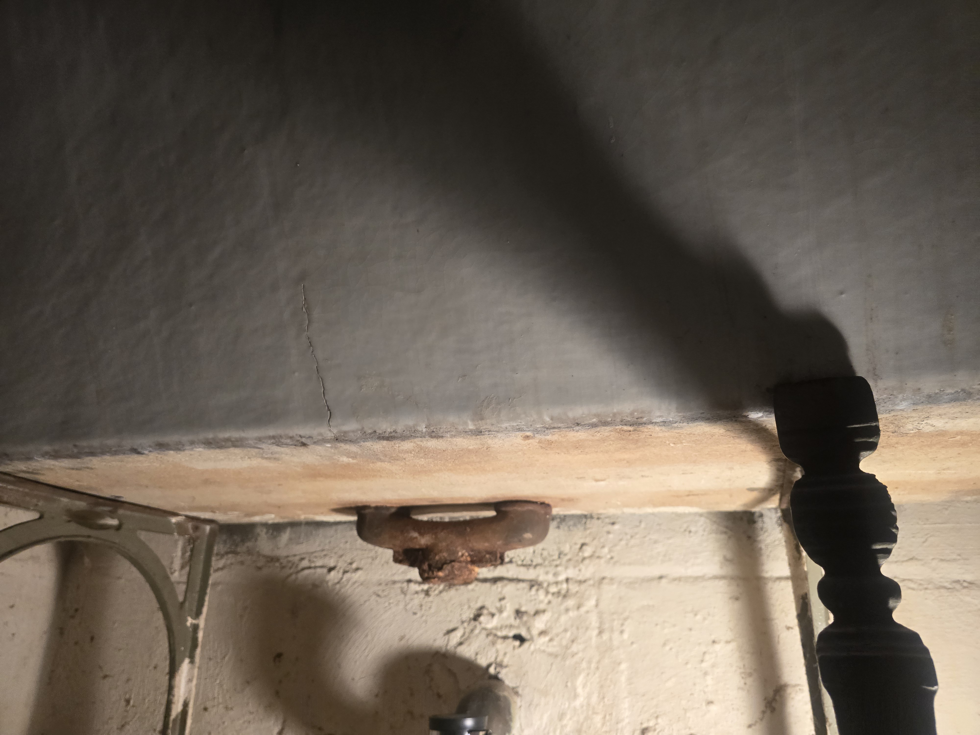

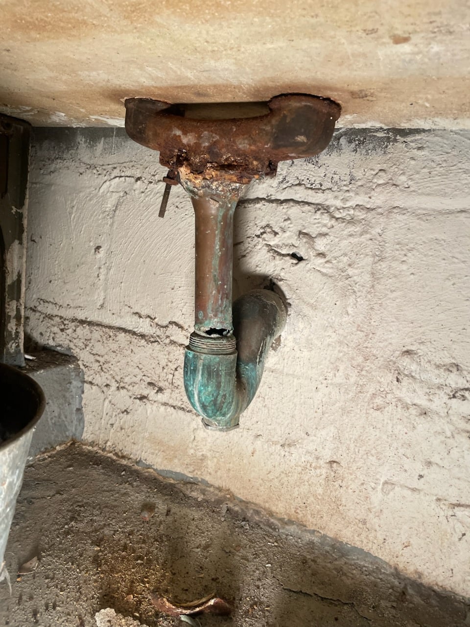

Replacement for Old School Dual drain slop sink
If Christ Supply in New Hyde Park (Est. 1810) ain't got it......Anyone have a source? Thanks Mad Dog

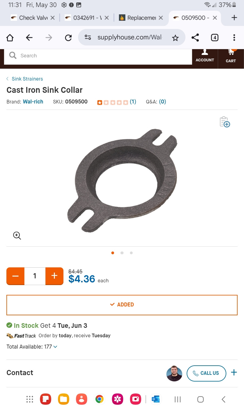

Are the studs that hold it on still viable? At least the single version is just held on with studs and nuts like a disposal outlet. Could use 2 singles and a tee too.

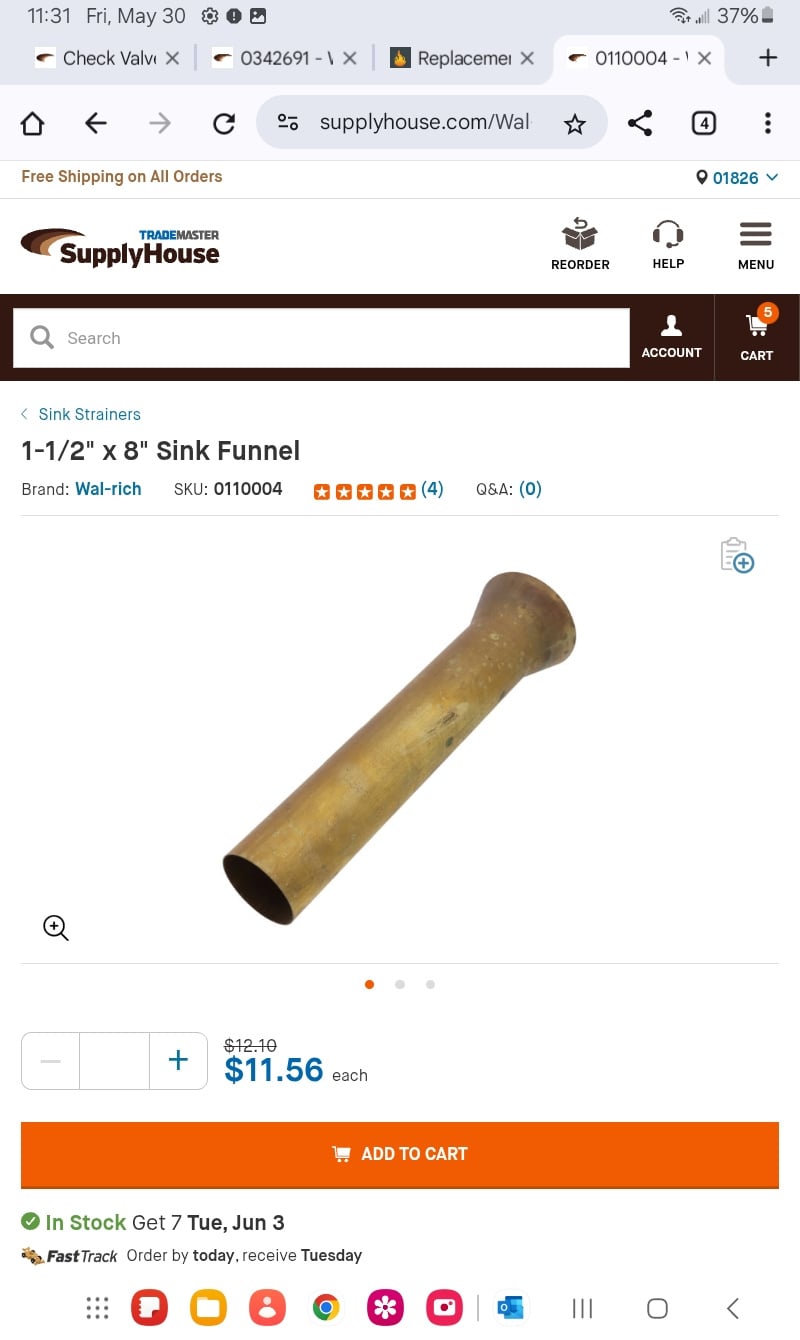

They are now made of plastic and are sold by many outlets, but if you want the cast iron version good luck finding one
what’s the name the part is sold under?

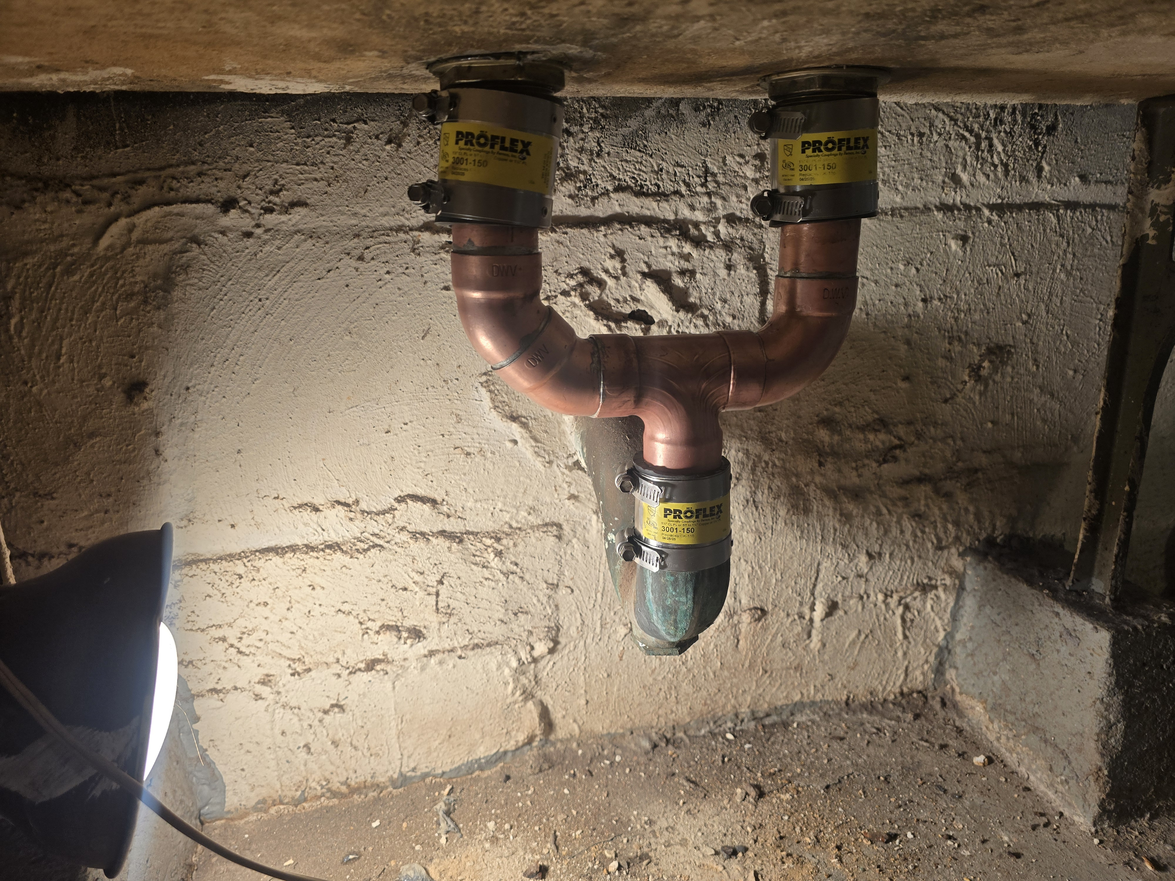

I had to ream out the drain holes to get the strainers through. They came through a little cockeyed, but all good no leaks...gotta love the tight pattern of copper DWV fittings. They weren't even that expensive...we got em off supplyhouse.com.

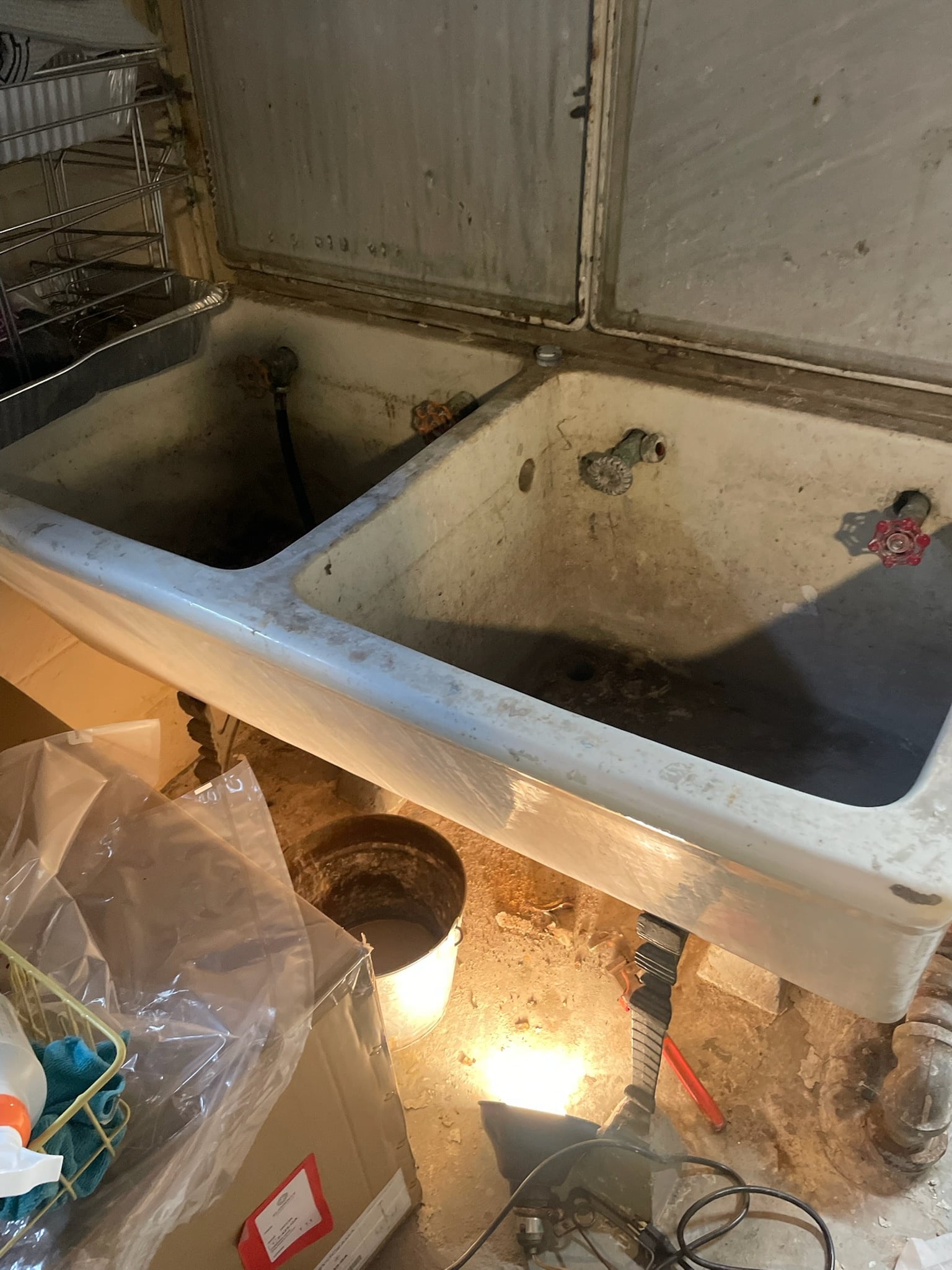

Saved this 100 yr old Beauty for another hundred years...Mad Dog
3 -
He had a few plumbers quote him big #s to crack it up, replace with a E.L Mustee PVC SS. All good all around. Mad Dog

it uses a standard strainer rather than one that is cast in to the concrete? I was thinking you could probably chip out the drain area and mold a new one with concrete/mortar made with epoxy instead of cement.
but even with a retrofit of the drain and adding backflow prevention that is far better than one of those plastic tubs bouncing all over the floor while you work.
could mount a faucet above with a vacuum breaker and remote spout in the holes in the tub. look at lab faucet parts.
