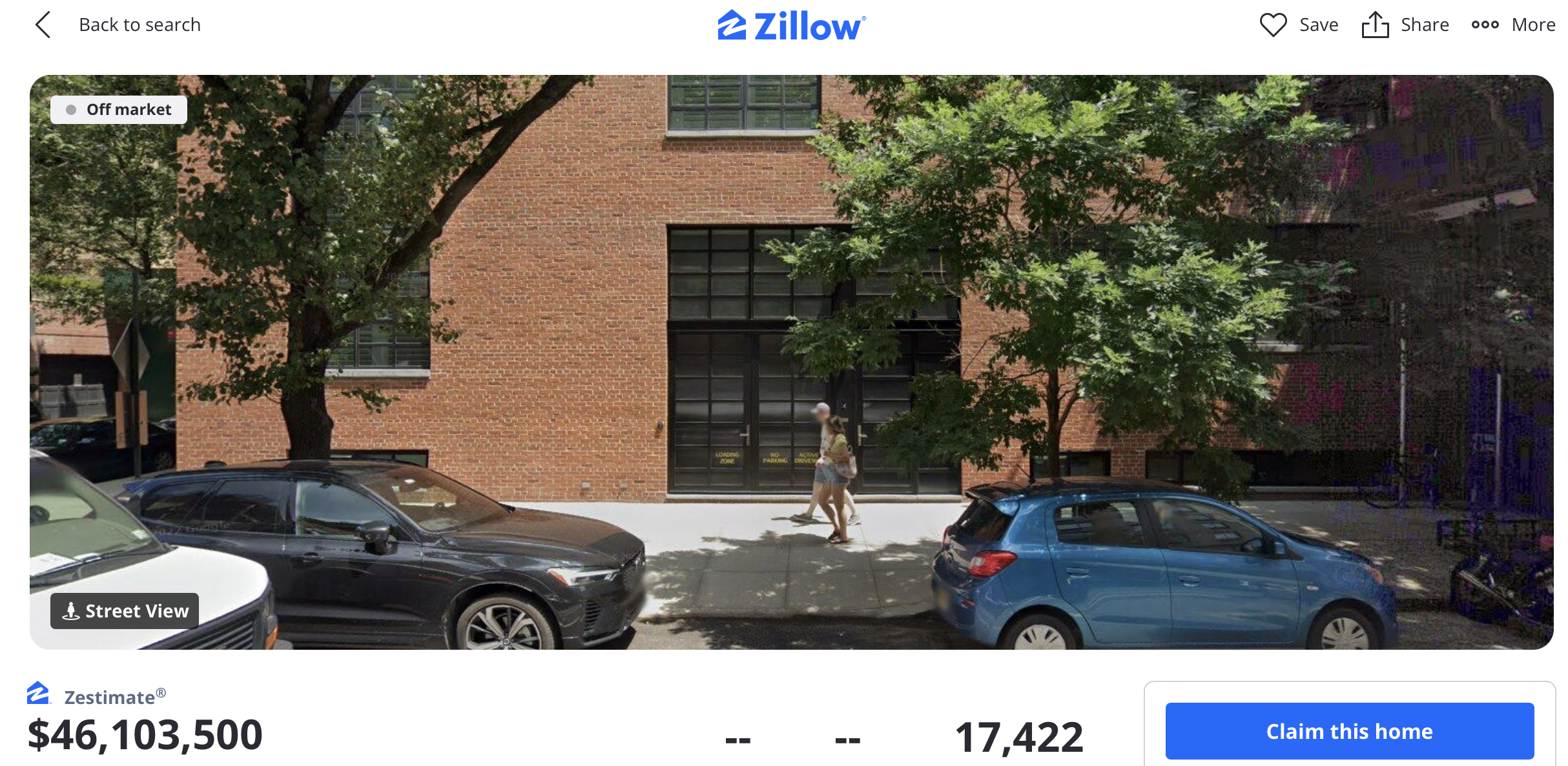

You can't imagine. The home is staggering.
