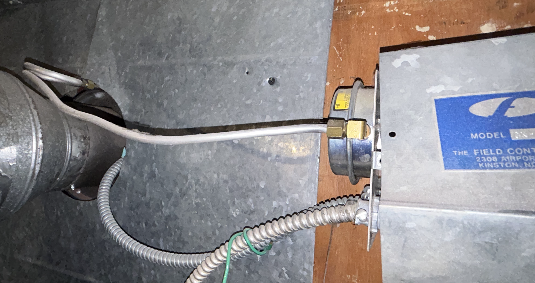

Woke up to no hot water. Verified I have oil, red light is on. (Honeywell R8184G4009) Pushed button once, light goes out and nothing at all happens. The exhaust fan turns on but the burner remains silent. Red light returns after 40-ish seconds Where do I go next?

    There is a proving tube inside the power venter. This tube transmits a vacuum from the ban housing to the switch, proving exhaust. These often get blocked with combustion debris.

    Yes. That senses draft and is connected to the pressure switch. You can try jumping the pressure switch but DO NOT LEAVE IT JUMPERED BAD THINGS CAN HAPPEN.
    Doyou have a test meter to see if the burner control is getting 120 volts?

    I Have been following this for the past few hours and can tell you the following:
    The Field Controls SWG series venter can confuse many technicians.   In order to determine if the burner motor is the problem get yourself a cheater cord.  That would be an extension cord with the female end removed or with alligator clips.  Remove the motor from the burner (you don't want the pump operating for this test.)  Connect the burner motor to the alligator clips and plug in the motor to a wall outlet known to have 120 VAC.  Do this for less than 5 seconds.   If the motor does not spin, the burner motor is bad.  If the burner motor turns, then the motor is good.    Be sure to use a  120 VAC outlet that is known to have power.
    My hunch is that the motor will operate properly.
    The next thing to look at is the CK control kit pictured here.  This control should always have 120 VAC at terminal L1 and L2. (L2 is sometimes called N or Neutral) When the primary control gets power from a call for heat The M1 terminal will operate the SWG vent motor.  This is to provide suction for the exhaust fumes from the heater to the outdoors.
    That happens when the Orange wire from the Primary control gets power.   The orange wire should be connected to T1 on the Fields Control CK control kit.  Not the burner motor.  That is the safety feature built into the Field Controls SWG Control Kit. You don’t want the burner motor to operate if the exhaust fan is not operating.

    What we do not know at this point is if the pressure switch is working or not.  We also don't know if the tube that connects the vent pressure area of the SWG vent is connected to the pressure switch properly, or if the tube that connects the pressure area of the SWG venter is clogged with debris.
    If the tube is not clogged, then the pressure from the fan operating is not enough to close the pressure switch contacts, or the pressure switch is defective or worn out.   If you replace the pressure switch and find the same problem, then you will own two working pressure switches.  I might look at the fan blade of the Field SWG.  They may be clogged with carbon or rust buildup and not moving the same amount of air as it did when it was new, or the fan may be missing some of the fan blades.  Inspecting the condition of the fan is less expensive than putting on a new pressure switch.   If the fan looks fine, then the pressure switch may be the problem.  Again if you replace the pressure switch without checking that the connecting tube is clear, you may end up owning two working pressure switches and just need to run a pipe cleaner (available at smoke shops or craft stores) through the tube.  I have found that the aluminum tube is fine but the short section that is in the Fan that is made from steel is clogged.
    You may also find that the relay in the Field CK kit is defective. On the CK61 kit that relay is replaceable.
