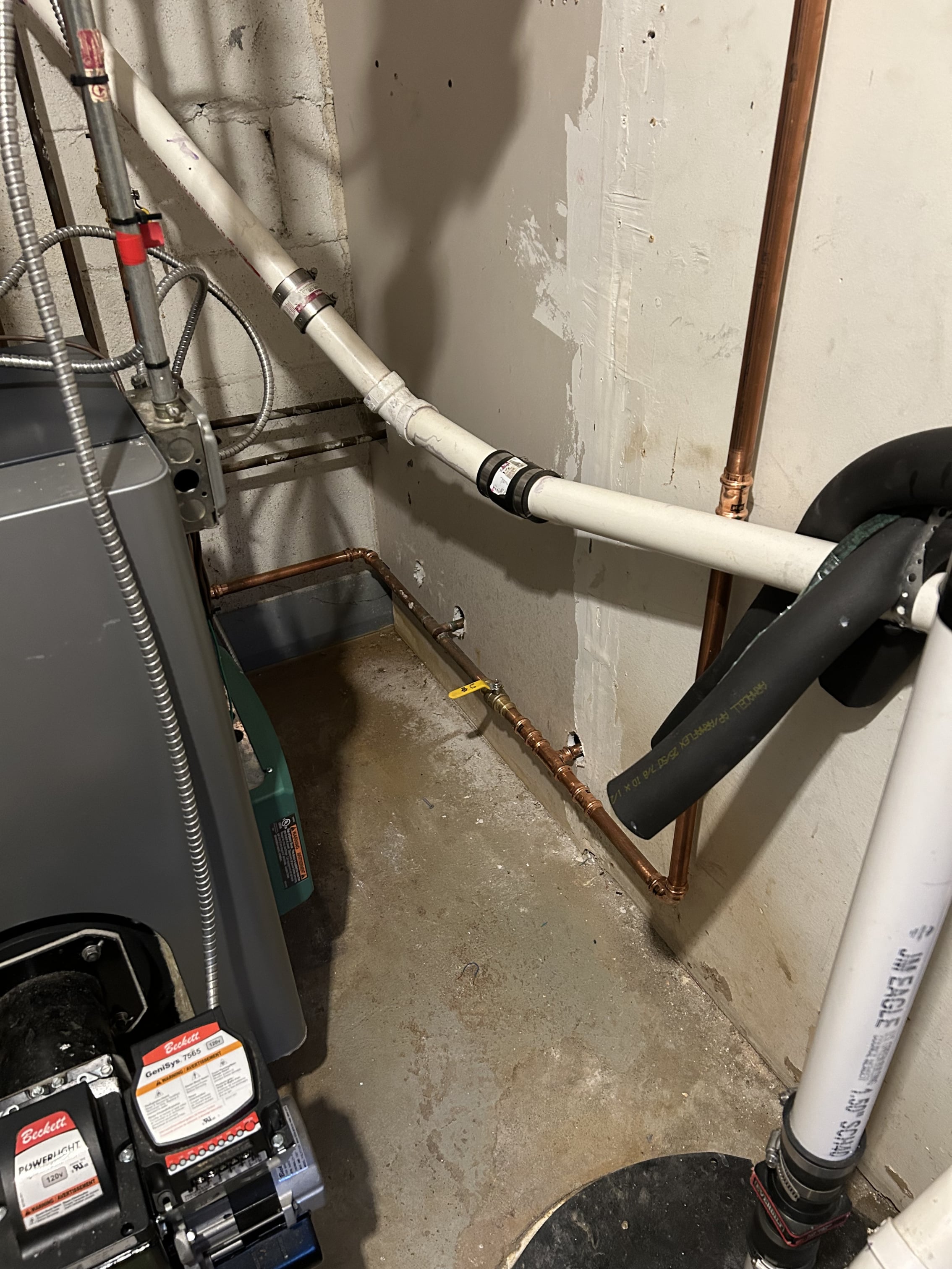

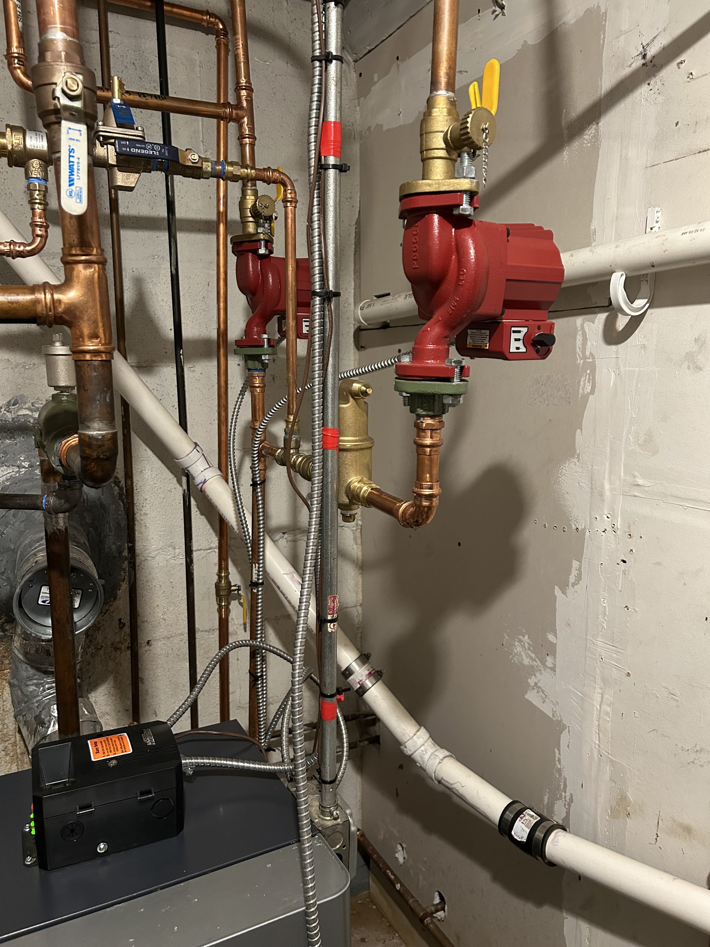

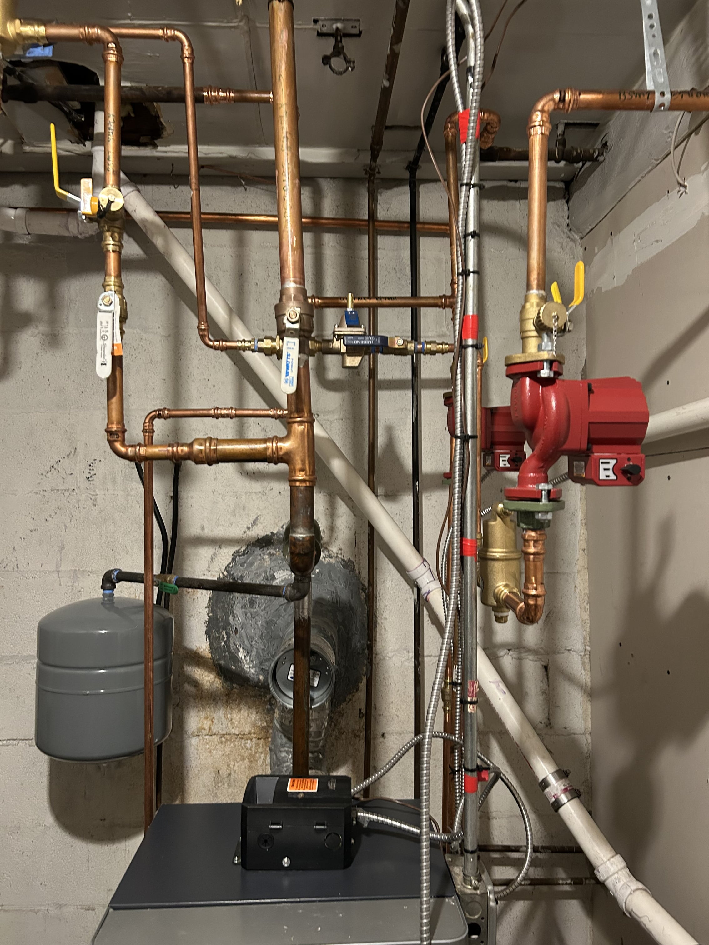

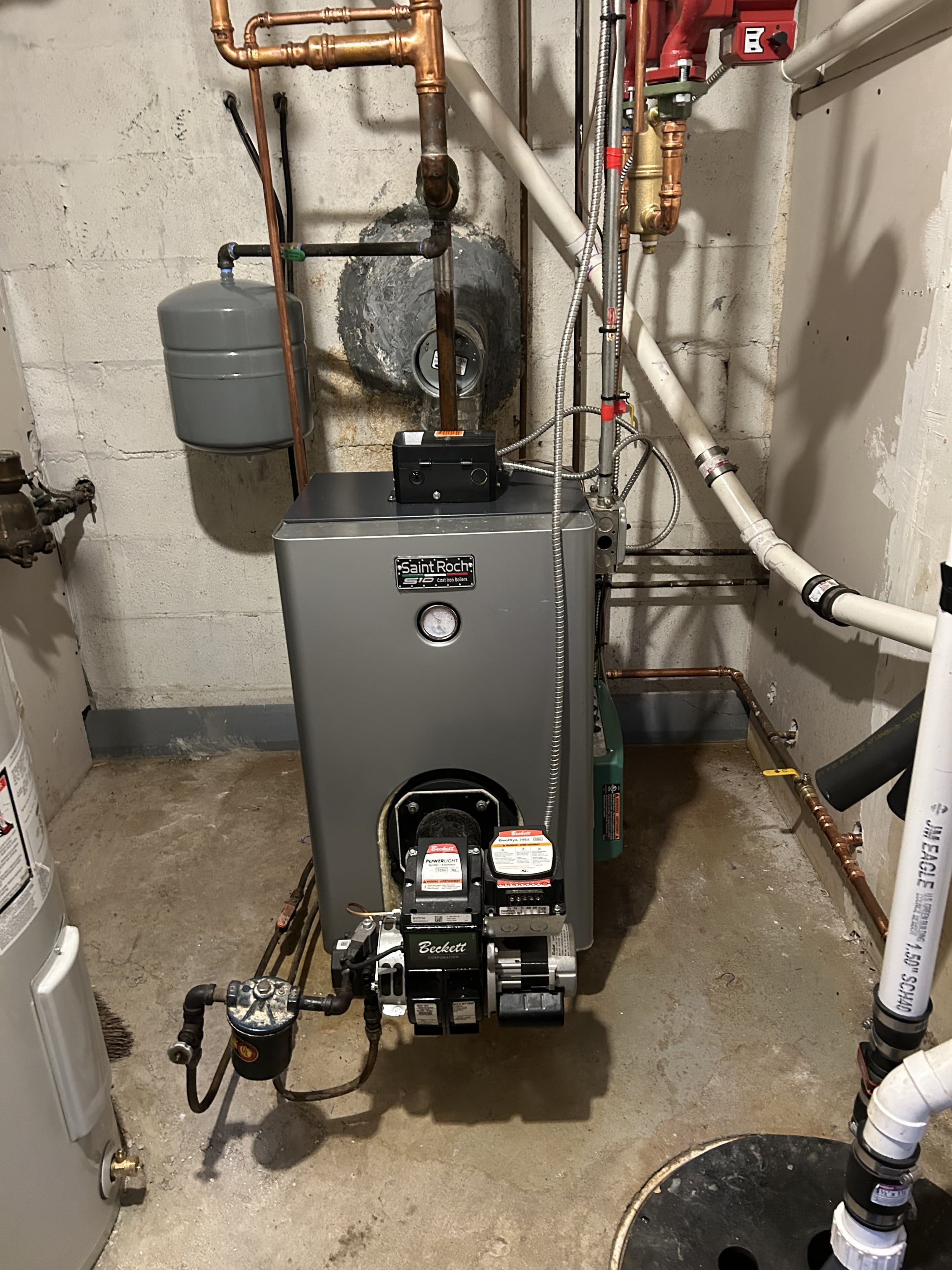

    ok, I appreciate the feedback so far. I reached out to the plumber who has been helping me to solve this issue and shared your comments. He replied that the pressure tank was correct and he only used dope on the probe. Perhaps these pictures will help shed some light. Also wondering, when not tripping the lwco, the boiler turns on periodically for about 1 minute (when not calling for heat). Is that normal and/or part of the same problem? Thanks - very appreciative of your wisdom
    @Jon_R101
    looks like a nice boiler. Is the well for the Hydrostat sensor under the control or is it remote wired from the control? i attached the manual but they are not clear on where it (the Hydrostat) should be mounted.
    It looks like the supply pipe comes out the back of the boiler a few inches down from the top. This could leave air trapped in the top of the boiler.
    I would call Saint Roche and aske them how to vent the top of the boiler. There may be a tapping you could install a bleed valve on.
    The manual is not clear on the available tappings but the drawing shows what looks like some spare tappings.
    HVACNUT Posts: 7,784
    You have the Hydrostat 3250 Plus. Check/tighten all Grounds. All the way back to the panel if needed. And make sure the 1/4" hex screw is tight where the Hydrostat attaches to the Well.
  • I’m sorry but that is one ugly install. Air scoop (incorrectly installed) and micro reabsorber.
    Piped wrong, circs way too big, flue pipe not to code for oil, and on and on.
    The immersion well does go into the top, and is the short immersion well, so your problem may just be air trapped at the top of the boiler.
    I don’t see the extra provided ground wire installed.

    I would check the pitch of the boiler , It should be pitched up toward the rear of the boiler to vent any trap air ...
