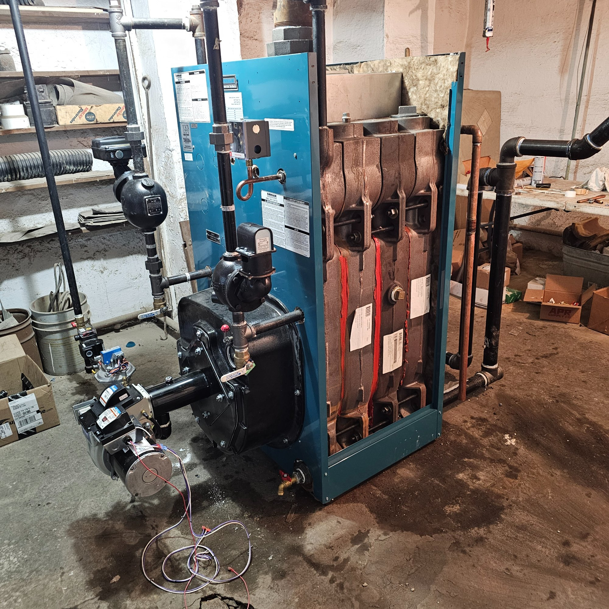

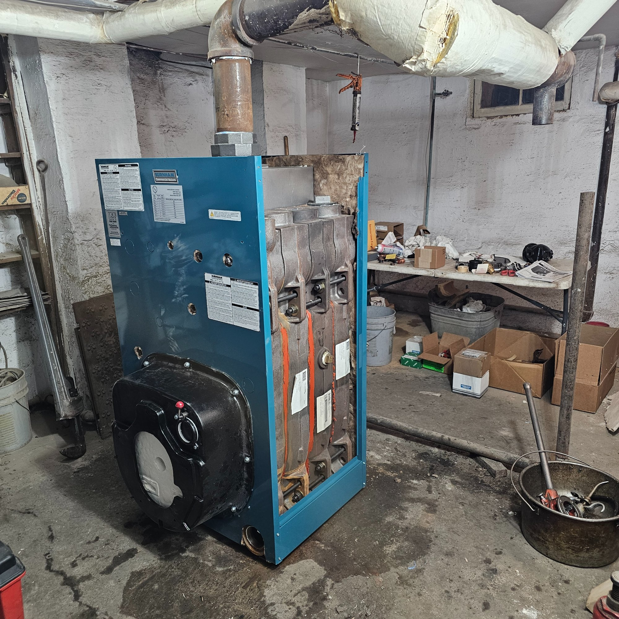

I am not a licensed steam plumber, and this is not my steam boiler, but I wanted to upload this photo from the coal pail forum simply because I would like someone with much more experience than me to look at it.
Of course the installation is not finished, but I feel like there is something missing besides a 6 inch drop header on this Burnham steam boiler.
He mentioned today that this is the smallest commercial Burnham boiler 904 with585,000BTU burner and using one of the 6 inch risers, he told me he ordered it three years ago.
The Burnham people sent all the needed controls and wanted it plumbed this way. He was surprised to see that two water feeders were part of the installation
The company that is installing it did a complete heat loss study before recommending what size boiler to order to replace the Van Wert VA1800 coal stoker steam boiler that was there previously. There are 4 pressure units on the boiler as well according to him.
The sheet below is page 38 of the owners/installation manual and the picture above it is the initial installation and placement of the boiler under the existing piping.
They have a welder coming to tie in the riser to the plumbing this week

    I can't see enough of the piping to see if there's even a header.
    Heat loss isn't the right way to size it…I take it this place is massive?
    Multiple safeties and possibly mechanical safeties seem to be required by code for commercial/multi-family installations, but not in single family residential. But I don't blame Burnham for their mandates. If they don't mandate stuff, then people cut corners.
    The people who actually know the code will speak more to that, but for me I'd love to see more piping, I don't think we can see enough yet.

    6,000 square feet, more than 57 windows, solid brick walls insulated ceilings. The Van Wert VA1800 coal stoker steam boiler which was the largest coal stoker boiler they made was sized the same way 48 years ago.
    ethicalpaul Posts: 9,075
    it could have been sized way too big. And a coal stoker I assume has different steam production rates depending on how fast it's stoking? I have no idea but it seems it might. The oil or gas burner isn't going to have that variability, right?
  • I was in the house, awesome place! The van wert was hugely oversized and had a modified feed rate below the maximum. His total yearly usage was around 500,000,000 BTus if I remember correctly.
