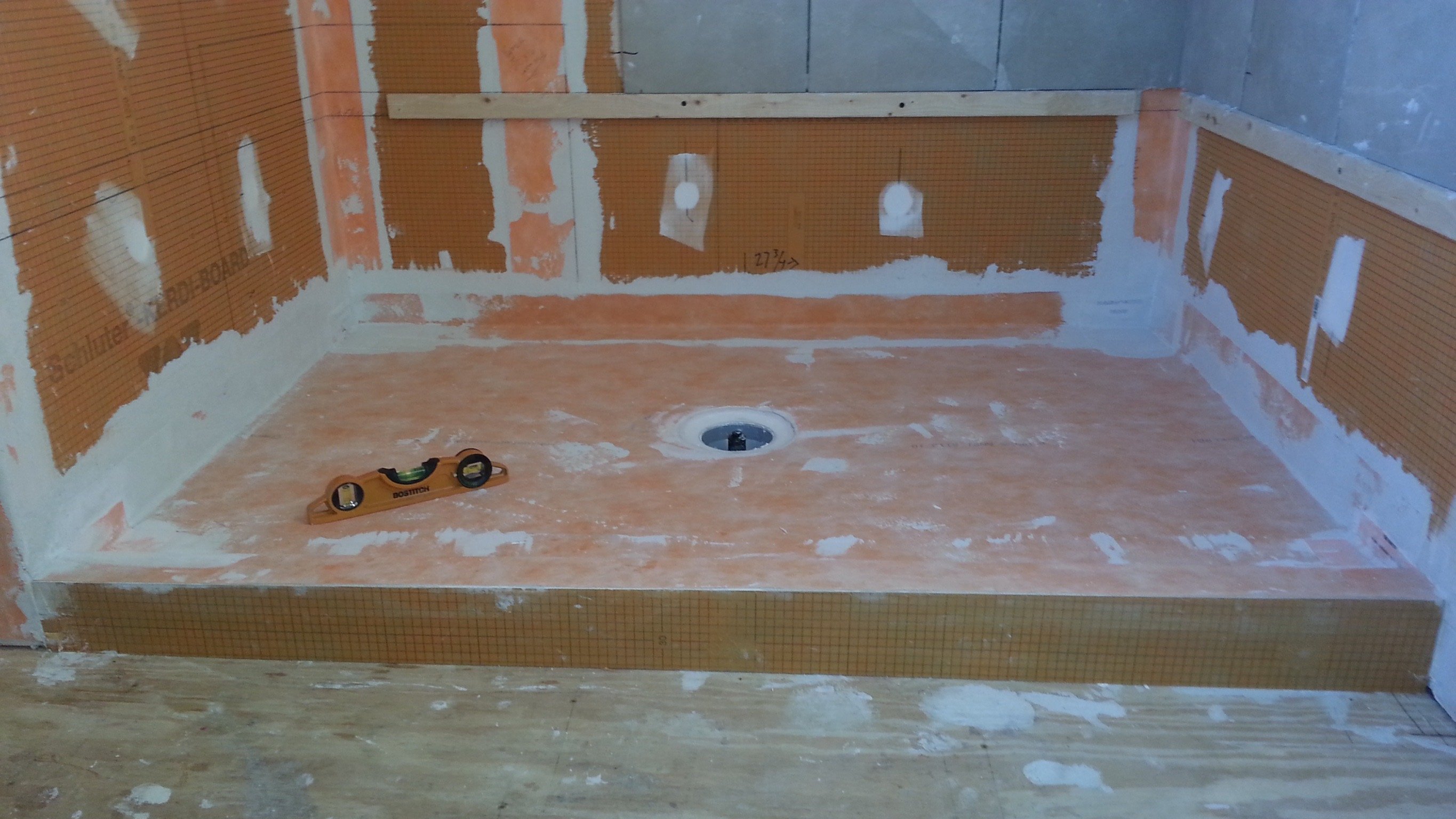

    rubber membrane with pre-slope and top mud layer typically fail due to nails through rubber within 8" of floor. This is especially problematic with wood curb as the leaks cause wood to swell over time rupturing the curb. Of course by this time the water has caused damage to subfloor was well
    fabric water proofing membranes such as Schluter Kerdi over mud or foam base are very good (gold standard IMO) but failures occur when wood is used for curb structure and the glass door installers put screws through the water proofing causing curb failures as described above.

    Recommend johnbridge.com as an excellent resource for all things tile and water proofing. The picture below has a foam curb with mud base sealed with Schluter Kerdi. Walls are Kerdi board (foam). Great products

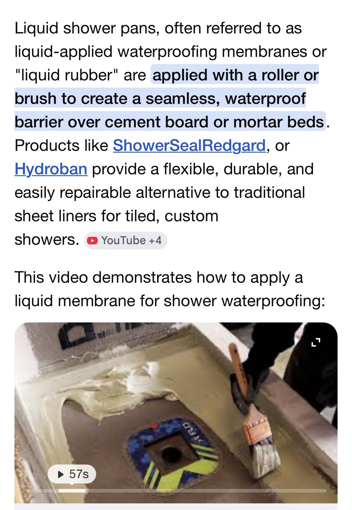

    There are a number of ways to do this. Some tile setters are using a liquid pan material, also
    It really comes down to which method your tile setters prefer
